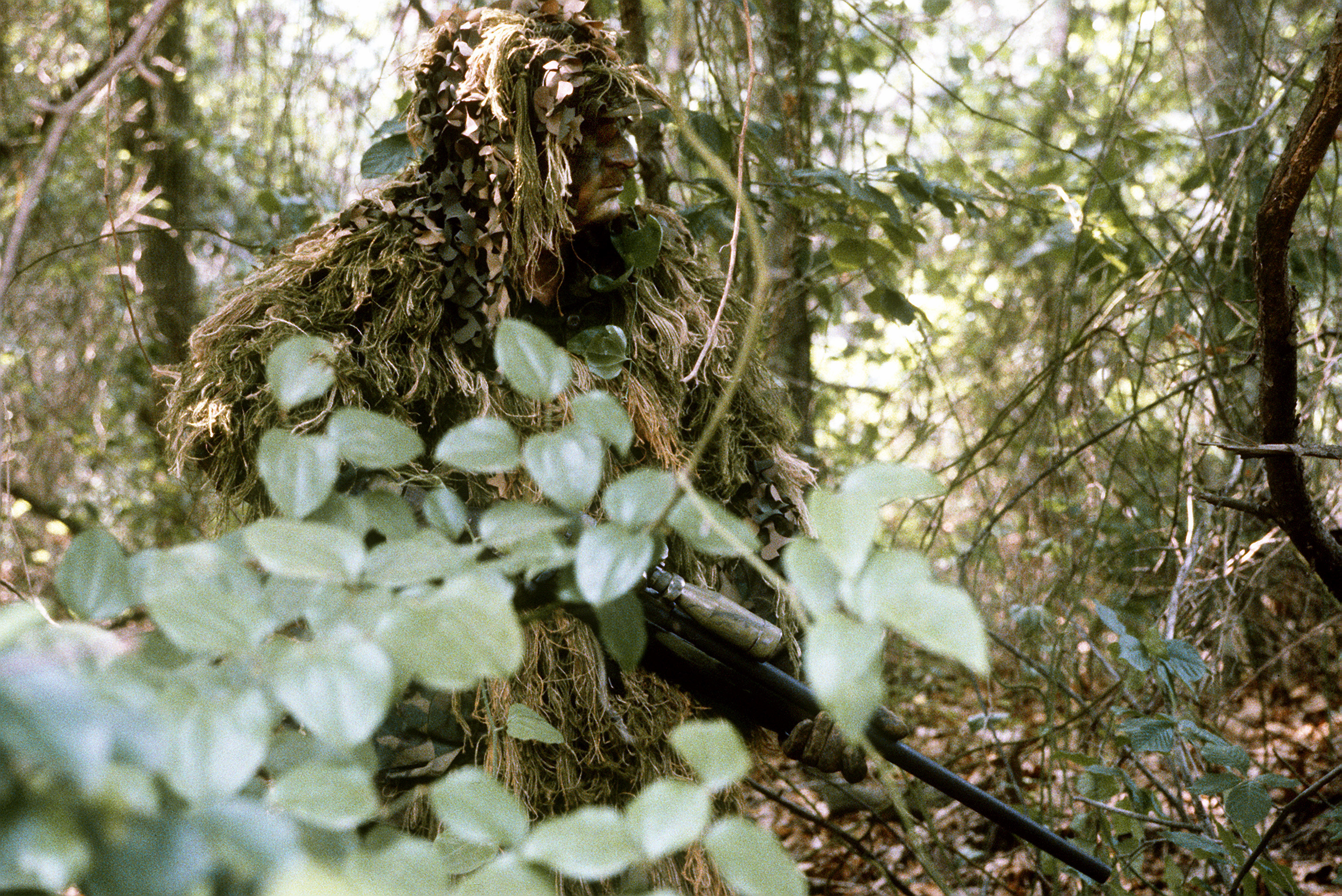

A colleague of mine is reparing a trigger for a base camp perimeter alarm while unknown to him someone is observing him in a "G" suit...where is the guy in the suit?
Ah here he is!

Awesome sequence. Maybe it was just luck, but after looking at the first pic for a bit, I was able to guess where he was. I can't tell what it was that tipped me off though, so probably just a lucky guess! (EDIT: Maybe it's the way that those shiny, round green leaves don't look to be self-supporting even though the other ones venture out under their own support)

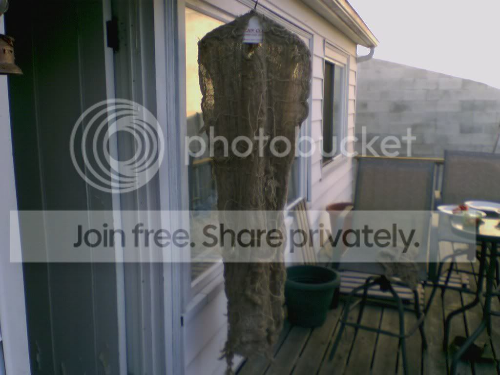

Here's one in progress using hessian, basically a photo blind that goes with you. There aren't sleeves so it'll be less obvious when using a bow or camera. Besides, I'm not about to wrap my lenses in cam tape to complete the ensemble.
I need to get some more hessian to cut into strips, but I'm curious to see how it works. It was this or cam netting...(which snags on gear and brush anyway). It's stitched up with jute and the lateral stitching gives a place to tie rags on and weave local veg into. It comes to about mid-thigh and it really DOESN'T look like some kind of Ozark ballgown in person....:D I ran it through the washer to fray the edges and it bunched up like that - it stretches out when worn but isn't baggy enough to snag on stuff.
Great pics Quirt. Think I'd have thought twice about sneaking up on your friend with the big knife though!

I also picked out the spot where the guy was hiding quirt....after looking at it for a while I think the problem was that the picture was focused on that little lump of plants, not on the guy...I couldn't say exactly what made me pick it out either...so I'm thinking that's what it was. We've all seen lots of monster movies and whatnot like that...at first you don't see the monster, but it's a pretty safe bet to think it's in the center of the screen. I don't know for sure though.
--BubbaThud
I didn't guess where the guy was myself...but regardless I don't ever remember being in a situation where I knew a guy in a ghillie suit was right in front of me, and I had all the time I wanted to find him, and that was my only goal!
I am not at all a ghillie suit expert but it seems to me that they're generally being used by guys like the ones with the Alice pack...that is guys with rifles that are going to shoot you from a long way off! So even if I could find the guy in the pic pretty quickly, I would guess that if that same guy was somewhere 700 meters away from me, even if I were really cautious and convinced someone was going to shoot me right in the tinfoil hat I wear, that guy would get me for sure.
And if I wasn't expecting anything or anyone, I bet the only way I'd find the guy is if I stepped on him and he grunted!
