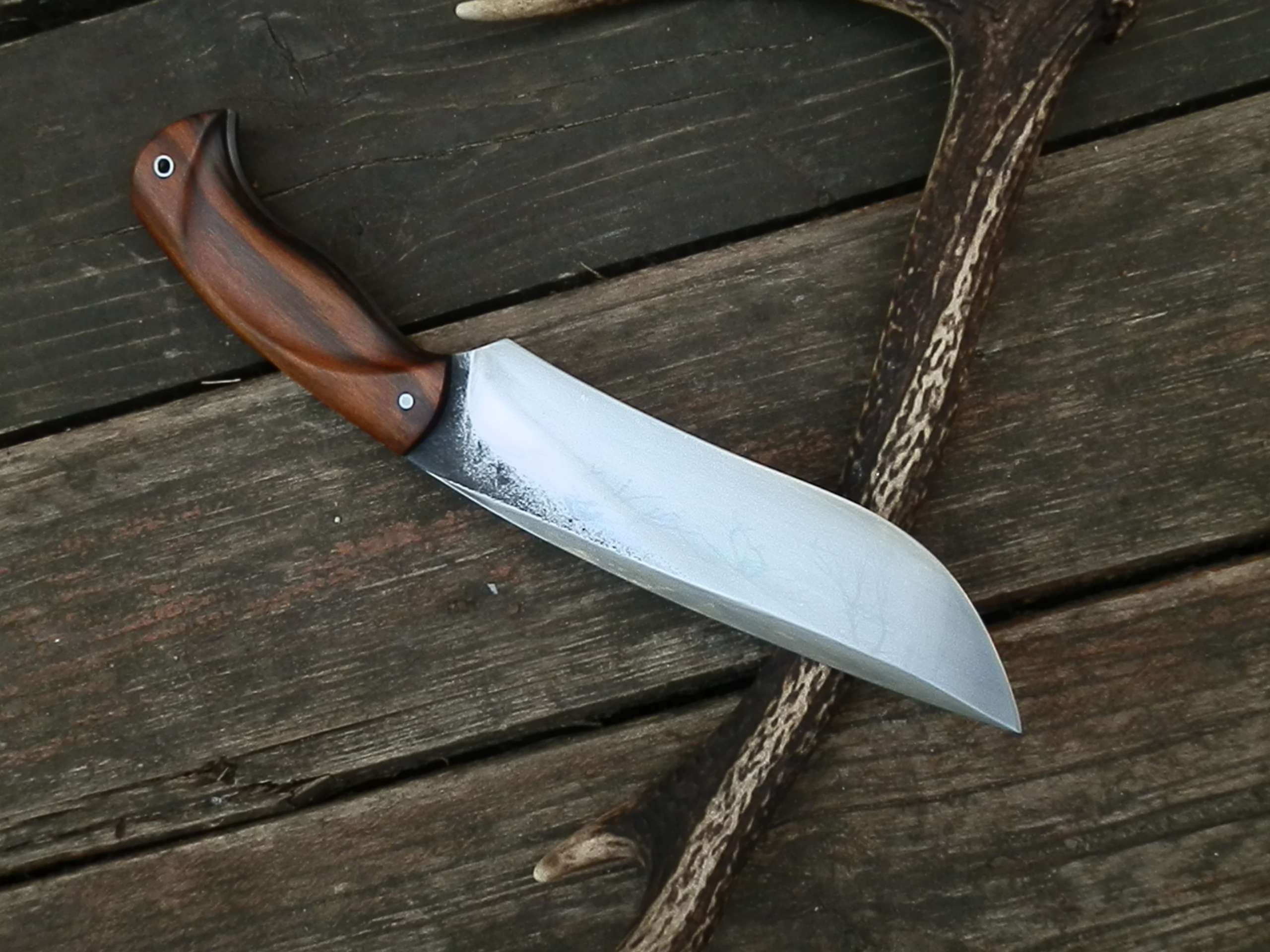

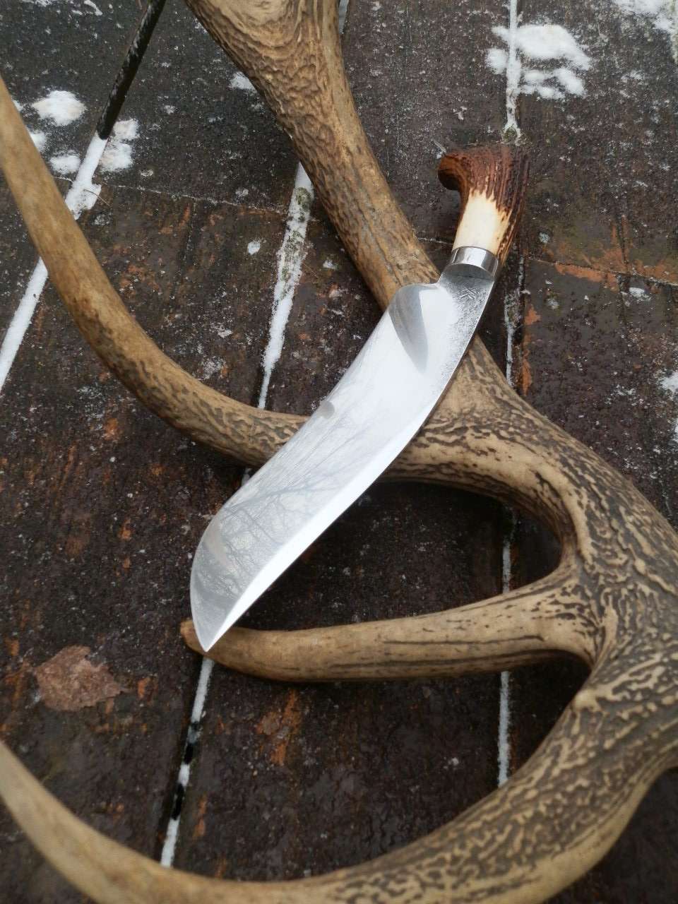

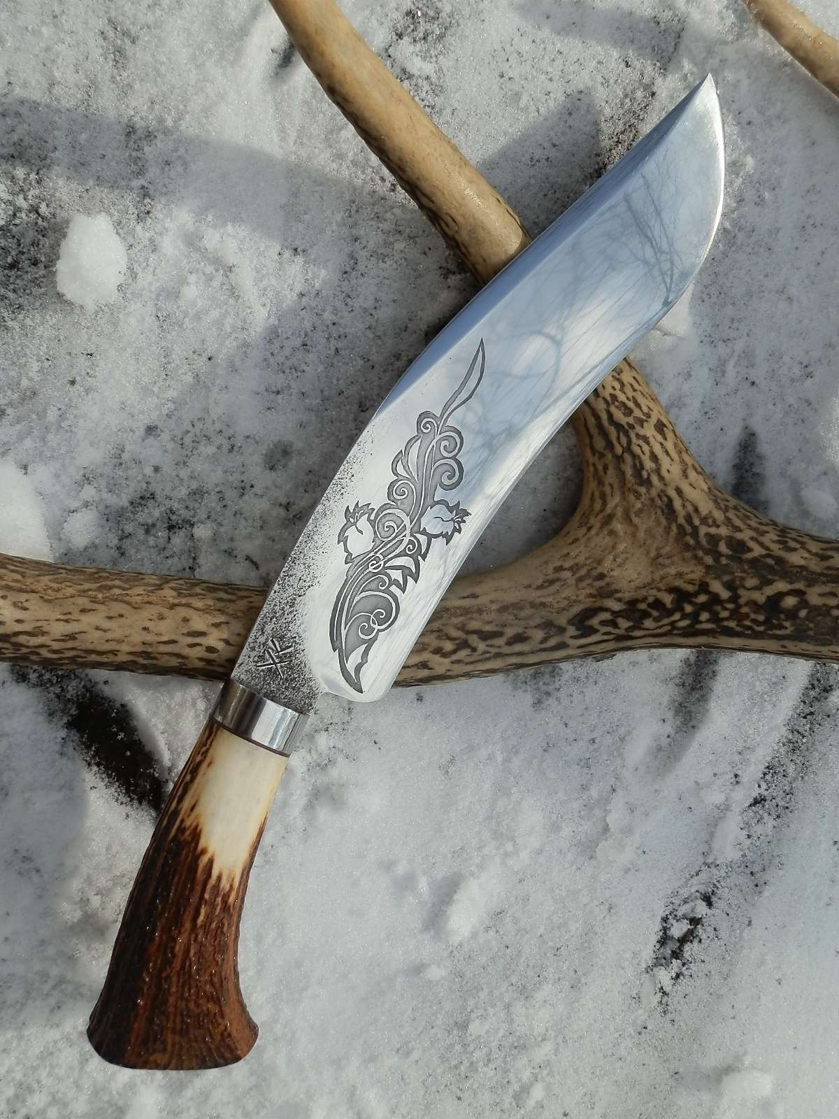

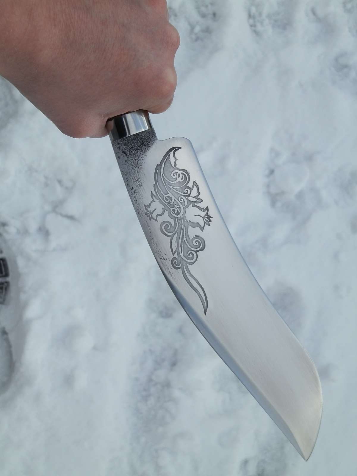

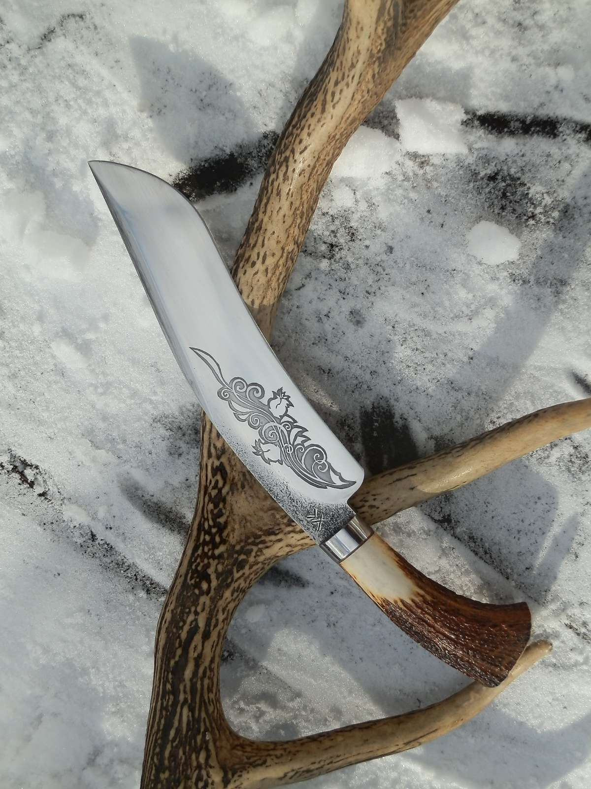

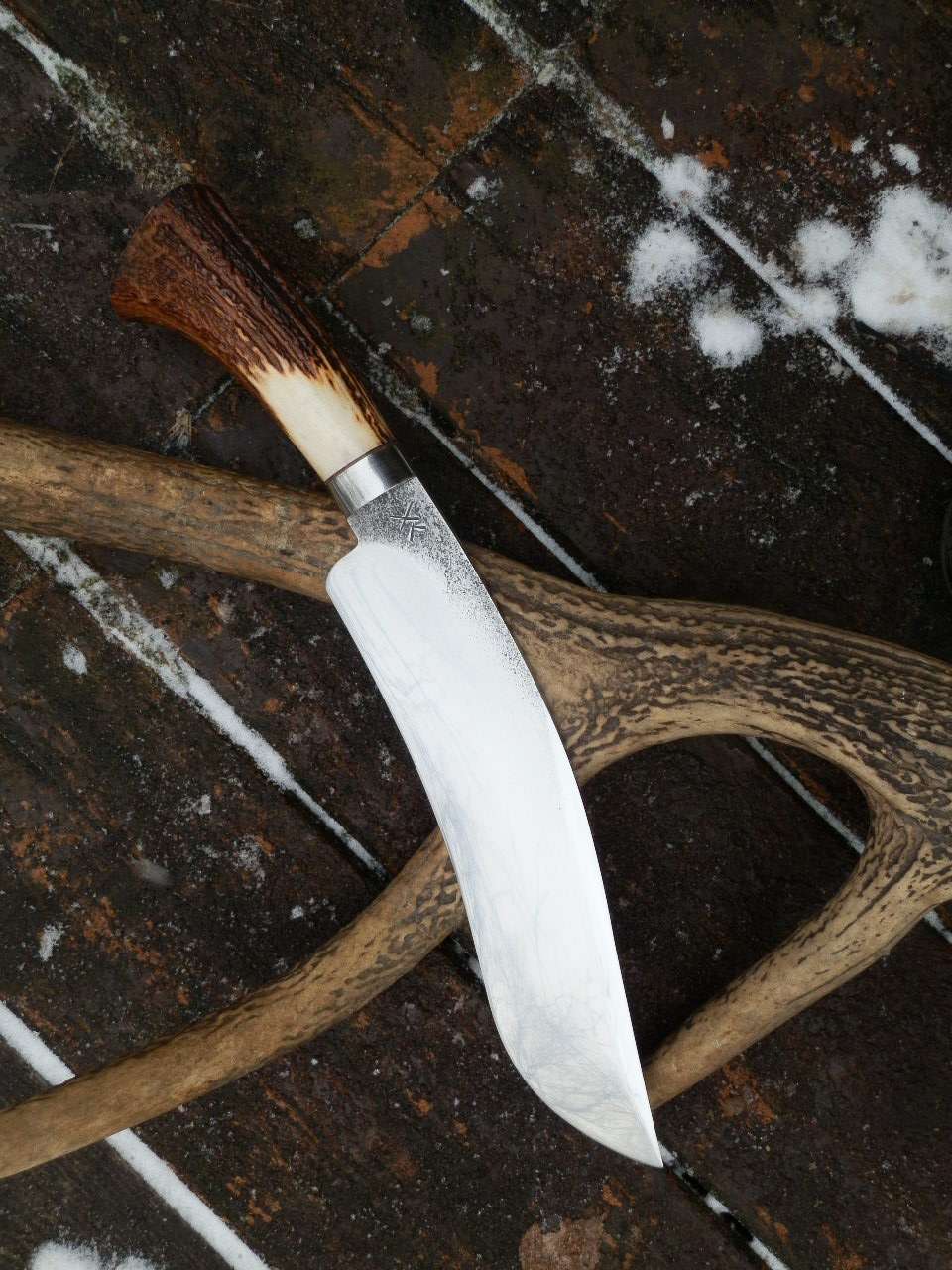

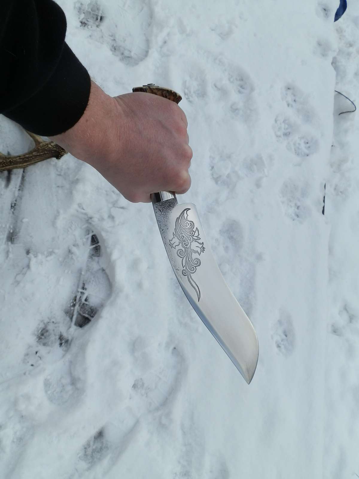

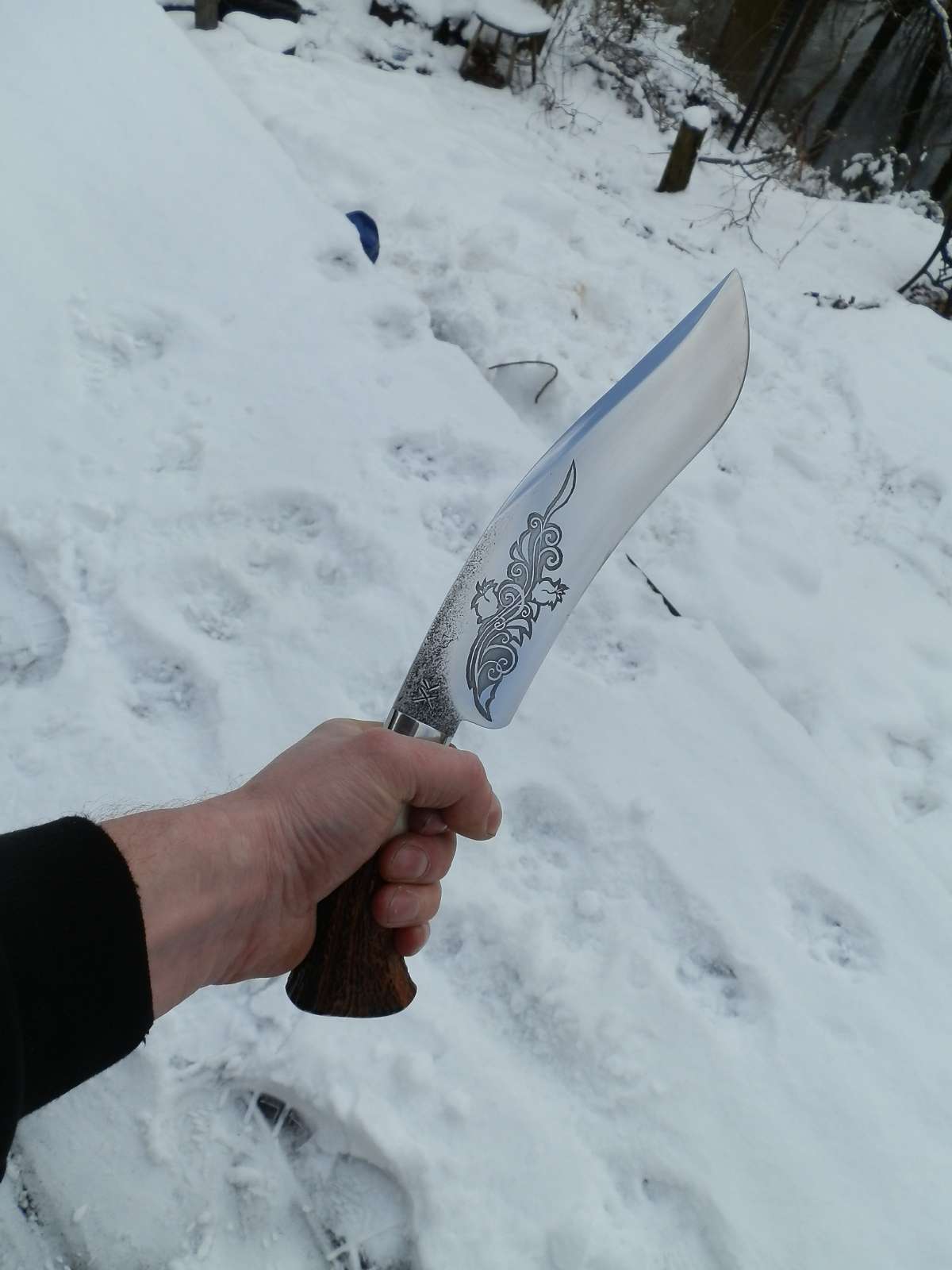

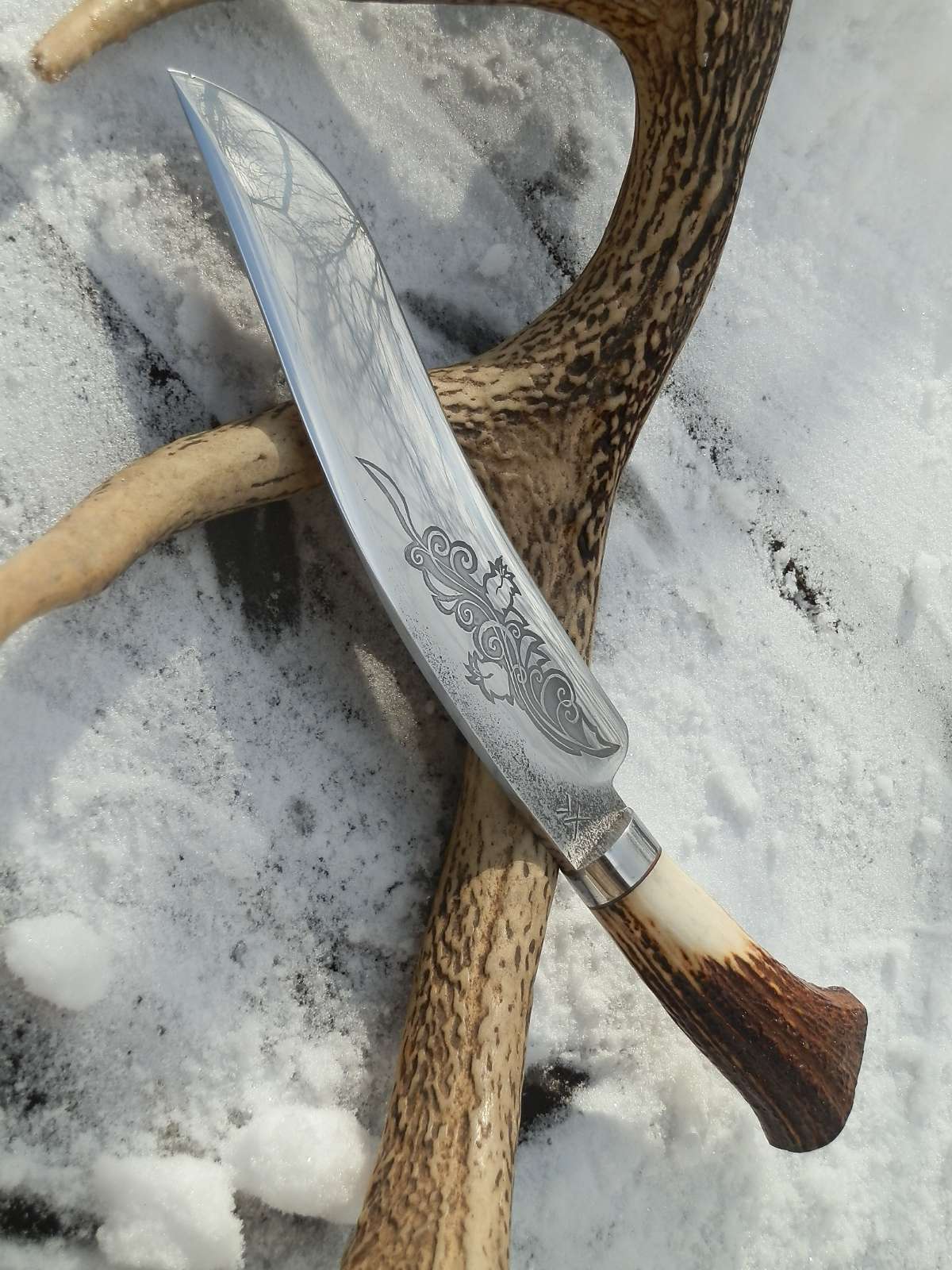

Hi Guys

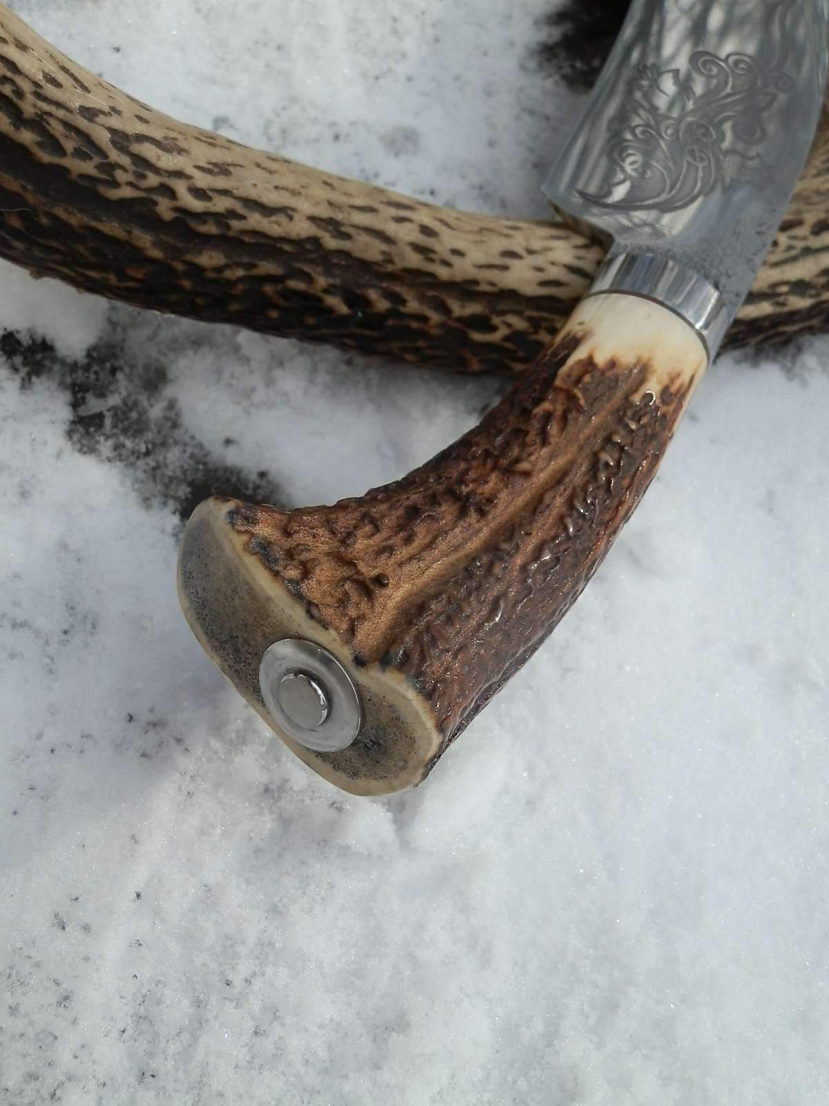

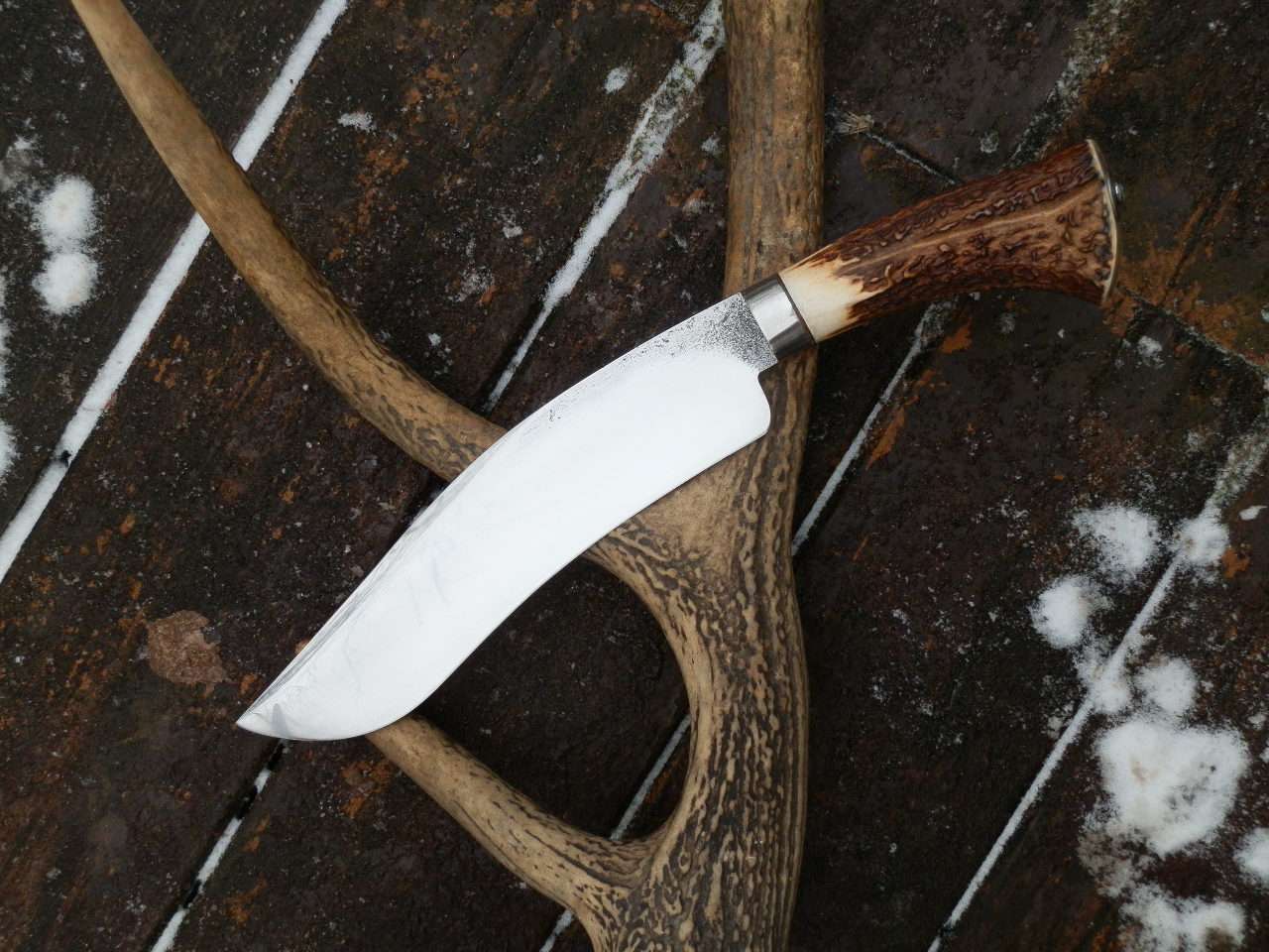

I finished this one some time ago in 2012 and wanted to check how it would look like with simple etchings. Probably I will make more etchings in the future, especially on smaller “gift knives” for my friends and family (so rather not on big working blades) but I have to learn a lot about how to do that properly. This was my first try.
[imghttp://img213.imageshack.us/img213/6813/p2215205.jpg[/img]
Regards.
PS the blade is 5mm thick NZ3 steel about 23cm long with deer stag handle and SS fittings.

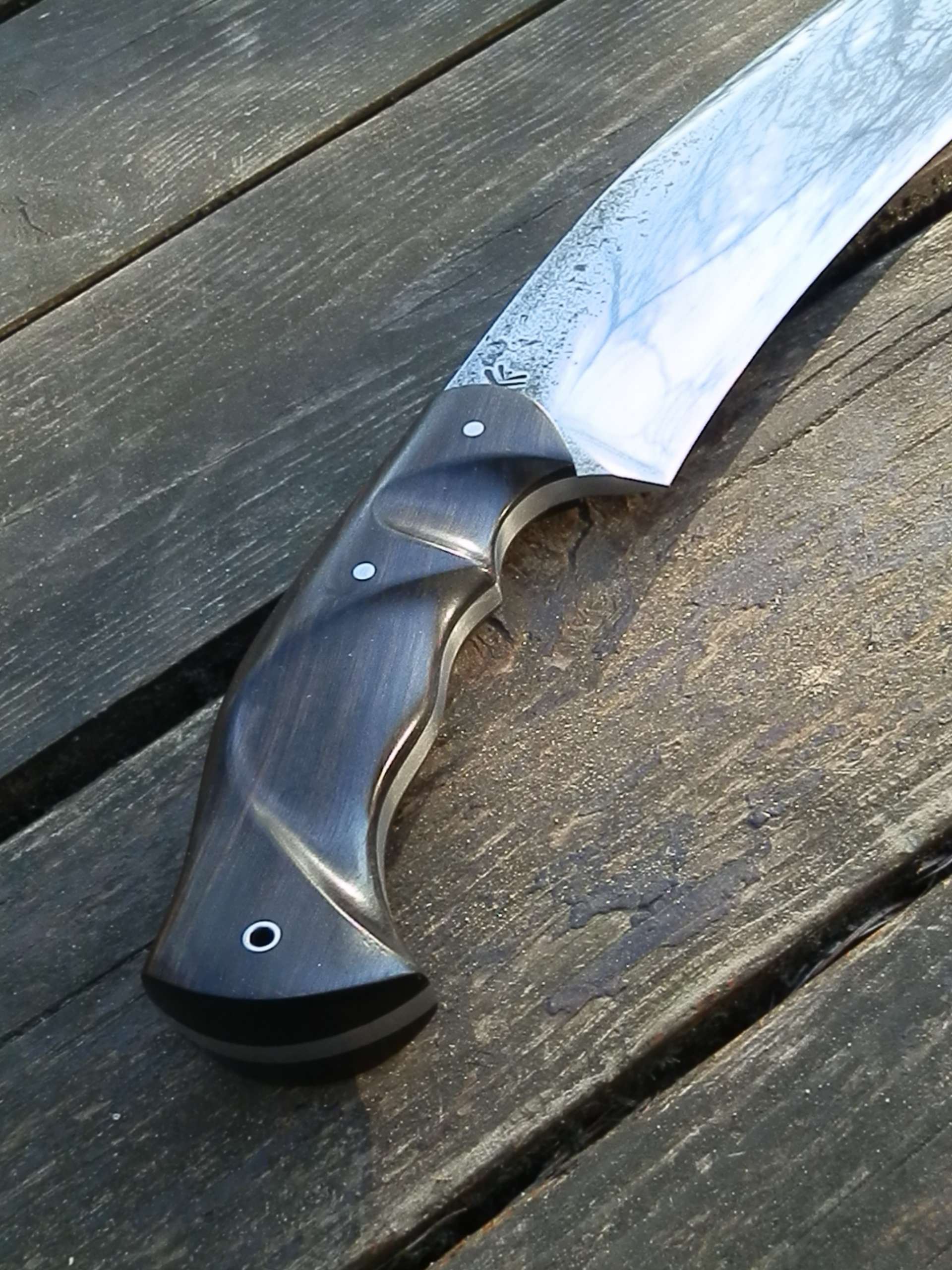

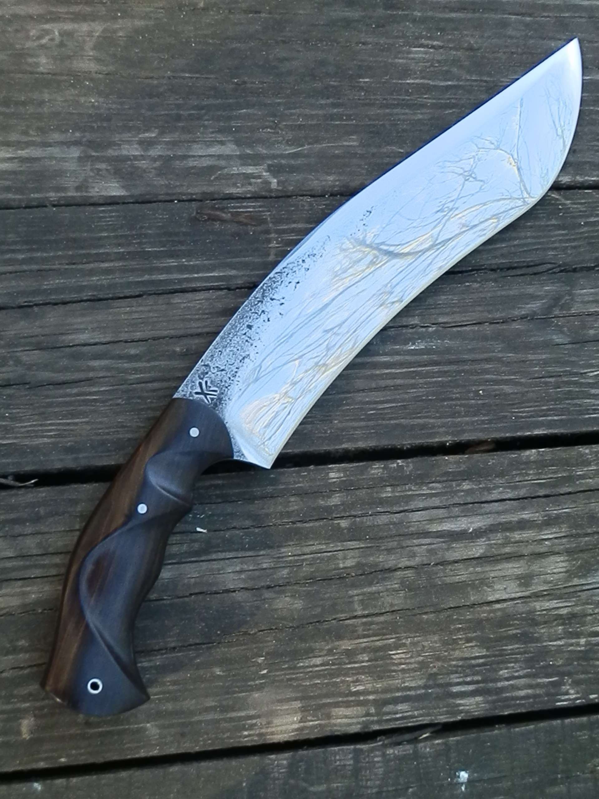

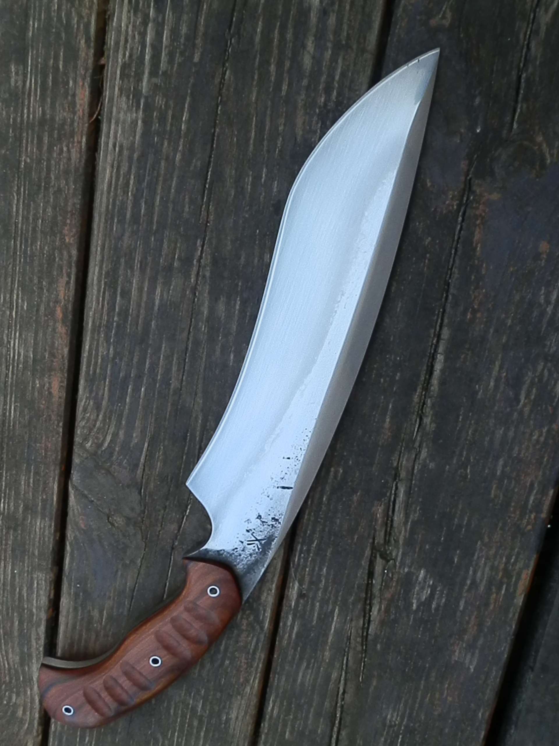

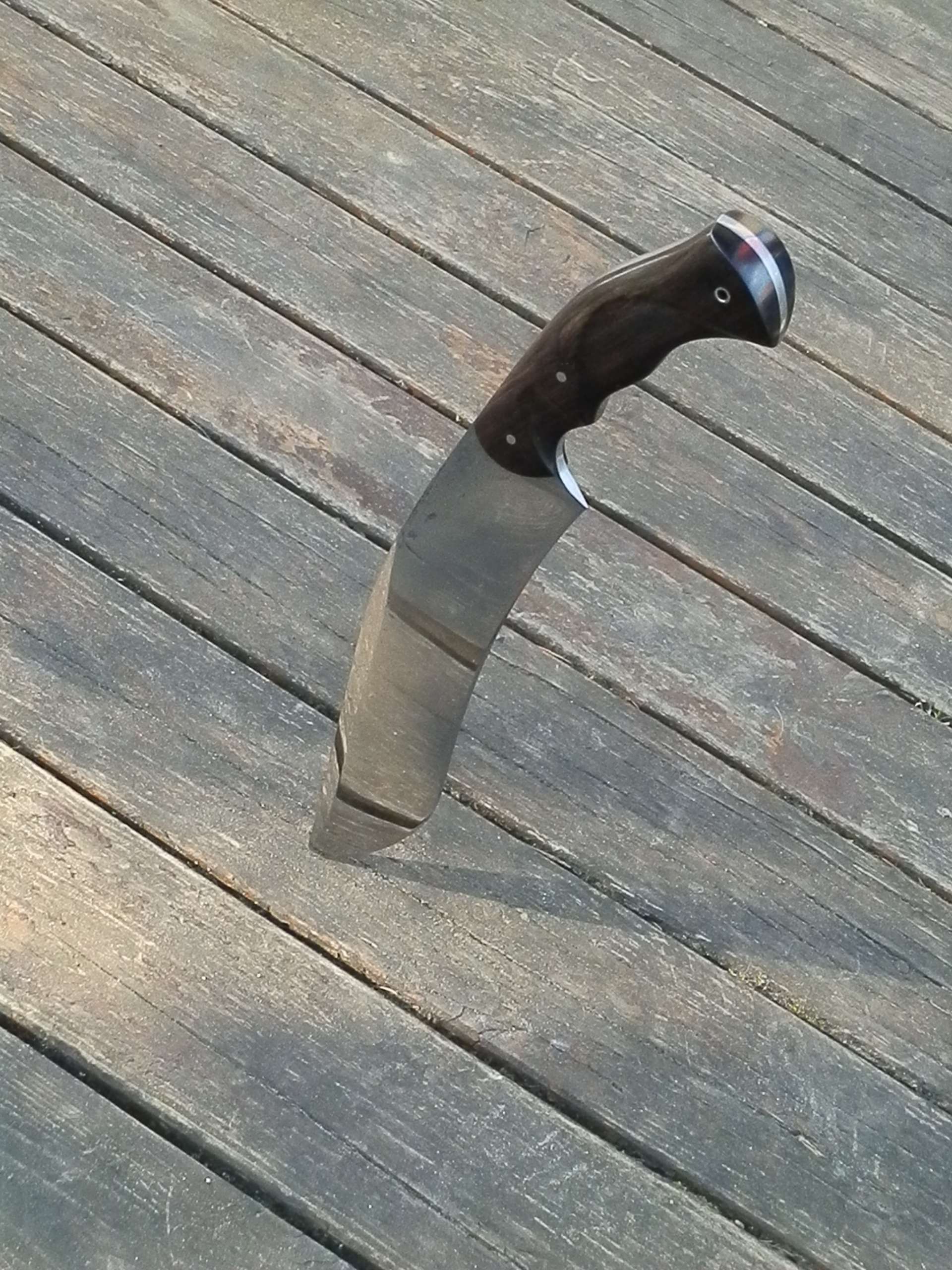

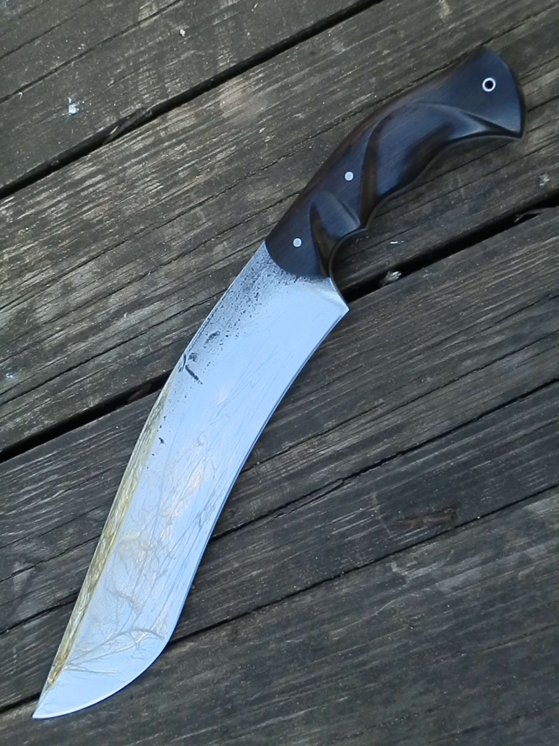

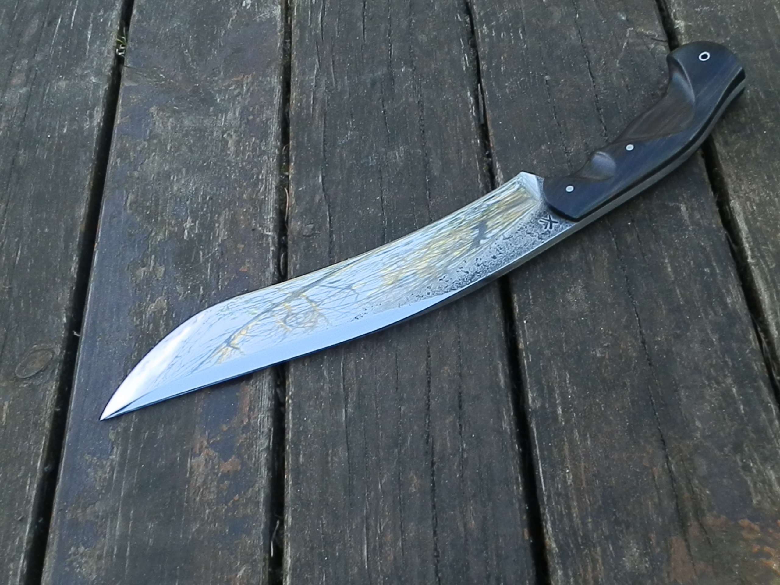

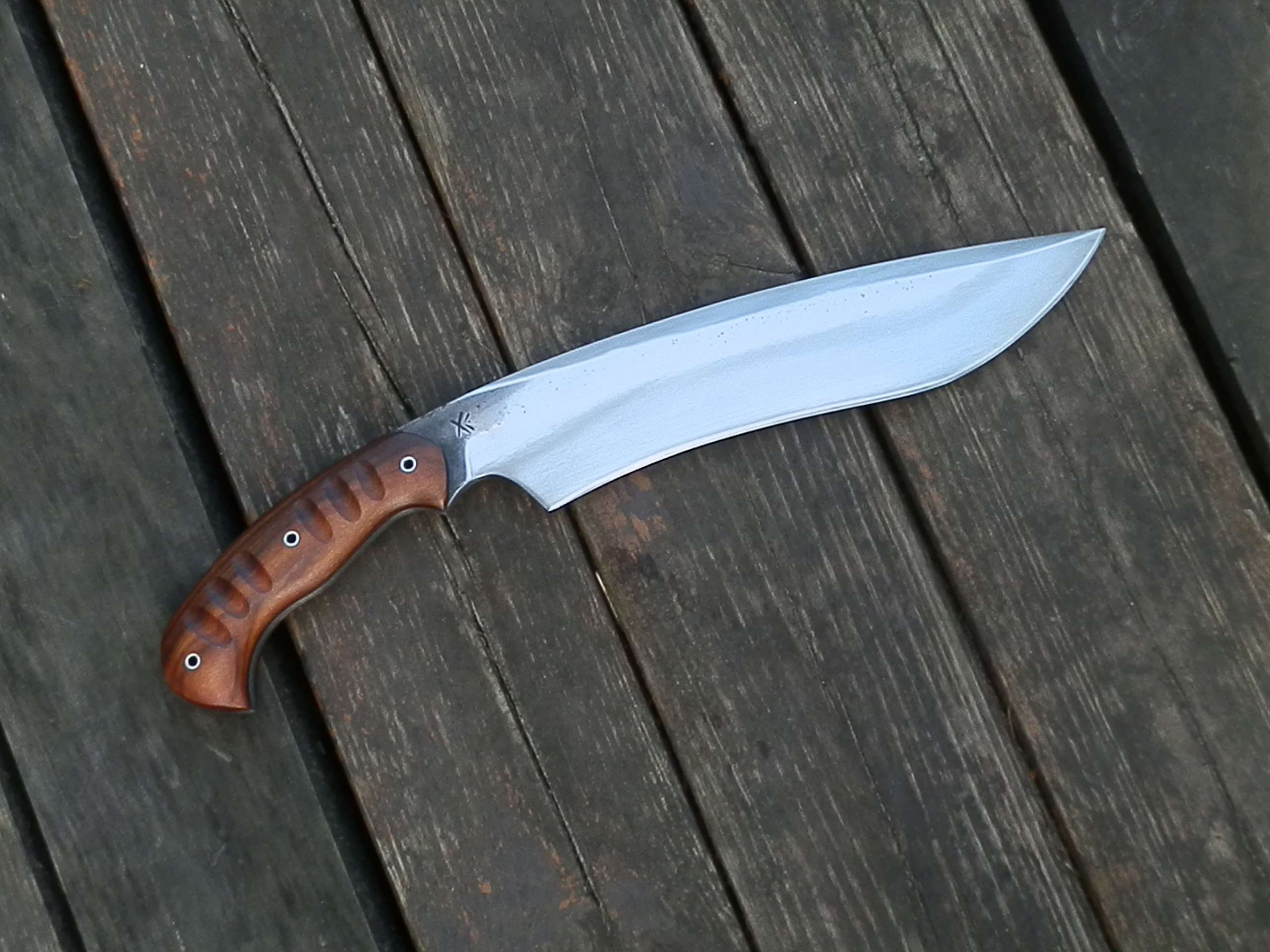

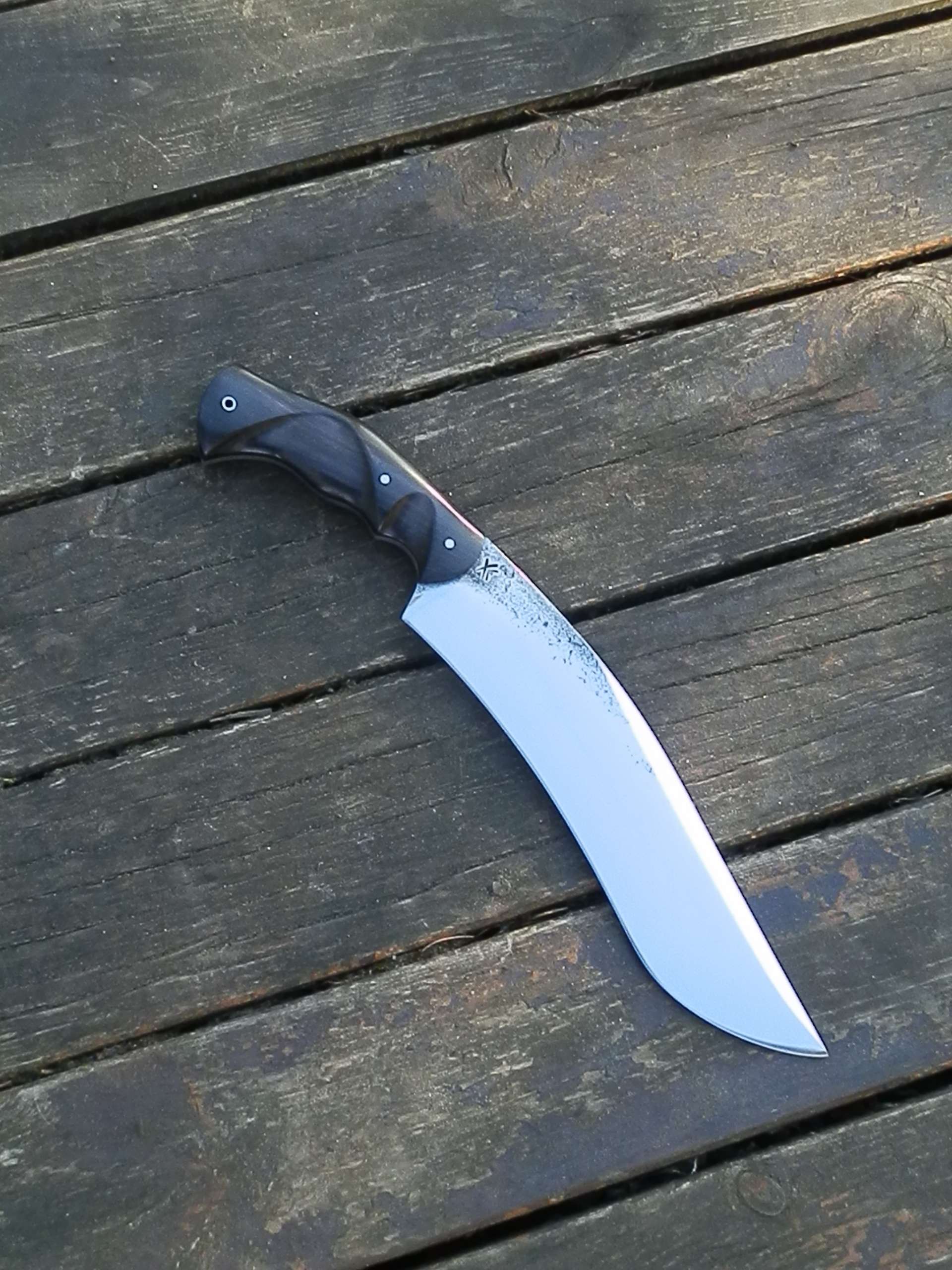

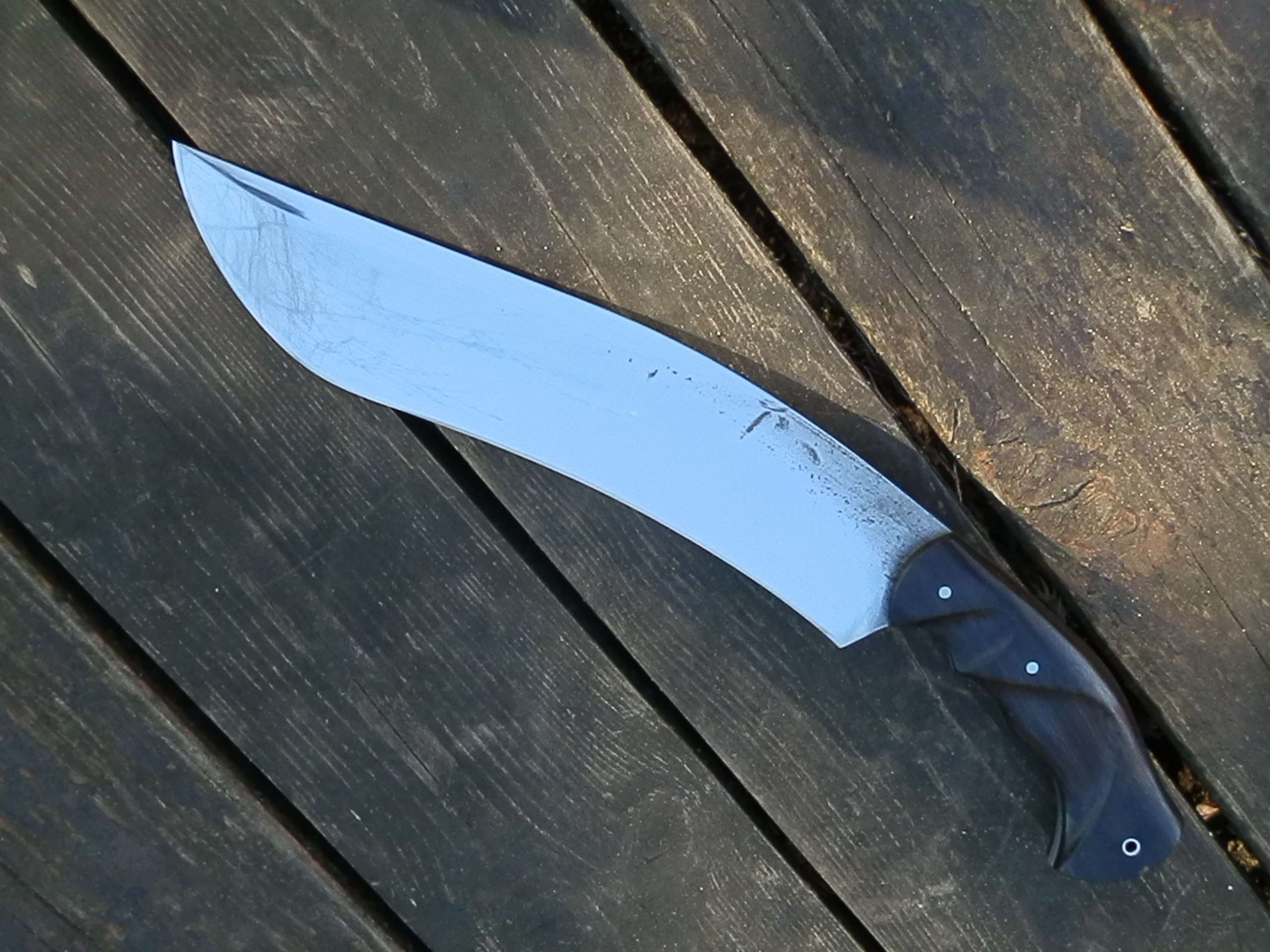

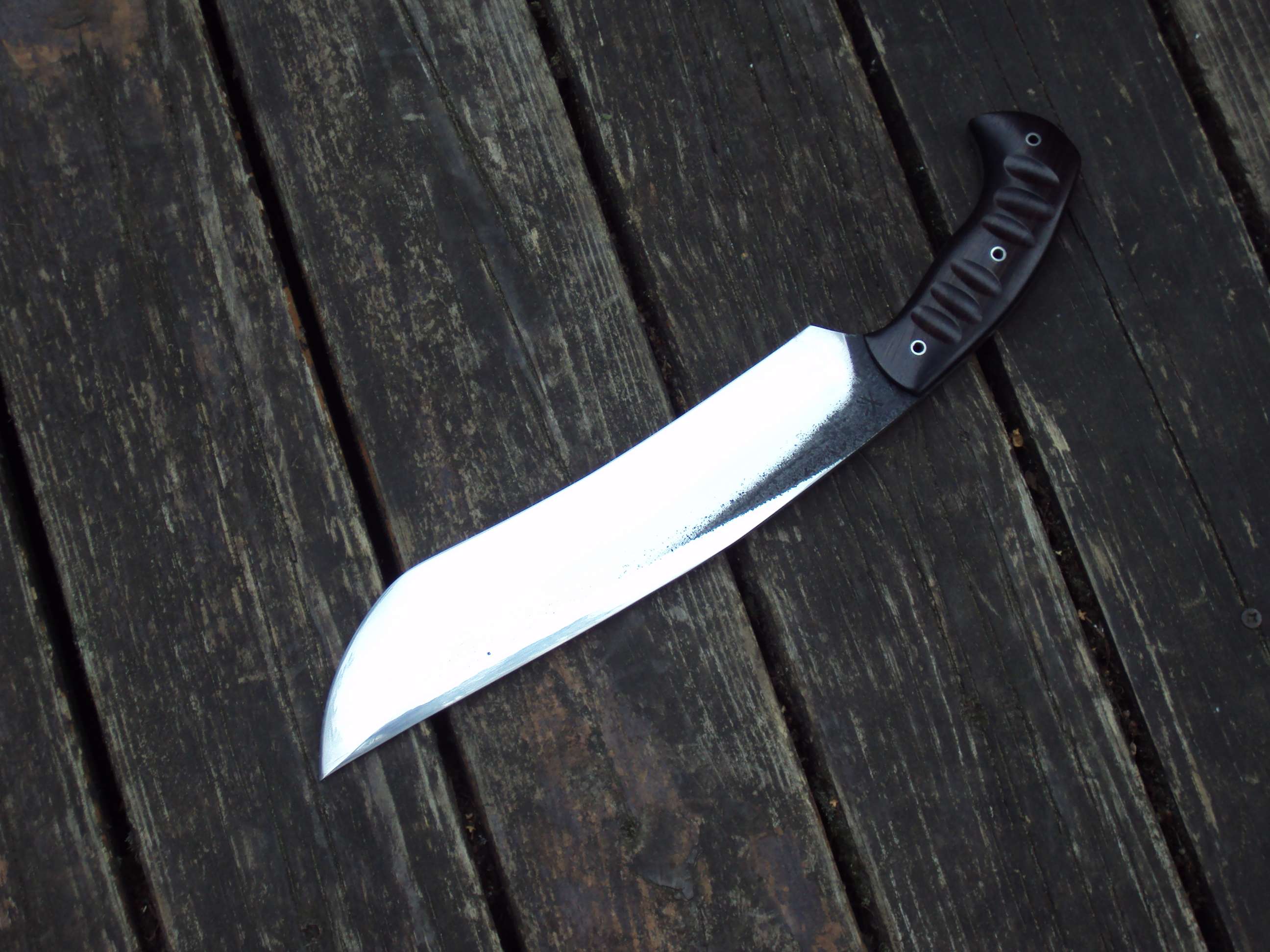

Hi.:)iwould like to show you my latest knife:
Overall lenght - 16in.
9 3/5 in of cutting edge.
Handle materials:rosewood, SS, and vulcanized fibre.
And a short movie:
http://youtu.be/6IwpUjiuqOM
Regards
Thanks:) After finish with 2000 water paper i keep the handle in linseed oil varnis bath for couple of hours. Then after it dries (day or two) I usually use carnauba wax paste.:)

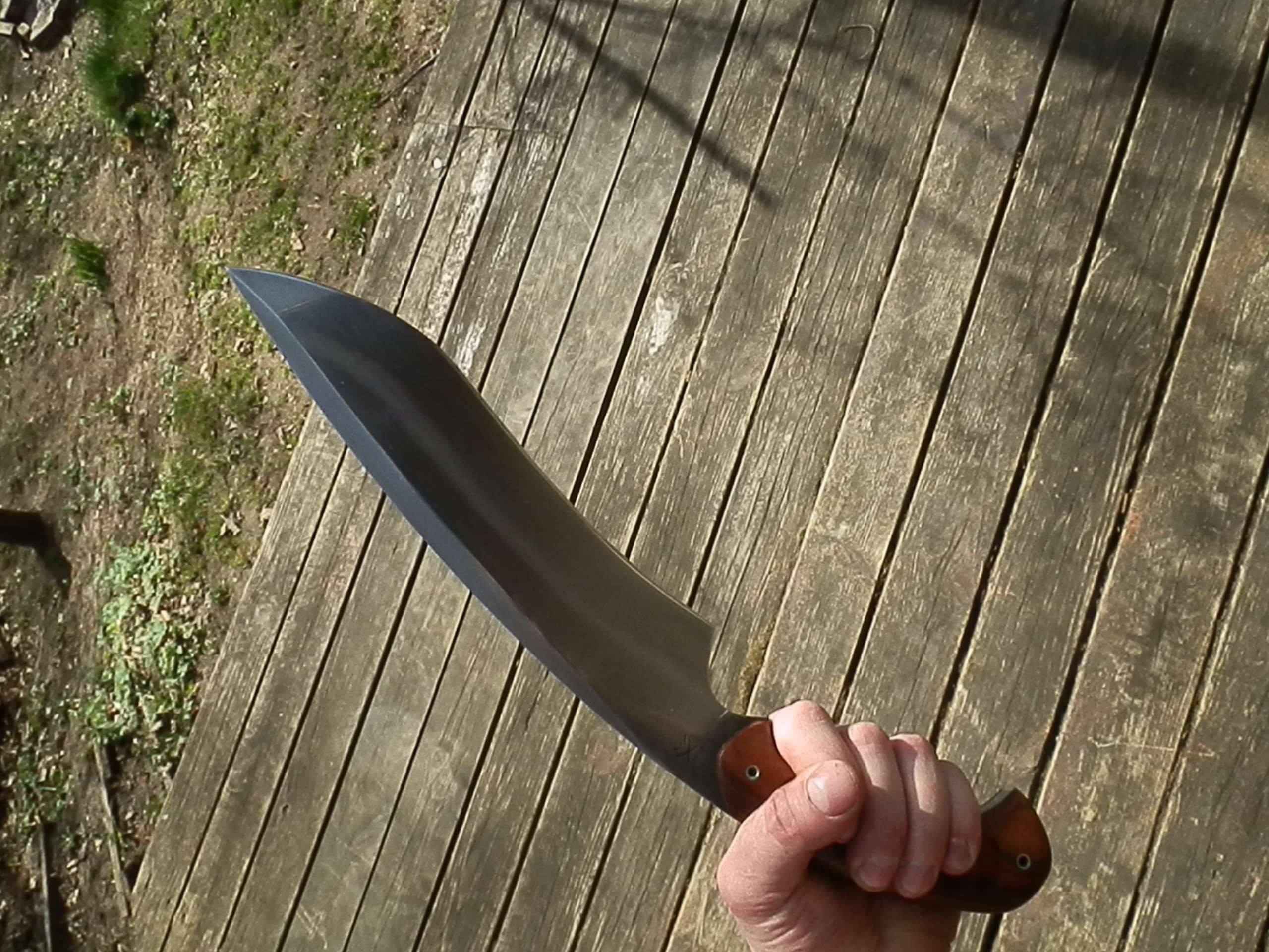

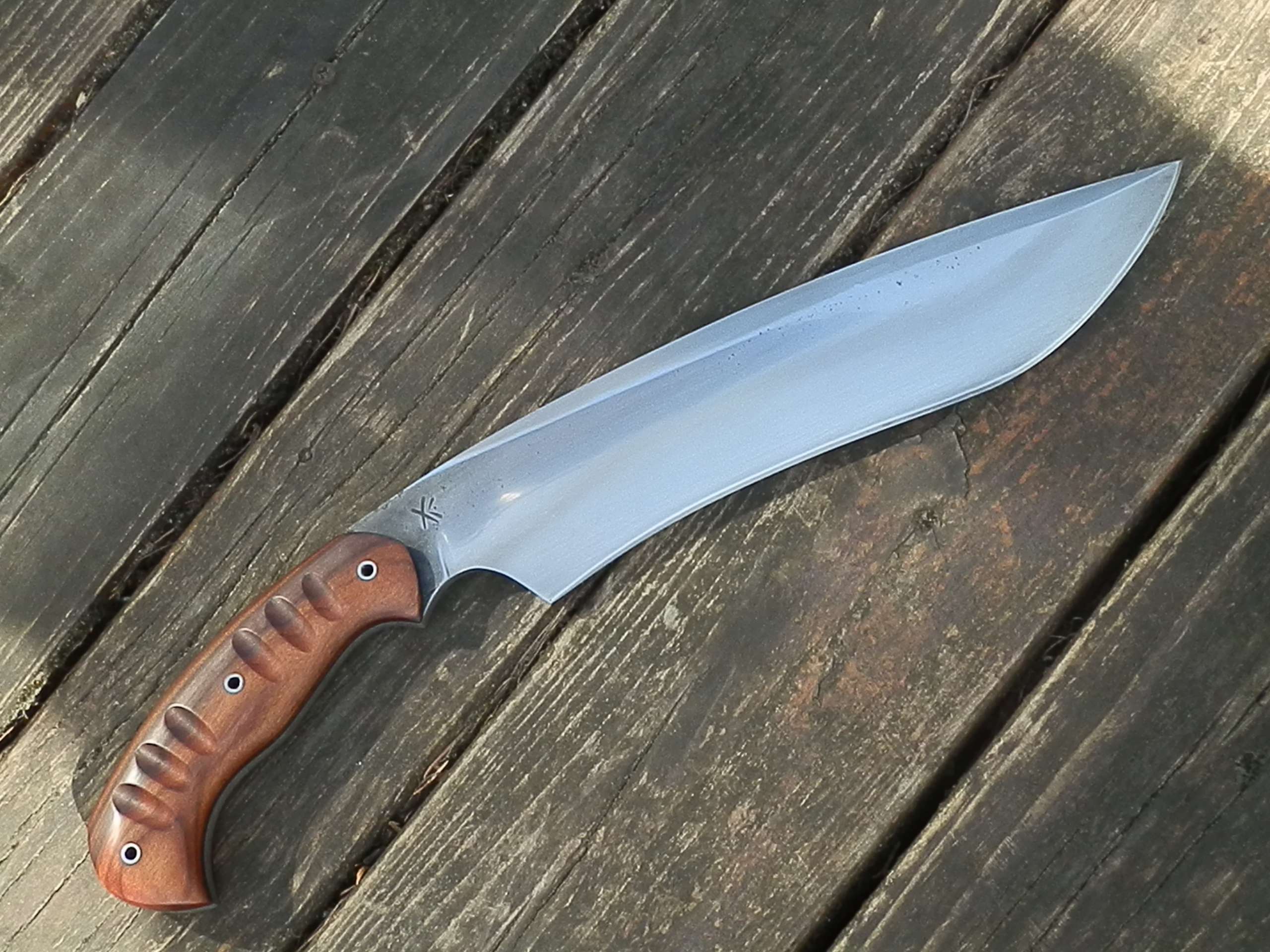

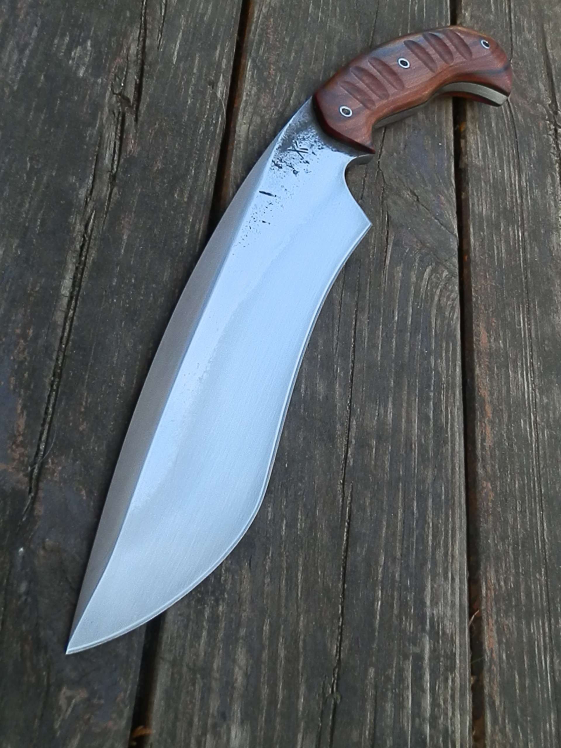

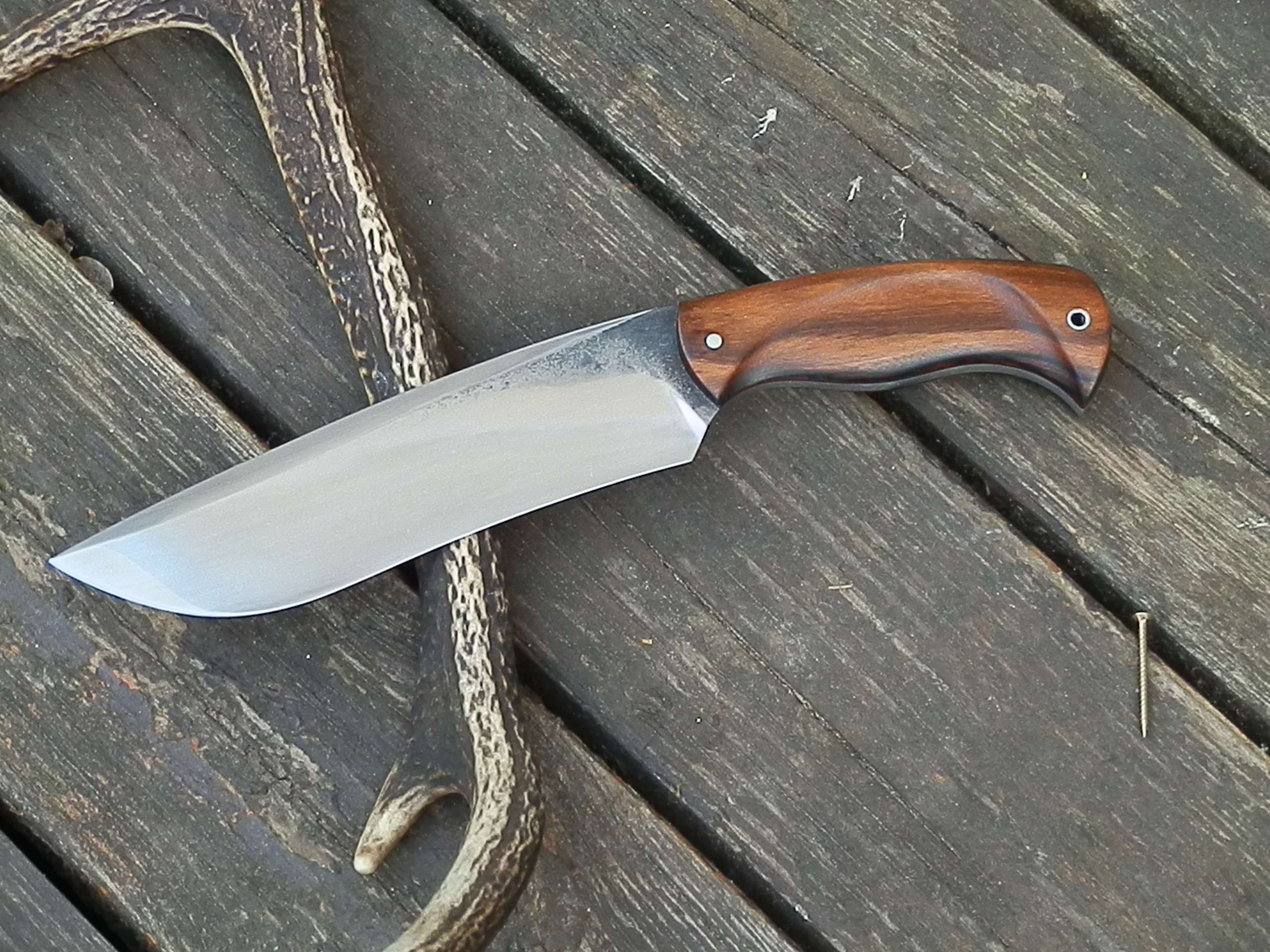

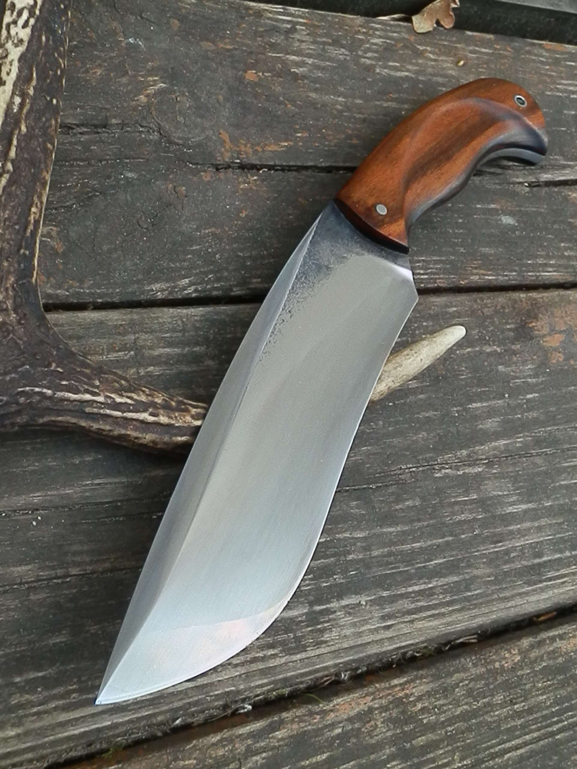

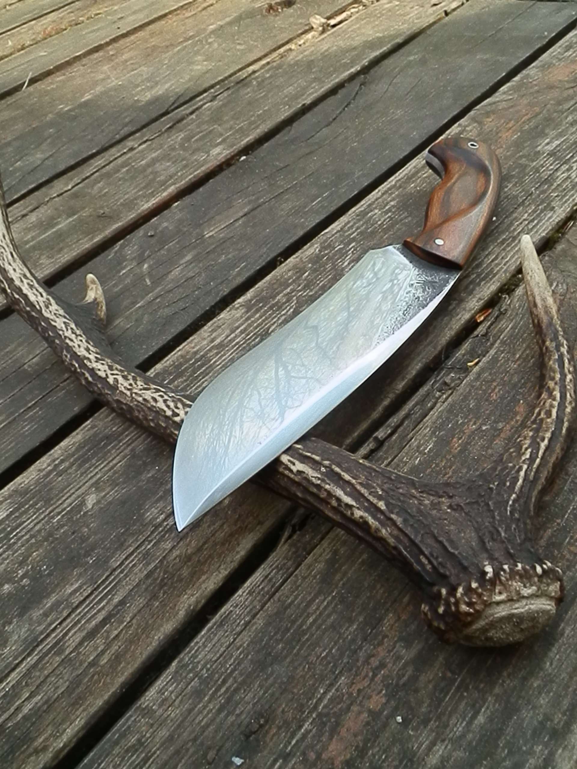

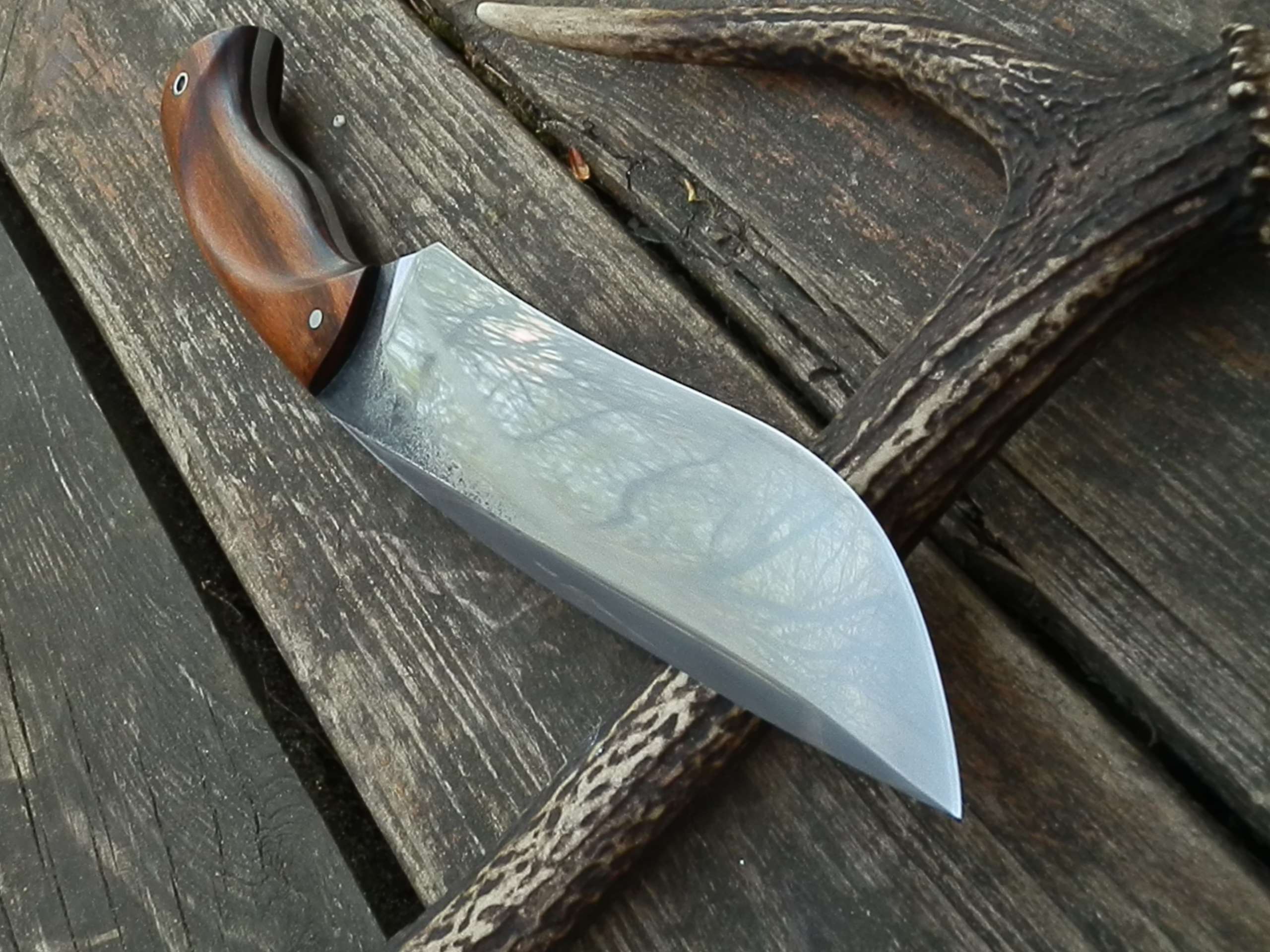

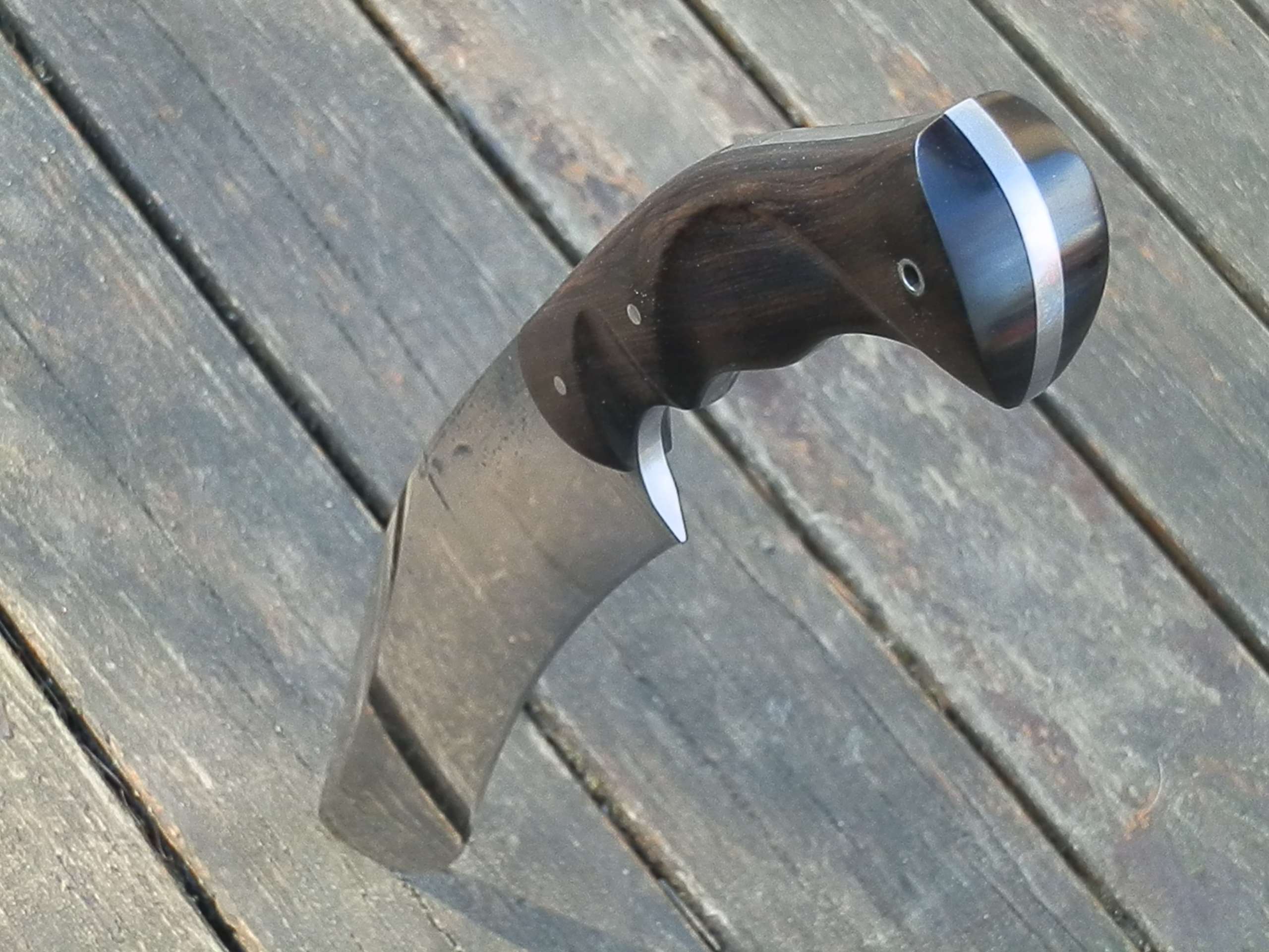

Hi

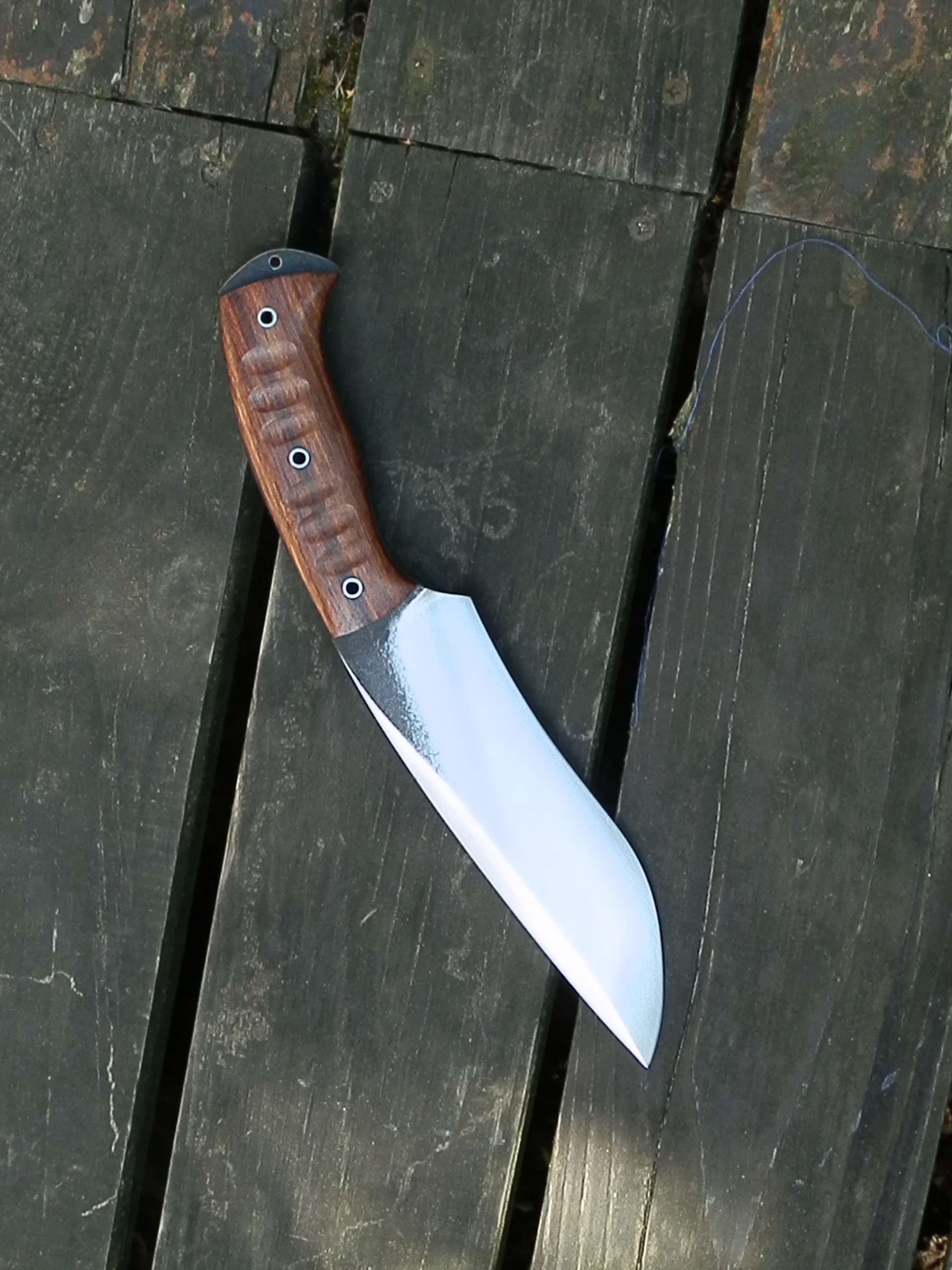

I've just finished smaller blade. About 6 1/2 in. of cutting edge. Rosewood handle with vulcanized fibre liners and SS pins.
Regards

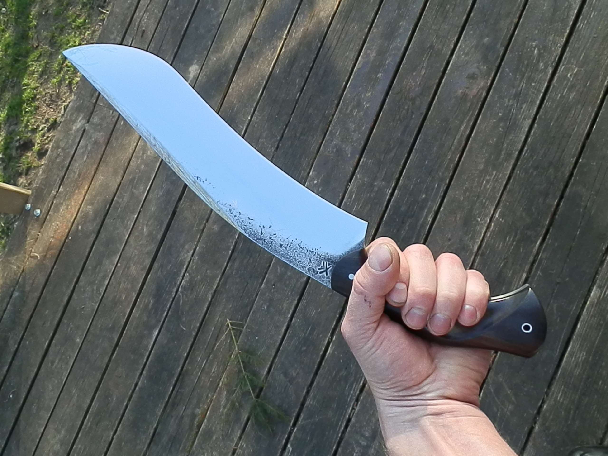

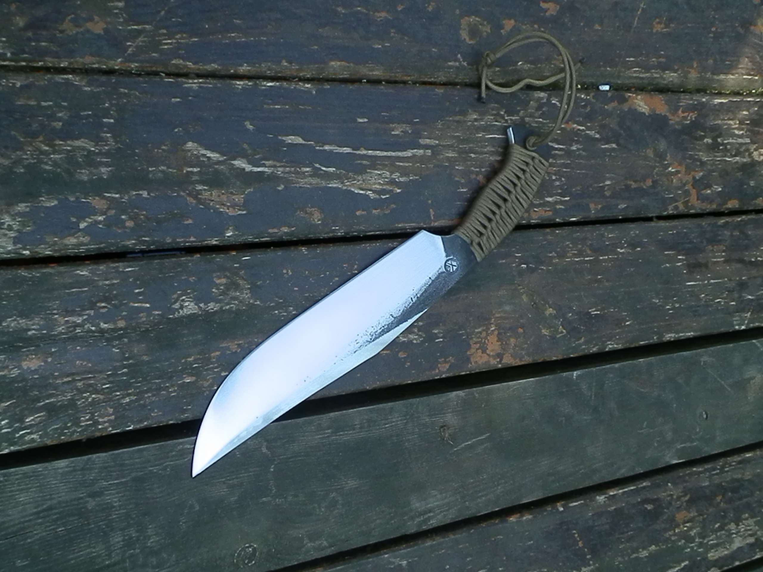

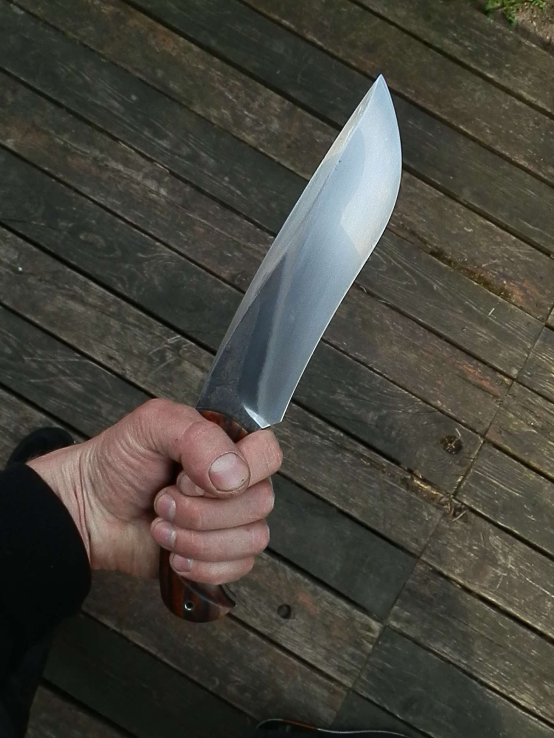

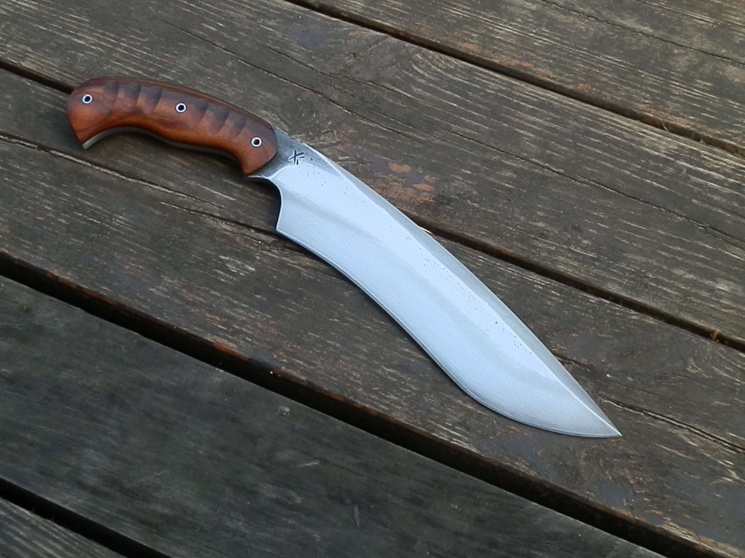

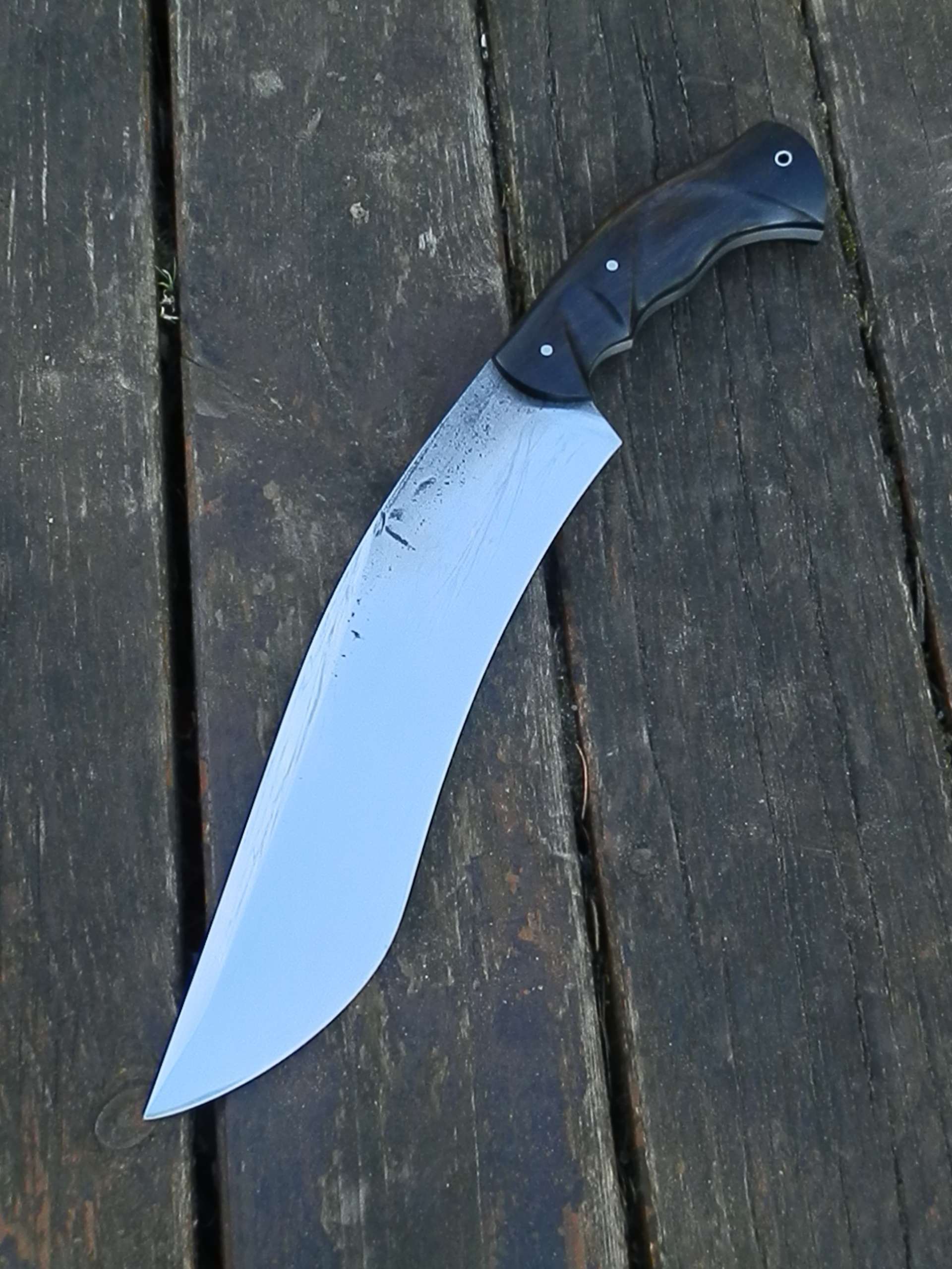

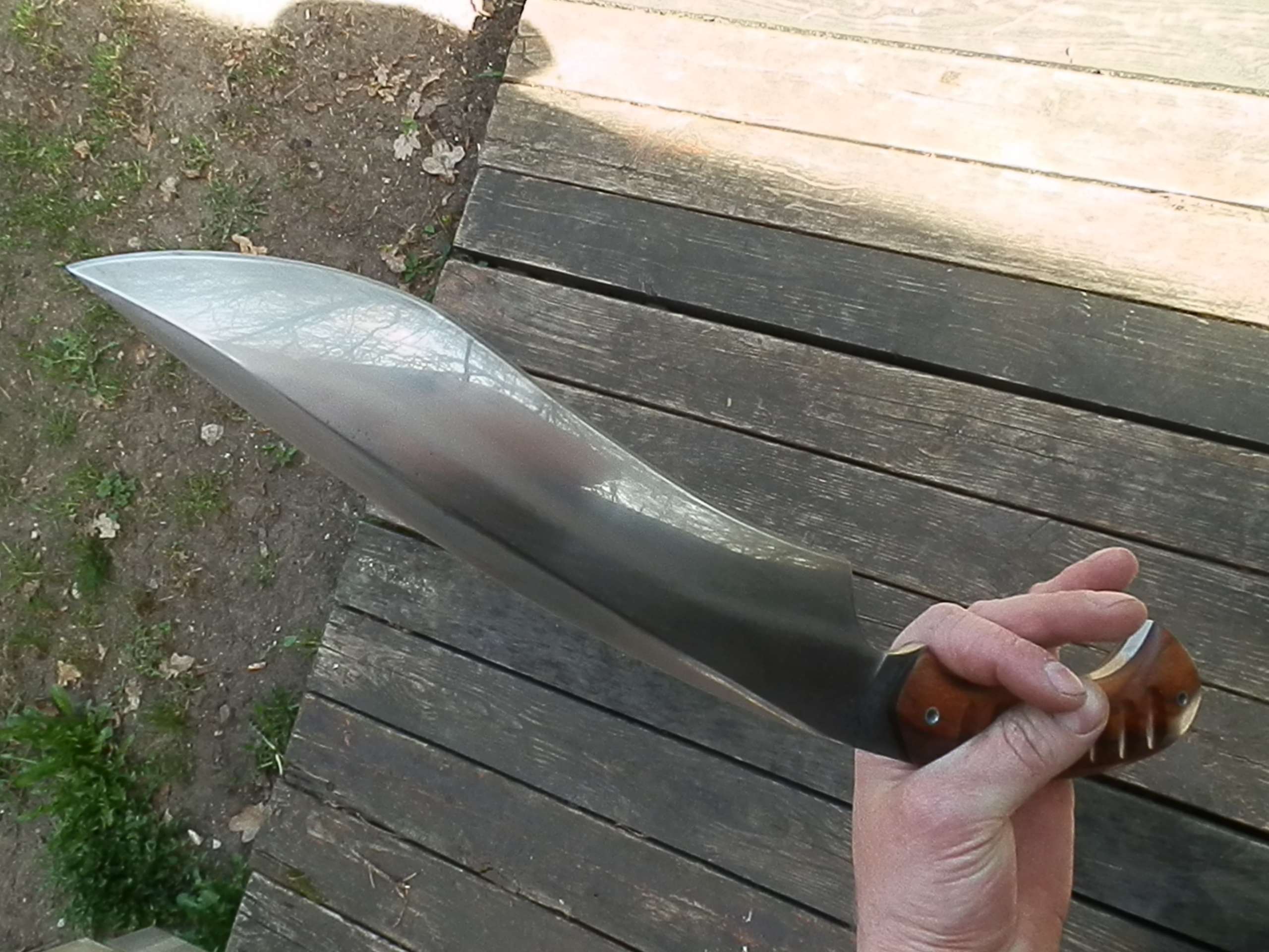

Hi guys. I have two big stacked leather handled knives on my bench and they were first in order to finish but since i've been waiting 3 weeks for the stainless steel for guards and pommels i used this time to finish few less complicated projects.
Two small ones

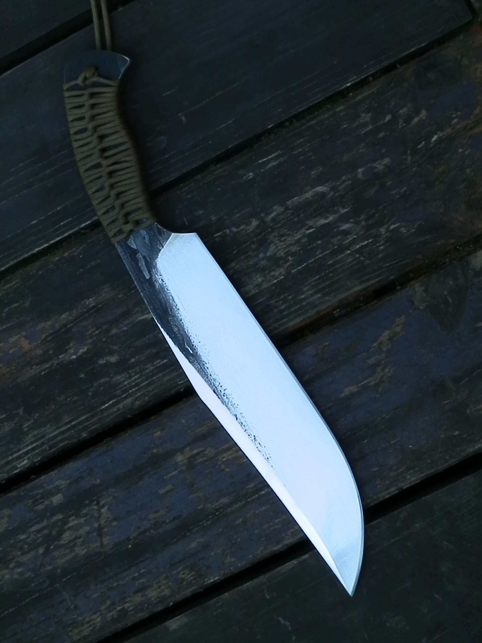

This next one was for me and ive changed the handle from paracord wrap to rubber:)

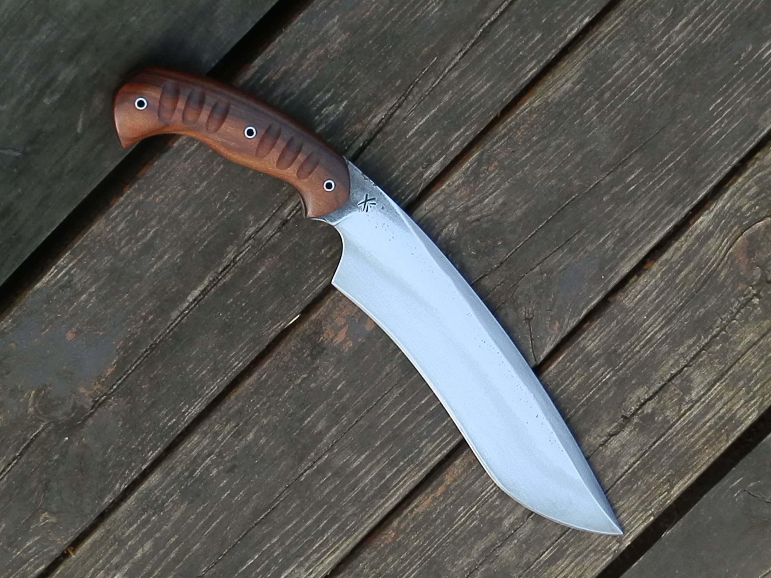

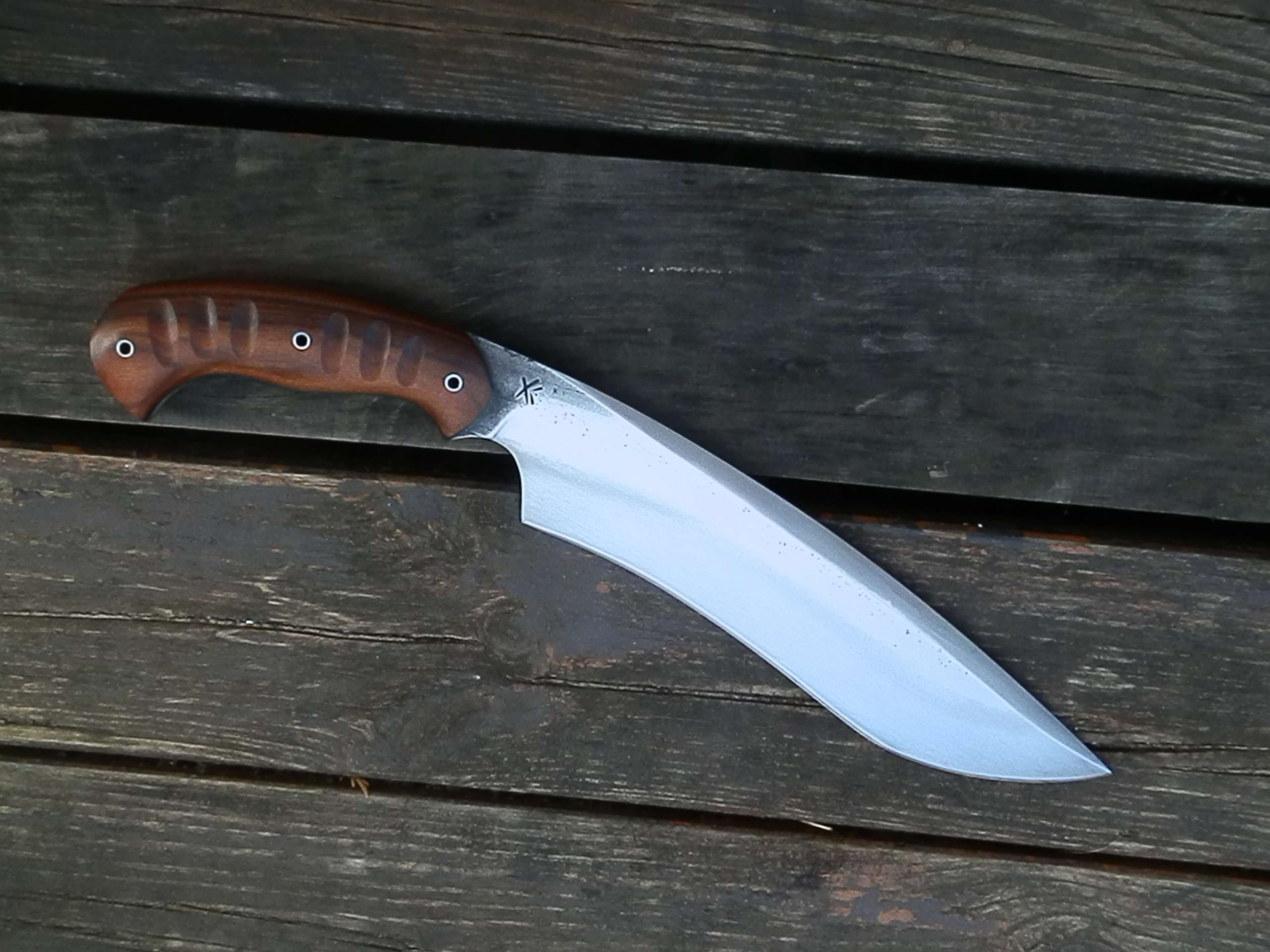

And a simple chopper 10,5 '' of cutting edge
Regards
Thanks:) it is about 6 1/2'' of cutting edge and 11 1/2'' overall.
