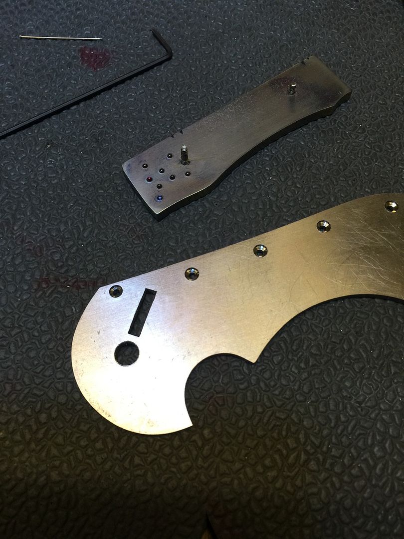

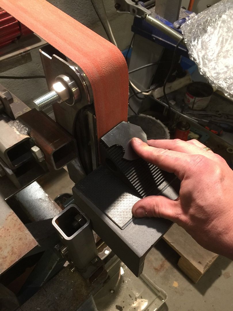

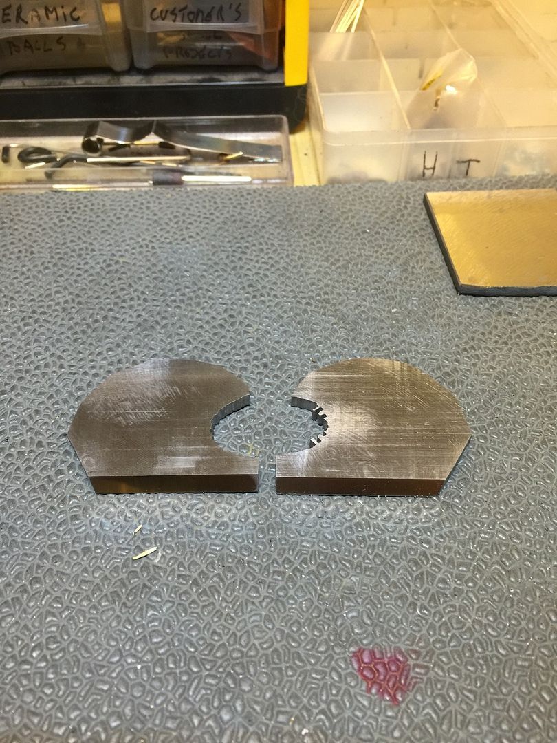

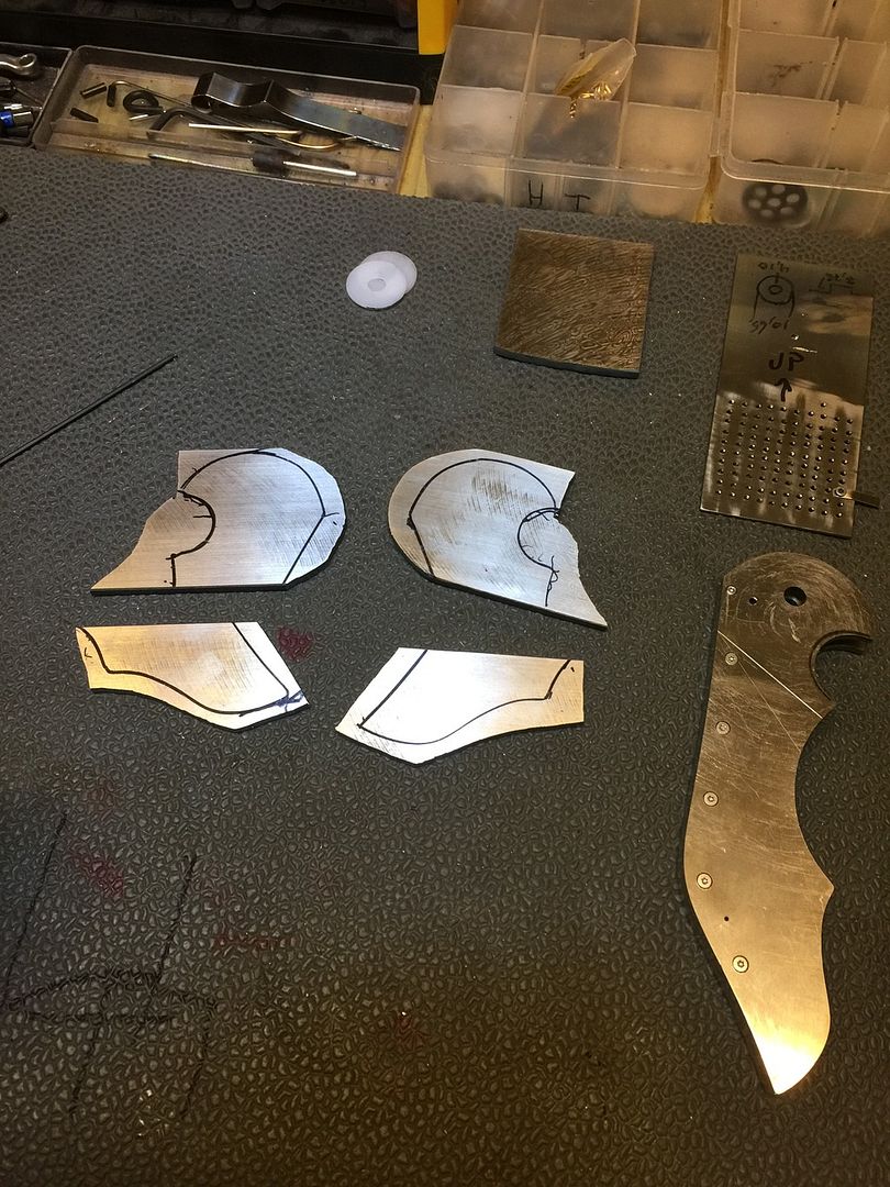

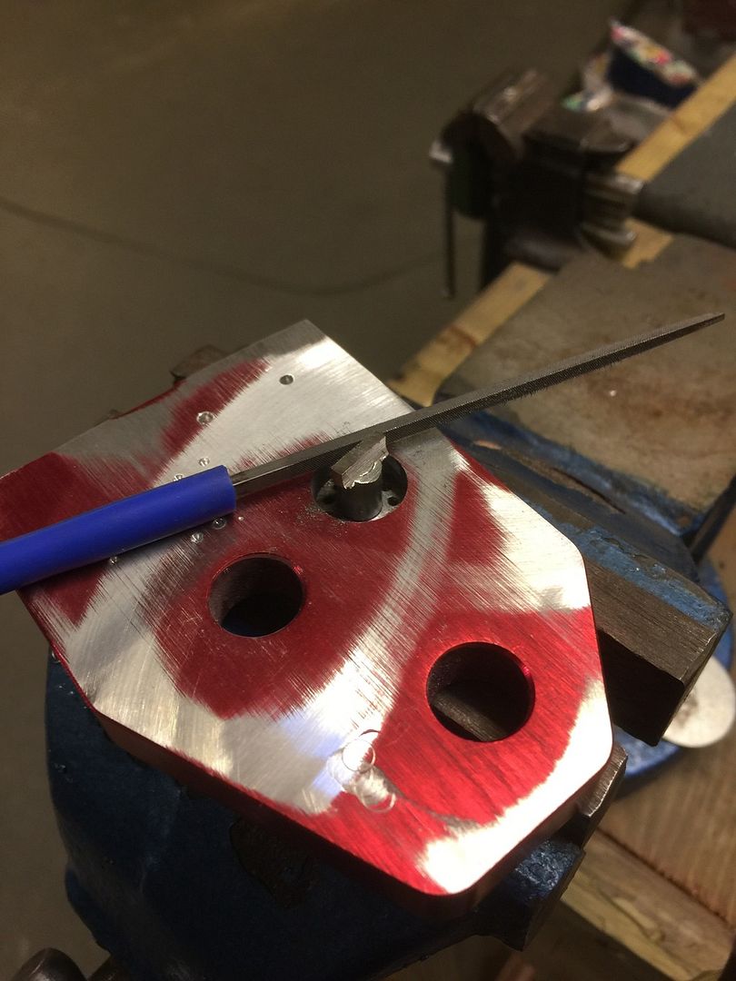

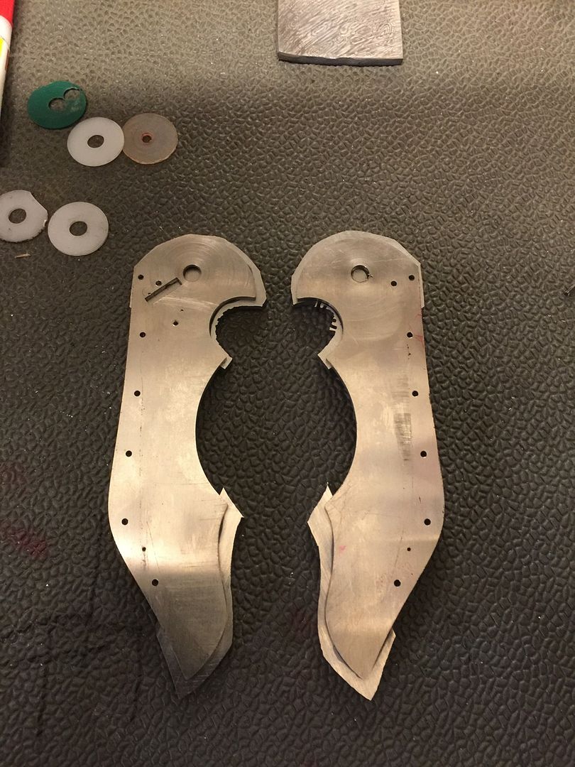

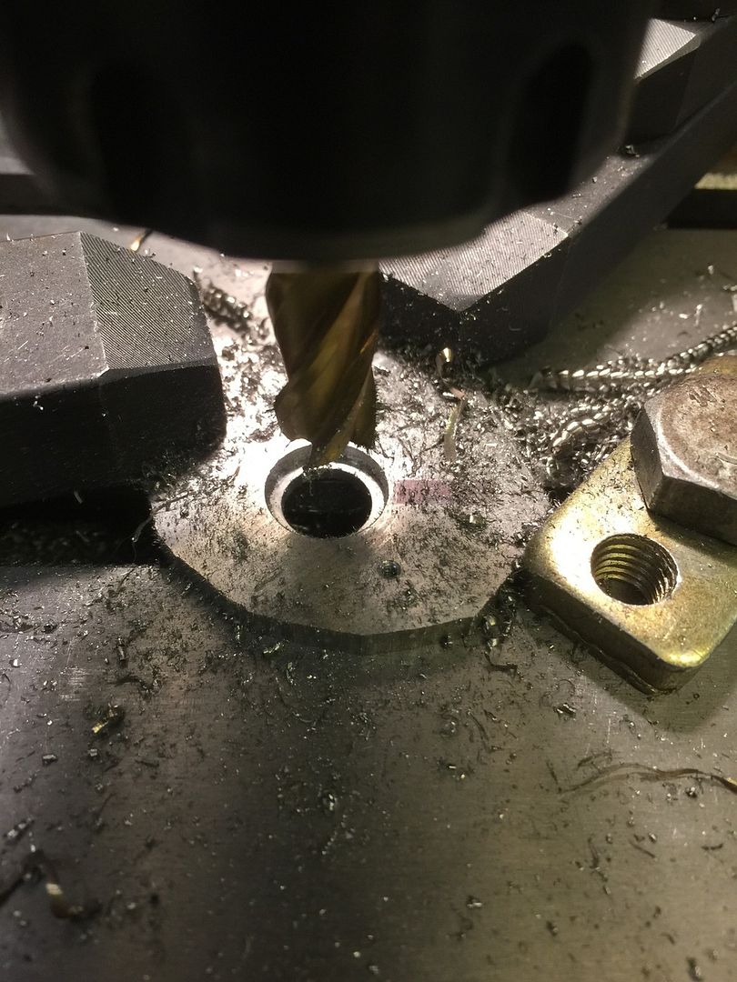

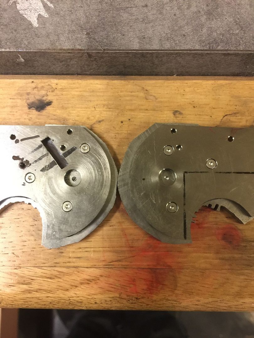

all materials have been sanded flat on 1" glass platter and are ready for first mechanical task, drill the undersized holes for liners and spine material.
done holes
splitter from the superglue

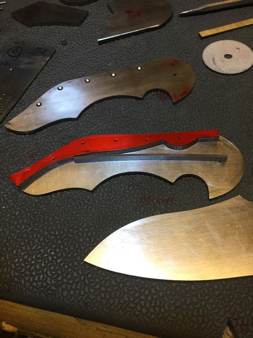

now I can do final profiling on blade i open and locked position, earlier the better. and this knife will have a lot mechanics so I have to be sure to have room where needed.

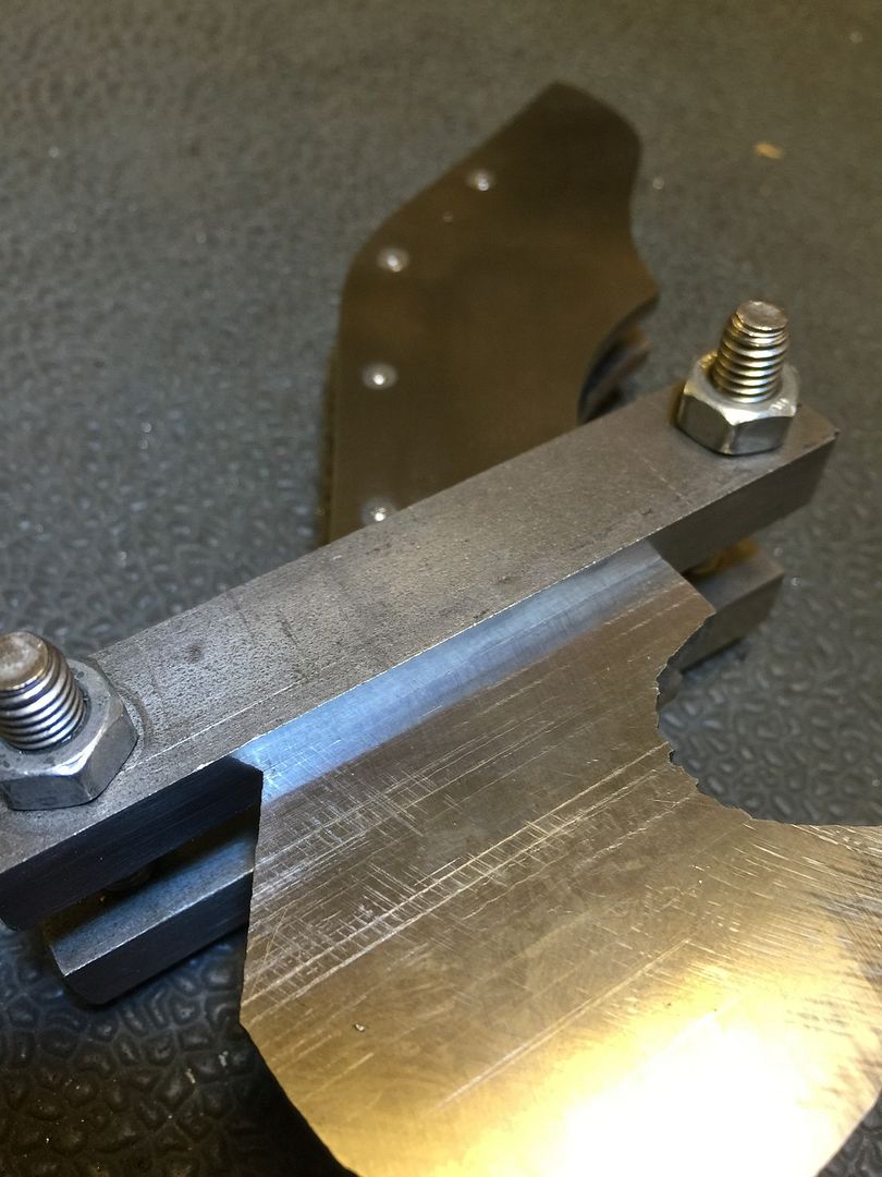

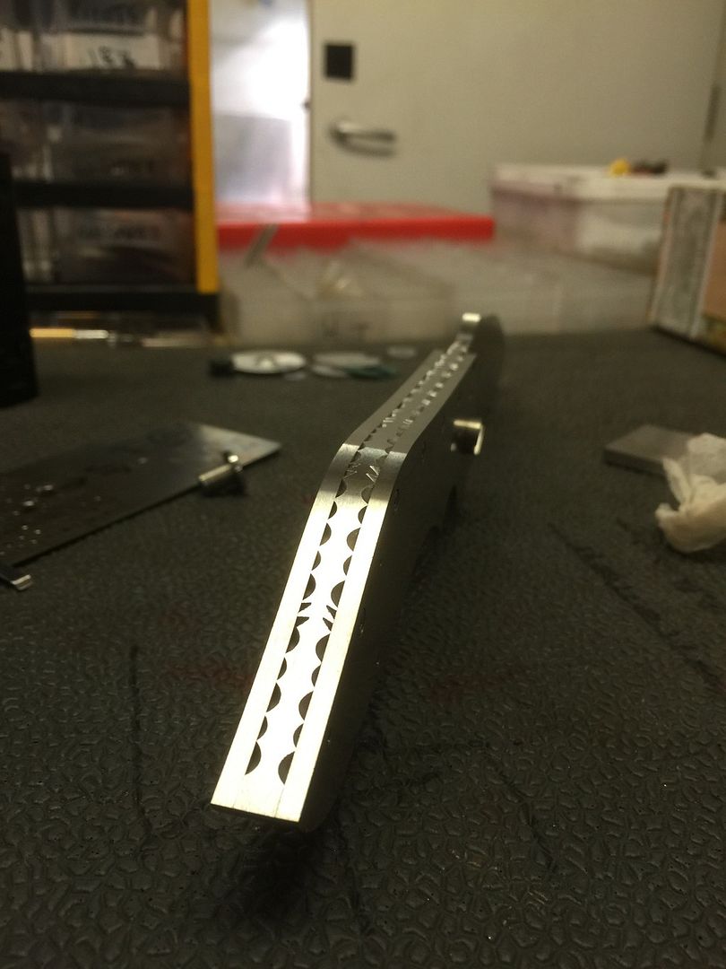

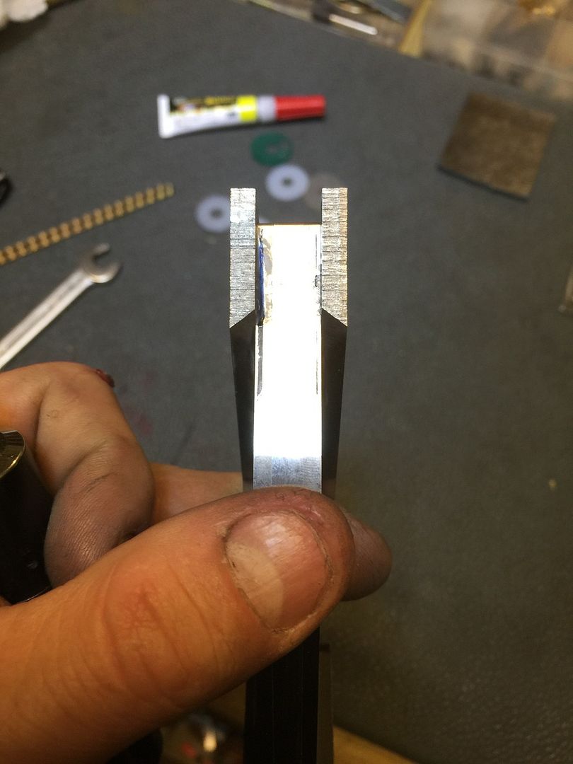

Cutting the spine

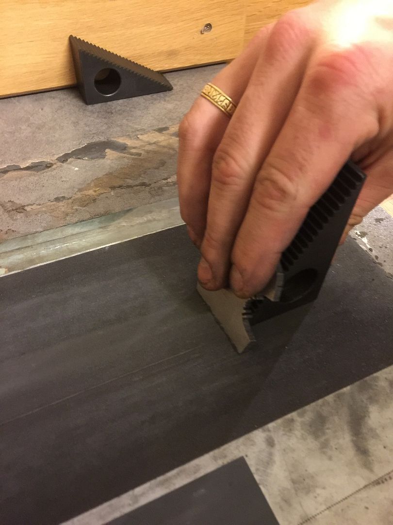

Flat sanding the spine end for blade to stop
Possible to get best result even without surface grinders or mill. Glass board and some patience do the job

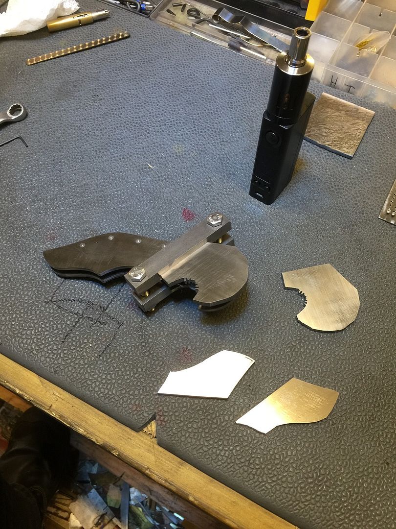

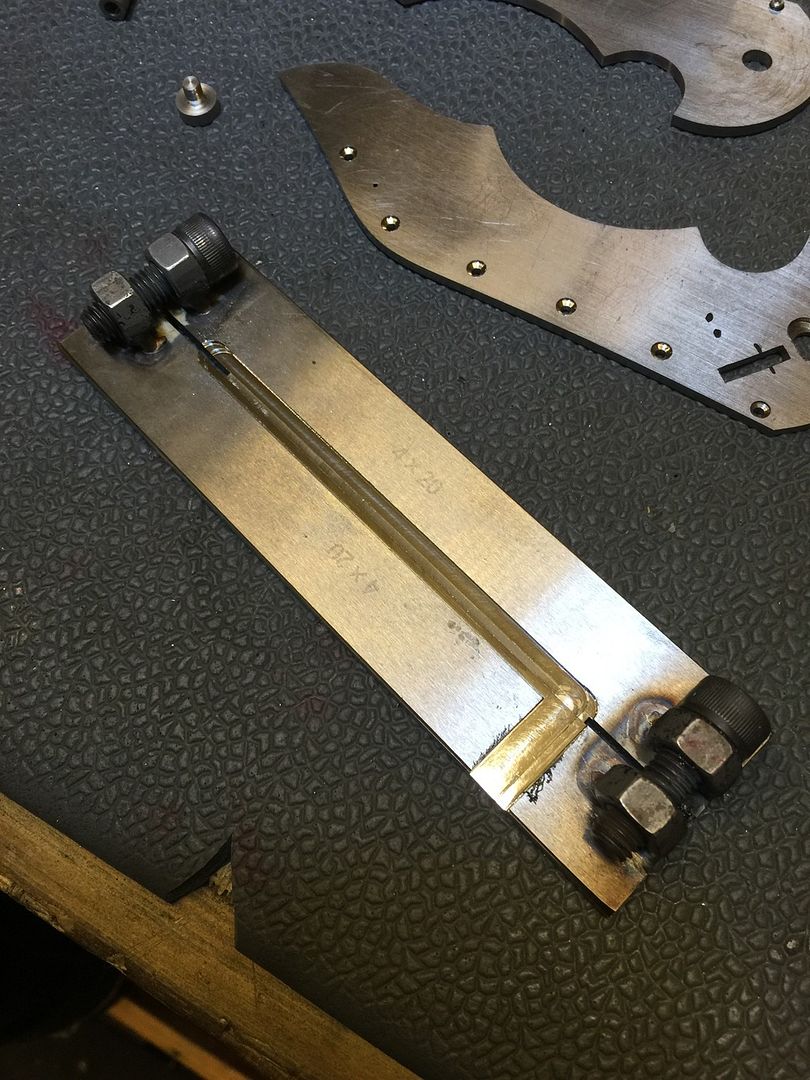

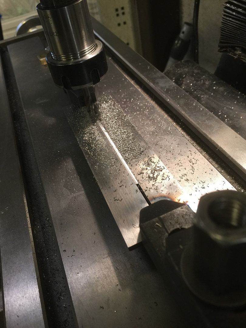

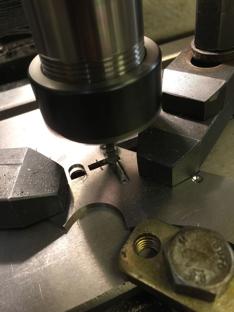

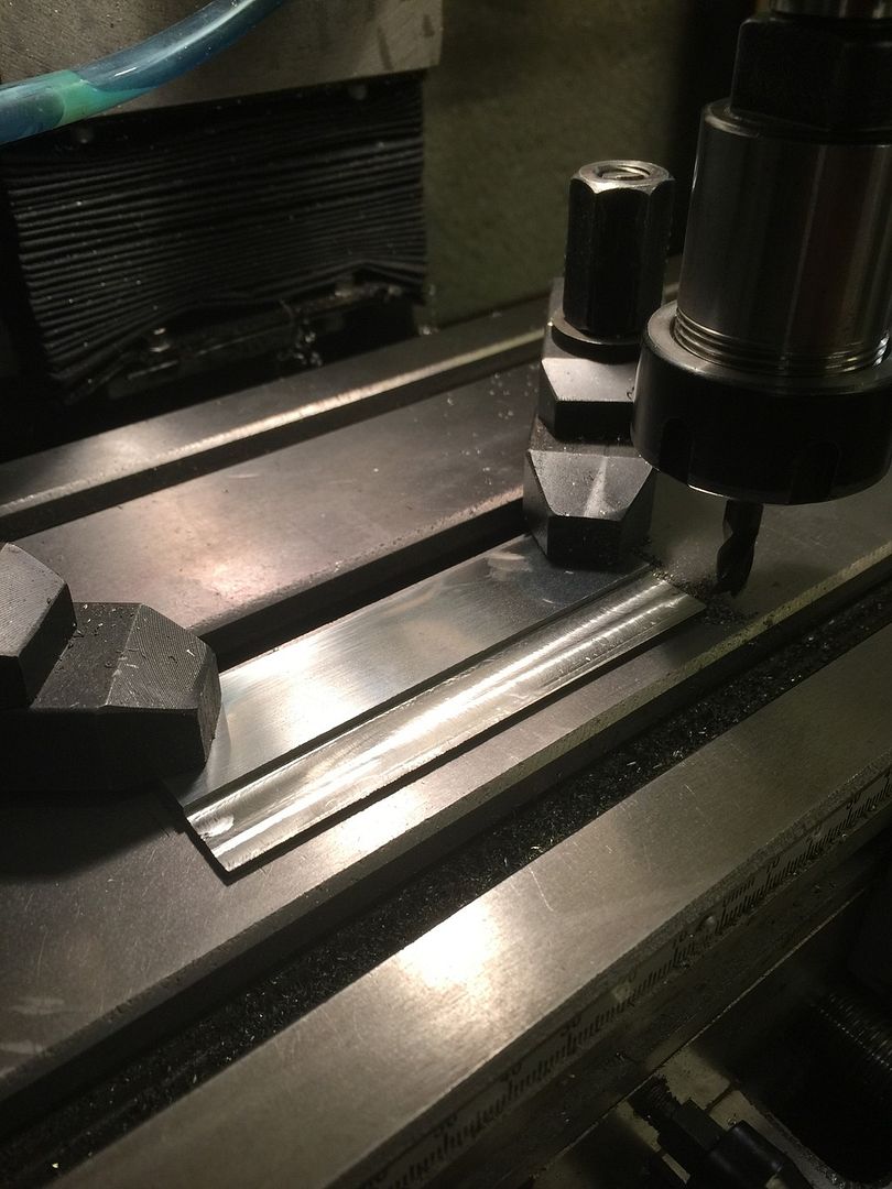

Milling the spring material to right thickness
Then I use my special fixture to mill the width so it fits nice in the handle.

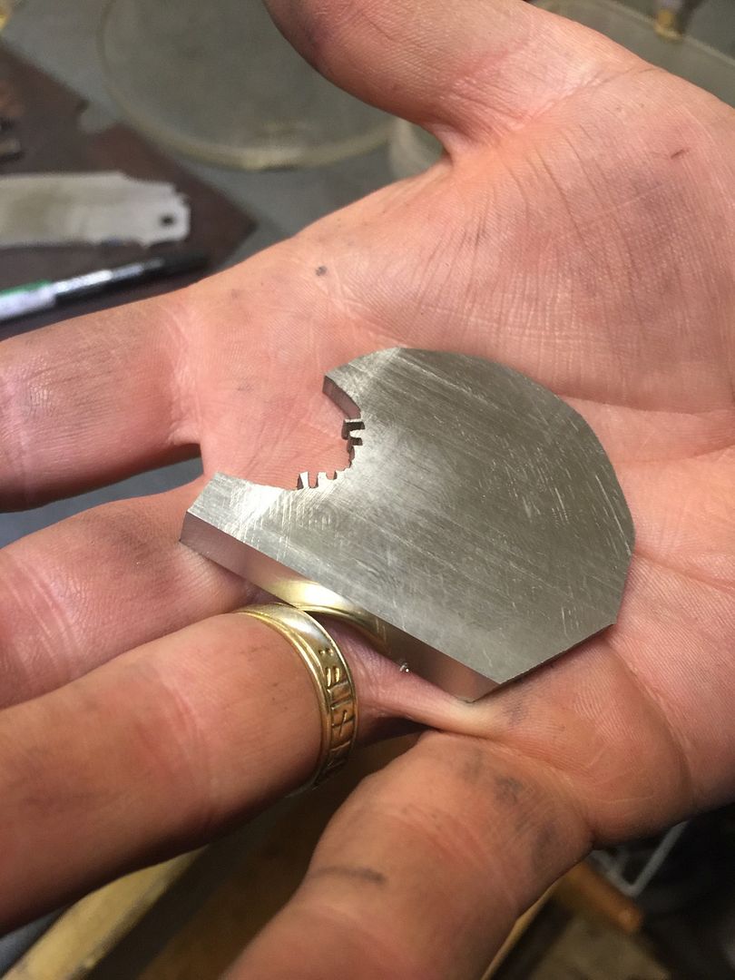

Spring is ready for location and heat treat

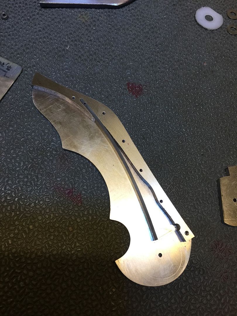

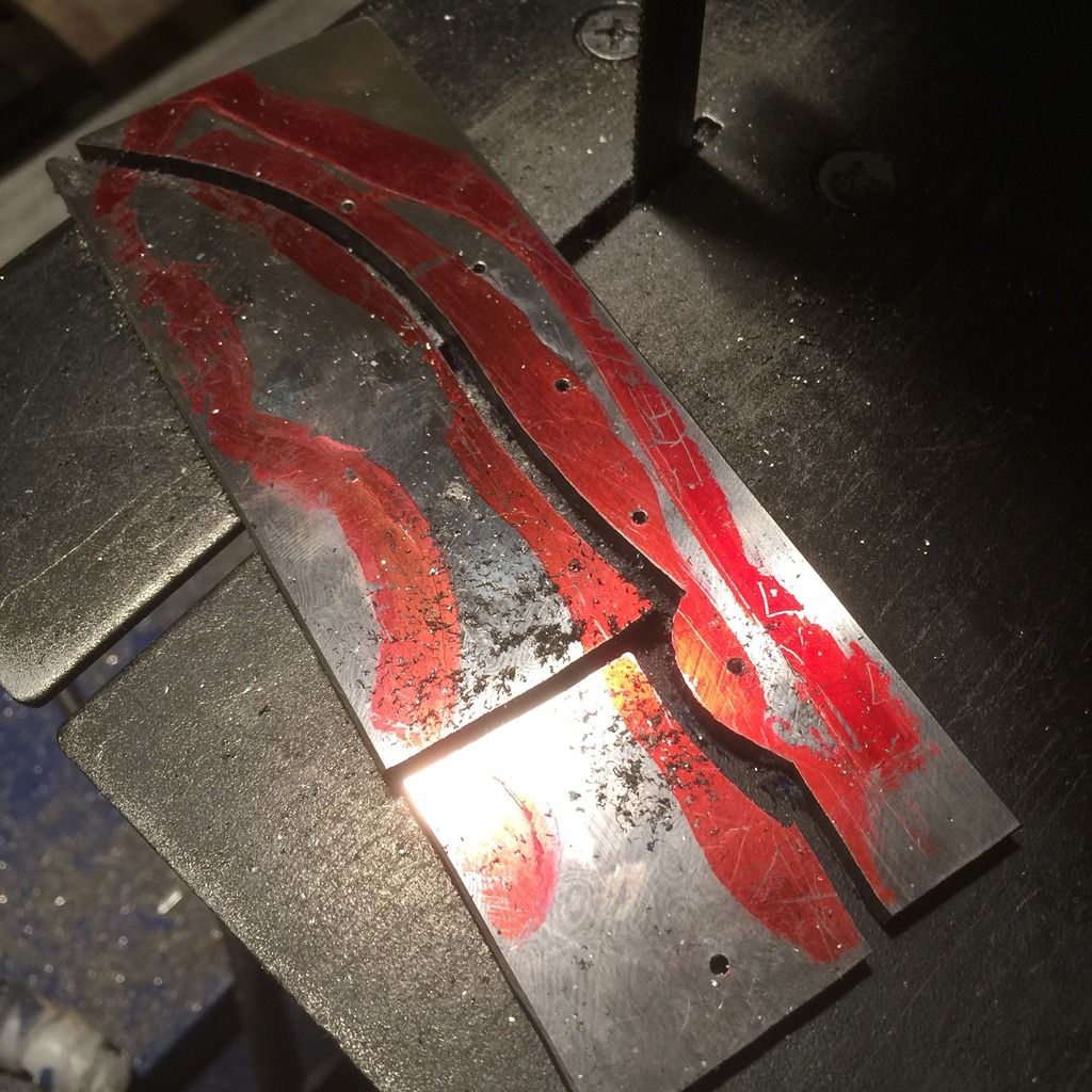

Raw cut from bandsaw, fits snuggely

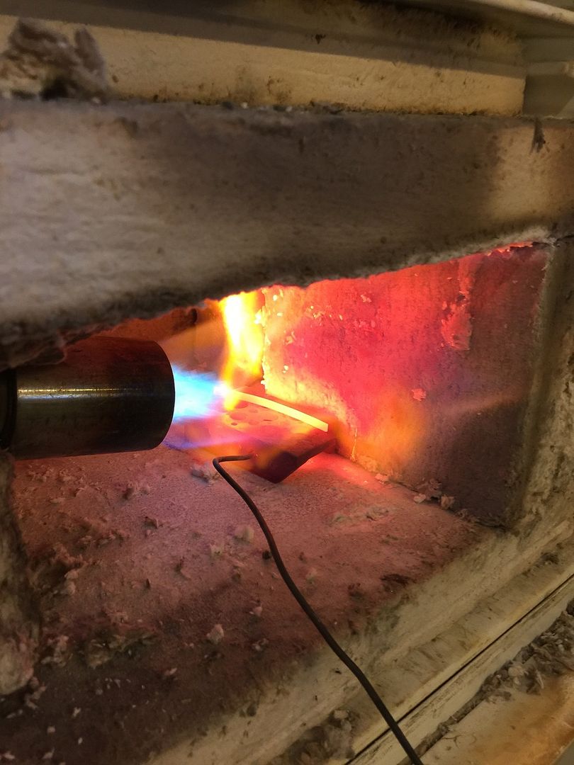

Heat treat the spring 2 cycles at 900 celcius 1 cycle of temper, rwl34 makes a good spring on this process.

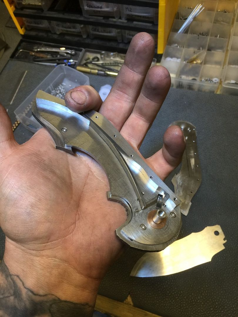

Spring in place

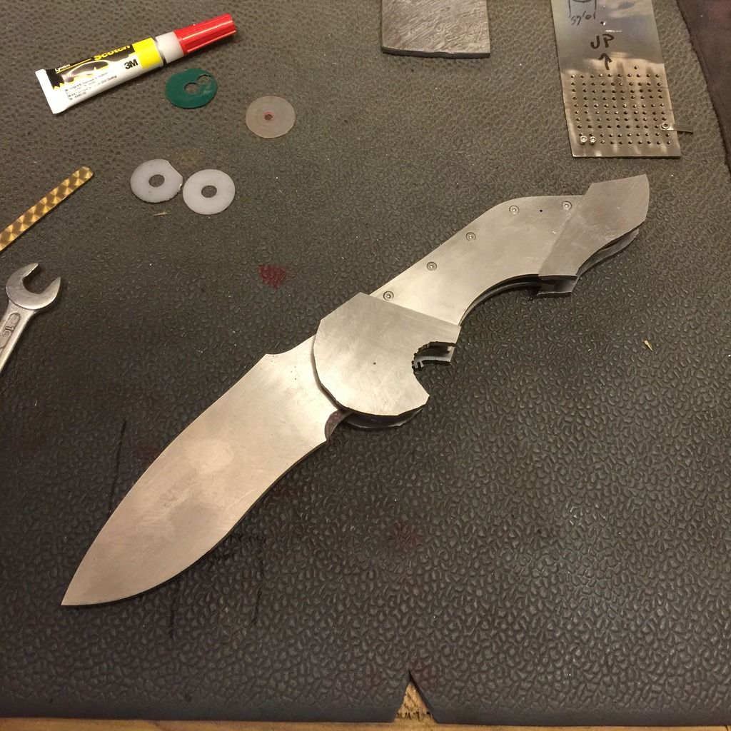

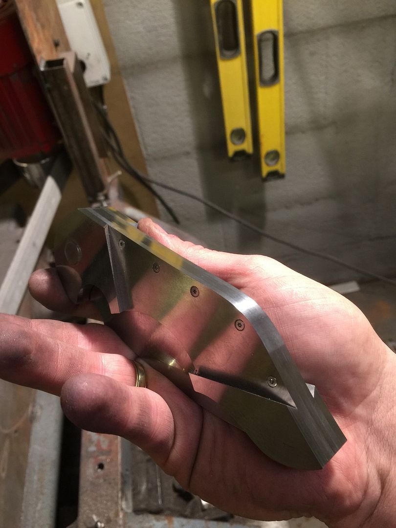

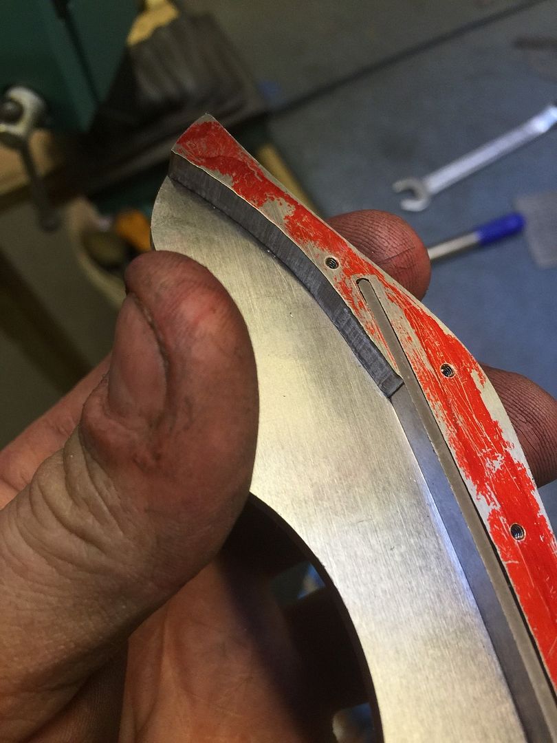

Blade roughly adapted to location, missing some parts so final location is on hold.

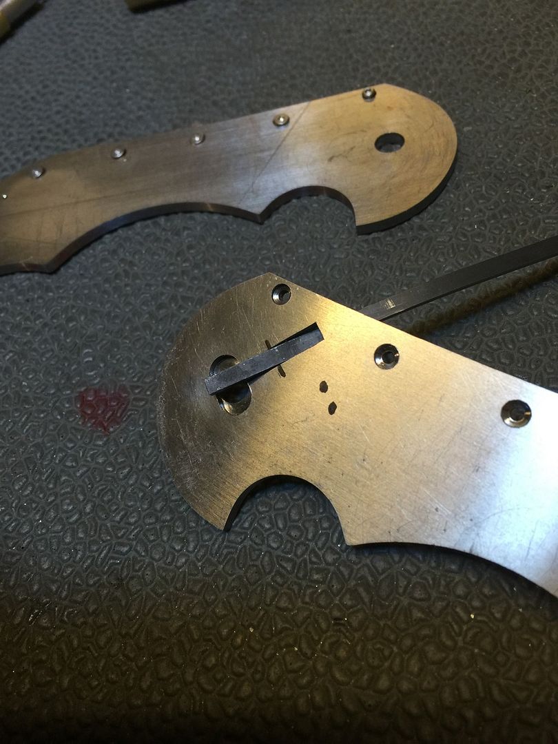

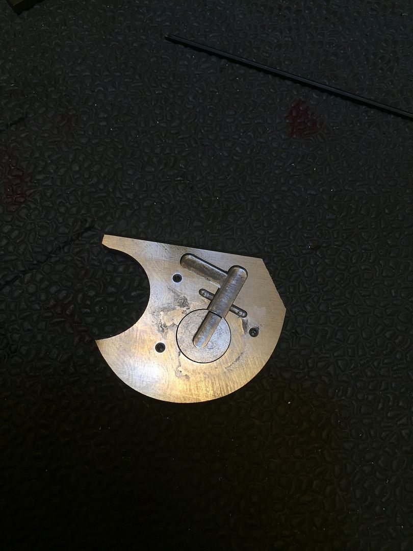

Slot finished for next part.

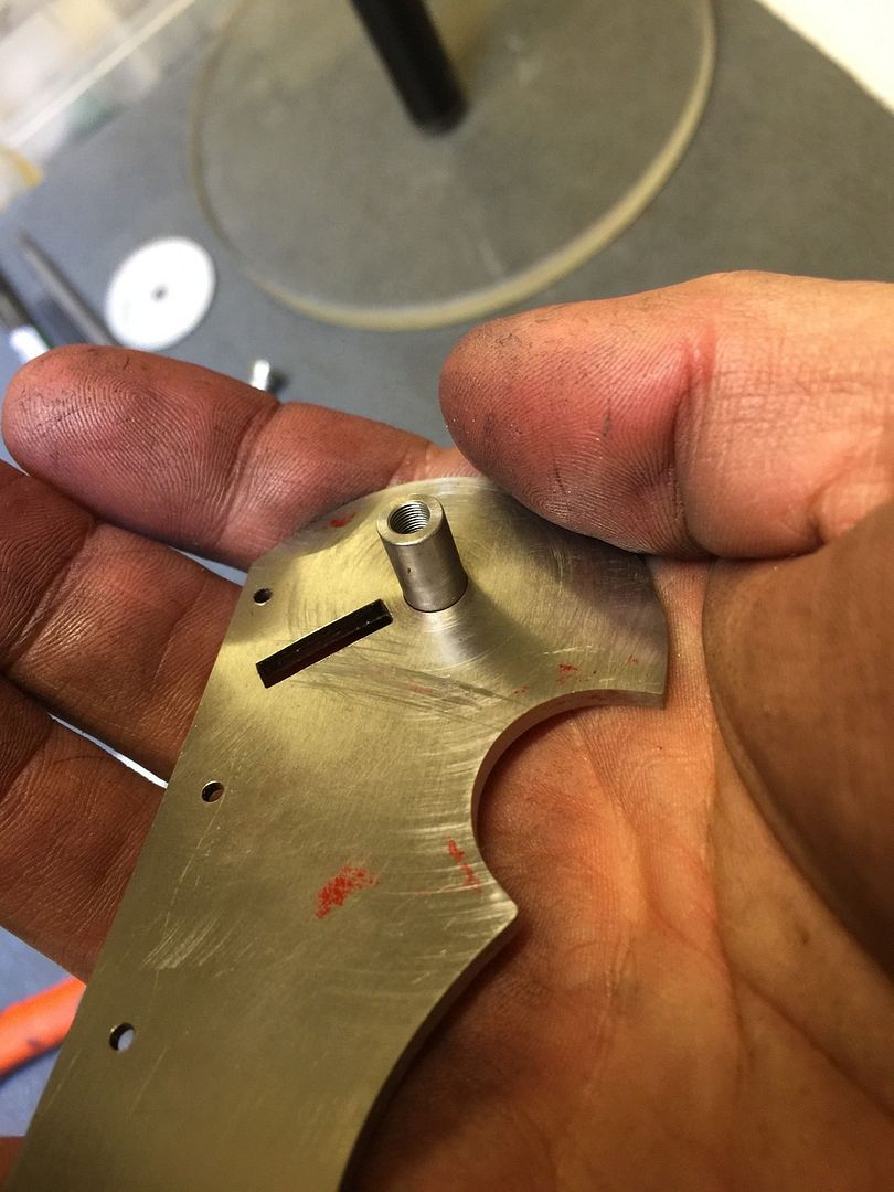

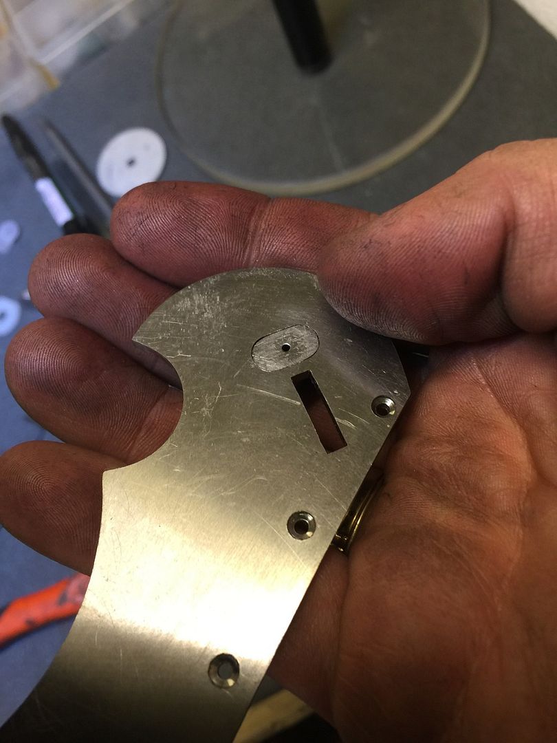

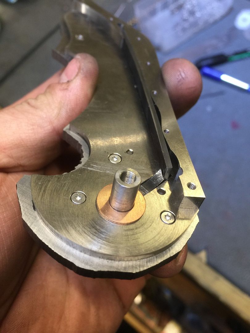

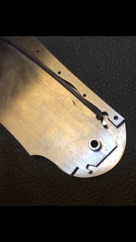

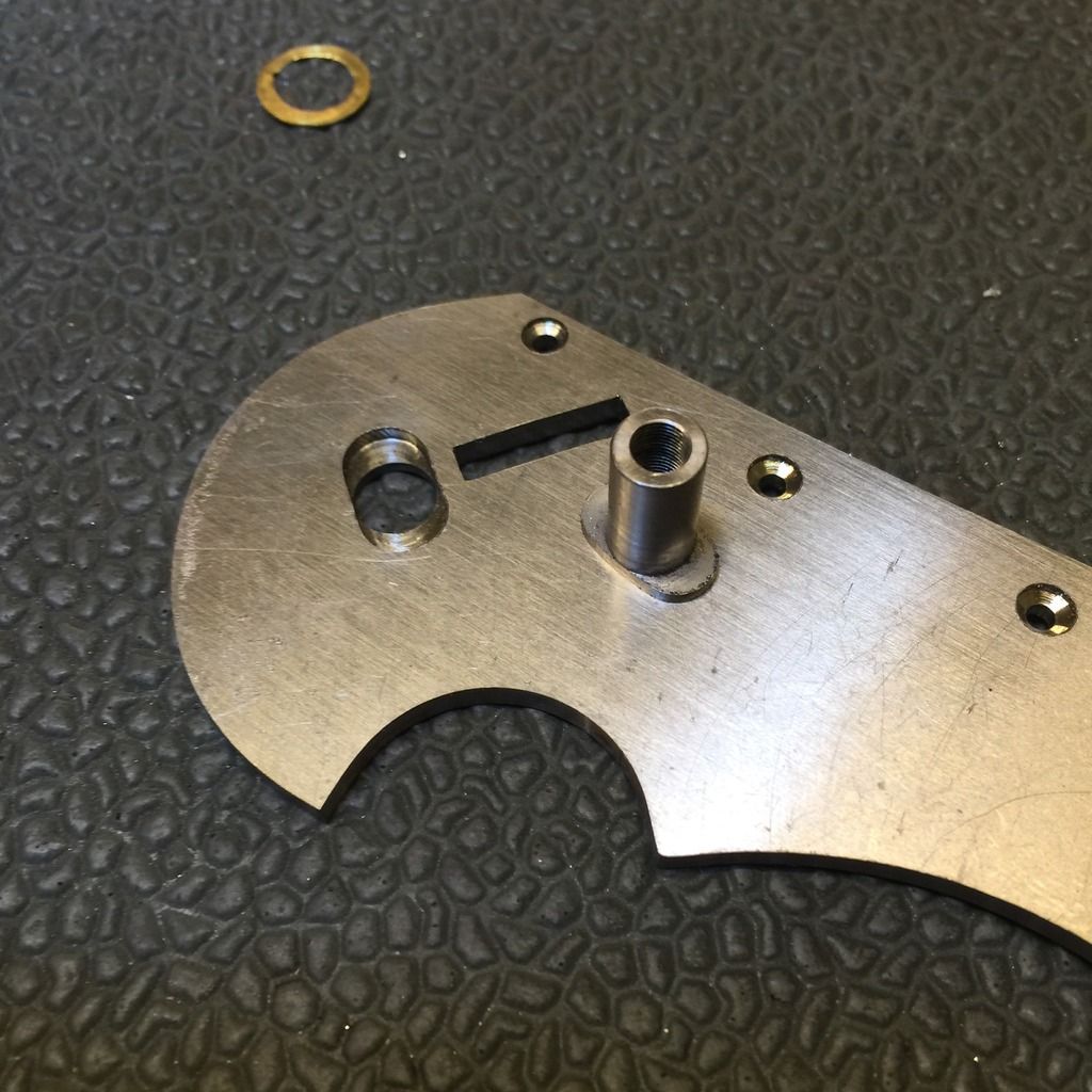

Pivot is ready from this side, more job on the other liner
Pivot pushed in place, secured to keep it from rotating

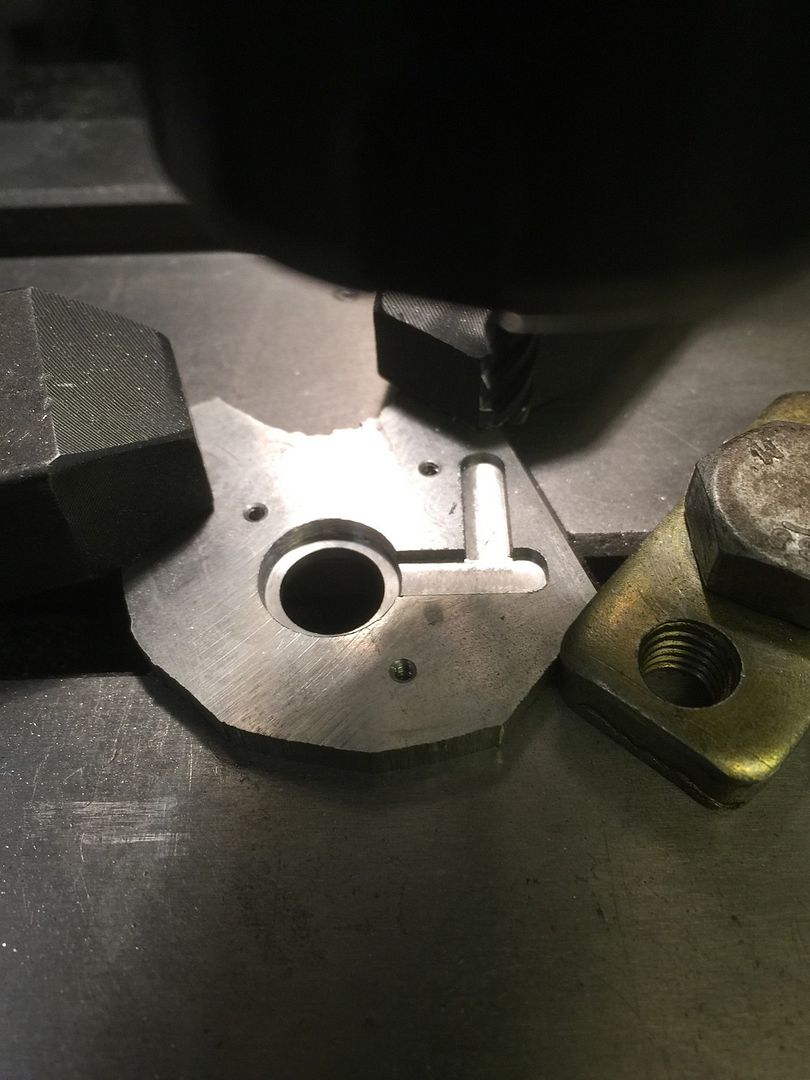

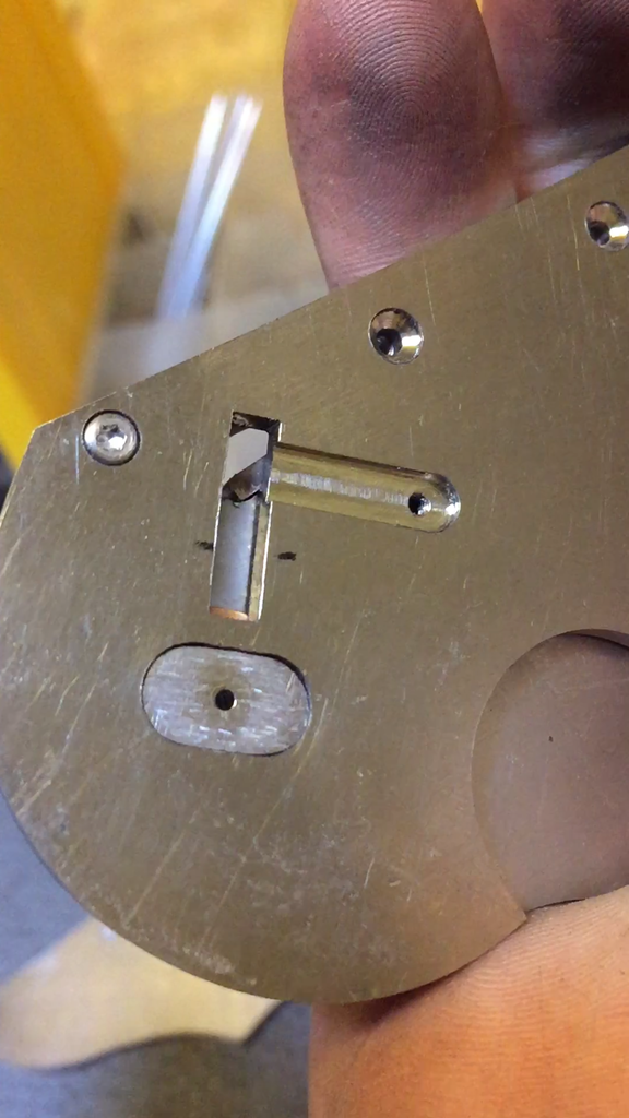

Milling down another part for the lock system
Adjusting the spring for the hidden button
A lot of geometry goes into this build and mechanics
I set my mill for repeatable operations, I believe in take things slowly and steady. One more time than ruin it on first try.

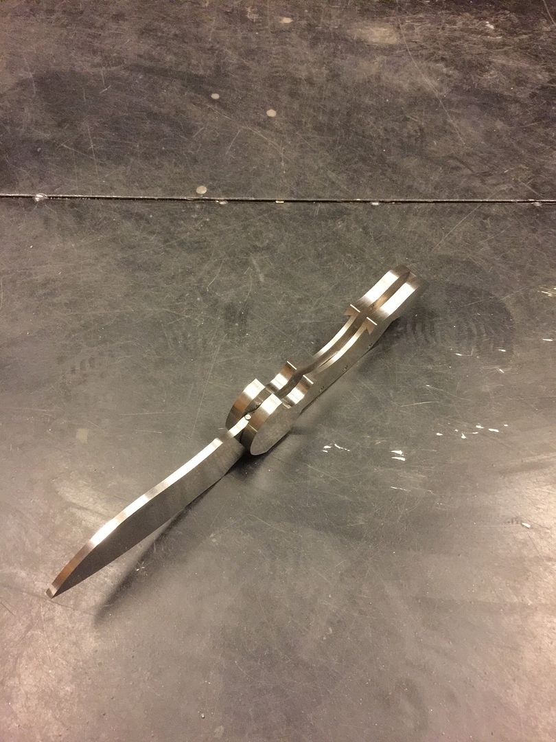

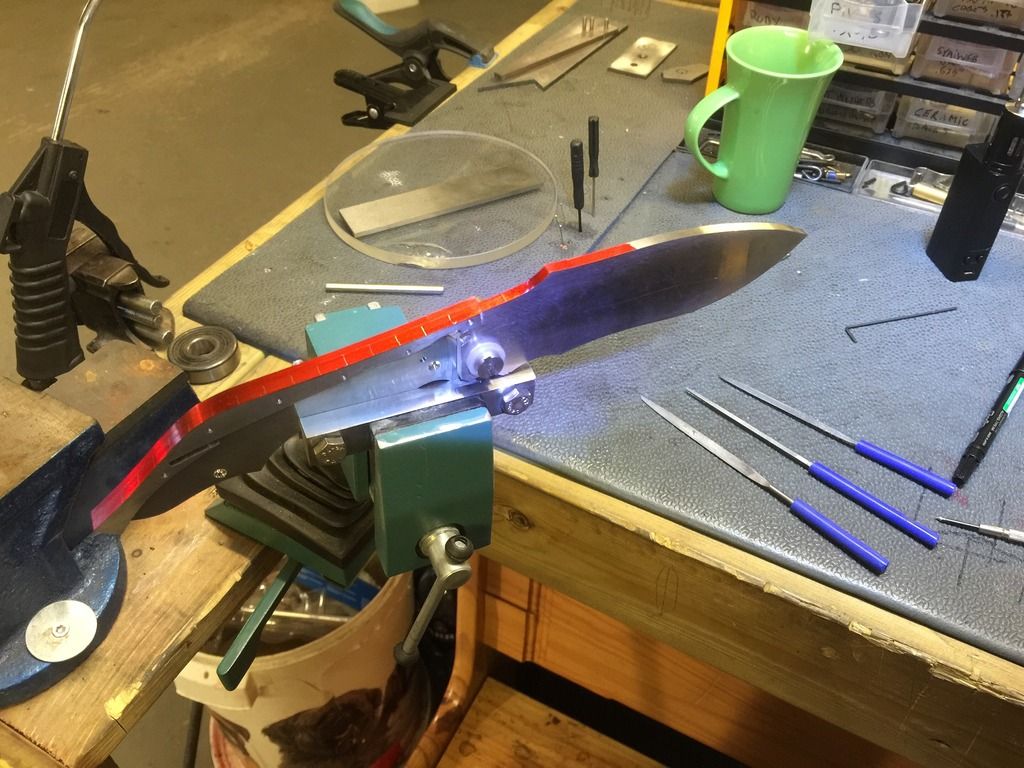

Checking for cleareance and planing next parts
Both open and closed position is now good

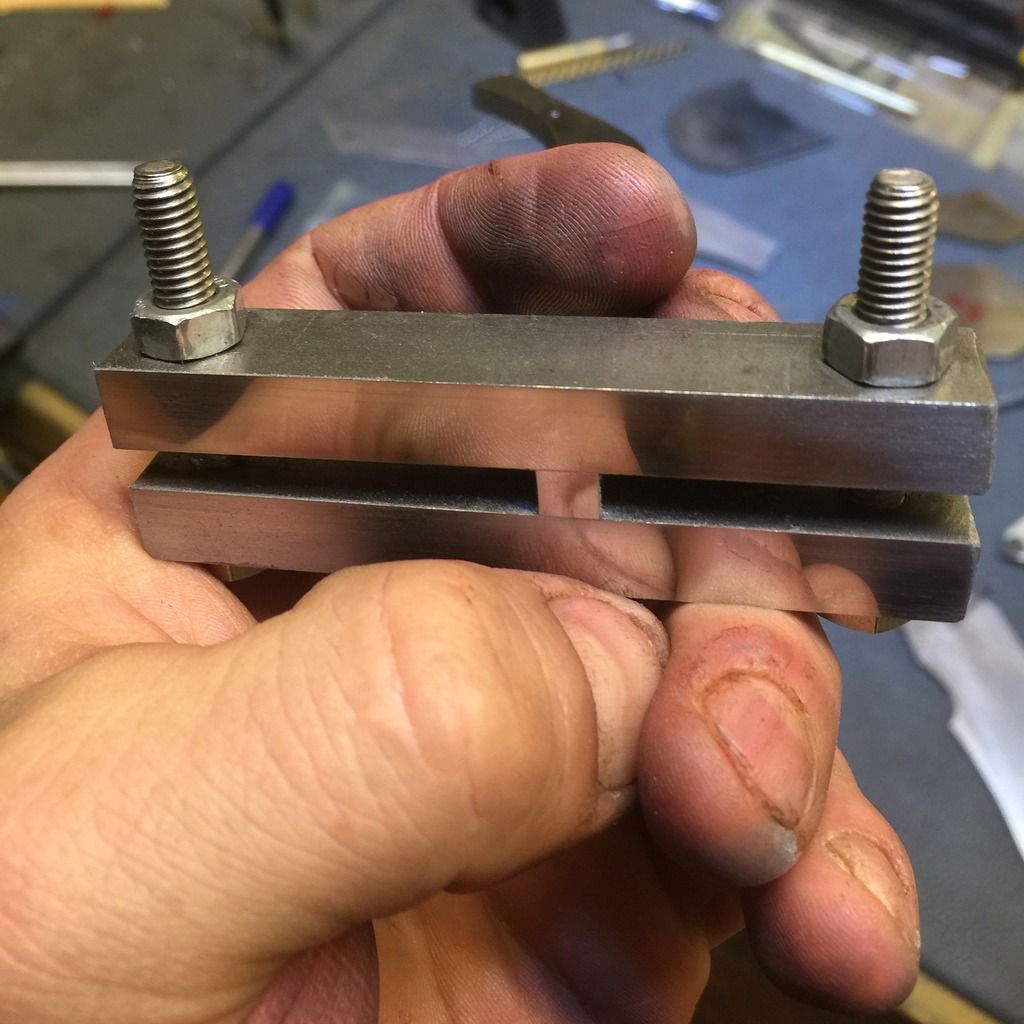

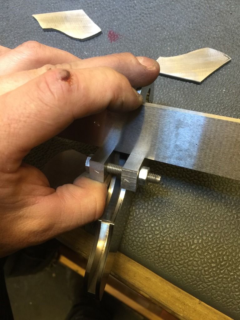

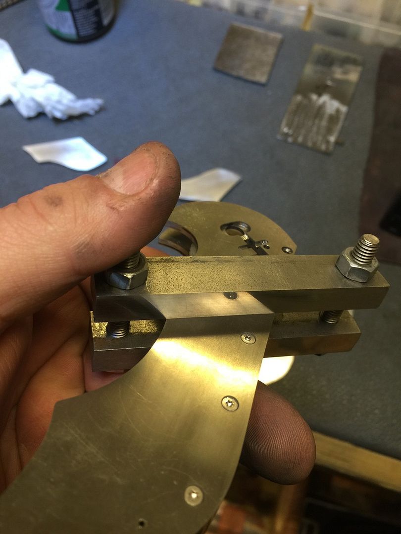

This handle will have straight dovetail lines on bolsters meeting up with mammoth scales. I use a filing guide I made for this job.
Checking the symmetry with a parallel
Here is the first stage of dovetails
Last stage for dovetail is done on a tempered 1 inch glass platten that is dead on.
Finished at 1200 grit, also the dovetail get a jeweled finish when final work coming up, every surface and dimensions of my knives gets the same attention. Inside is equally nice to the outside.

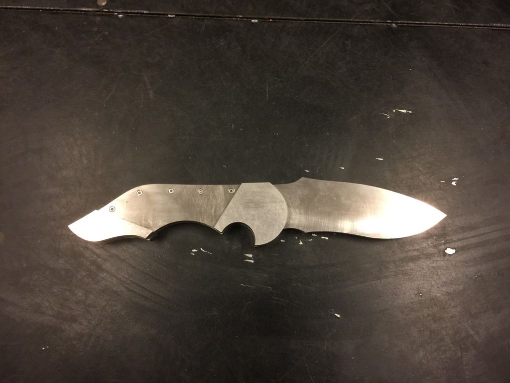

"Starting" to look like a knife
Sentered spot drill in the bolsters, next task room to lock in the mechanics.

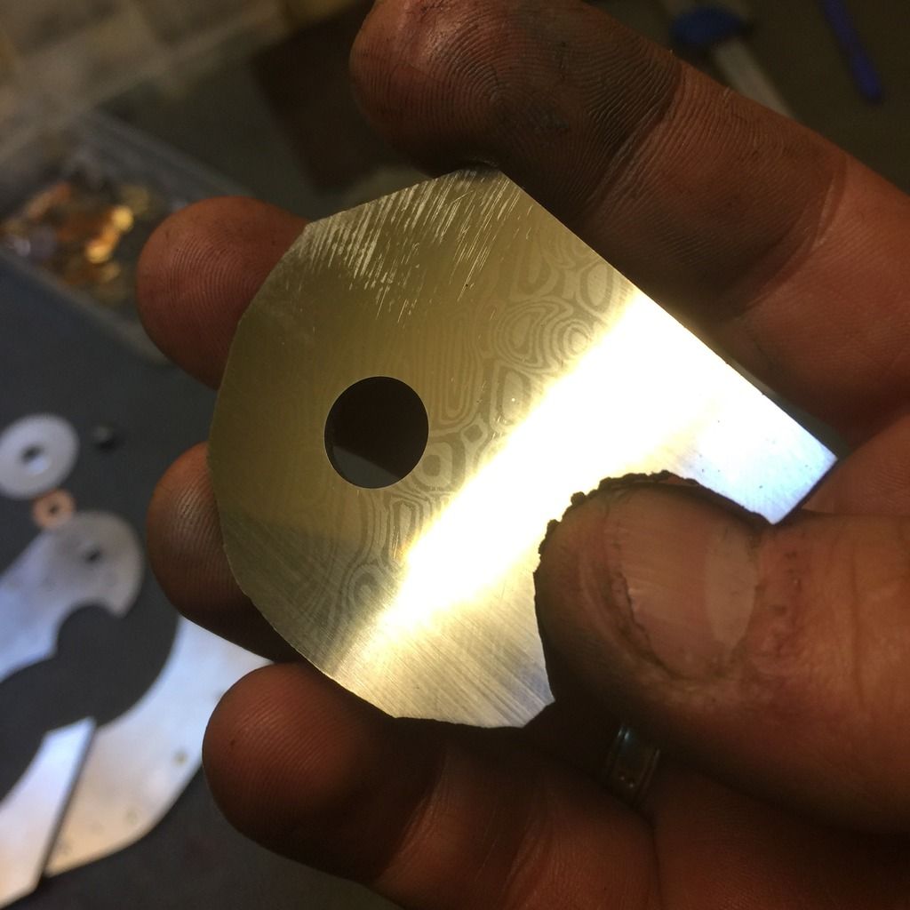

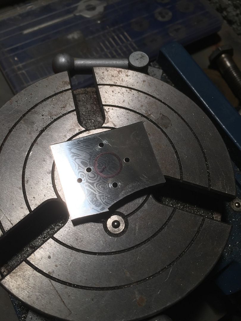

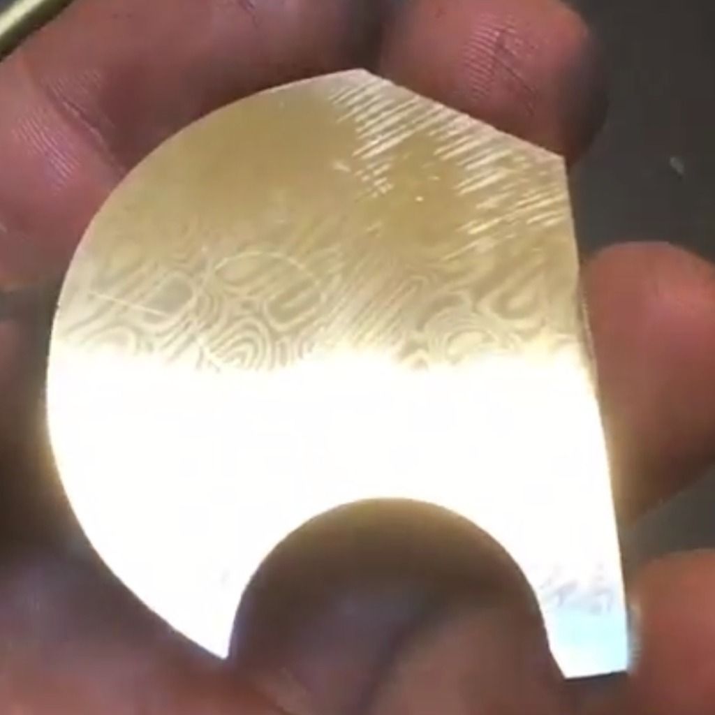

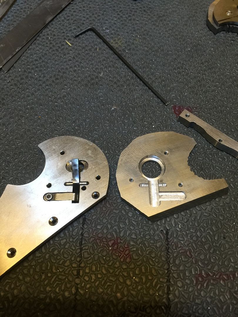

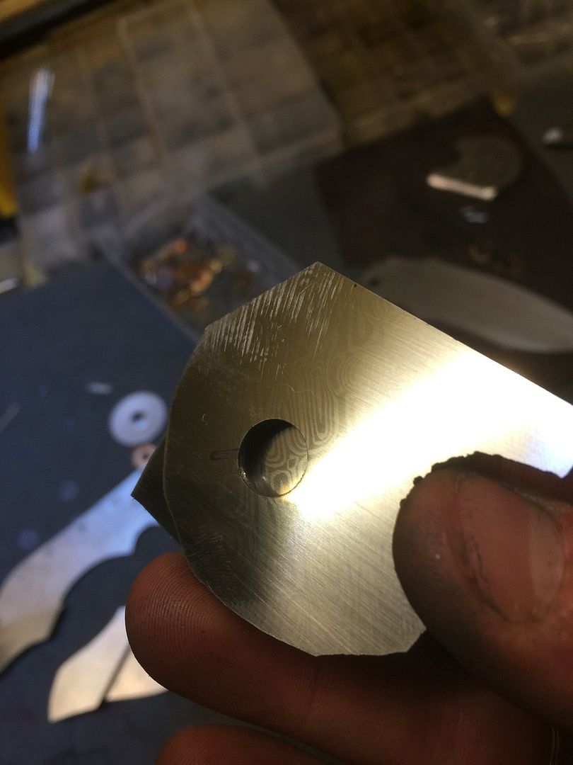

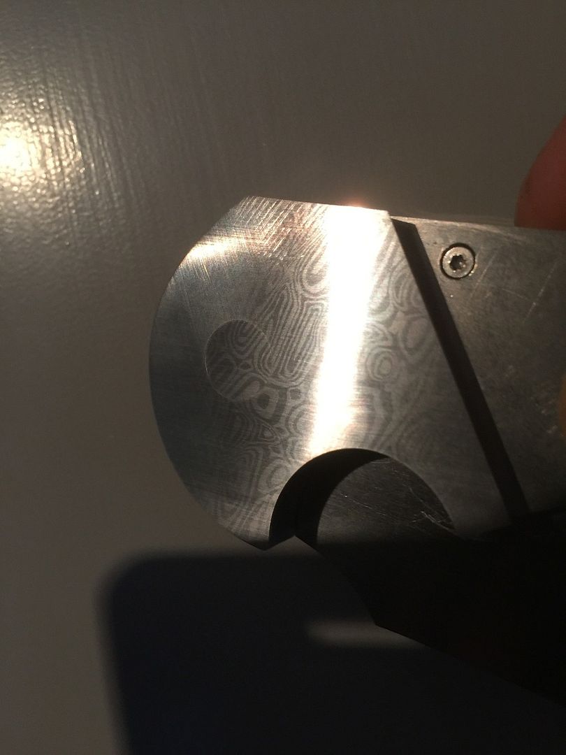

Time to make the button, revealed the pattern so I can find a similar piece.
Material that match the hole found, this will be tricky but fun job.
Roughly marked and with guiding holes, ready for the roundtable.

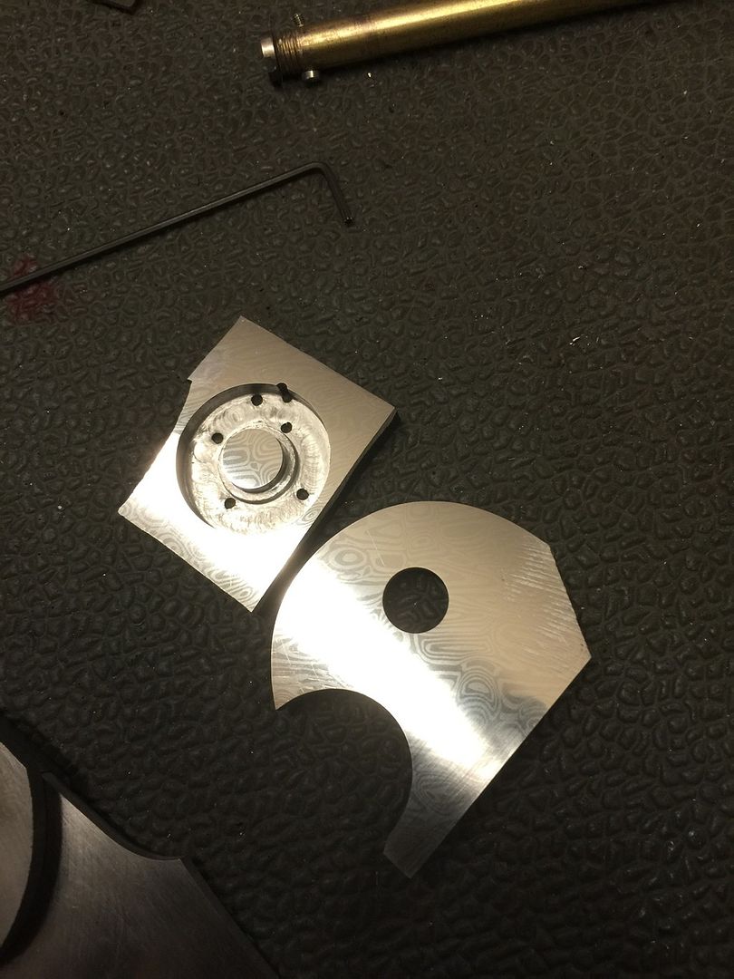

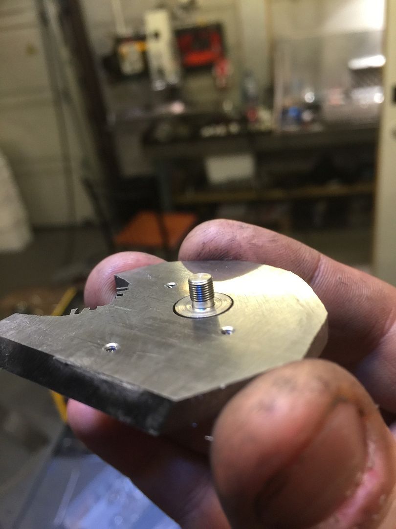

Pocket milled on the pivot screw side bolster
Shaping the pivot screw
All messy :P to be continued very soon.

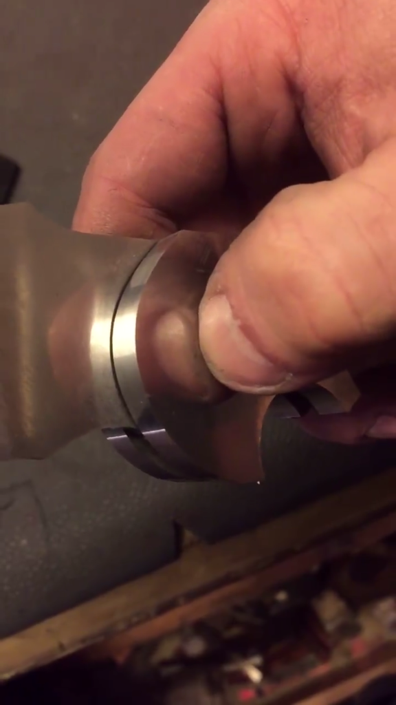

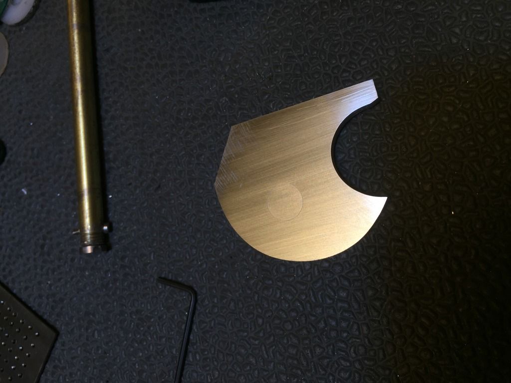

Button ready for shaping

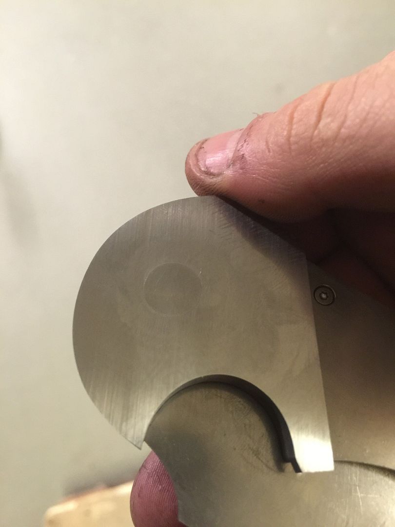

Just flat sanded to see if it holds my tolerances, seems good so far
Tuned in the backside and it fit nicely against liner and mechanics.
Flush tested
Button will be flush with the contoured handle, but for now this is just for testing to show tolerances
Hides nicely

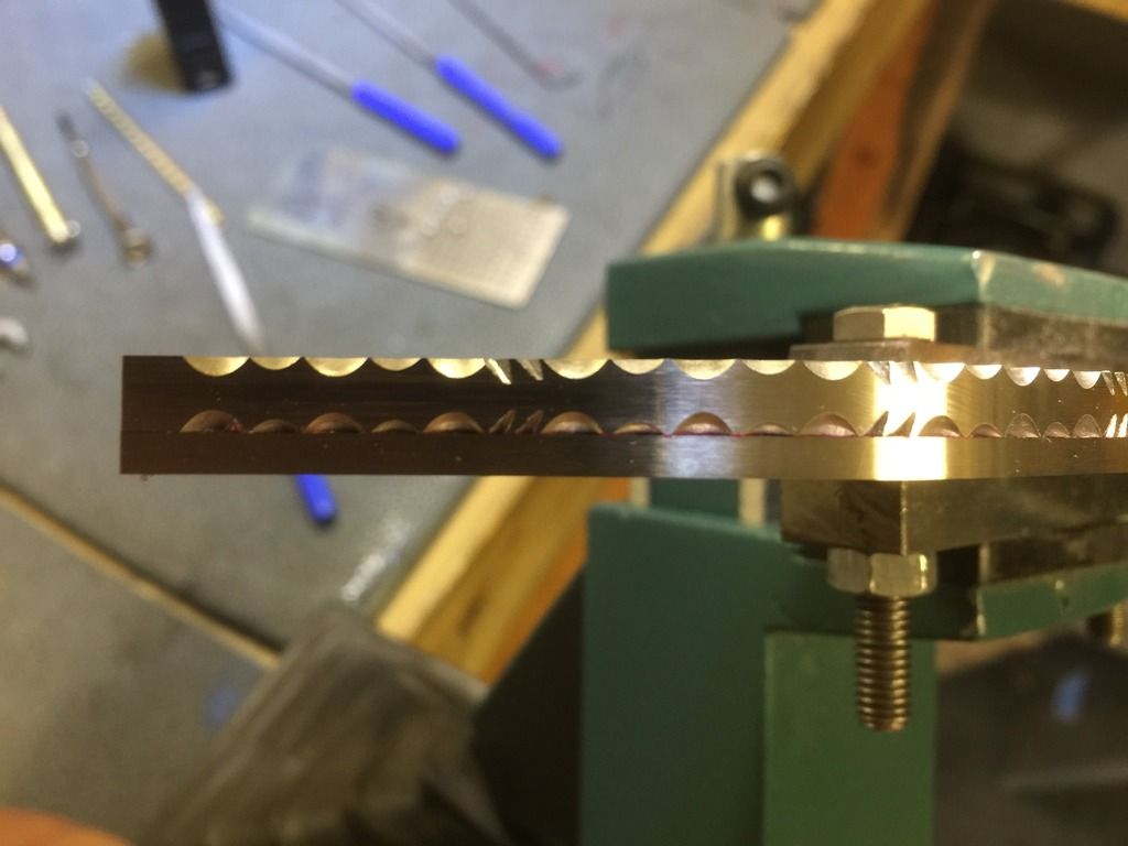

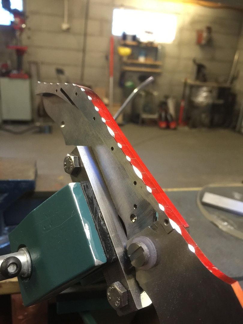

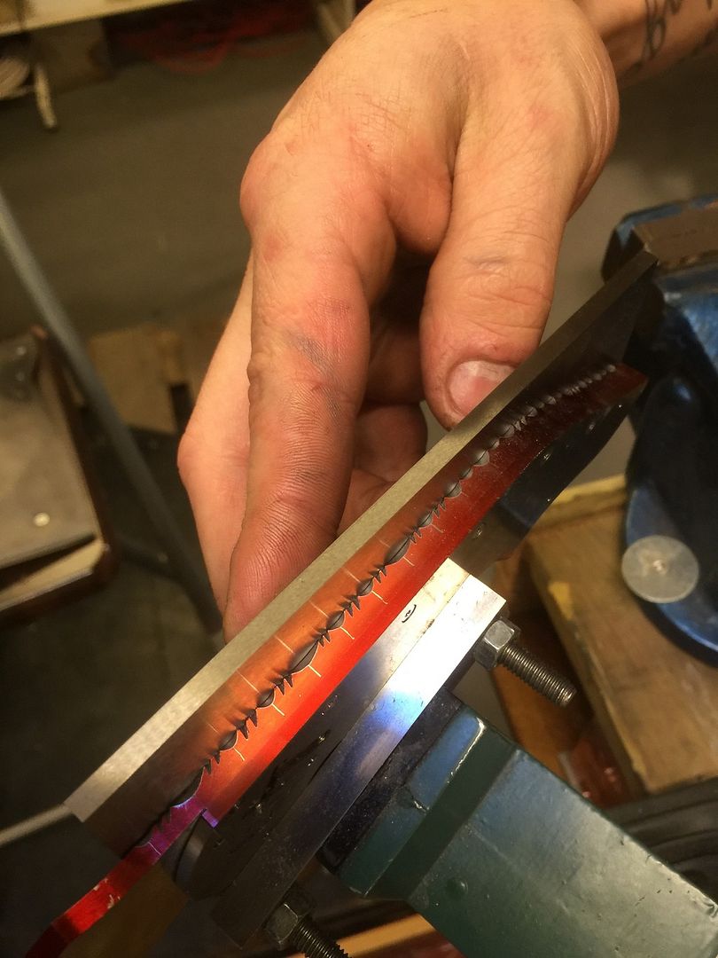

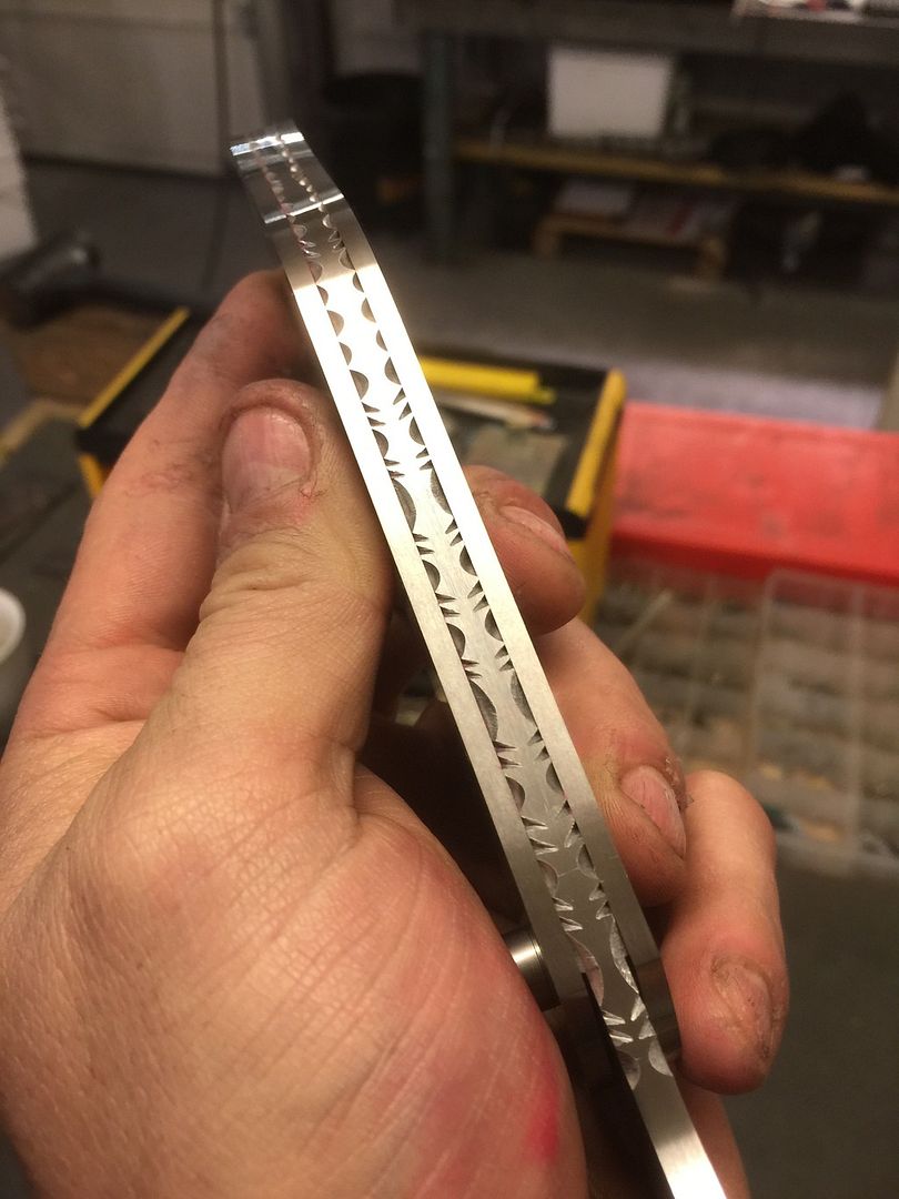

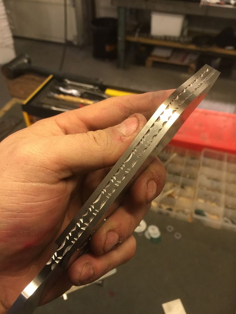

Time to filework spine and blade
Filework finished, liners get filework later in build

Just a short video of filework, hope quality of vid is good enough
Filework

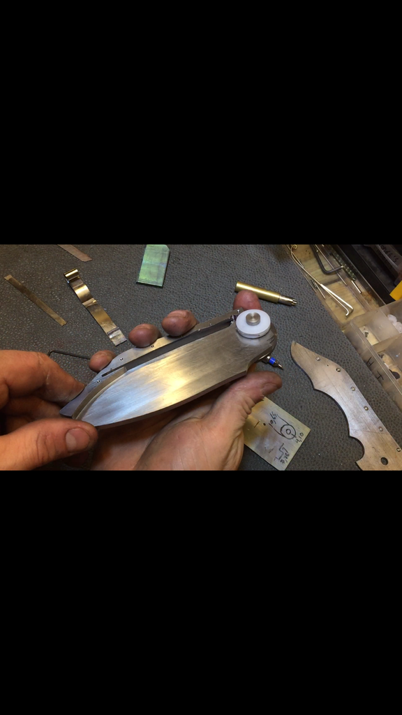

Better picture of the button, the pattern is very random so this match up was approved

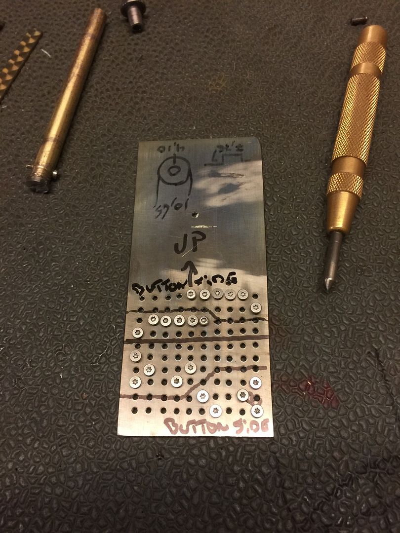

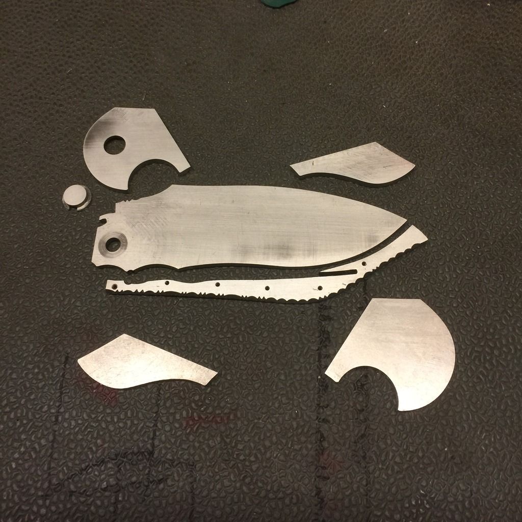

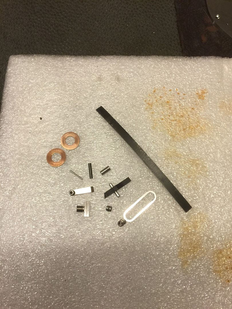

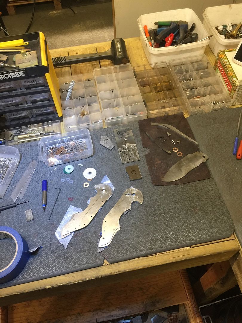

Disassembled the knife, this is a map for every screw
All the little parts on this build
Parts ready for HT
