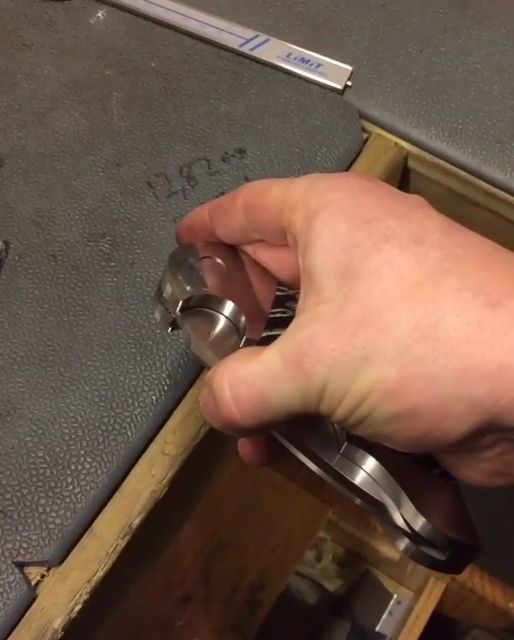

spring assembled and tested for clearaence
video clip of testing of button and detent. and action of the spring. need some tuning

lock is set and spot on
started contour of the handle
here it is about 600 grit
I do the contouring with everything assembled to eliminate any variables that can happen. this way everything stay flush and consentric
above 1000 grit I do the rest by hand with paper. finish is done on my grinder with leather belt
Here is what I am at the moment. more to come soon

I just have to ask, how do you do that sweeping grind, where the plunge is so perfect and rounded/feathered at the bottom? Is it with a rubber wheel, any special technique? Because I've been wanting to do that but haven't the foggiest on how to even start. It's absolutely gorgeous, I'm just curious if you'd be willing to share technique!!
Hi Sir ya of course.
I have built most of my equipment myself, my grinder, fixtures, handtools, Ht oven so on. Only investment I had to make was my mill(the mill is used for inside mechanics stuff on knives)
to the grinder, i use a 10" wheel(want bigger) and yes a rubber wheel. i have slightly camfered the edge(just tiny camfer) But the grinding process is a patience job. Short story: Before i wet stone my entire bevels and sat for 18-20 hours on a blade, thats why I have still have a slow grinder only 0,3Hp(will upgrade some) Now i spend 4 hours about on a couple bevels, the plunge is done almost from start, you just have to try and sweep it in and make sure the lines are crisp, a good helper is to draw consistent lines on top of dykem so you dont pass critical areas. Most people that try this plunges get a straight down sideways angle, that happens if you try to do the plunge in the end, my plunge grind is with the bevel making from the start. I might do a full vudeo on YT on this cause its difficult to exlain in text.

Thanks and I am humble of the words, I am a 31 year old maker with 2 years experience, but I have always used my hands on mechanics and steel working so I have a understanding that things must be flat nd paralell from the start. I dont have surface grinder so all prepping is done by hand. i only have a mill for tolerances on mechanics part, or else I do manual labor(old school knifemaking)
Important that this craft can live one more generation and hopefully inspire new guys to do the same in 40 years, I will always do this cause I can use my Passion, Patience and Determination to the edge of what possible.
for the Mammoth its a pain, I went thru 2 carbide endmills to get down the thickness under prepping, for belts its was okay. I have totally 20-25 belts and havent thrown away one in a year cause I work slow and take car of my belts also. Time isnt a presence for me so I can fully use equipment properly. But Cubitron belts in the start of contouring and Ceramic belts is a must.
On the Mammoth I wish I had surface grinder cause it eats up carbide endmills(cant use them for other tasks later)
