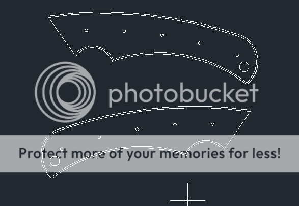

Stormbird I use AutoCAD to do all my drawings i dont know if its anybetter than any other program but iv had like 4 years of training on it in school so its what i know and use.
I didnt really have to transfer it well i did but i didnt have to convert it at all, the computers of the waterjet at the shop i use can read the files I email them.

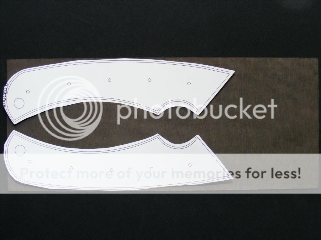

so since its going to be a few weeks until i get to my tools to be able to start finishing the blade I i hought id figure out the handle lay out.
So i drew some matching handles on the computer and then made them a bit bigger to give myself some room for error.
Than I printed out the drawing on a 1:1 scale and arranged them on a slab of black linen micarta I purchased at the recent knife show i also have a slab of black G10 i may use.
So once I have access to a band saw ill cut the slab in 2 and than trim off some excess and start profiling the handles.
Any tips for the handles Oh! i forgot to mention im also waiting on some 1/8th inch copper sheet im going to use as a liner.
