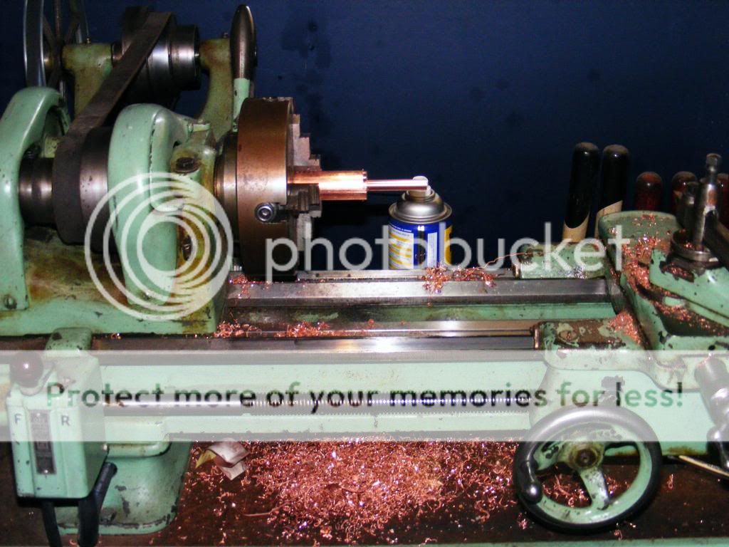

Turned the copper rod down to the needed diameter i know thats a lot of waste but all i had on hand was 1" copper rod.
Now i have a heavy walled copper lanyard tube :) slow progression.

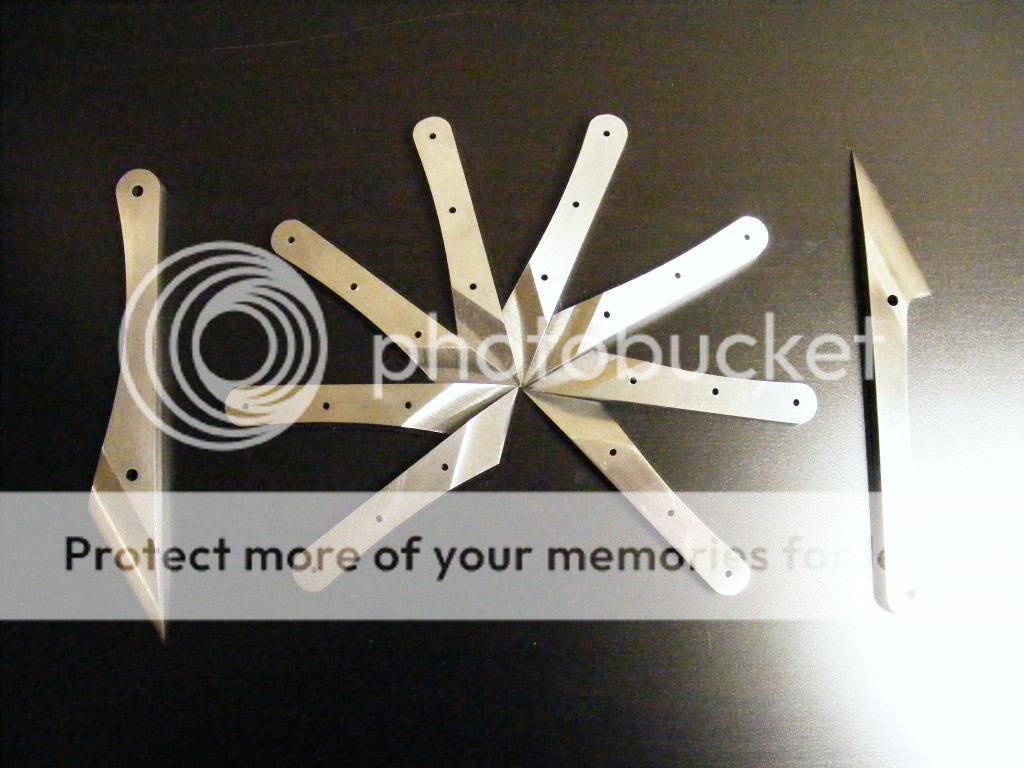

I really like how the big 'un is coming. I think that one has the most potential, personally.
Have you done anything with the smaller knives? I don't know, but they seem pretty thick for such small knives. Seems like you'd have to grind them a lot to get much cutting ability out of them.
All the smaller ones have been rough ground (except the persians) but since all i had on hand was a portable belt sander they all have an extreme unusable convex grind.
So until i either have enough time to file them or some better tools they are on the back burner they are very thick but they will cut with the right grind.
