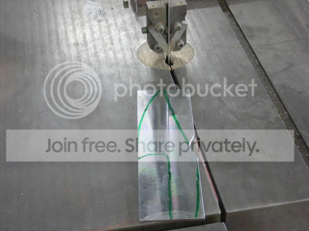

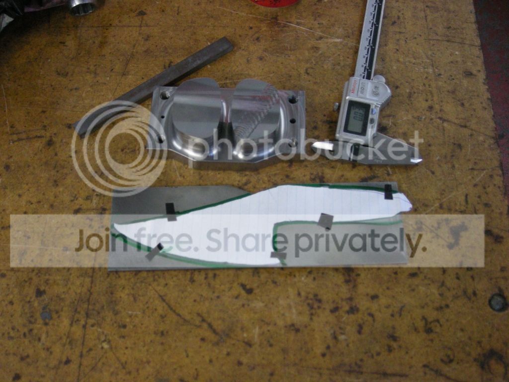

here is my design on my off cut of steel

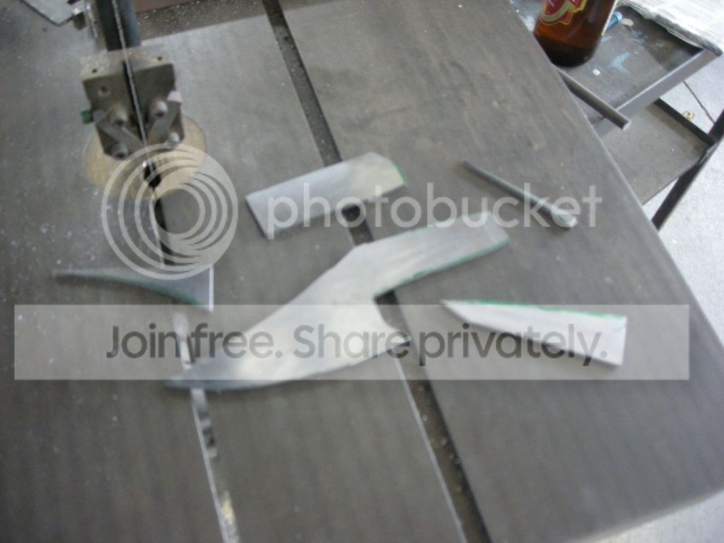

here it is about to be cut out on the band saw
chopped out

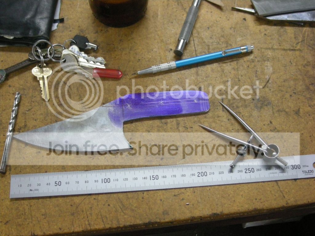

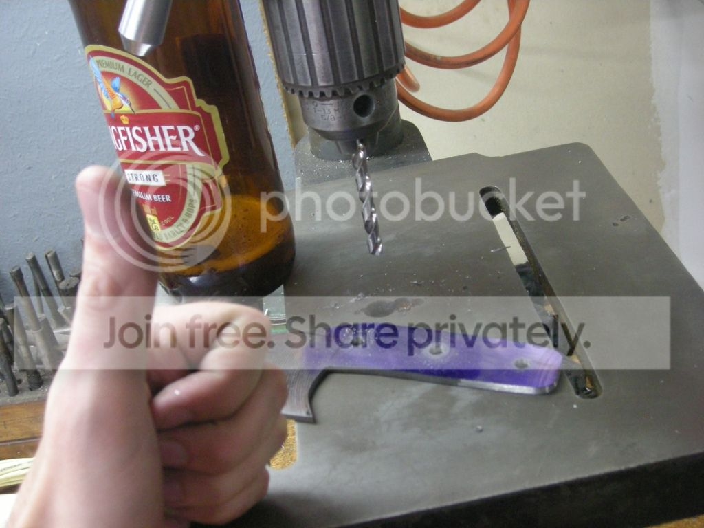

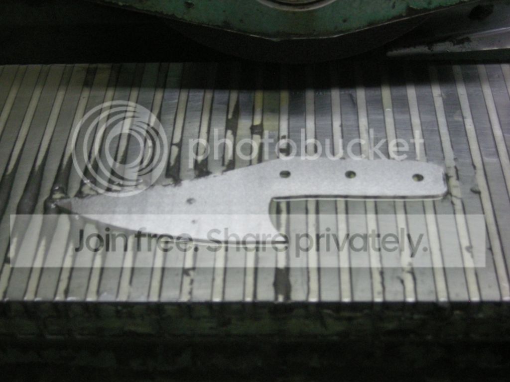

putting engineers ink on it and marking out pin holes & lanyard holes
holes drilled

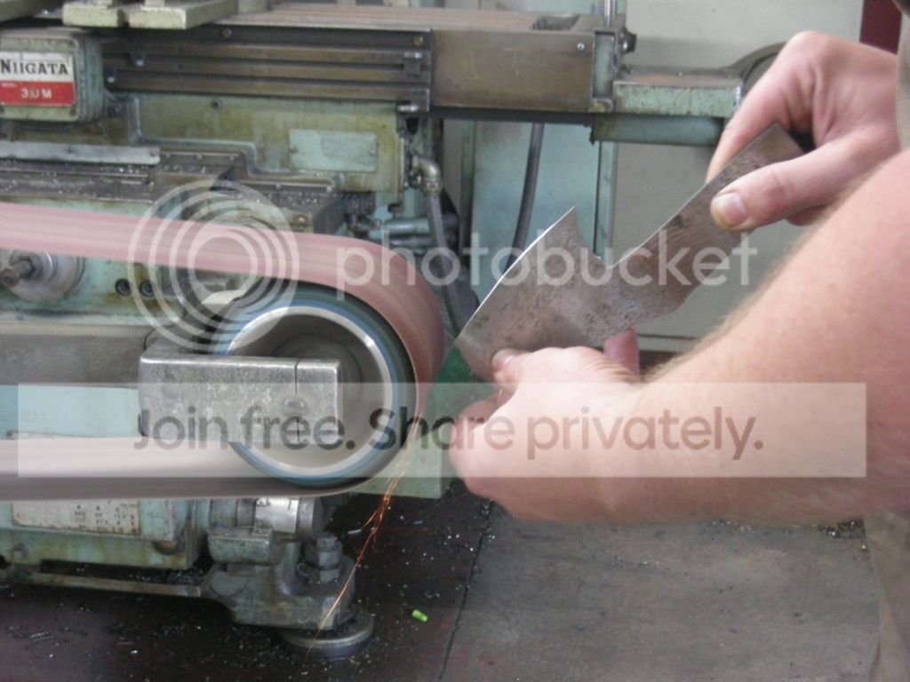

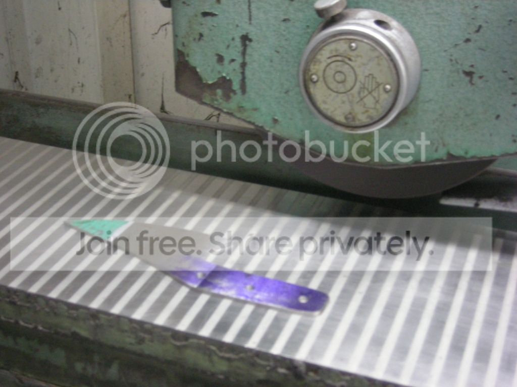

putting it in grinder to make it flat and look nicer
grinding in progress :)
now its flat and smooth

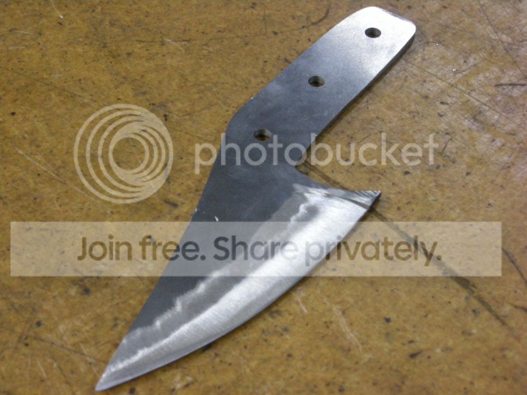

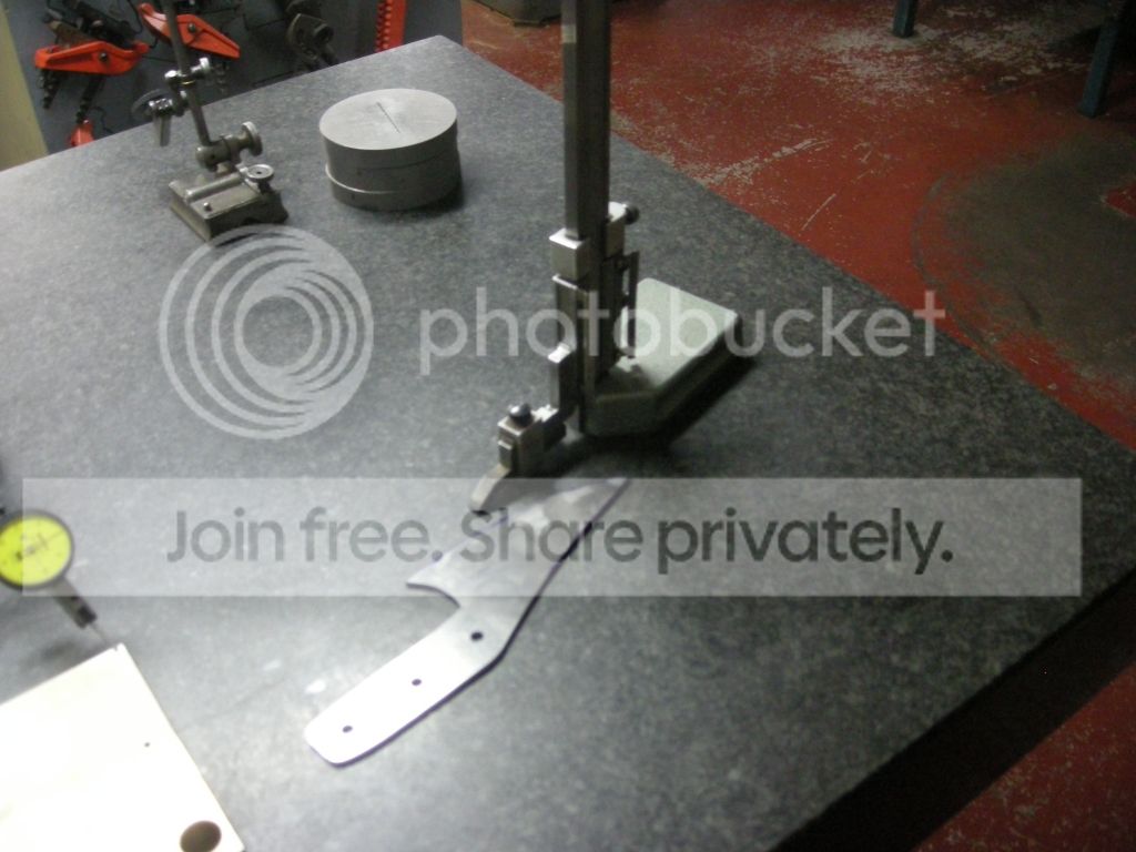

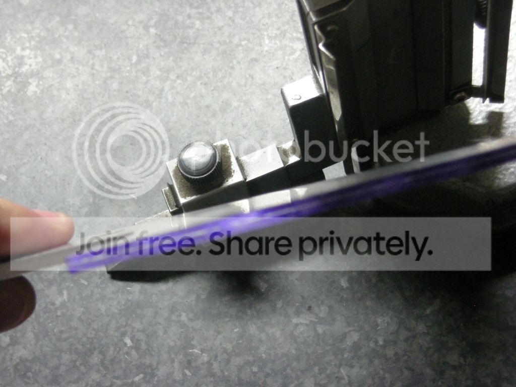

this thing here was used to mark out the middle of the blade where we had to grind

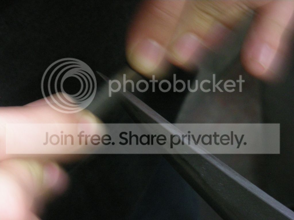

here is the edge scribed (it is even, it was done with the above tool, i dont know what its called lol)
here it is with a bit of grinding done on the edge
I stopped taking photos here, but i got it looking a bit better and its off for heat treat real soon.

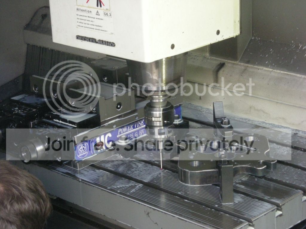

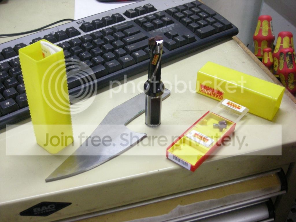

almost forgot the coolest pic of all. heres what my mate was working on.
no idea what it is but it looks pretty sweet :)

EDITE: the tool you used to scribe the center line is a height gauge

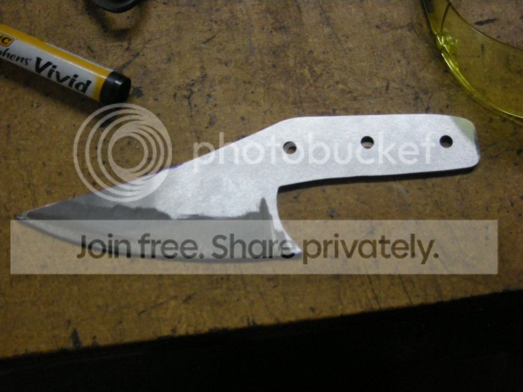

Hello everyone, my knife didnt get sent off to heat treat today because the other job it was getting sent with wasent ready. This is good because i had more time to touch it up after work today, which im happy about because in reality it needed more work and it will no doubt be a bit more difficult after heat treatment.
here are some pics i took this afternoon :)

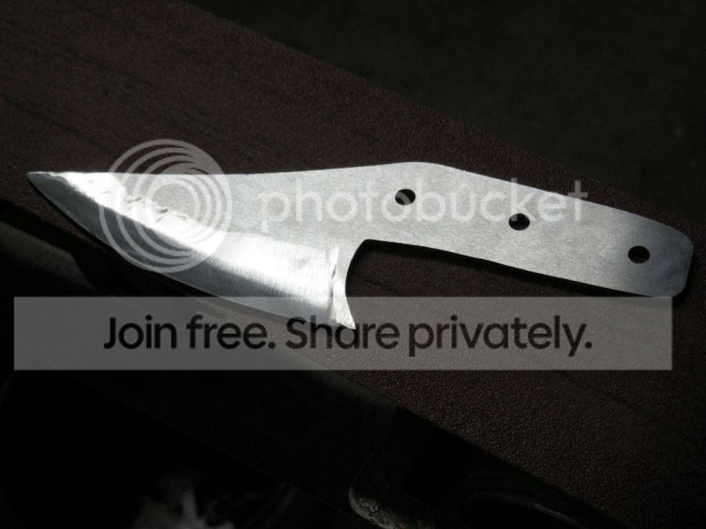

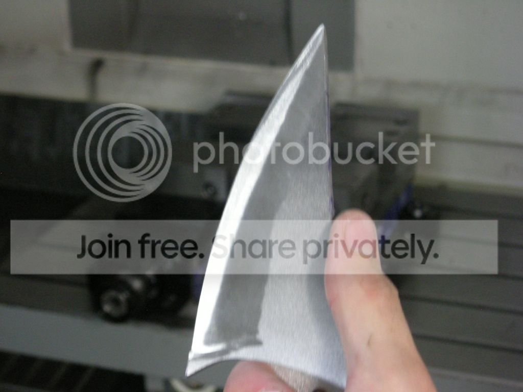

here is at almost the start of tonights work, the edge looks nice here but the convex is way to heavy.
knife in hand
now i think its getting there, knife sitting on big linishing belt :)

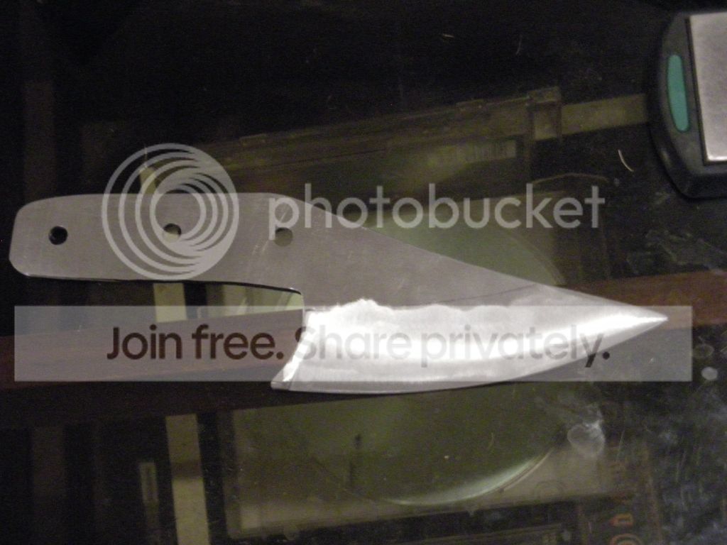

heres the other side. I managed to get a pretty good convex on it. No doubt this is due to the large size of the wheel at the end of the sander providing a large rounded surface area for you to work on.
some work with a small fine file on the top. its blade is 3.4mm thick

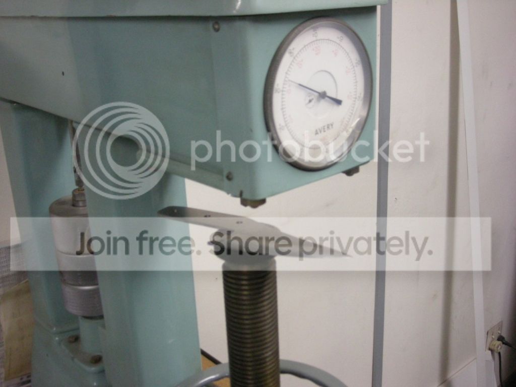

here is my knife on the hardness tester. didnt actually test it as its not heat treated. just photod it because we all like photos :) supposdly at the moment it should be at the minimum/just below what his tester is calibrated to test. Will test it after heat treat, but i told my mate to have it done however he thinks would be best he thinks is about 58Rc for D2. Im fully leaving that to him as he works with this stuff every day.

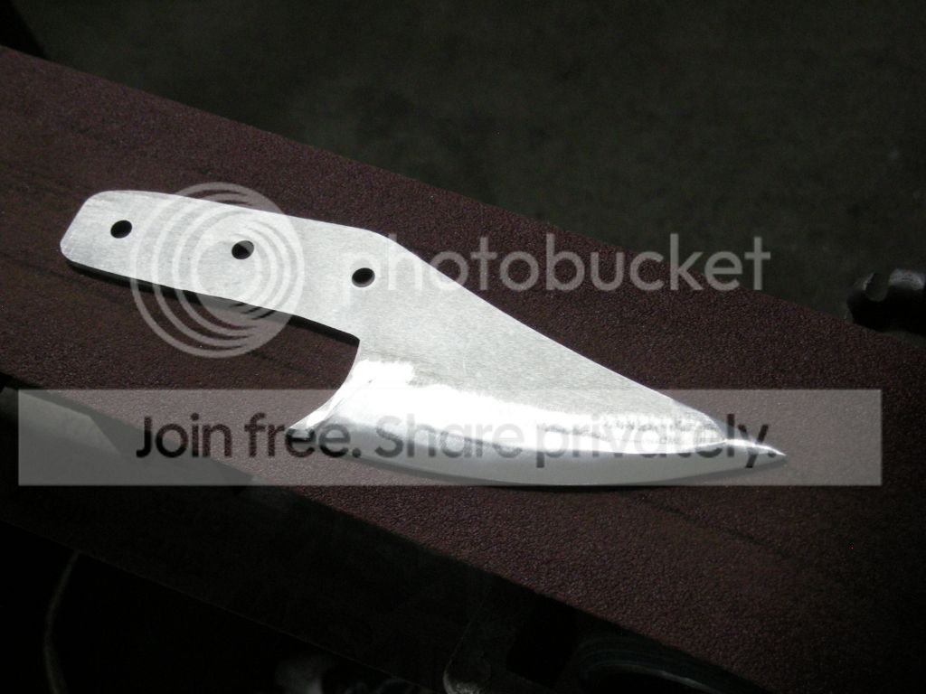

and here it is after yet more grinding.
now im going to give it a bit of a sand here at home before its goes away for heat treat.

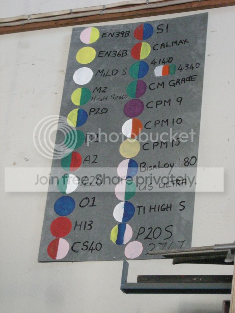

here are some photos which i thought some may find pretty cool..its my mates steel colour code to keep track of his stock. I see some very sweet stuff there for me to play with :)
I wanted to leave a lot of point strength, so its got a heavier convex up at the front if that's what you mean.
if thats not what you mean then its just my amature skills lol :)
im not to worried about how it looks right now, ill buff it on a machine after its heat treated :)
going to make some kind of hilt also
Ameature skills or not, I bet you could even up the grind line at the top of the bevel. At the very least, you could blend the convex bevel to meet the flat in a more consistant manner.
Also, don't think that buffing will remove much material. That would be a mistake. Buffing is one of the most dangerous operations you could undertake (even more dangerous than drilling pin holes without something to clamp the blade to the table). This is especially so with profiles like the one you have with pointy parts to grap the wheel. Buffing is a finishing process, not a machining process. Get it close now before heat treat so you have less work to do later is my advice.

Sounds good. And, yes, the buffing machine is one to watch out for. It spins very quickly, and one moments lost concentration can see that fabric wheel snatching the blade from your fingers and throwing it away from or towards you faster than you can even process it's happening. People have been severely injured by buffers. Always buff with the top of the wheel running towards you, keeping the blade on the bottom 1/2 of the wheel. That way if it is grabbed, it will most likely be thrown down or away. I saw one user who posted the red mark/bruise he had after the buffer snagged a blade and actually carried the knife all the way around so that it slapped the back of his hand with extreme force (lucky for him, on the flat), before it spit it out away from him.
Just something to be cautious with. You'll thank yourself later as finishing is much easier with less material to remove after hardening.

You have some work to do before you ship it off to HT. Get the blade sanded to about 400 grit and make sure all the previous grit scratches are gone before you move up to the next grit. Trying to get deep scratches out after it's been HT is a beast. And heed Nathan's warnings about buffers. It's been discussed numerous times on here the dangers of them. There are some makers on here who wont even use them, and one member had one snatch a knife out of their hand and stuck it in a wall a not far away from his head.
