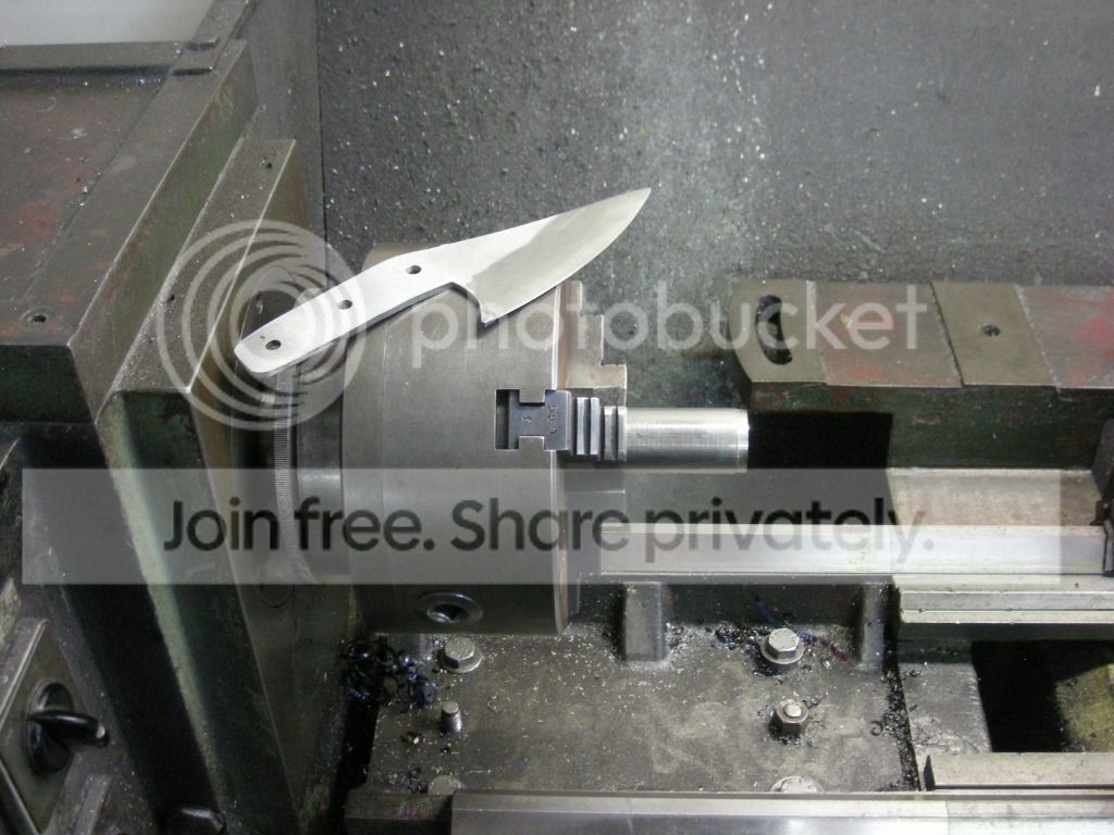

I just sketched up a pommel for the bottom of the handle :)
hopefully friend is working late again tonight so i can go grind it a bit more and start the pommel

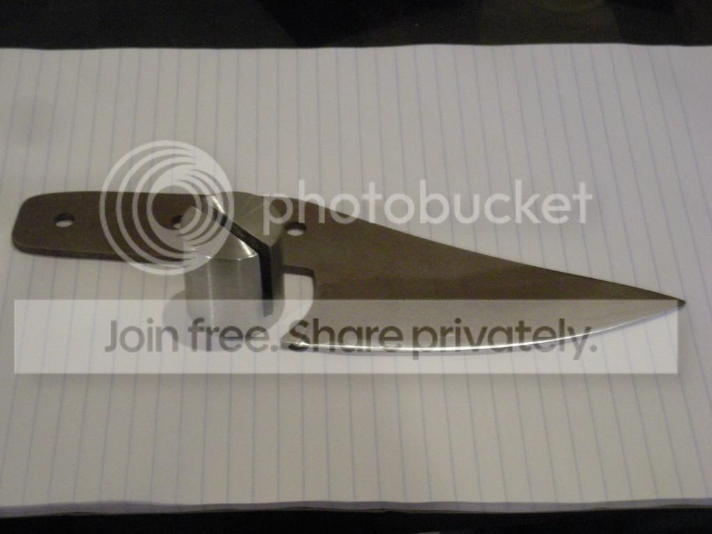

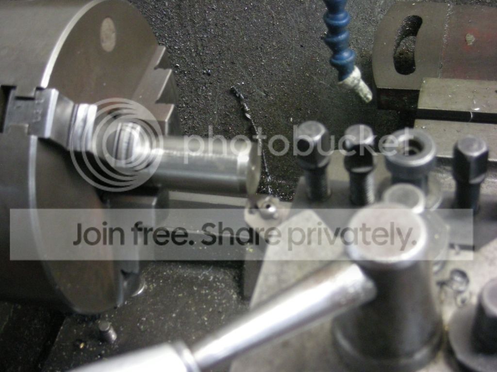

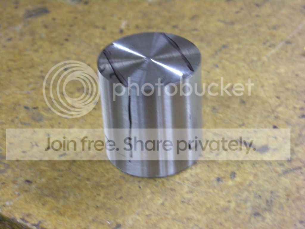

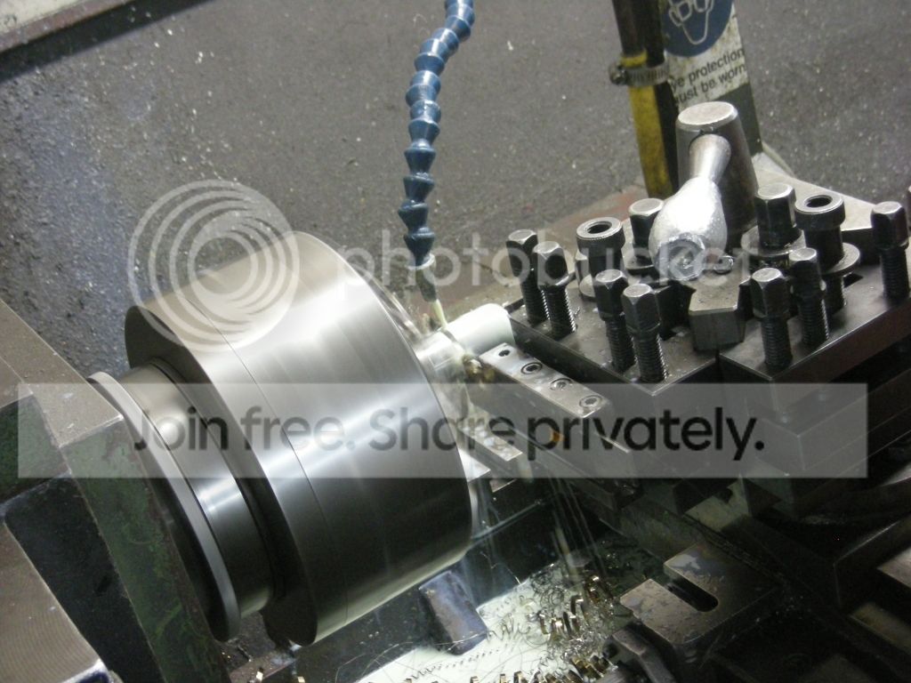

started making the handle bottom basher bit
knife is back from vacuum furnace heat treat. here's a pic of it after heat treat with the progress iv made on the bottom bit. the bottom basher bit made from some stainless propellor shaft :)

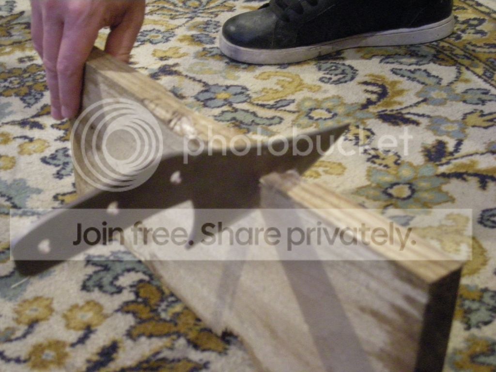

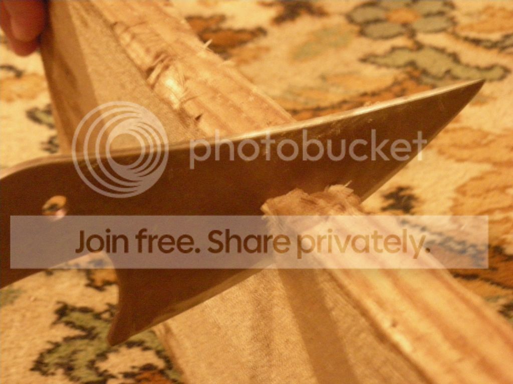

next i tested it on some wood. I split a bunch with the grain then hammered it into a wet piece against the grain

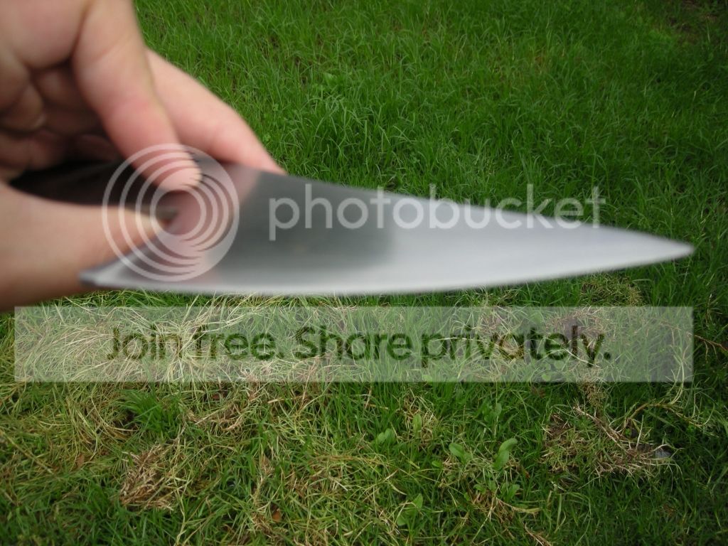

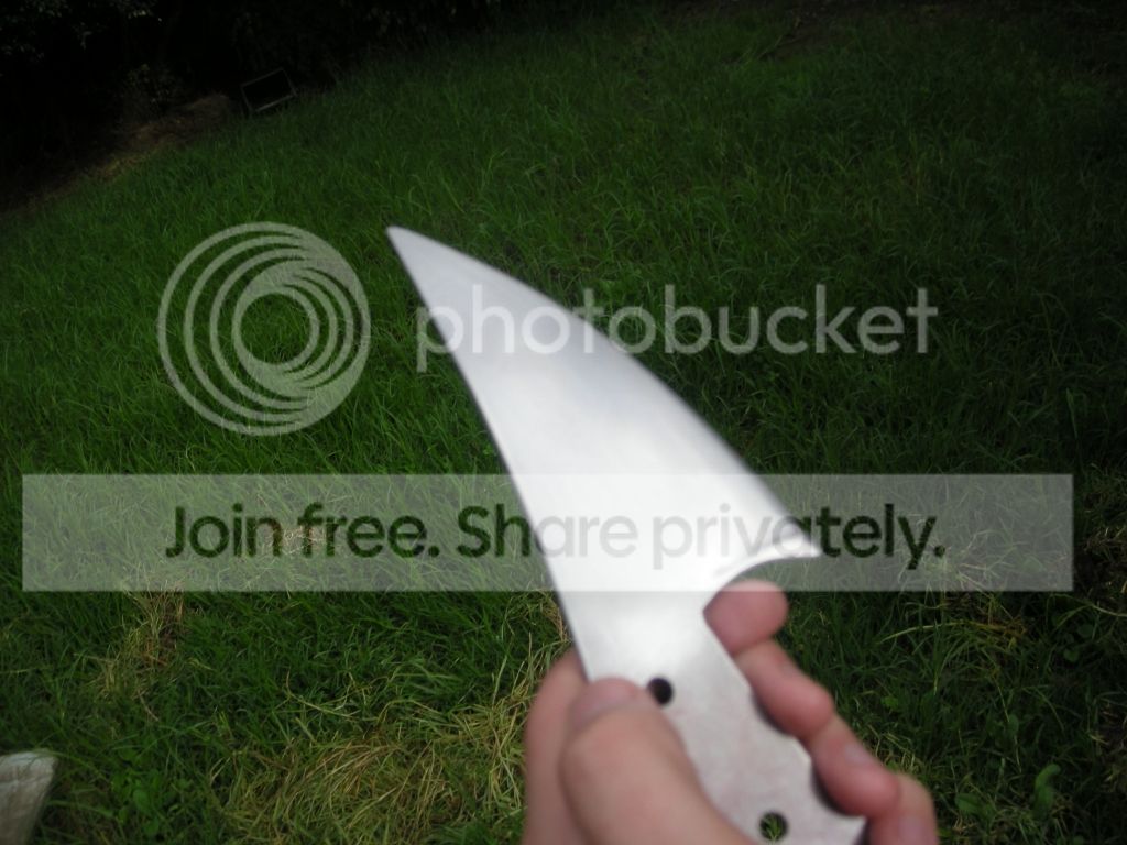

next i did loads and loads of sanding (by hand), sanding hardened D2 is hard, dont do it, listen to the knowledgeable people and just do the prep mate!!!
now its razor sharp and polished right up to the edge, no grind lines

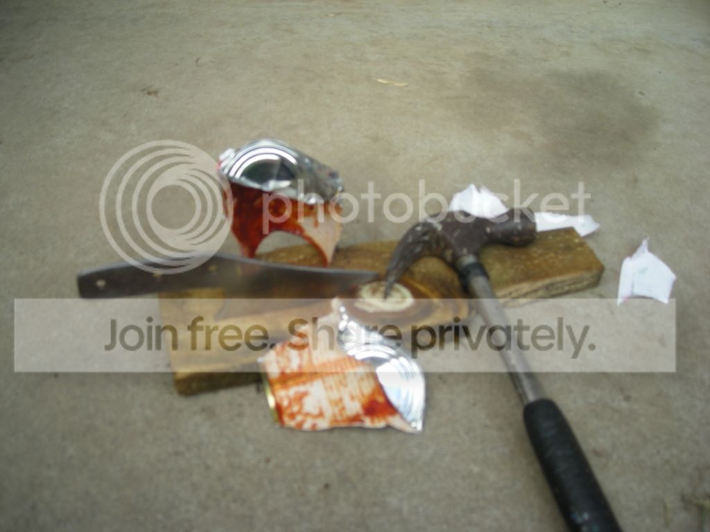

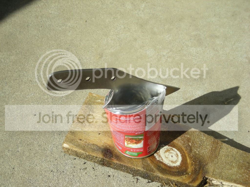

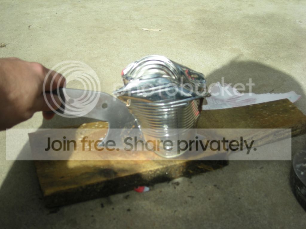

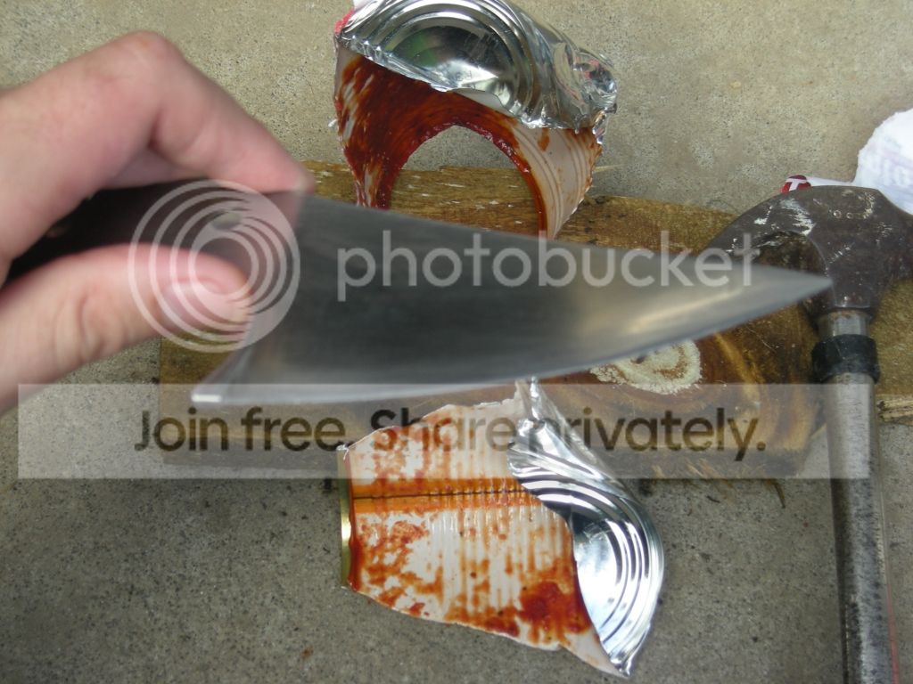

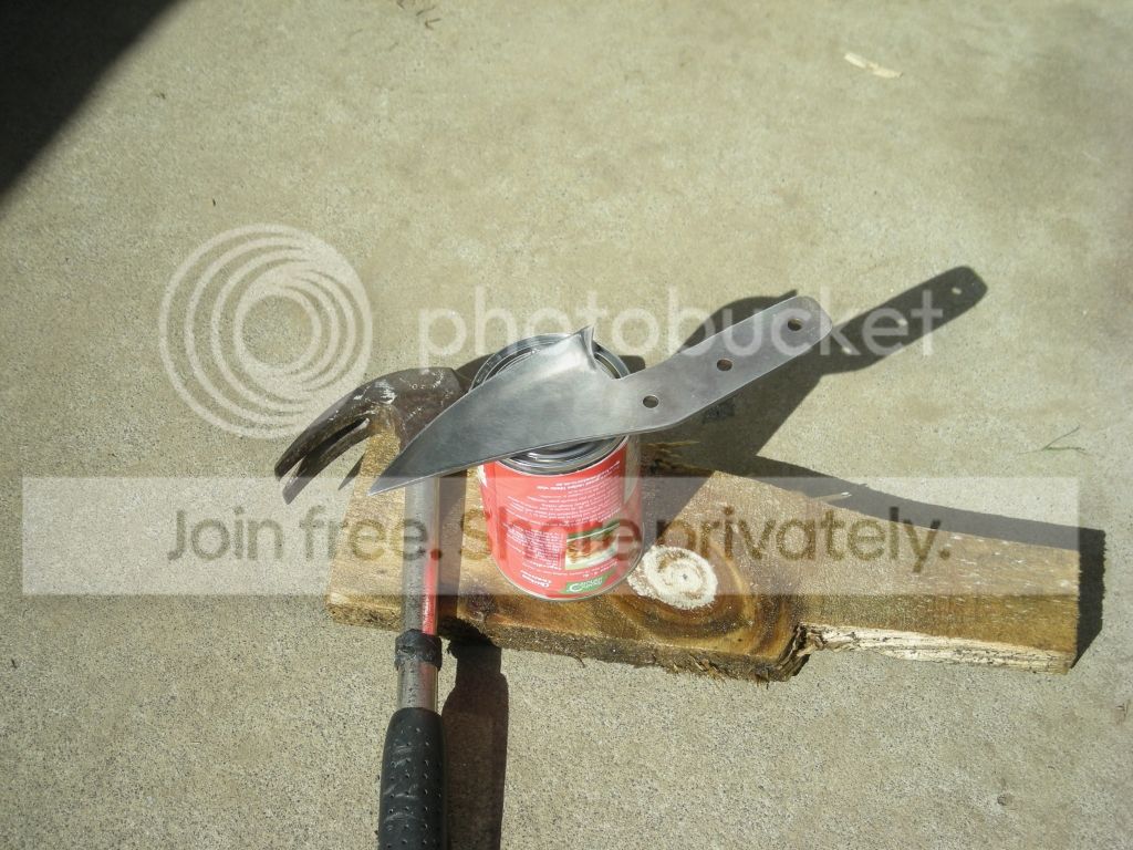

ok so now the blade looks nice, better test its durability aye!? lol :)
first we have knife vs tin can lengthways. hammer check, can check, chopping block check
through the can and into the wood,
edge is sweet!

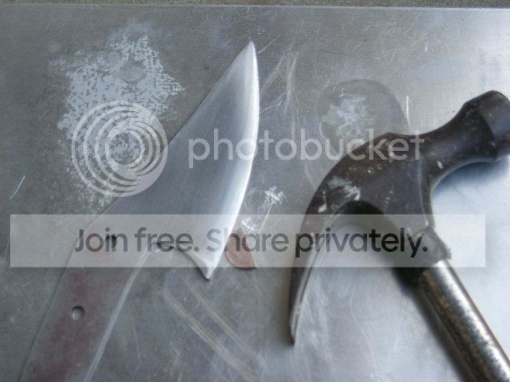

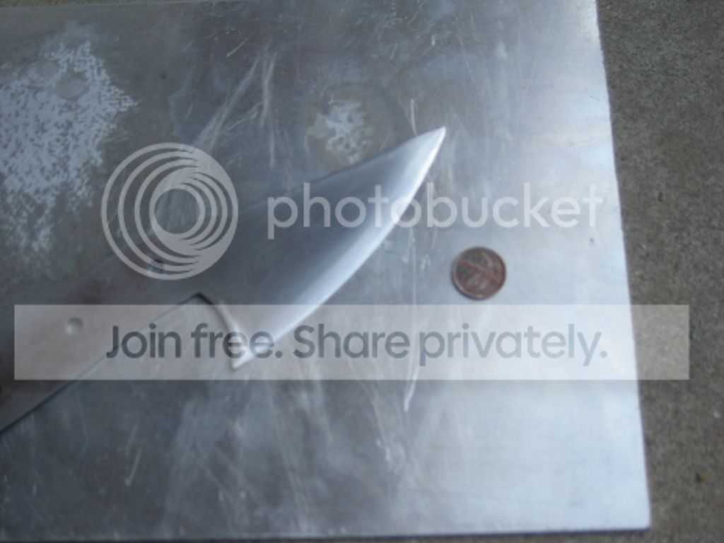

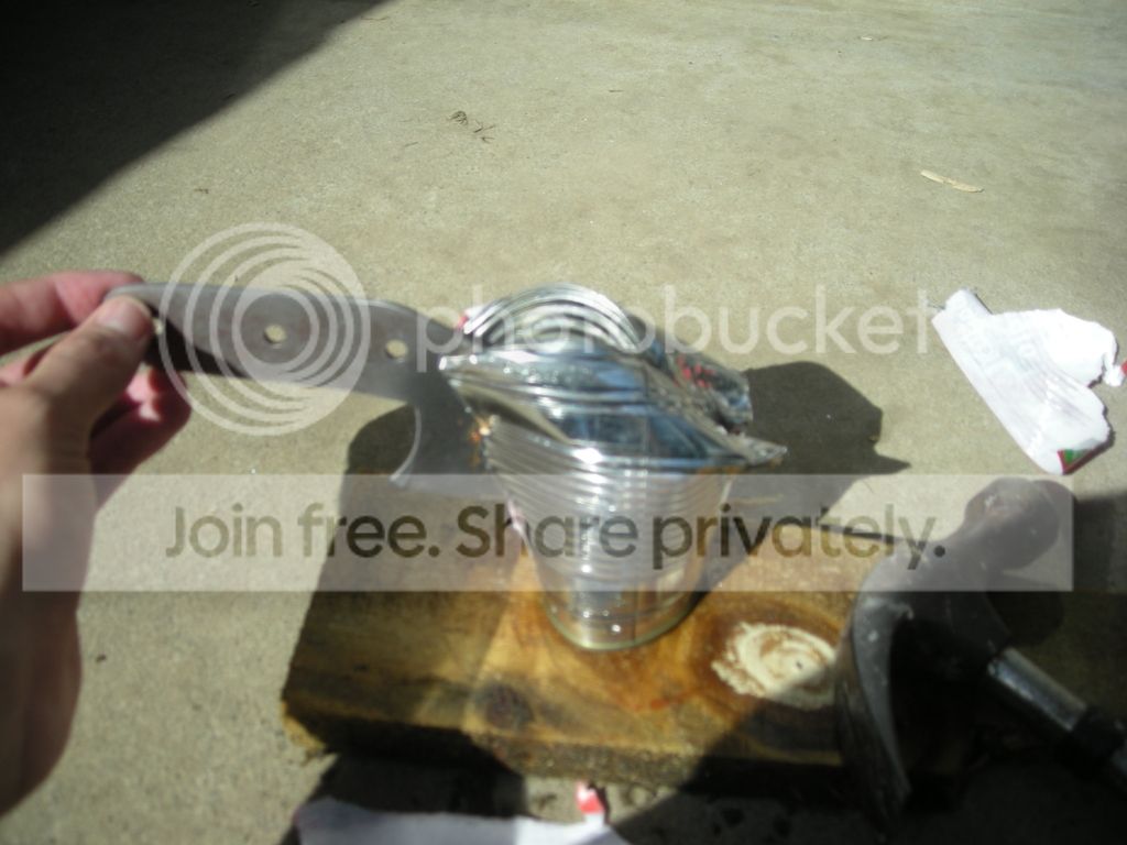

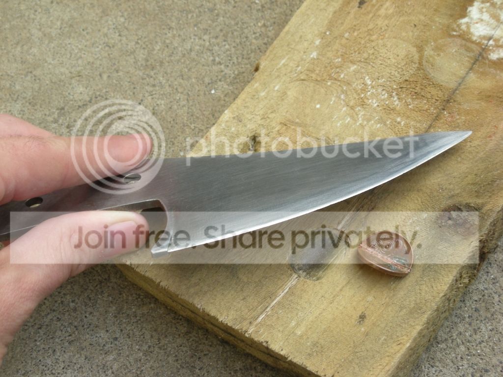

next i felt i needed to cut a coin in half
stupidly i tried to do it on a bit of wood first, so i just ended up hammering the coin into the bit of wood using the knifes edge, lol
still sweet

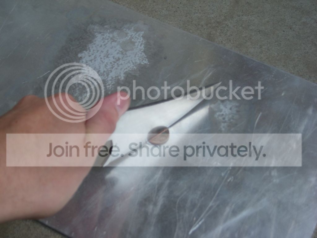

next i put it on a sheet of aluminium to try cut it again..
success!
Reminds me a bit of a sharpfinger knife.
Are you sure the edge didn't chip?
yea im sure, it was only slightly rough after the cutting the coin on the aluminium. t sharpened out with about 4 swipes on my extra fine diamond stone :)
its 57Rc by the way
