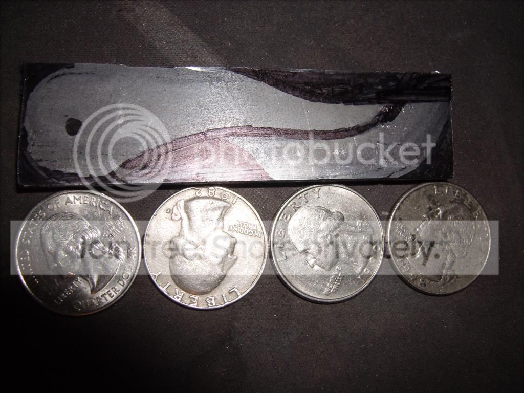

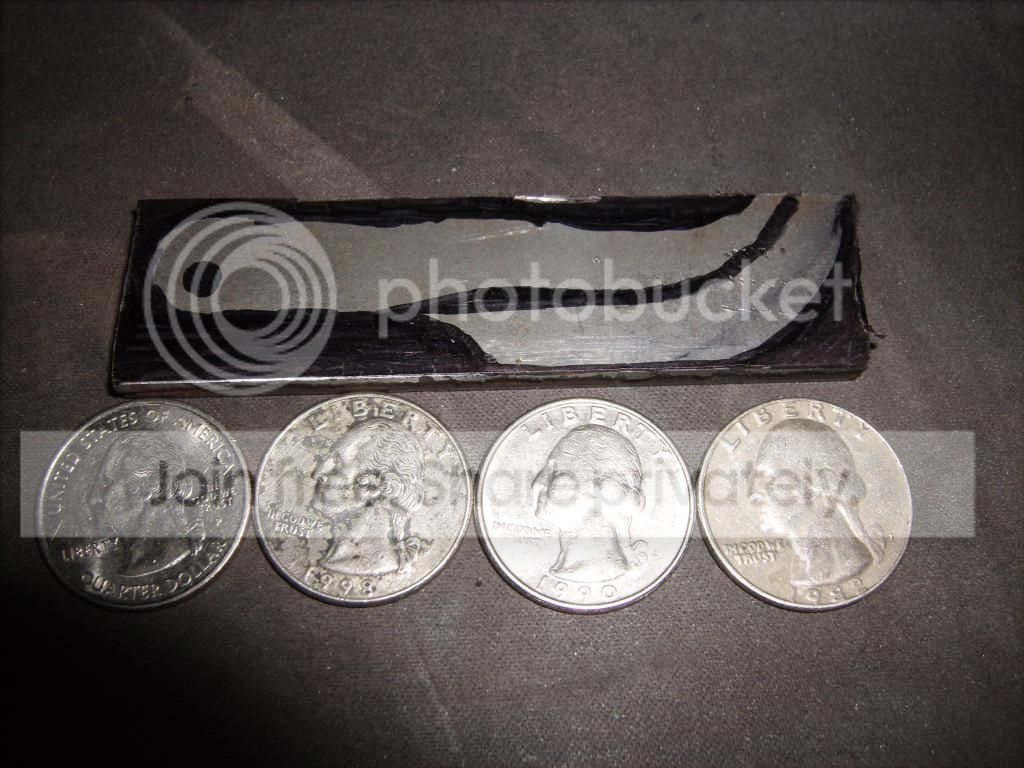

I am going to start small I was thinking of a small edc blade 2 finger knife thingy. I am not cutting anything yet going to keep looking at this and trying to get ideas. I have a small piece of 5160 I was going to try and make a small knife this is just brain storming at the moment. Just let me know the blacked out areas are where I would remove metal. I figure get some use out of the scrap metal.
I find small knives to be best with a gentle arc going along the entire spine to match the natural curvature of the guiding finger. I'd reshape the handle and drop the point a bit.
good point yeah I am tweaking this some more looking to see whats going to fit in the hand good first and then going from there

The knife you are proposing to make there SUCKS(both versions). It looks like you just want use as much steel as you can, not make a knife that works.
Lay the piece of steel aside for a day or so. Do a few searches here on "three finger knife", read the stickies you've been asked - repeatedly - to read, draw your knife on a piece of cardboard then transfer that to a scrap piece of 3/4" plywood. Cut that out, shape it a bit and see how it feels in your hand. Then modify that, several times, until you have it right.

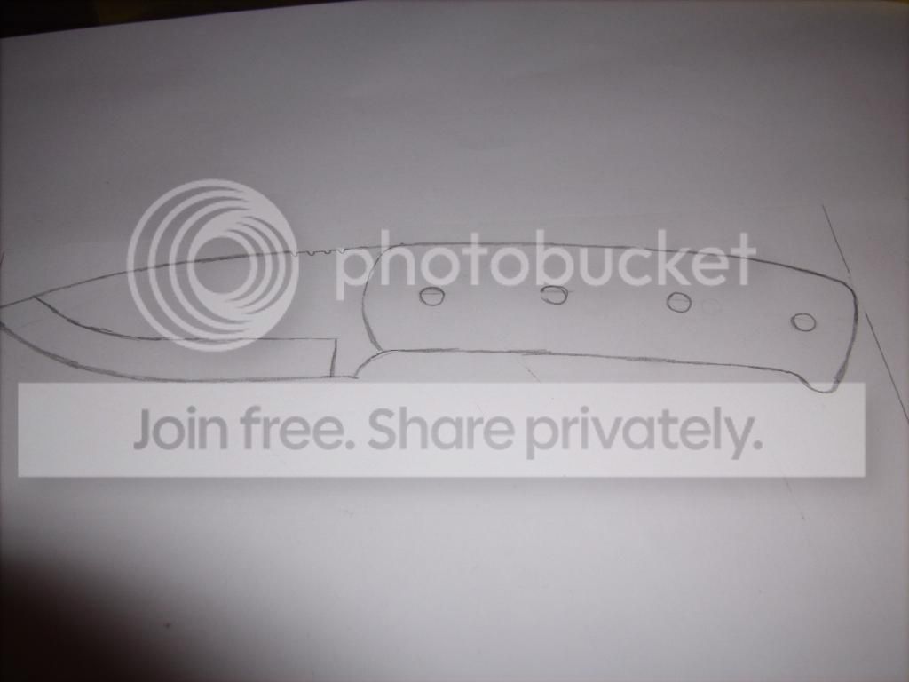

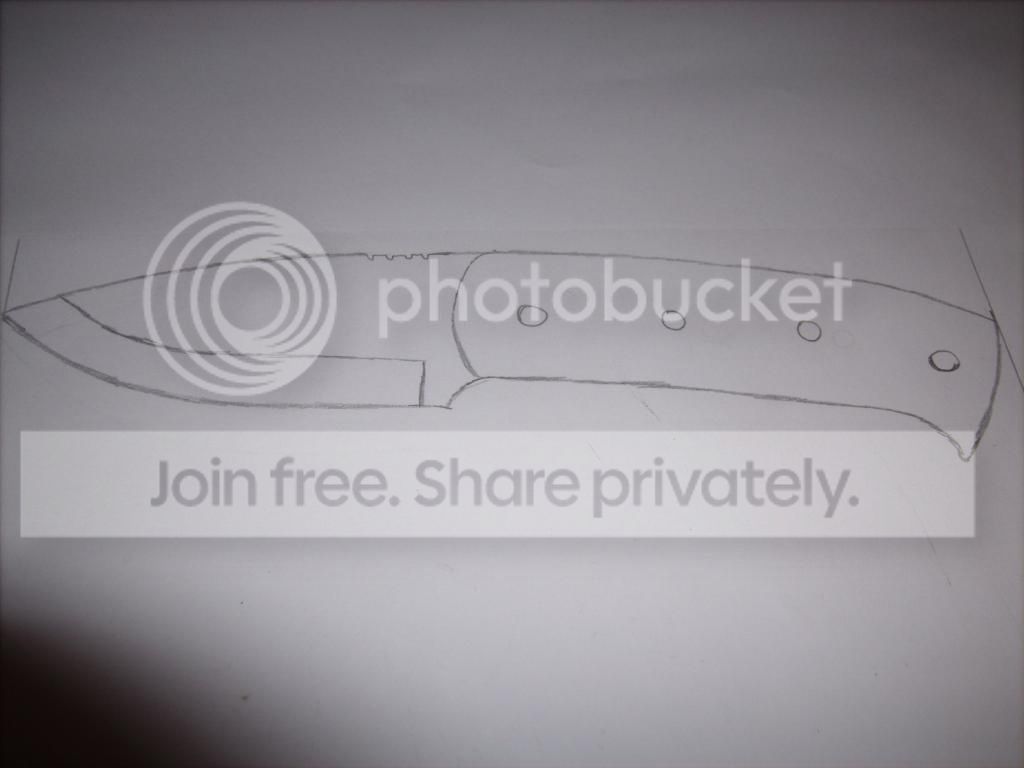

So something like this? I like the curve to the knife I just have never used one but I do see alot of people making them. This is actually the drawing I just did to see how it looks.
Much better.
Round off that pointed tip on the butt, and switch to three rivets. I would also suggest you leave off the jimping.
Yeah was thinking the same thing. I want to stay away from any sharp angles where only the epoxy is going to be able to hold on the scales or is to thin and breaks off.
