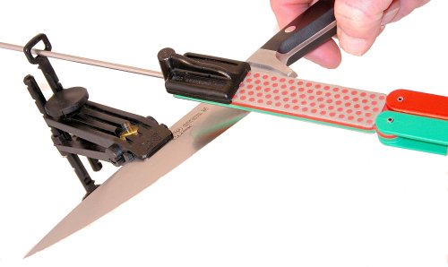

how do you figure? you have to hold the handles of the magna where the stone holder in the aligner system holds the stone for you ..you can sharpen the entire length of the stone where with your system you have to stop down near the handles..infinitely more control... let me show you..
your system

Regarding the 'entire length of the stone', the Dia-Folds are 4-1/4" long (actual sharpening surface), vs. the Aligner hones at 4". So, the difference in usable length is essentially moot. You'll need to stop short on either hone, anyway, unless you're running off the end of the hone on the sharpening stroke, which usually isn't good for the edge.
And the issue of 'infinitely more control' is purely one of individual technique. Haven't had any control issues with my Magna-Guide, vs. the type of holder used with the Aligner (which uses the same 'above the hone' grip as on the Gatco/Lansky, both of which I have used in the past). Holding the built-in handles on the Dia-Folds exactly duplicates the grip used when free-handing with them, which makes transitioning to free-hand that much easier. It's a very intuitive setup.
And, the Dia-Folds come in double-sided configurations, the Aligner hones don't. Only need 2 Dia-Folds for Coarse, Fine, EF, EEF. That's another 'portability' factor to consider.
These are both nice sharpeners, but I think the Magna-Guide & Dia-Fold combination is a more versatile setup overall.
listen im not trying to bicker about this... when sharpening on a diafold you either have to stop at the folded handle or sharpen away from them.. either way you cant go to the end... on the aligner you can hold the stone holder and make a flowing motion going from end to end ... thats all i meant....
Yes, I get that. This is what I was referring to, in terms of 'individual technique'. I also use a 'flowing motion, end-to-(nearly)end', and lifting the hone away. It's a matter of adapting one's own technique to the tool, and each individual is going to adapt in their own, different way, and still produce good or even excellent results. I've never felt a need to sharpen away from the handles, at all (nor would I even want to).

That said, I agree with Obsessed with Edges and add the I prefer to use the handles & have my hands away from the blade & hone while using the Magna-guide.
In regard to portablility you can carry your kit around in a bag swinging from your belt or rolling around in your kit. I like the portability of tossing the coarse/fine hones in a neat folded up stick inside my bag when camping or traveling.
If you want to carry one or two hones and freehand with them then you have to palm the hone or hold it somehow in a precarious way to accomplish this. The use of the Aligner kit or single hones, both put your hand right on top of the edge, during the sharpening procedure. :)
