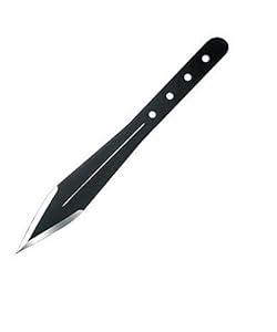

I've just checked by hand.
Cold steel true flight thrower, 1055(or 1075) if I remember.
Hardness - just over (or about) 55hrc (tested with files). Websites say it is from 55 to 57.
Bobby Branton knives (according to his words) - 44-46 hrc
Flying steel - 50hrc (their website).
H&B Forge makes knives from 4140 which can achieve 54hrc TOPS, and at that hardness it would be very tough..
My "customs" are about 50hrc
So I would stand my point.
Cold steel throwing knives are HARDER than most custom/semicustom ones.![]()
