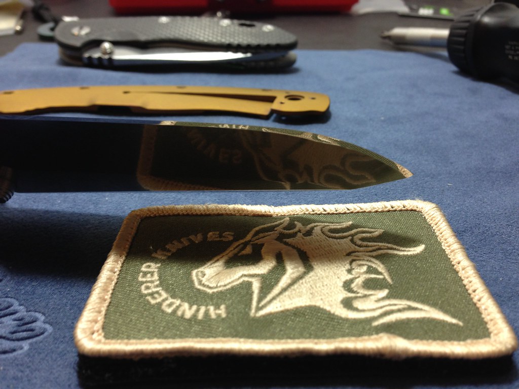

I've been hanging onto the original edge on my primary EDC for dear life but........I'll let the photos do the talking.
Now that the horror show is over its time to sharpen her up and here lies the problem for me - Spanto. (3.5")
I've been using a Wicked Edge Pro for a while now but never on a Hinderer, I've gone through all the WEP/Hinderer threads but still have a few questions regarding the sharpening angle and set-up on the WEP.
I want to match the original primary cutting edge as close as possible, too often I see spanto blades sharpened too acute pushing the shoulders back way too far and ruining the aesthetic of the spanto grind.
From my observations the original cutting edge has a varying angle - it looks fairly acute and consistent from the choil, along the straight to the start of the belly, then it blends into a more obtuse angle through the belly to an obtuse angle at the tip. I would like to keep these angles and avoid pushing the shoulders back along the belly to the tip.

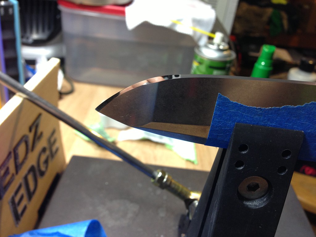

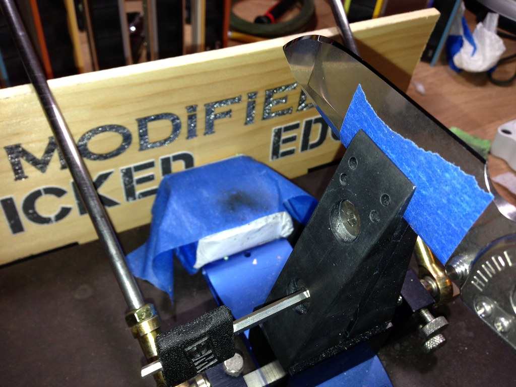

Just did an XM-24 Spanto to a mirror polished finish. For the XM-18 3.5" I'd put it in the bottom holes, letter B-1/2, always use a digital angle guide (if you have the new arms that you can dial in at exactly the same degree). If not I'd set the left arms to 22 degrees & the right arms to 23 degrees to offset the blade thickness. That's why the new arms are perfect because you can dial both sides in at exactly the same degree using an angle finder.
The edge bevel will come out consistent & even if done right, don't need to vary the angle of the choil area to the tip or anything technical.

Everything will be even, though its natural for the bevel to get wider where the 2 grinds meet at the tip because the shoulder is thicker there.

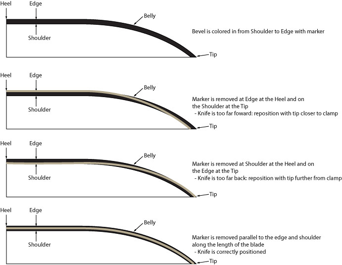

If your bevels are coming out wider at the tip, you just need to bring the knife back towards you. For ex, if you have it in letter C, I'd bring it back to letter B.5. You can use a sharpie on the edge or what I use is a 40x or 60x jewelers loupe to inspect the edge to see exactly where it needs to be to get the bevel even along the straight, belly, & tip. The angle on the belly & tip change pending where it's mounted. Generally the further up you have it the lower the angle which makes the edge wider.
I understand your desire to keep the original bevel. I myself don't mind lowering the shoulder and I have, in fact, changed my edge angle to 20*. I use the level app on my iphone too like an angle cube. Other than that I just use a sharpie and this chart to get it right.
sweet-spot-on-a-curved-knife by GermoneGold, on Flickr
