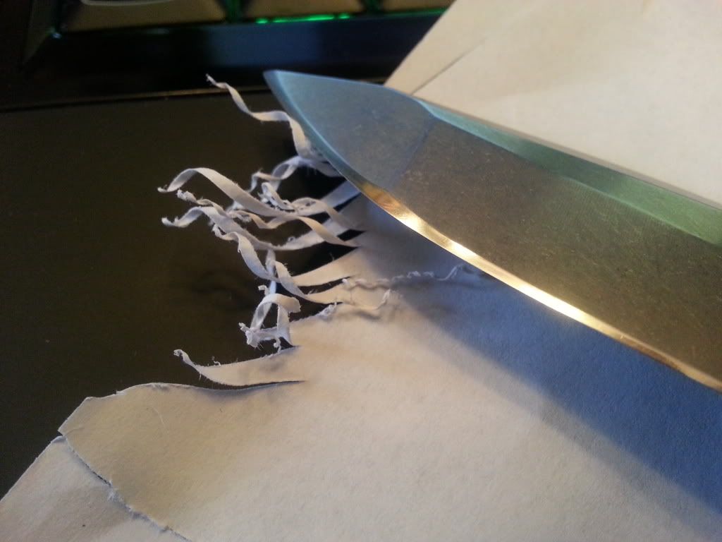

I'll tell ya this knife is crazy sharp. Use it constantly and stropped it maybe half a dozen times or so. Just did it today to freshen up the edge and it snapped right back to paper shredding/arm shaving lusciousness.
Did I mention, I LOVE this Knife:thumbup:
