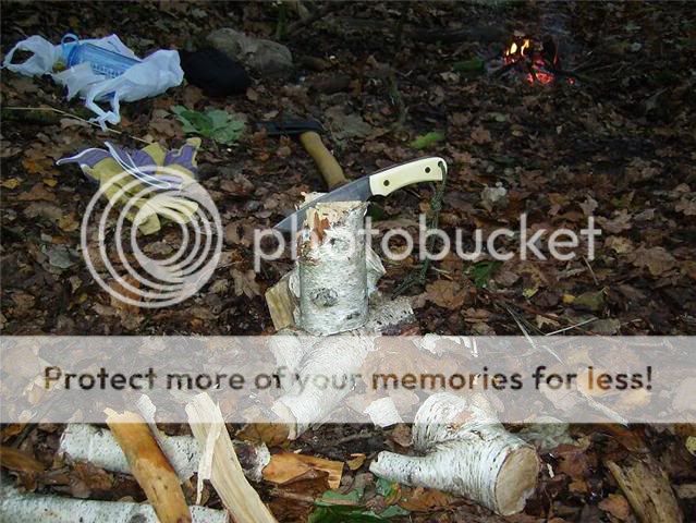

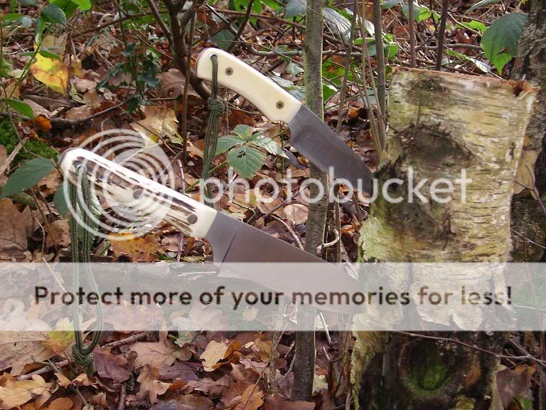

Here is one of " my moderate use " Skinners that a bushcrafter is splitting logs with. Yes he is driving it with a hatchet. That is "MY"
Knife. I don't make a moderate use knives. I make hard use Tacticals and Bushcrafters. I am proud that my clients can and do use them that way. Here is the review from Bushcraftusa

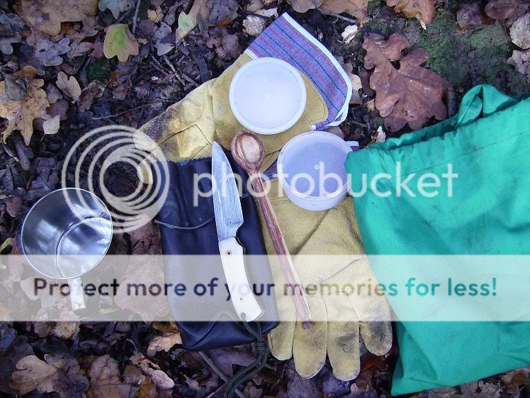

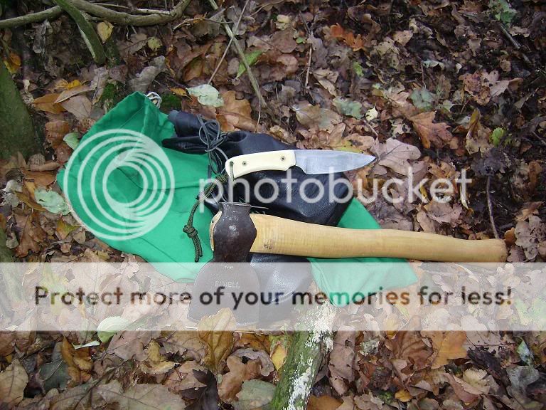

i thought id do a quick review on a knife i purchased from jim adams on the above site
i was looking for a knife with a full size blade but a bit shorter in the handle to compliment the large camp knife that chevin made for me. i saw this and it fits the bill

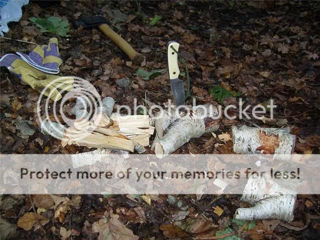

i didnt get it to do things like this but i couldnt resist giving it ago, and it performed realy well.
it works well when teamed up with a large knife or an axe

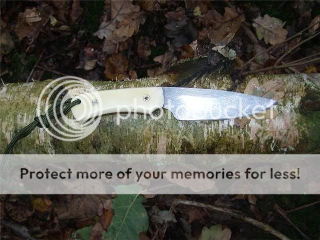

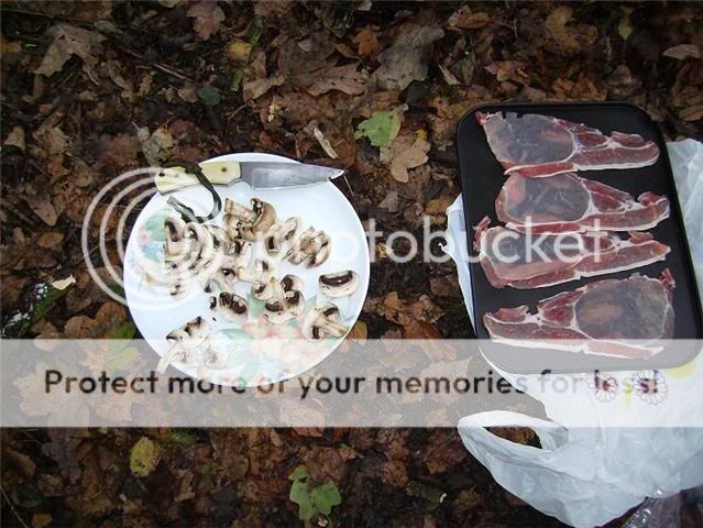

even after being used for carving and battoning, it was still sharp enough to be used for food prep

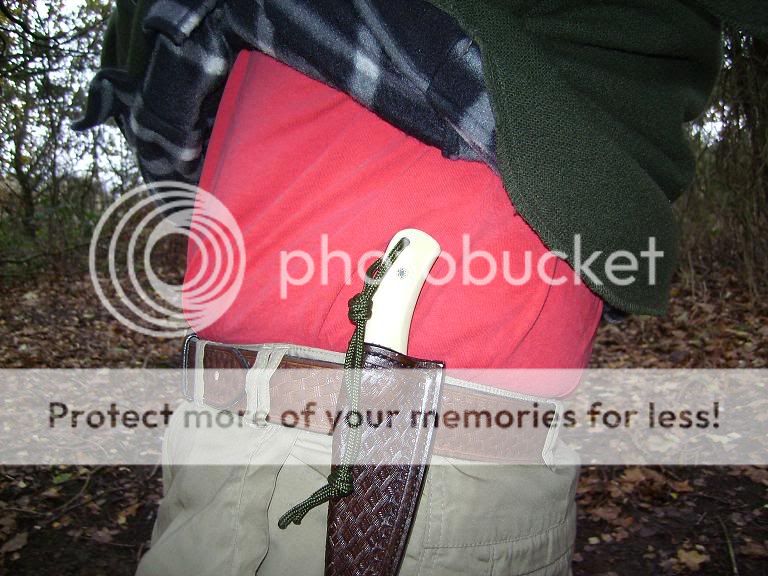

appoliogies for this shot its ment to show the knife in its belt sheath but was a self portrait!

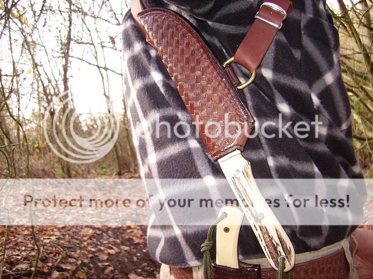

this is the bif knife that i already owned, i bought the black toe knife to complement it
a shot of both knifes together in their resptive sheaths
all in all im very happy with my purchase and will deal with jim again
