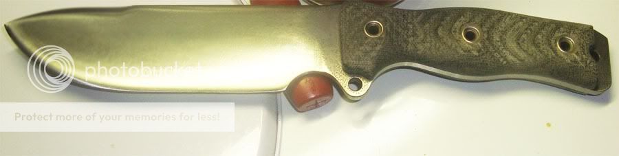

I didn't have much time before work, but I spent some time working it with an 80 grit belt. I'm just working on getting rid of the decarb and the dimples. I figure this would be a fun little project, and it's coming out pretty decent thus far. It's just time consuming with the 80 grit generic belts. They wear quite fast. I ordered some new belts that should be here tomorrow, including some 40 grit, hopefully I'll be able to kill the dimples.
I'm also going to try some cork belts in various grits, up to a polishing belt. Supposedly they have a tighter scratch pattern, but we shall see. I don't know how high a grit i'll end up bringing it, but i've seen some SICK looking SarQs out there, so we'll see where I end up. Sadly I won't have much time until the weekend to grind on it some more. I'm just happy to see the dimples disappearing and the decarb gone.

Here it is with a 1/4 done 80 grit finish.

Edit - All done!
Lookin Good!
