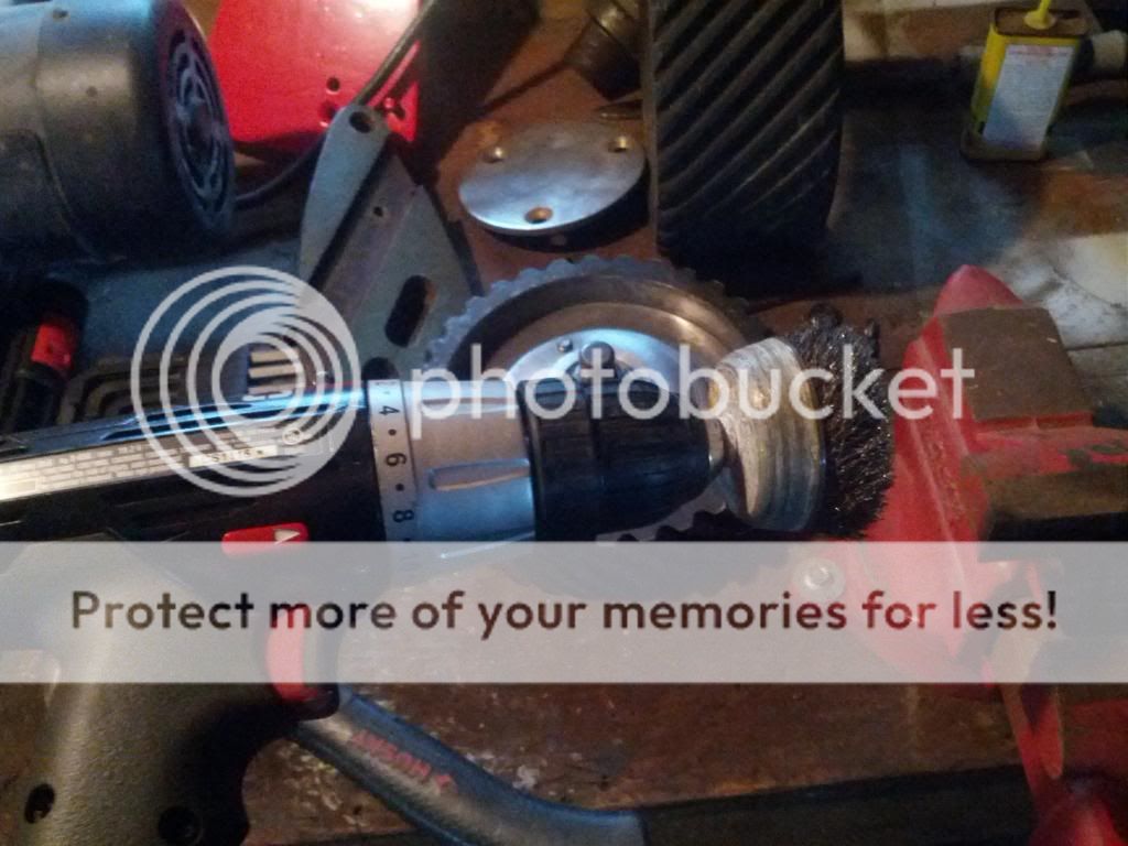

The wire brush really won't get it hot enough to worry about. What are you planning to do with the grinder?
If I was doing that I'd reach for this instead of my angle grinder. The wire wheels you can chuck into hand drills are cheap and work well for small jobs. I got this one at lowes for $3
Are those wheels for a belt grinder?
