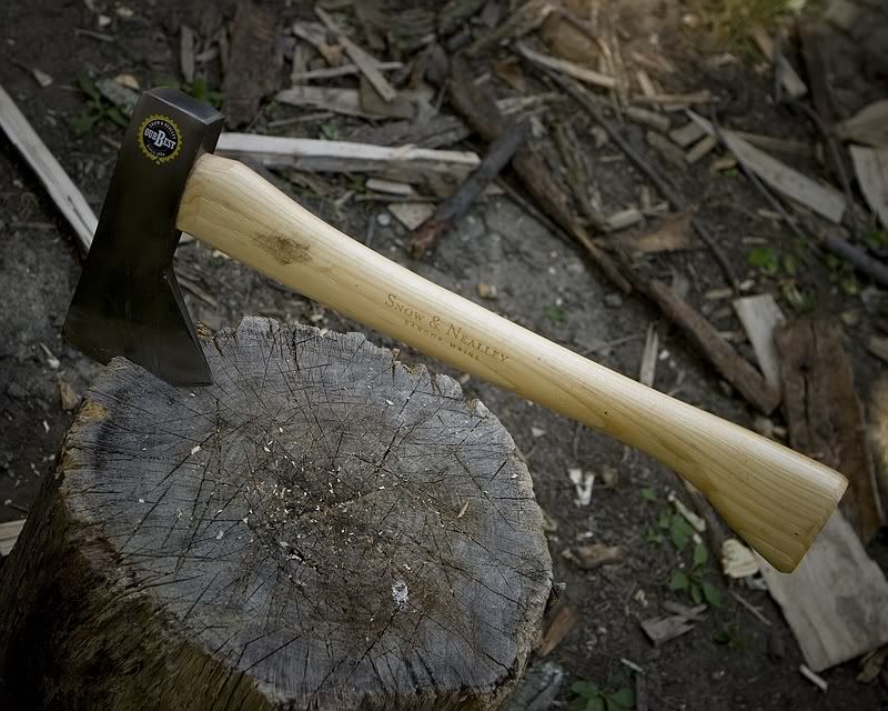

The axe:

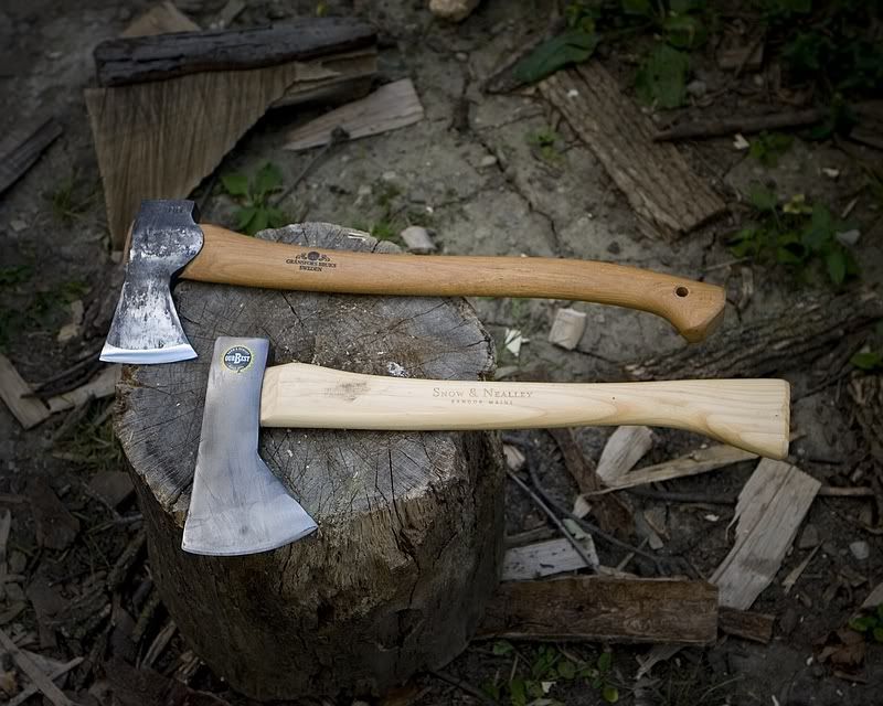

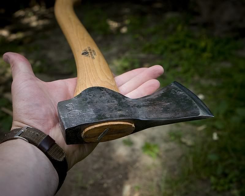

Here is a comparison between the two:

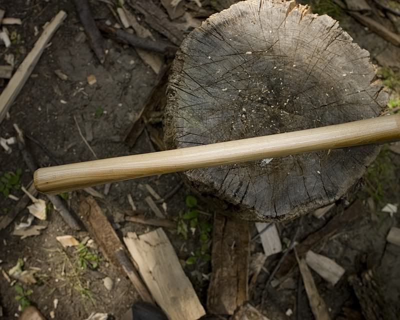

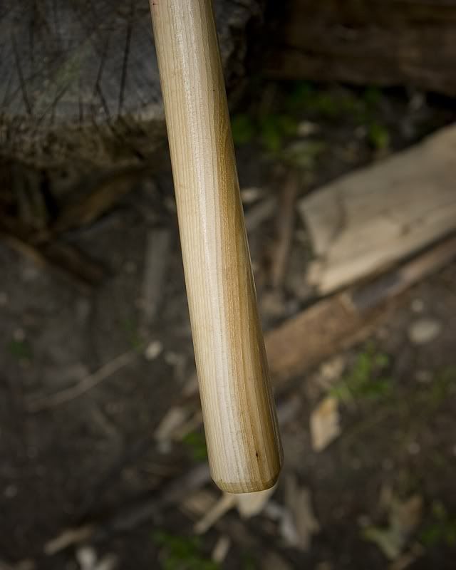

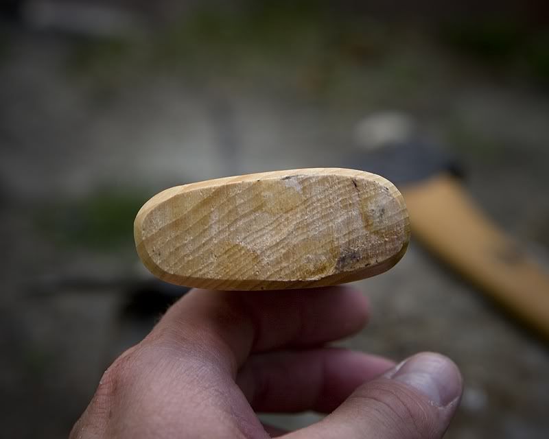

The handle grain is not the best that I have seen, but is not bad enough for me to complain about.
Actually, it is not as bad as it looks there either. It kind of deviates toward the end of the handle, and is rather straight in the rest of the handle.

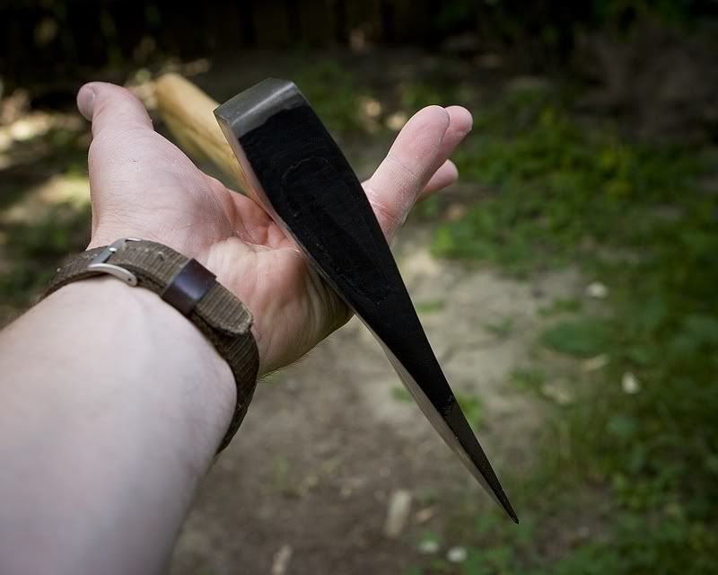

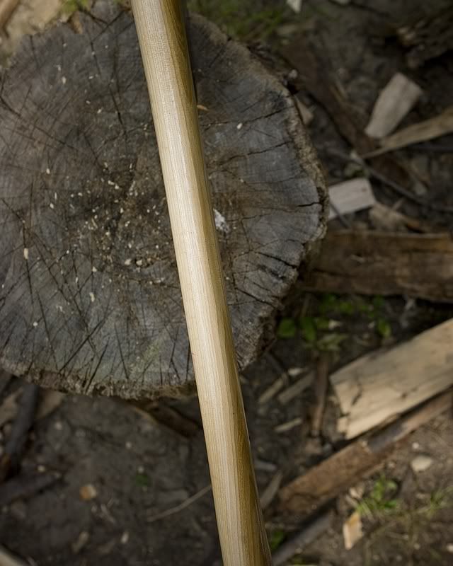

You can see the "sway" I am talking about here:
And then it straightening out:

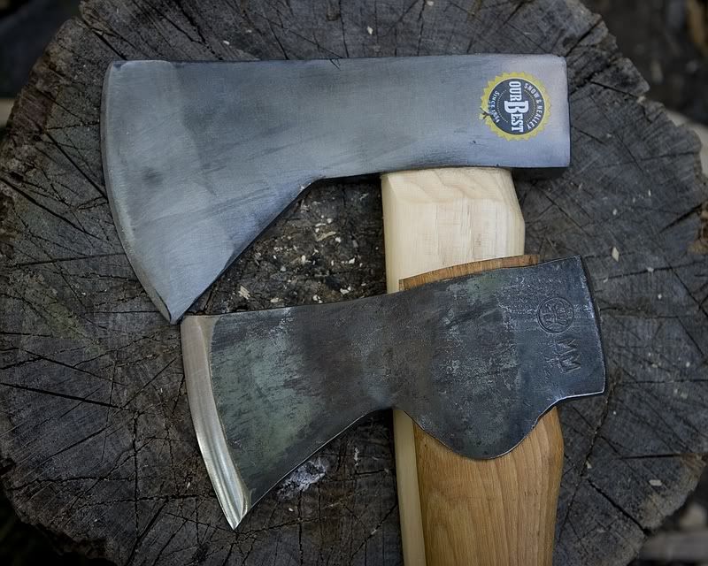

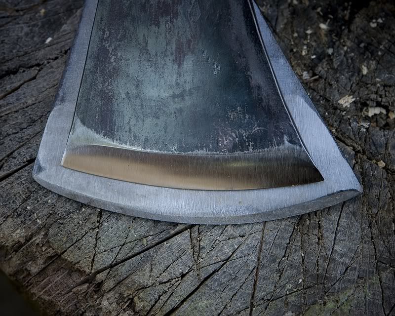

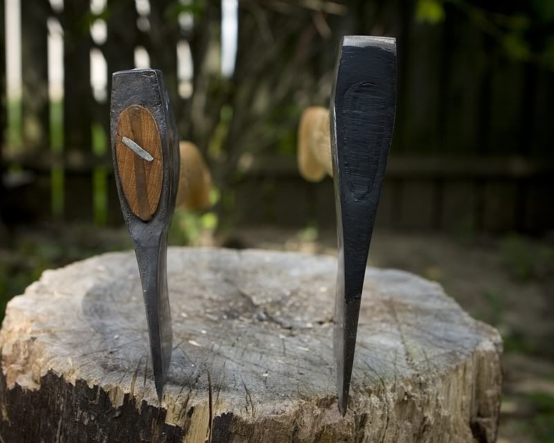

Head profile comparison between the two:
GB profile:

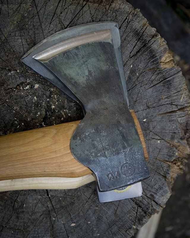

S&N Profile:

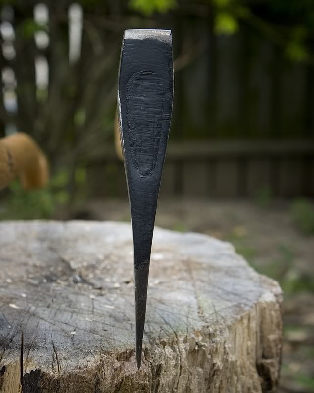

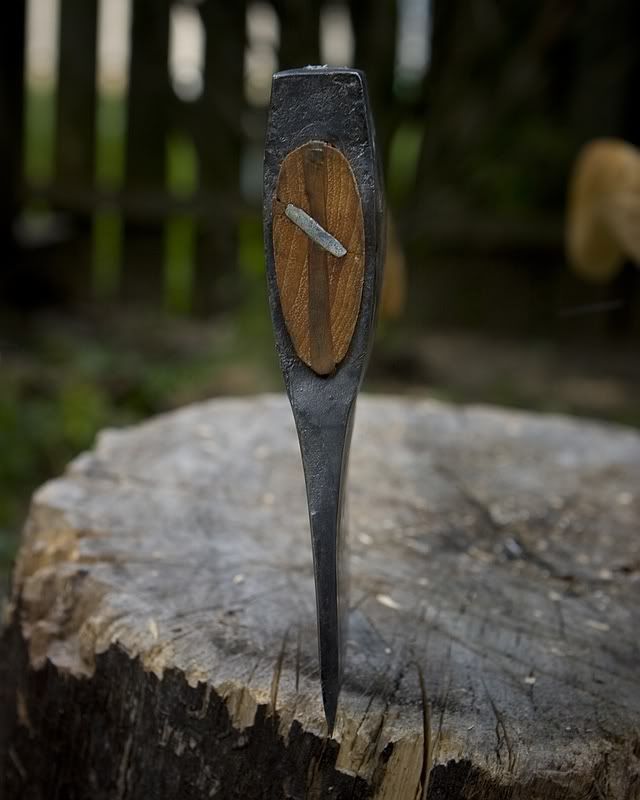

Side profile comparison:

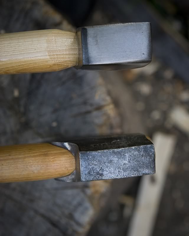

Poll comparison:

- The S&N edge is very slight convex, and then the head goes into a v-grind shape.

- Splitting: The S&N definitely ruled here. It split hard wood much easier in all sizes, both hitting and batoning. I believe this is due to the head shape again. The GB is so thin that as you approach the eye, the metal is actually concave, and it doesn't work as a "wedge" very well.

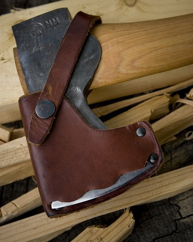

Yep. Its good to know you stitch your own. Ill bet a kydex insert in the sheath edge would be a usefull addition to a leather sheath.

Head geometry
If you consult any authority on axe head shapes you will find that the GB shape would be classified as "limbing." That is why I showed pictures of the profiles. Now, I LOVE the quality of the Gransfors, but I want a more "general purpose" ax than I do a limbing axe.
While the GB, with its geometry, does great on limbing, it also will cross cut (buck) softwood well enough that there is not much reason to look at a different axe. Try the same thing with really hard wood (like we have here in Michigan) maples, oaks, ashes, etc, and the performance is just not there.
My first two priorities for an ax this size are cutting hardwood in to smaller pieces (via bucking) and getting small and larger wood chunks in to smaller piece (splitting). The concave nature of the GB makes it not a good splitter on hardwoods. The thin head just keeps penetrating without much wood splitting going on. When the eye of the axe is reached, the concave nature of the head wants to push the axe back out of the wood!
