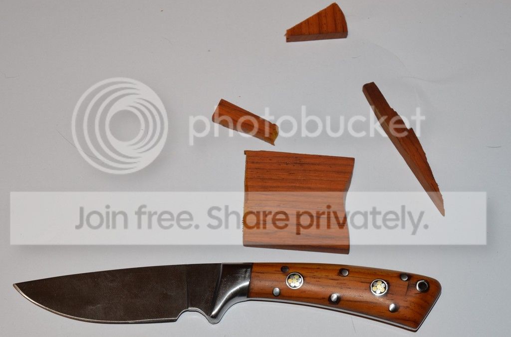

Gray cocobolo scales after sanding
You said "During filing and early sanding the wood would remain orange " so this makes me think some combo of wet sanding/heat/metal dust is to blame ??? A picture of the scraps may help.
Should I email the seller (knifekits.com)? I paid thirteen bucks for it to be good wood from what I thought was a reputable dealer. I'll post a link to the page with the slabs once their website starts working again. I'll also post a picture of the scraps next to the finished handle.
Don't email them until you sand off the top coat with 400 grit and bring it up to about 1000-1500 grit and throw some kind of finishing product on it. You may find you like it even if it doesn't look like the cocobolo you're used to. Also, for 13 bucks you can't expect a whole hell of a lot, truth be told.
I think it is sapwood also. Here is Cocobolo sanded to 1200 and buffed.
Coco bolo sap wood is WHITE, not gray. Rubbing coco bolo (and many woods) with most solvents, alcohol or other chemicals will leach out the pigment color in it. Pigment colors in heartwood are referred to as "extractives" due to this physical event.

Here is the almost finished knife next to the scraps. I have two coats of tung oil on but i have not buffed it yet. The color looks pretty close to me. I dont know if it is sapwood or not but i am pretty satisfied overall. At least I have learned some things for the next knife I make
Thats not sapwood ( with the exception of maybe a small strip on the top) . Did you do anything to it ? because this new picture the wood is a different color ?
I sanded from 220-400 in sandpaper to get the color correct and then I went from 1500-2400 in micro mesh. Then I added the tung oil and let it dry.

I'm not sure how much I am liking the oil treatment but we will see if it grows on me before I change anything
I know cocobolo varies a lot, but that just doesn't look like any I have ever worked. It has always had darker color and bold stripes when I bought it. The other photos shown of cocobolo handles all look like what I have worked. Your handle looks much more like paduak.

The Panamanian cocobolo looks a bit like yours, but it still isn't straight grained.
http://www.knifekits.com/vcom/index.php?cPath=40_553
Knifekits is a good supplier. I haven't ever bought cocobolo from them, but I buy screws and springs, and some laminate material. I would send the photos and ask if what is shown looks like their other cocobolo. It is possible they sent the wrong wood or it got mis-labled.

I'll email them to see if there was any confusion. It does look like the paduak you posted

I'll email knifekits. It's pretty wood but since I don't have experience with exotic woods I didn't notice the difference right away. I will know for next time and hopefully I will get some money back for the difference in price
I just spent the last hour looking for some pictures of some cocobolo I cut a few years ago (because some of it looked very much like this) and I think most were on a hard drive that failed so they are lost. But I went back and found this picture from a sales post here from 2011 , if #2 was quatersawn ???
If I had my old pictures I could show you a picture of cocobolo thats pretty close to his scraps. To me it still looks like quatersawn cocobolo ?? wouldnt bet my house though.
