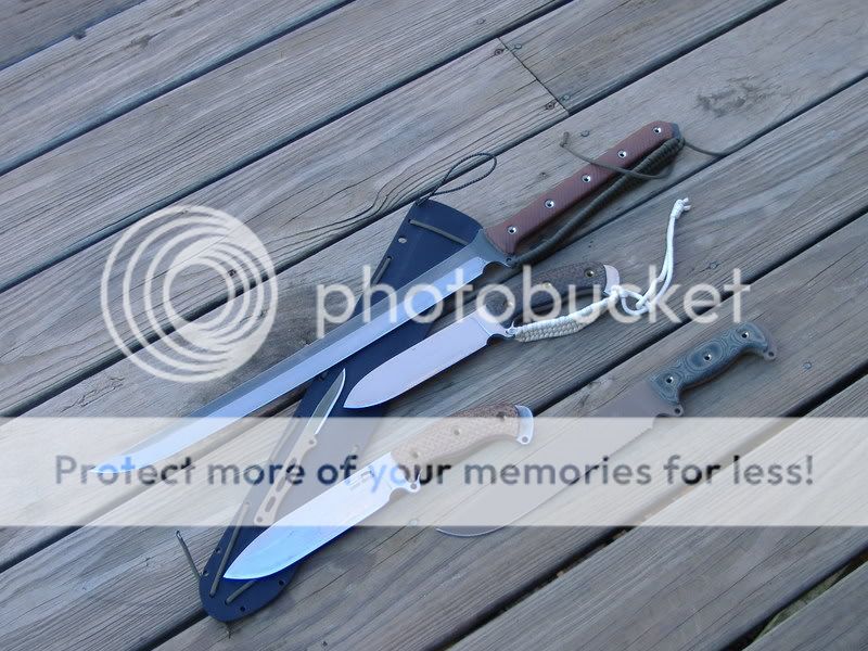

I sharpened a 16 inch (yes, the blade) "bowie" knife it took several hours ate up my stones because so much metal had to be removed, it was a hand made knife that a machinist made and tempered about 10 years ago... without ever being sharpened.
from now on, if the blade's that jacked up it's gonna hit a sander first, at least for metal removal.
I need somebody to sharpen this for me. I don't have any stones.... :cool:
