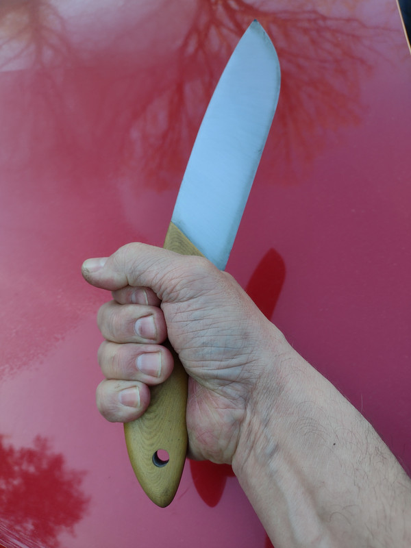

I LOVE that potato feel!
Me too. Underrated. Great grip for draw cuts.

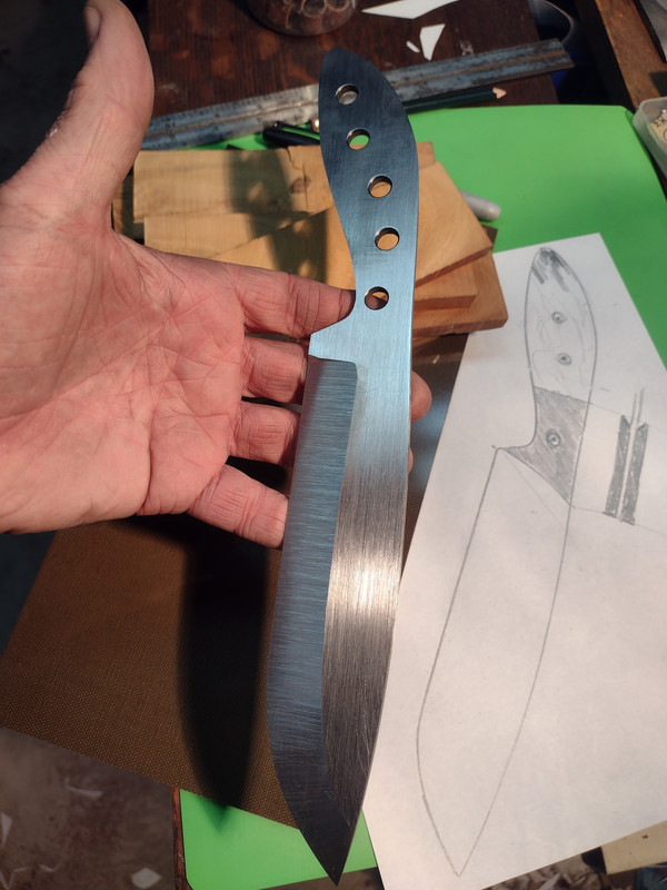

Hello, what a beauty!Rough grind freehand takes forever it seems.
Currently I grind my bevels Hard, post heat treatment. The thought is that the edge gets a even treatment since it's all the same thickness steel. I'm told less warping. Makes sense.
I might experiment with thicker steels next year.
Later this year (hopefully) I have a 1/4" slab of M4 I will be grinding....a Big Field knife.
Idk how many weeks I'll be at the grinder? Haha.

I first grind my primary grinds flat, past a saber grind, then I'll blend into a sorta Convext grind. Later. It's a very strong, very sharp edge.
Here I'm going to add a carbide "bump" stop and then I'll blend my bevel lines into some sort of a plunge. Free hand.

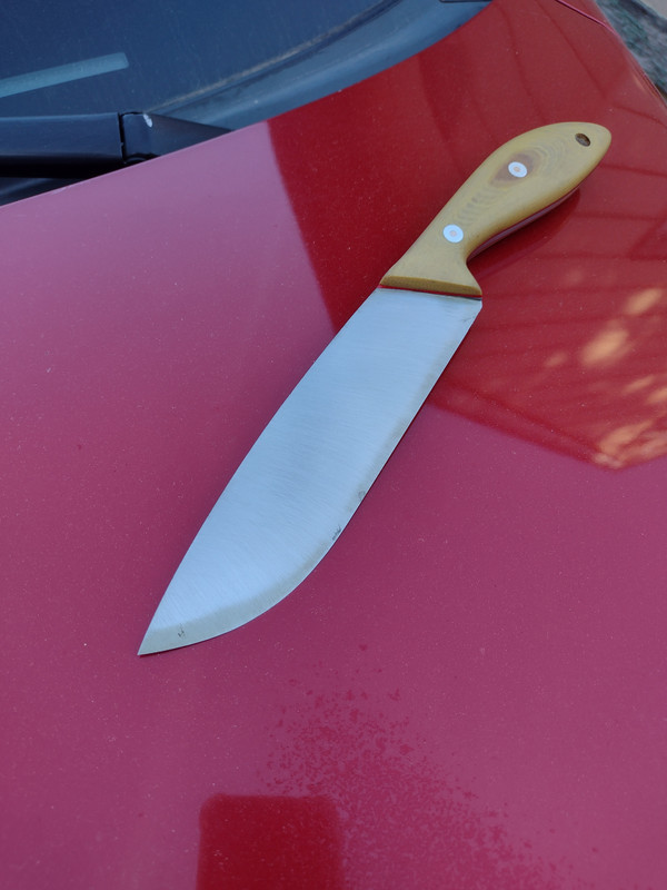

The red and oatmeal look great together.
