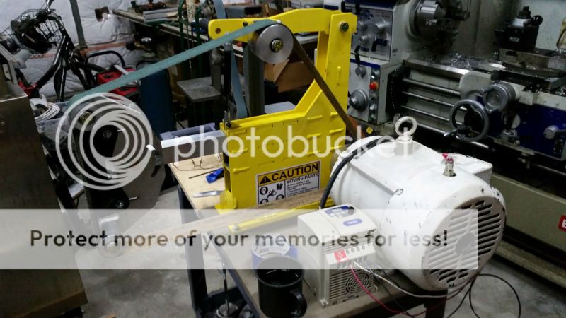

Now that I've figured out why my motor wouldn't run right, I am getting my grinding cart fixed up for use. Photo attached.
I am wondering if anyone can shed a little light on the issue of VFD placement.
Obviously, this VFD is not enclosed. I would really prefer not to buy a printer-sized box that will cover the remaining space on the platform. I've noticed that not everyone uses an enclosure. I saw a photo here of an Esteem grinder with a VFD mounted on a stalk about a foot high, presumably to get it above the flying crap. Is this an acceptable solution, or would it shortly result in a fried VFD and broken dreams?
If a stalk won't work, I was thinking of simply putting a couple of pieces of acrylic (vertically) between the VFD and grinder.
Metal dust from a grinder gets everywhere. I have my VFD on a "stalk" as you call it, but it's a nema4 enclosure which is dust and water proof. It also has an aluminum heat sink to dissipate heat from being enclosed. If you don't enclose and cool that VFD, it's more than likely going to let it's magic smoke out.
Mount the VFD on a wall or even in the next room. Run the wires from it to the motor and to a remote On/Off switch and a speed pot that are at/on the grinder..
Alternately, put the VFD in a box to keep the dust out. The VFD would be fine mounted inside a plastic storage box for shoes ( about 6X6X12). Making vent holes with filters covering them, and providing air flow from a small computer fan will keep the VFD from burning up.
Mount a 2x4 vertical by your motor and screw in a clear tote with a lid. Cut out a whole for the VFD bada bing. It may seem ghetto but from what I read it works good

I used to have it on the wall when I was using it to run my mill, but that is not an option with the grinder. I suppose I will have to go with the enormous unvented can option. I really don't want to construct a metal box with filters and fans that have a separate AC supply. I guess I can put it in the lower tray of the cart, which I had hoped to use for storing other things.

There are large switching currents in the power section of a VFD. These produce much of the heat that needs to be got away by ventilating. The same high switching currents also produce magnetic fields which will attract fine steel dust to the power switching components. This double whammy means that it's not so much a question of whether an unsealed drive in the vicinity of a grinder will fail, but a question of when.
With a lathe or milling machine, you'll generally get away with mounting a drive on the wall behind it, or somewhere else that the relatively big bits of metallic dust will not reach. With a grinder producing lots of fine dust, it's much more difficult.
Definitive answers are not really possible, especially without knowing exactly how everything else in your shop is sat up. For example a guy with a state-of-the-art extraction system might have no problems at all because all his dust gets captured.
If you are a fastidious individual (many knifemakers seem to be), have a location that never needs brushing, vacuuming, etc, and which will never transfer anything to a powerful magnet when you sweep the area with one, that "might" be an acceptable location for the drive.
Otherwise, seal it, move it to a clean location or build the cost of regular drive replacements into your knifemaking budget.

If you want to find a VFD box without going insane, do not search for "project box" or "cabinet." Search for "NEMA enclosure."
I found something that looks okay, for an amount of money I can stomach. It's a hinged BUD Industries 10x10x6 box.

move the VFD to the other side of the motor mounted on a 'stalk', piece of flat stock or angle iron so the control panel faces you when you are standing next to grinder. find a piece of 1/4" aluminum the size of your VFD back(the heat sink), drill holes for VFD, mount on 'stalk', then mount the VFD. if worried about dust, get some loose furnace filter material and fashion a cover for 3 sides. if i remember, your fan blows out, so leave that area uncovered. just moving the VFD to the other side of the motor and above it will get it out of most of the dust.
scott
Scott has a very good answer - move VFD to other side of grinder, with VFD bottom mounted a foot or so above table. Cut sections from a fabric type AC filter to cover the air inlets to VFD. I've been running a NEMA 1 Chinese VFD for a couple of yrs now mounted that way. That is with "hobby" use, NOT a full time knifemaker type work. If used for full time knifemaking, then bite the bullet and buy a NEMA 4 rated VFD.
I decided on the Chinese NEMA 1 VFD because it's cheap - just a tad over $100 shipped for a 3hp rated unit. I can buy 3 or 4 of them for cost of one NEMA 4 27D 2hp that is close to $400!

The easiest way is to buy a VFD with a NEMA 4, or IP65 rating enclosure

I'm sure other people are in the same boat, so for their benefit, I will give info on the box I found. It's a BUD Industries JBH-4961-KO. The volume is about 600 cubic inches.
