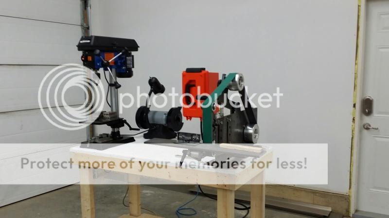

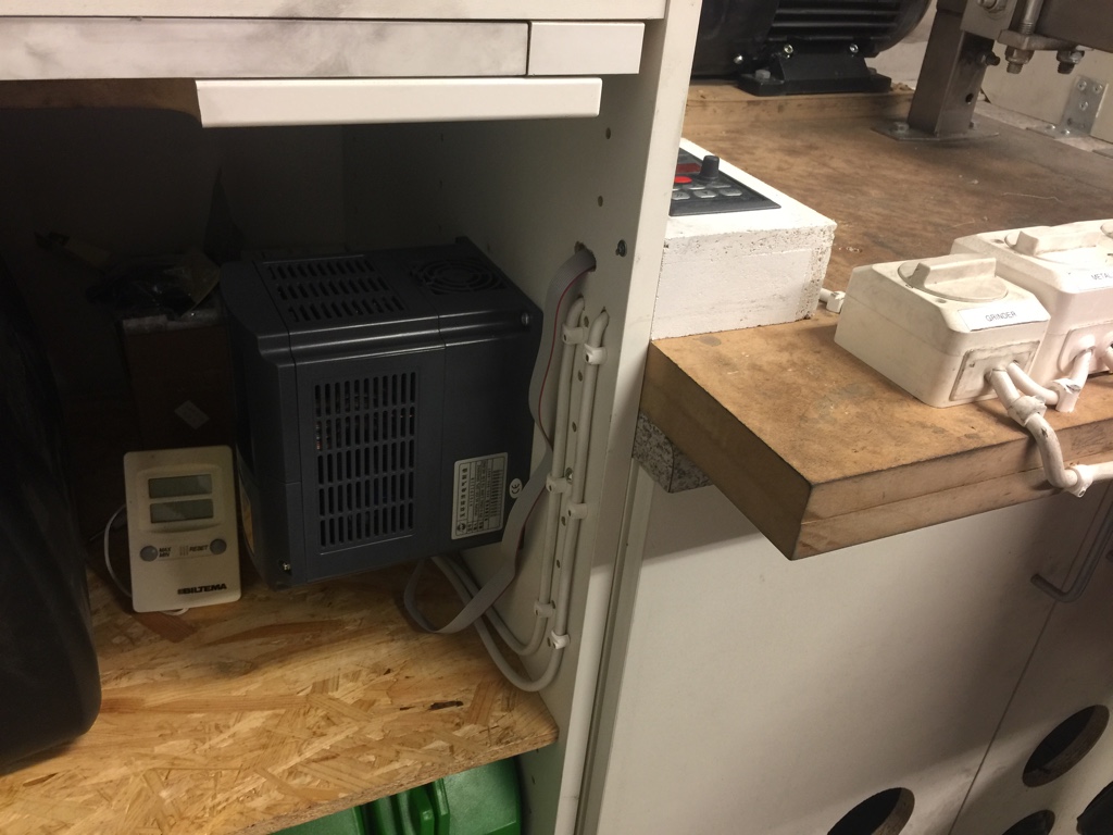

I run a KBAC Nema 4 drive on my 3HP grinder and it's mounted on the wall right behind the grinder. Never given me a lick of problems.
I put my Chinese non-nema VFD in the adjacent cabinet and ran the control box through the wall. Works just fine.

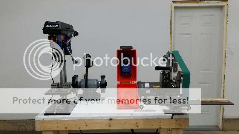

So here is what I've been working on. Almost there. Still have to hinge the door and mount the fan and filter and then wire it all up. Does anyone know if my vfd will run 12v DC accessory?
I left room at the top of the vfd so later I can add buttons and rheo instead of opening the door.

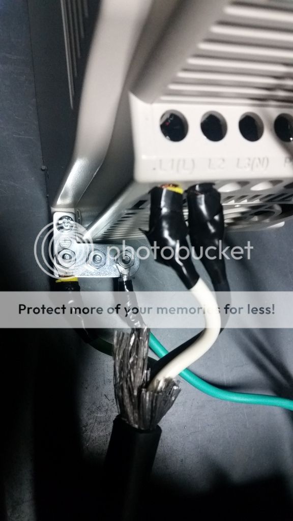

I'm so angry. I went to hook up the wires on the vfd and low and behold the terminal for L2 is not there!!??! I guess I'll be calling Monday to tell them they forgot to install a terminal. [emoji35]

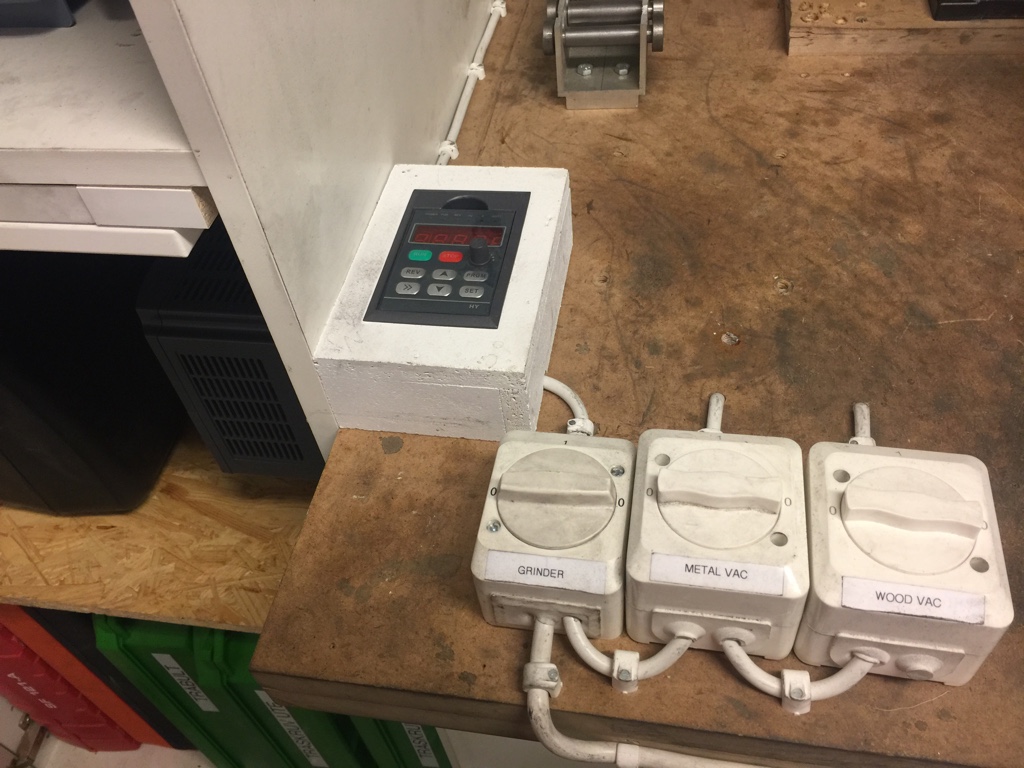

I put mine in a dust proof box and mounted it on a chunk of 2x4 attached to the back of the bench. LOL, that's a long time ago when my garage was clean.

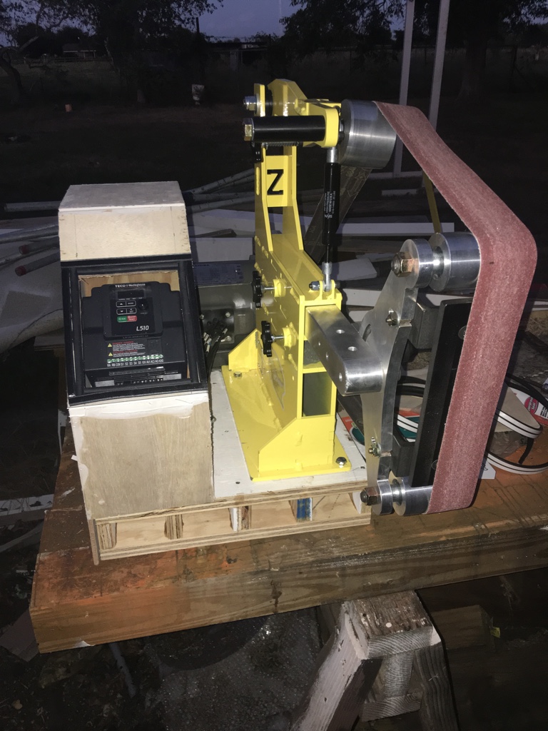

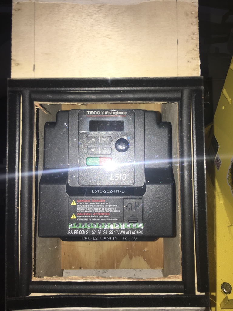

This vfd is a 220volt single phase input. I called deleted electric and Teco tech support and am very disappointed. I'm not a licensed electrician but understand electricity well and have wired up house and breaker panels. 220v single phase requires 3 wires one leg is 110 hot, and leg is 110 hot and the other is a neutral or return. So where do you you hook the wires. No matter how I explained it to them they just kept saying hook to l1 and l3 or call and electrician. Then they would say you get 220v to your house and that's one wire and it jumpers over and stupid crap. Uh no. Anyone delt with this before? They seem to think it suppose to be like that and it's not making sense to me. I only have two terminals for input voltage on the device and a separate ground.
They seem to think it supposed to be like that and it's not making sense to me.
It is like that
Read the manual
It's only a neutral if you need to get 110 out of it, like a dryer plug that has 4 wires
Two hots and ground are 220V
Ok thanks for the clarification. I asked them if I hooked it up like that and used the ground as return and they said no. When I asked them that they then said L3 was return and L1 was hot lol. It just seems funny the people I talked to were so clueless and not willing to help at all. There has to be a return somewhere.
Ok I studied up a little more on 220v and understand it a little better. No return is needed on 220v. I thought there needed a return as I always wired it with one. The transformer at the pole takes care of the return through the hot legs of the 220v.
