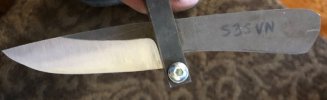

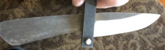

Okay, these bevels have been done with 60 grit to 5degree angle now. The thickness at the blade edge is 0.7mm. The two bevels are very very close in size to each other. I think I held the camera at a slightly different angle when I took the pictures and they don't appear so even here. But they are quite even when I measure.
Do I do a few passes of 120 grit now? Should I be going to 4 degrees or is this good? I'm not sure how far up the grits I should go before ready for heat treat. I know I still need to drill holes.
Some cool things I learned. Elbows into my sides, get bubble lined up gently near belt, lean in and sort of rock/lean body across and things usually stay pretty good.
Get off it when things go wonky. Had a few passes where I would start to chase the bubble but was going in the wrong directions and it all went whacky fast when that happened. Eventually I just stopped a pass when this would happen and start over again and it seemed to clean up the screwy pass before it.
Looks Good...I would take up to 400 grit...heat treat...drop back to 220 for a couple passes 320-400 and finish at 600.
Looks good.
Just a note, you should already have your handle holes drilled.
Grinding the bevel before the tang holes can lead to an accident if it helicopters when drilling.
Ahhh...didn't think of the possibility of helicopter with a close to finished knife. I had a thin piece of steel helicopter years ago and mostly cut the wire going up to the drill press. At least it shut the press off for me.
Take it up to 400 grit...does this mean 120, 220, 400? Or do I need something between the 220 and 400?

That will work fine because after heat treat you want to drop back a couple grit sizes to clean up any lingering deep scratch pattern.

View attachment 1095638 View attachment 1095639
Taking shape. You stop when the height is where you want it to be. Finishing all surfaces of the blade before heat treat, to a grit of 220 or 320 is a matter of choice. Each making makes their own call. You will do finish grinding and sanding [after] heat treating is completed. Look up information on the different steels you are using; each one has different parameters on how thin the edge can be at heat treat and still come out straight, without a wrinkled edge. Trade offs. Finishing the ricasso before heat treat is a given; most makers take it to 400 or 600. There should be very slight sanding in this area after the heat treatment is complete.
