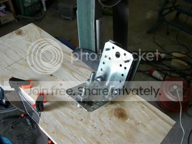

Hey guys
I was wondering if any of you use some sort of holding device like I do
Without it my flatgrinds suck and it takes more time
SO I would like to know if there are any other devices,angle rests,..out there which are essential? :confused::confused::confused:
Would be great if you could post some pics:thumbup:
Tom Krein talkes about a "angled rest on the flat platten" in one of his tutorials on USN
Does anyone use something like that too ???
PICS would be GREAT!!! :)
thx
Al

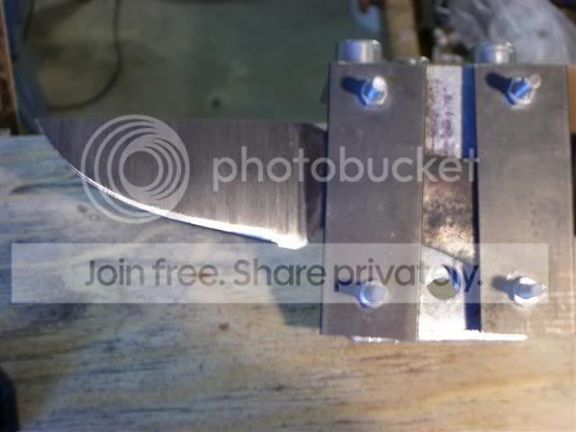

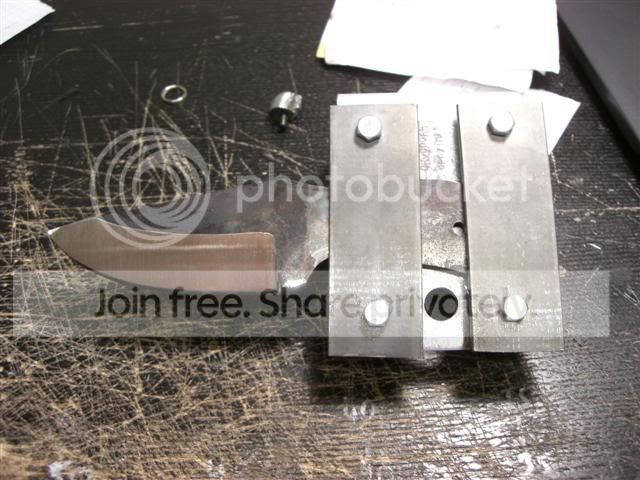

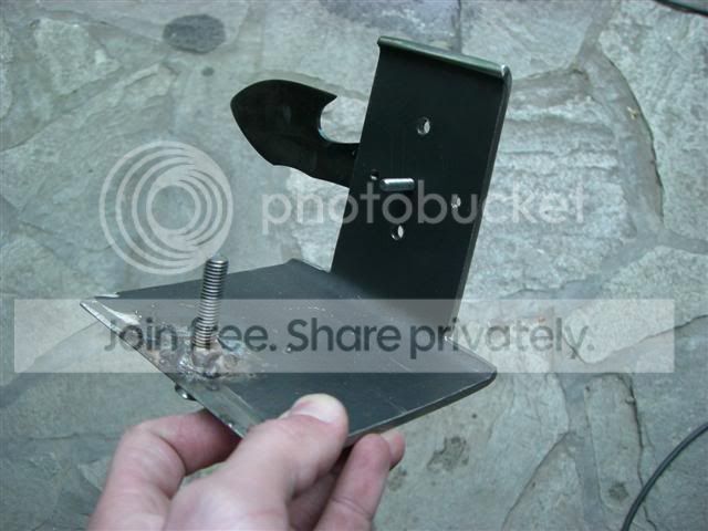

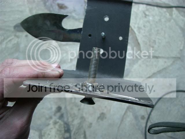

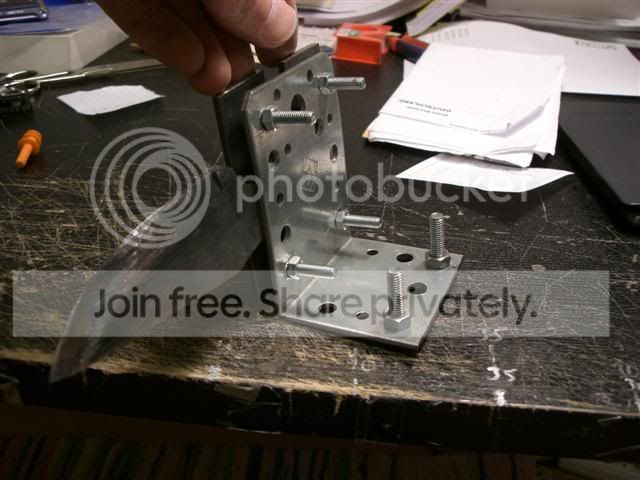

all you need are a few screws, a welding machine,2 angle iron, and a few pieces of flat steel and thread rod
the screw on the bottom is for adjusting the angle
you need to wled the nut to the angle steel
after that I took the second angle steel and cut it in half.
cut 2 pieces of flat steel to length,drilled holes and screwed them together using thread rods
the only thing you have to do now is drill matching holes in the angle iron and insert the thread rods through
I already made 3 jigs so don´t get confused.
took some time until it worked the one from post #1 pic 2 is the one I´m talking about
Al

Also, none of the jigs pictured here support the blade tip or blade. As a result, you will often get uneven grinds. As you grind more, the blade will flex more, causing the grind angle to constantly change unless the stock is so thick or blade so short it doesnt matter. A proper jig would support the blade tip to ensure the grind remains consistent as the blade gets thinner and wants to flex when you push it into the belt.
