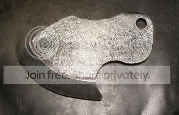

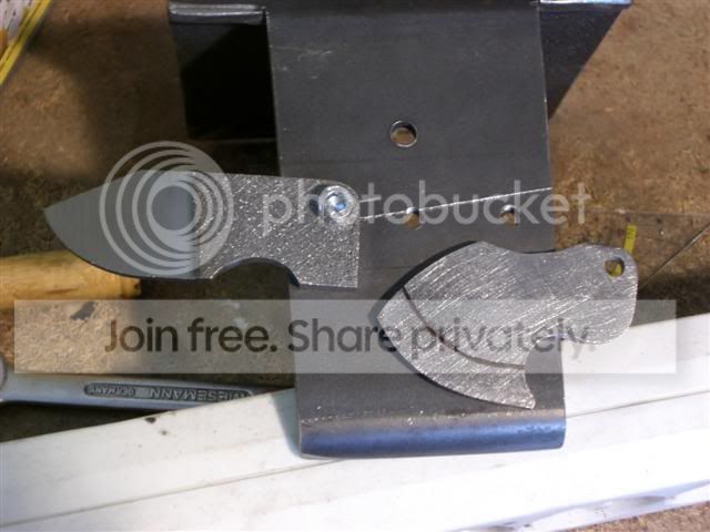

started freehand on a very small blade OAL 1.9"
but it´s so damn small I couldn´t even hold it
was afraid to grind off my fingertip so I used my jig again
how do you guys hold small blades like that???
screw it on a piece of wood?
thx
AL
if you have a piece of stock thats 6" long and you're going to make a 3" knife, leave the other 3" on until you have completed your grinds.:p:D on the 2 you have showing in the picture, you could have ground one end then taped it up and done the other.
