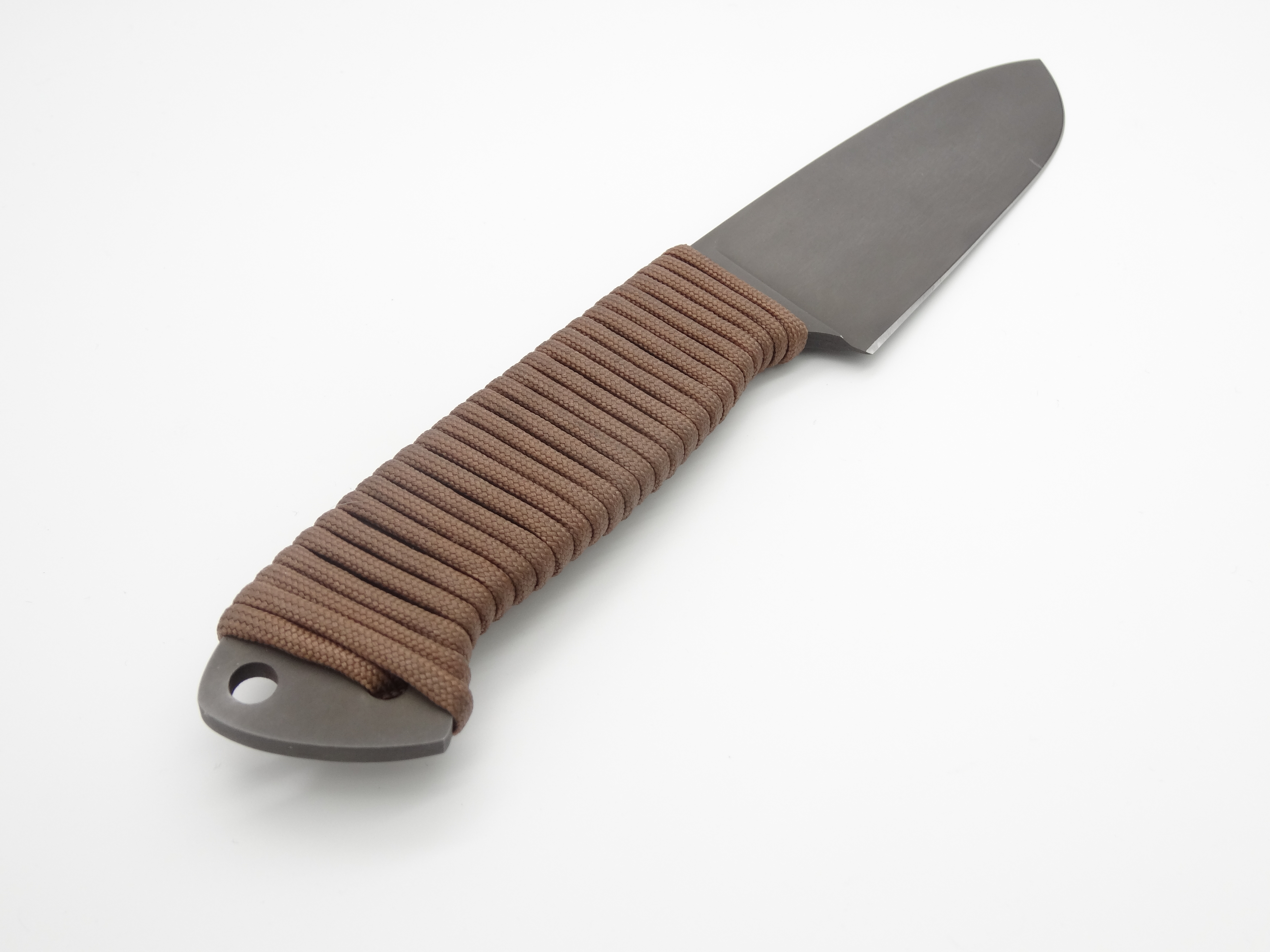

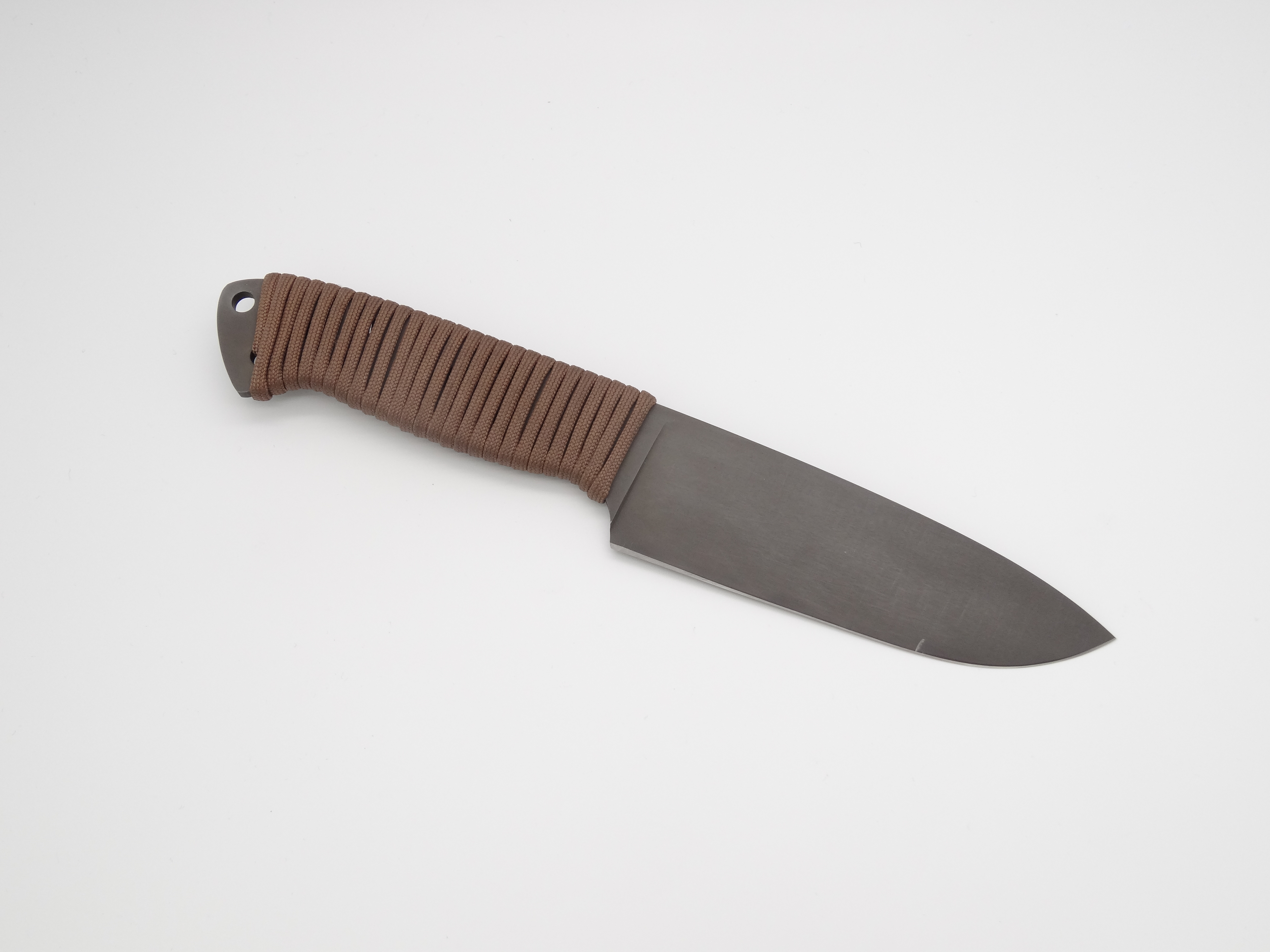

Since I learnt the hard way that Niolox should be nearly finished before heat treat and I didn't want to toss my Moby Dick. Instead, I did a quick finish on it and will give it away to a friend as a utility knife.
Some blades just doesn't want to give up without a fight. Surely I managed to give it a scuff during WEPS sharpening also. Hahaha. I guess I'm allergic to Niolox and should keep away.

As the current record holder, may I offer a pro tip: never grind and hand sand Niolox after heat treat.
