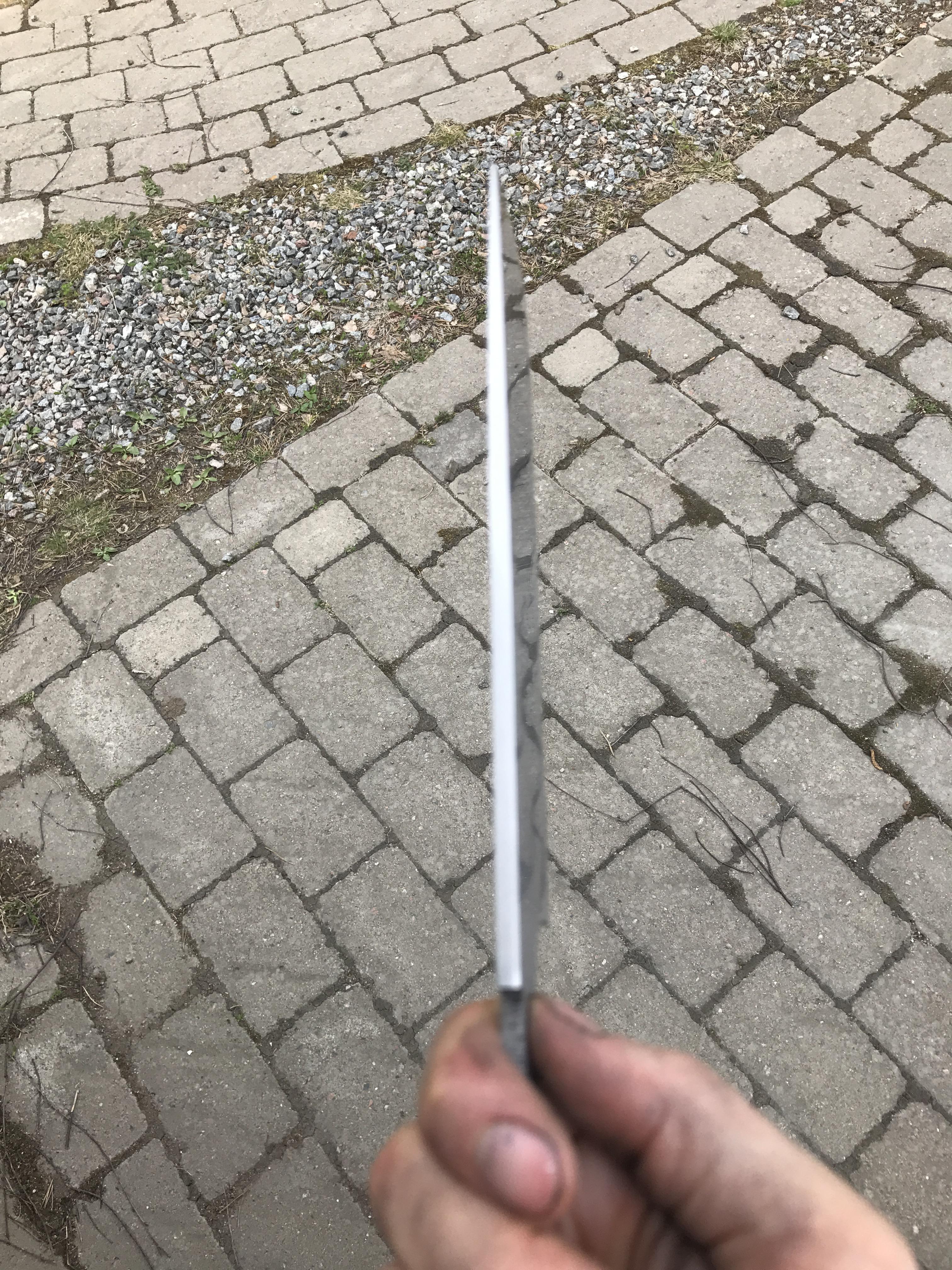

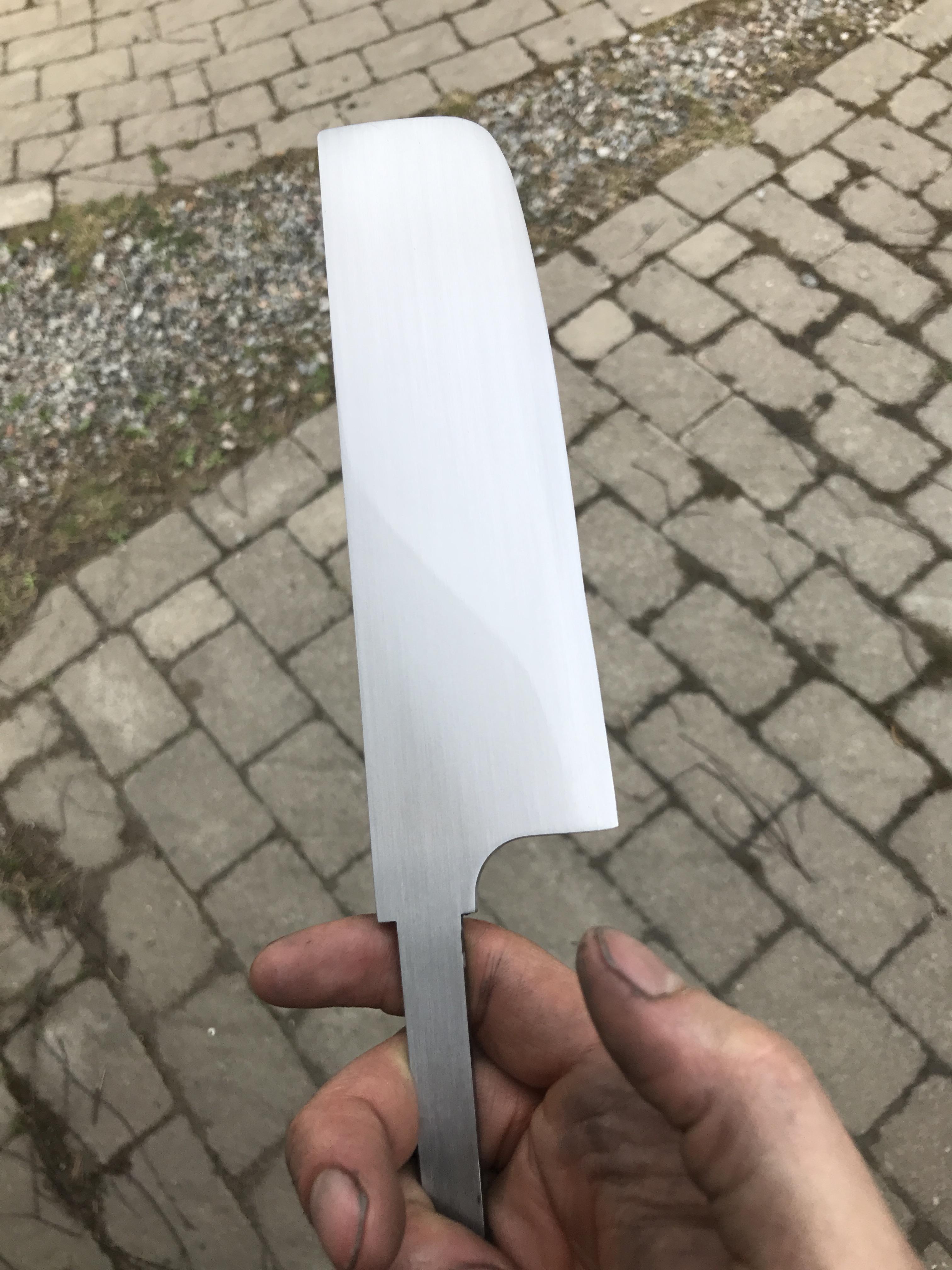

I also had a Nakiri ready to grind, and tried a new grinding approach, based on the answers in this thread. Keep in mind, it's O1, so a lot easier to grind than Niolox, but it's 4 mm thick and I ground it post HT.
I managed to get it ground to A100 in less than an hour. That's progress. And there's a lot of meat to grind away on a 4 mm Nakiri, it tapers to 1,3 mm at the point and 0,1 mm at the edge. It also has a convex grind towards the edge.
Nevertheless, the secret to my success: I stopped caressing the steel and instead actually ground it. Since I grind wet I can put a lot of pressure on it. It did marvels with the speed. New belts and pressure seem to be the solution.
The result (I also handsanded it to 800 grit).
