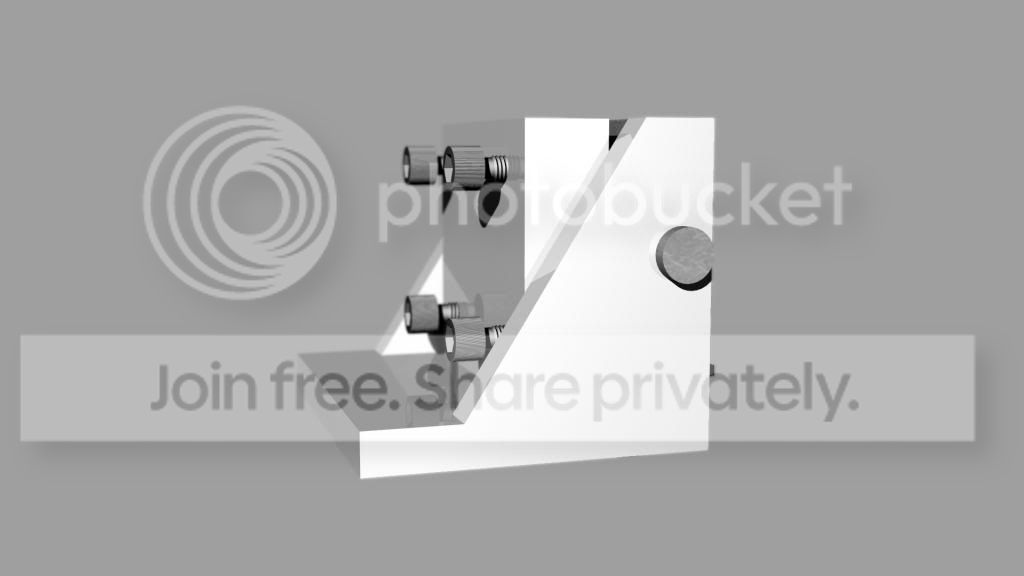

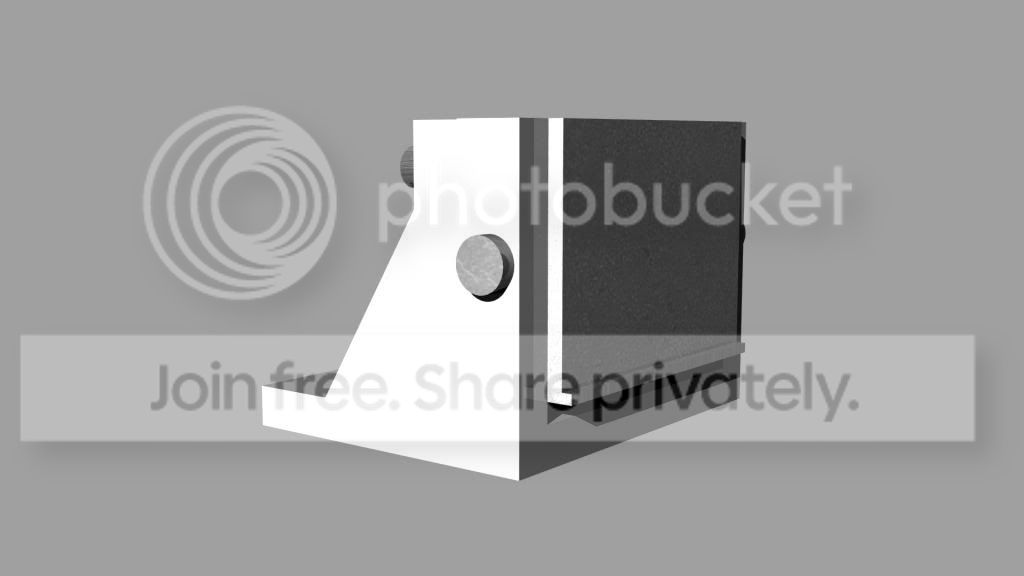

I have an idea of what to make for a jig, but I would like some input from the fine people here. This is my preliminary jig idea
The blade would be held in by magnets, or I would extend the holder so I could bolt the blade in place. The 4 screws would allow me to adjust the angle I was grinding at. With the angle and holding the blade securely, all I would have to worry about is pressure and moving the blade across the belt. There are still a few issues with this initial design to work out, like how to compensate for a blade that has been ground on one side already. I could make wedges to take up the space or just add set screws so the back spacing is infinitely adjustable.

Your jig would mean you would have to change the blade from one side to another. That would mean the blade the blade positioning would probably not be quite right with each change. There is a much easier way to get some blade grinding help if you are willing to give it a try. This works very well for hollow or flat grinding. You need to make up a table that is long enough on each side of the belt plus 6" that will tilt up or down. Probably near 36" long and 3 1/2" wide aluminum with a 90 degree angle. When this is set this up to tilt a cut out must be made to fit around the wheel or platen. This seems to work best when the cut out is made where the two sides come together. This table must sit a 90 degress to the wheel or platen. Take two blocks of micarta say 5/8" or more thick 4" X 6" and place say a 1/8" or 3/16" bolt through at each corner so that the two pieces line up especially on the long length. Place witness marks on these blocks so they will always go back together. This should look like a file guild. On one of the blocks on what you now know will be the inside cut a slot the thickness of a 1/16" or 3/32" rod that goes length wise about center. This will allow you to push the rod in here to help a bit this blade up and down alignment. But only for before you start the grinding. The blade with two scribed lines for the blade angle is placed between the two blocks edge up and if it is a short blade as for a folder a piece of equal thickness is placed at the other end. The table is now given some angle and the grinding starts. An allowance for grinding with all belt sizes that will be used must be made. Grind the one side with the coursest belt you use or even part and go to the other side before going to the next size. GRIND BY FOLLOWING THE LINE FOR EACH BEVEL. Yes, this will mean drawing your blade in the fixture towards you near the tip. This is why the table must be wide. This will also allow you to grind recurved blades . And yes, to grind a two edged blade you just turn your blade over AFTER the one edge is completed, set a start angle and go to it. Perhaps the blade tip may need to be adjusted up or down. just loosen the screws just a touch and give the end of the blade a tap in the right direction. Retighten for sure.
Get out the MILD steel and try a few blade patterns. Sorry as a lot of you already know I don't do pictures, but I use this set up - jig - for every blade I grind. I sure will try to answer your questions. Frank
Gee I really wish you did pictures, because I just can't seem to wrap my head around what you are describing:o I am goingto have to keep reading what you wrote till it breaks through the mental block I am having right now. Thanks for the input.
My design is still in the planning stage, and I know there are quite a few bugs to work out on it still. I was going to mock it up in wood before committing to making it out of metal.

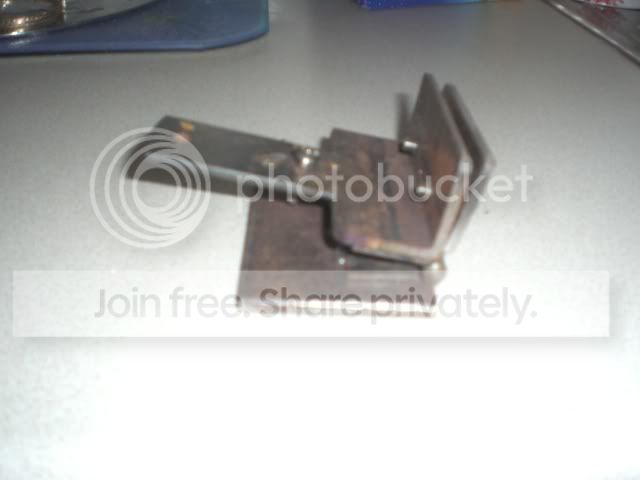

I'm in the process of making two jigs. One is somewhat similar to your idea, but a bit simpler design. I got a door hinge at Home Depot, 2" angle steel, and some 2" wide x 1/8" steel. Similar to the picture below. The other is a flat grinding jig similar to the hollow grind jig sold by Jantz (Well similar premise anyway). A bit more complex to make, but easier to use.
I think your design would probably work well except for the magnet. You will want to switch the knife from left to right and have it at the exact same angle, IMO that would be difficult with a magnet. I would recommend screws.

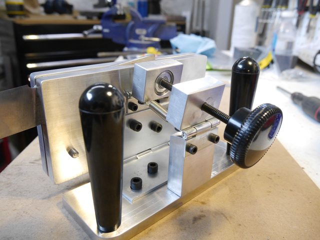

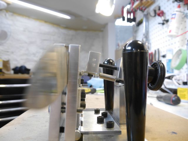

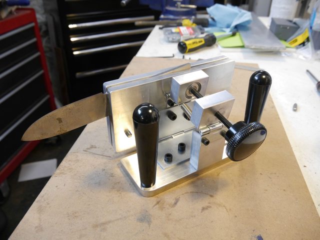

I built a grinding jig for my KMG that works very well. It is of the type where the jig changes angle. You do have to swap the blade from one side to the other, but what I do is use a file guide clamped to the blade to mark where the plunge line will be, that way the file guide stays attached to the knife the whole time (even when changing sides) and the plunge lines come out very even.
My jig is designed to make changing angles easy because in my experience the angle always needs a little tweak at least from one side to the other.
The whole jig is moved about by the handles at the rear, and the bottom is covered in UHMWPE tape that makes it slippery and relatively easy to move around...
The file guide is not on the blade in these photos, I tried to show the mechanism in detail so you can get an idea what's going on:

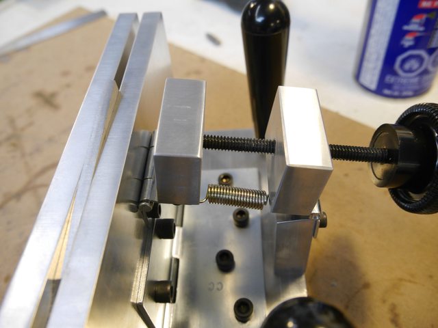

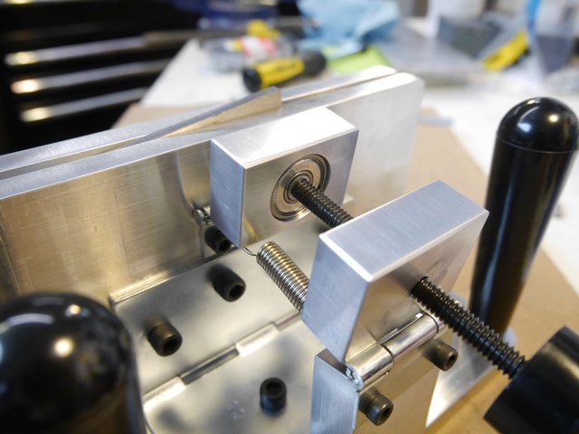

Basically the two hinged blocks and the threaded rod form the adjustment mechanism. The rearmost block is threaded, and the forward block captures the end of the threaded rod in a bearing. When the rod is turned it either pulls the blocks together or pushes them apart. This forms the angle adjustment mechanism.
The hinges used are regular door hinges (1x 4", 2x 1.5"). The steel loops that contain the pin in the hinges were whacked with a hammer a bit in order to tighten up the fit and remove slop. The little spring serves to load up the whole mechanism in one direction and soak up any remaining slop.
The whole thing is made from 3/8" aluminum plate, and with the exception of the little bearing block could all be made with just a bandsaw (or hacksaw if you're brave) and a drill-press (or hand-drill if you have steady hands!). The little bearing block was made on my lathe, but I'm sure there must be a way to replace that with some other mechanism, maybe 2 circlips on either side of a block or something? I will give that some thought...

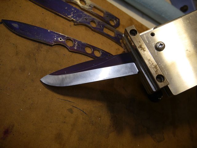

Results:
You can see the file guide attached to the blade blank in these photos:
(Don't mind the messed up swedge, it was the first swedge I've done... It was also done using the grinding jig)
And this is the large table I fitted to the KMG in order to facilitate use of te grinding jig:
My only other thoughts are that you will find that using a jig makes the setup of your grinder much more critical. Make sure the platen is flat and also at a perfect 90º to the table. Belts need to have their edge killed, otherwise they might under-cut your plunge. I use an old file to strip the grit off the corners of the belts.
I have found using the jig to be very rewarding. It still take a fair bit of skill to use, but it does not require the constant perfect motor control that grinding freehand does. I find that kind of physical concentration very tiring and stressful, so I much prefer using the jig!
