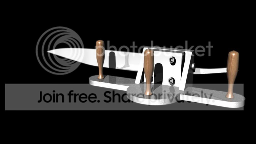

I think I can still grind as long as I take holding the blank and maintaining a proper angle out of my hands. To maintain an even pressure on the blade using a jig similar to yours I would just have to add extensions to the jig so I had a handle behind the blade at each end. I drew up what I am trying to say, but for some reason Photobucket wont load and since I lost my knifemaker membership I can't attach the picture:( I will amend this post once Photobucket comes back online.
I am not ready to give up on making knives just yet. Some time ago someone here posted a video of a guy grinding knives that was either missing one or both hands. My thoughts are that if he can do it so can I, I just have to figure out a way to do it.

Which part does the tilting the blade holder or the grinder table? How can you just turn that tilting blade holder around and have the same angle? Yes, if you taker the blade out and turn it end for end but that upsets what you are trying to do and that is achieve some accuracy. Frank
Neither. It's not a tilting blade holder - the blade holder is at 90 degrees. It sits on its own table that is tilted, so if one side of the blade is facing the grinder at a specific angle, the other side will be facing it at the same angle when you spin the 90 degree blade holder around on its table. There are pictures in that thread.
It doesn't sound like it's exactly what you're talking about (you're tilting the grinder), but it's the same exact principle I think - only easier because you don't have to tilt the whole grinder, but just an independent table that the blade holder (which is at 90 degrees, never tilting) sits on.
I understand what your setup is now after looking at that one, but they are the same in principle (blade never has to be removed from the holder, which is at 90 degrees). The only difference is that you tilt the grinder toward the blade, and the other guy has a table in front of the grinder, independent from the blade holder, that tilts toward the grinder.

I haven't totally envisioned Frank's set-up yet, but the one thing I totally do understand is the part about having the blade fixed 90 degrees to the base of the jig, and using the tool rest to set the angles. IMHO, that is the best route. Tilting the platen should also work. so long as you can get the angles you need.
Most of the jigs I've seen look really fancy and many have some really nice machine/fab work, but would be quite a chore to actually use.

I think that if you were able to roll off the edge of your work rest, your jig would work. That would give it a pivot point to grind the tip. Otherwise, if your work rest is really long, you would have to raise the tip end of the jig in mid air to finish the grind. If the width of the tool rest was adjustable then your jig would work for any length blade. I might be missing something though in my brain's eye.

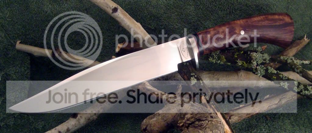

That's a handsome looking Bowie knife you made there and many makers have overcome a lot of disabilities in knife making and life in general.

That's certainly not what you do. You just draw the end of the knife toward yourself and the tip will form. Just follow the lines that you have for the blade edge. If you can grind to those it works out well once you set the angle. Simplicity.
Unky the magnets strong enough to hold the blade one will be a fight when you want to move the blade even a hair. Frank

My jig uses an 18" aluminum work rest that is 4" wide you will also need a non magnetic platten I attach the handle to the magnetic jig that is adjustable for the angle needed. Then I use a wooden block to maintain even pressure to the blade as I pull the blade across the belt. I watch the space between the blade and belt as I come to the tip I pull the butt of the handle towards me slightly to form the tip.

I would try to keep the spine in contact with the work rest I fear with it elevated the force from the grinder will cause it to move.
