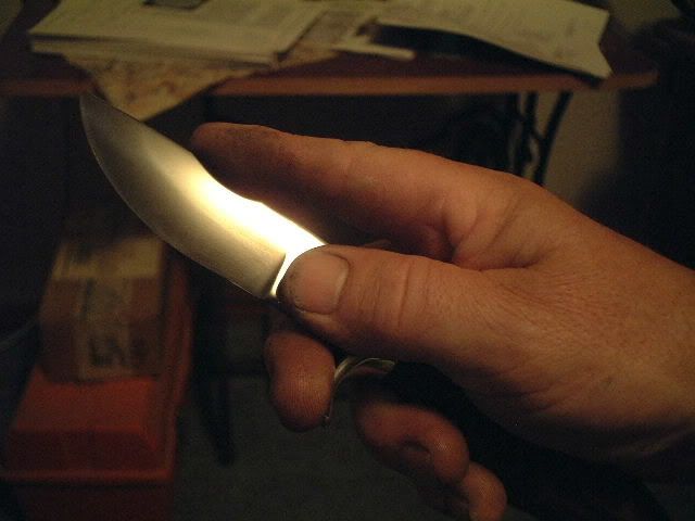

I couldn't get the photo of the "rope cutting/spear point shaving" application by myself, but there's at least one more than these two.
It helps to have a nice ricasso/choil area.
