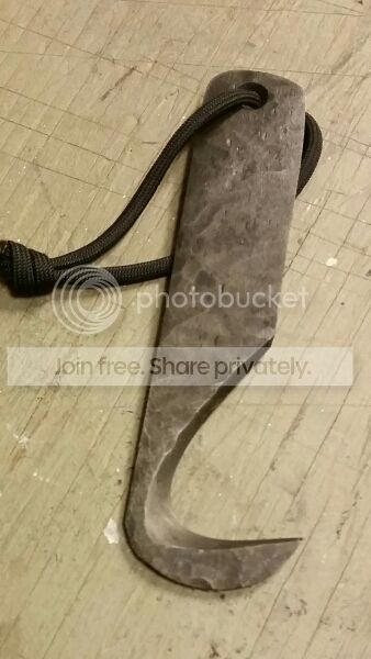

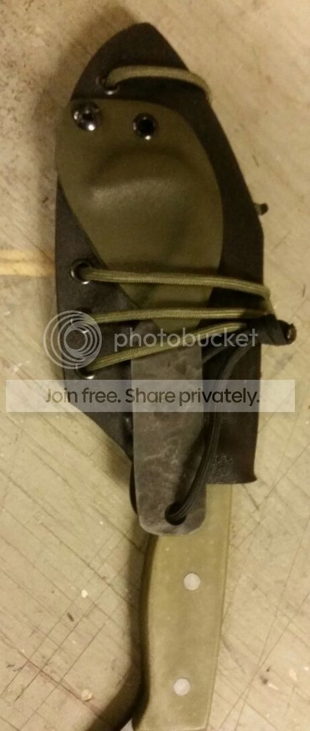

Yeah. One of my first ones was for a buddy who wanted textured g10.

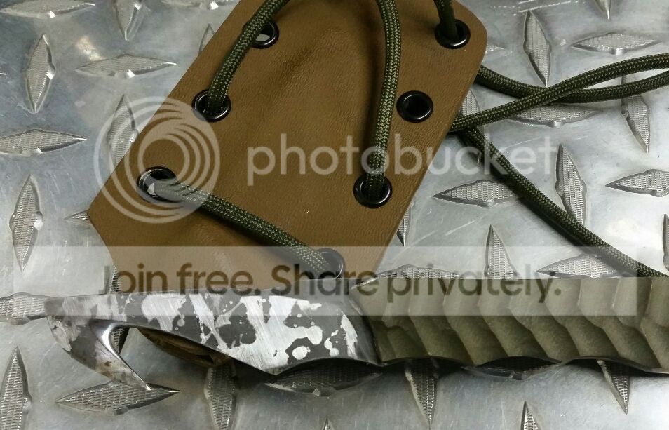

Another one I made. I tried to do it on my 1" wheel. Sharp as can be, just too big.
