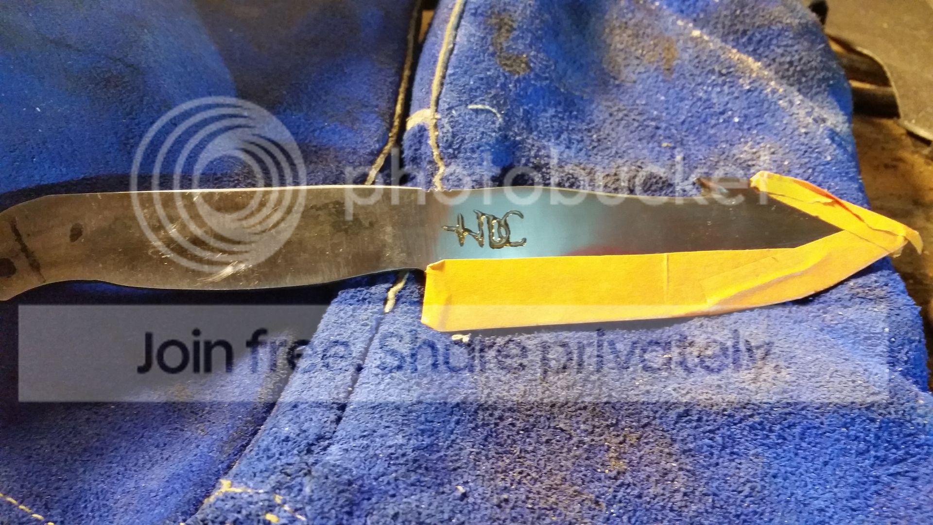

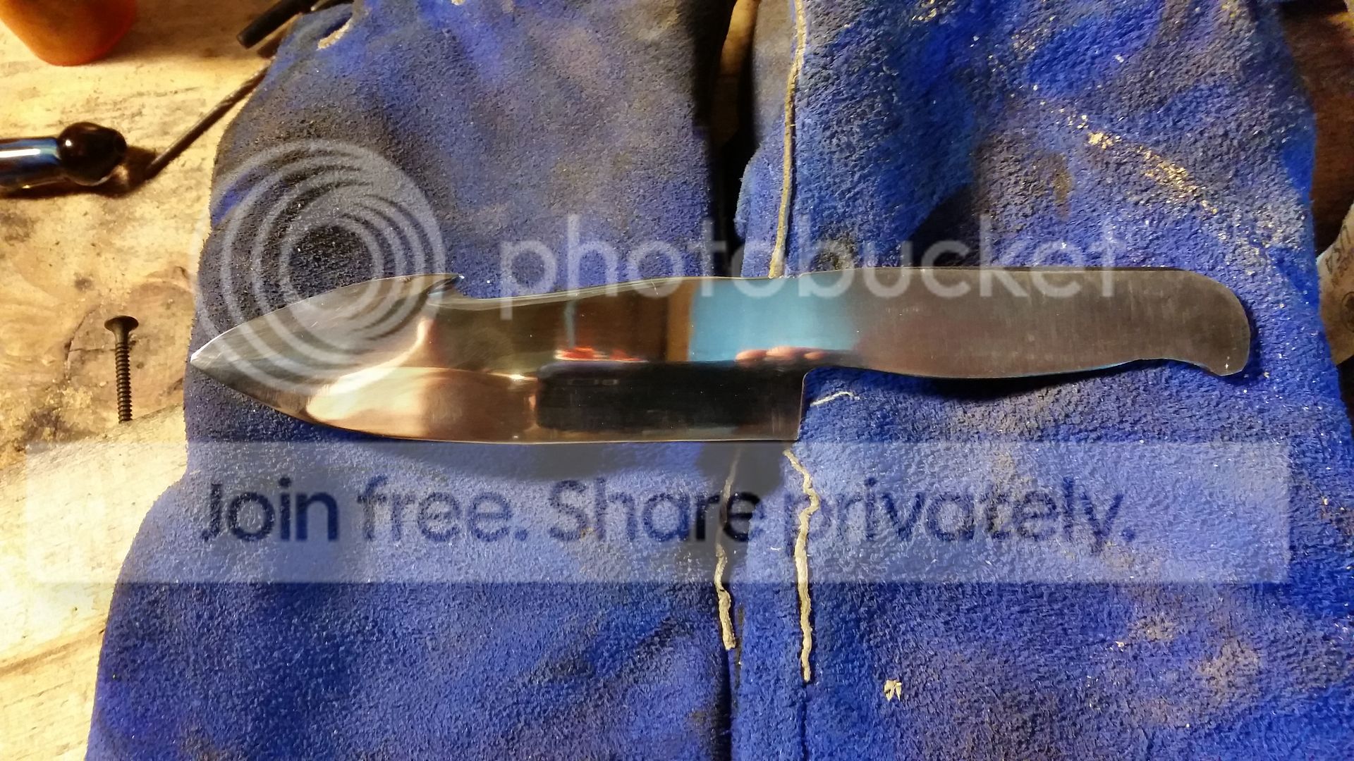

I just got mine off the buffing wheel and she looks pretty nice actually. Spear point and the swedge before the hook is fairly blended for smoother transition. Taped up and ready for a forced patina then off to get fitted with Cocobolo on the handle

Yes it is sharp starting 7/8" from the hook tip. It was per request for whom I am making it for. Was a bit of a pain as I had to walk my plunge back during grinding. This will be the last of either style I will be doing for some time.
Hmmm , that's going to end up bad for the customer. When I use a gut good the panch from the moose balloons out of the cut and pushes against the knife tip. It's a nerve wrecking job , I can't imagine doing it with a sharp edge/point.
Hehe I don't disagree with you there. As stated before this is entirely by request and I'm just doing it for the educational purposes. IMHO it is a rather sleek design and with the current patina it pops.
No doubt! Most guys I hunt with don't even like skinners with a fine tip for this reason. This is asking for trouble.
Been hunting in Alaska since I was wee lad.. and tried out a gut hook once. For its intended purpose it worked pretty good, not really any faster IMHO than proper field dressing technique with a well designed Skinner or drop point.
my biggest issue with it came after the belly was zipped, the hook on the spine was a severe hindrance in skinning as the pointy bit would catch on anything. I gave that knife away as soon as I returned to civilization.
Tip to handle the blade is 4-1/2 " . It all started out from a 2" x 5/32 " A-2 tool steel .
It has a steep drop point and all is rounded in order to avoid what others here have talked about , cutting the internal organs
