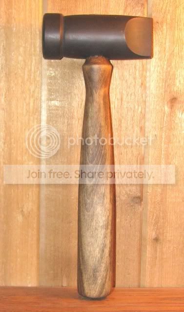

Anyhow, thanks mostly to the safety point from Stacy, I went and did a new one. I got a decent 4 lb sledge, and cut out a straight peen on one side, polished up the cutting marks, and dressed the face. I sanded down the handle (which was too thick for my smallish hands) until it was nice and comfy, but I like to have a good long handle. I find that when I want more striking force, a long handle is helpful, but when I'm doing finer work, I am not shy about choking up almost to the head, and having the weight of some of the handle behind my grip helps.
Here's the results:
