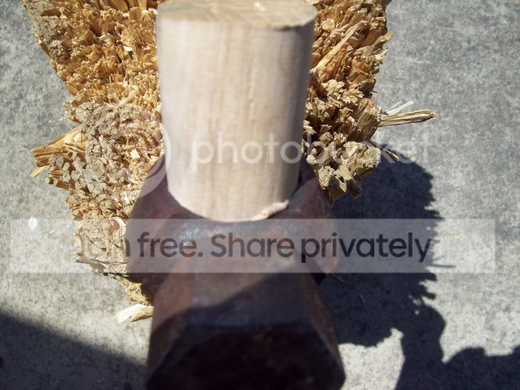

Here's a couple photo's of me making an eye for a different style ax. I use pretty much the same thing for a hawk except the slot is narrower.
