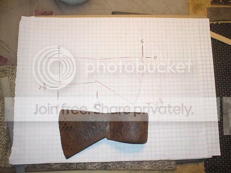

Are there standardized dimensions and shapes for tomahawk and axe eyes?
Here ya go Dr.

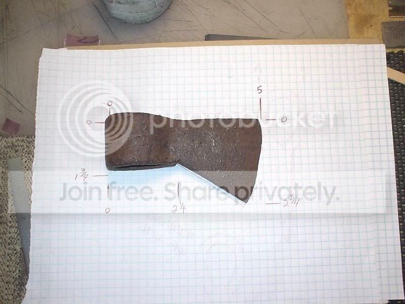

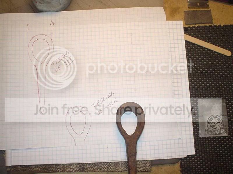

In the warmer months, a couple buddies and I hunt Copper Culture Artifacts with metal detectors. Every so often one of us will hit on an old Trade Hawk. Here are some tracing's I did of a foldover mid size hawk that was dug up a couple summers ago :thumbup: :thumbup:
This should give you at least a base to work from :)
:cool:

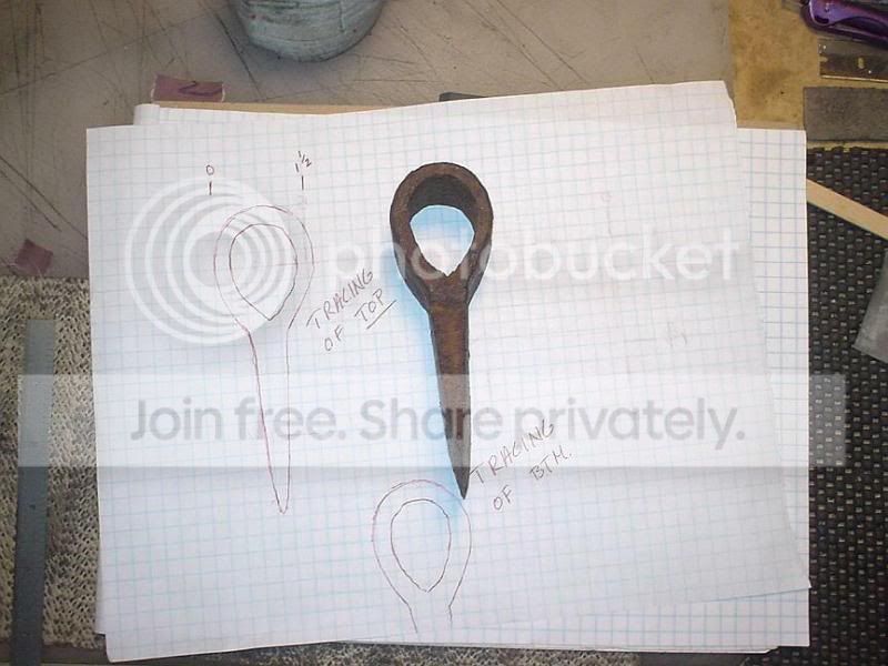

I wanted to add, in the last pic you can clearly see the taper in the drifted eye. The tracing of the top & bottom of the eye also show the size difference. FWIW, each square on the grid paper represents ~ 1/4".
To clarify, the top of the eye (the larger side of the taper) would be the side we would drive a wedge into on a new axe or hatchet handle. The bottom (the smaller side of the taper) would be the side your hand would be closest to when gripping the handled hawk.
I hope this helps any who want to make a little Hawk like this ;)
