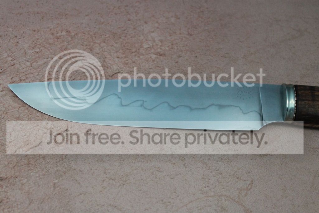

Now you can't go doing that to us lol. We've all chased the hamon fairy so when one of us catches her you gotta share what she left you with haha. At 400 grit you should be able to see your hamon in just the right light. What are you etching with, and what are you polishing with? The type of hamon you're going for determines the next steps. The quench only locks it in, it's the polishing that makes the hamon pop. If you're going for a "dirty" hamon where it's flat out 2-tone in any light, then you don't have to do that many etch and polish cycles. If you're going for a "clean" hamon where it only looks 2 tone in dark light, but has a bunch of cloudy whispy stuff, the best course of action is using loose abrasive.
I'm not saying one is better than the other by calling them clean and dirty, just using the terms I've heard knifemakers call their own work. I wouldn't consider this hamon clean in some ways because there's flaws but many knifemakers called it clean when handling it. but there's relatively no oxides left on it. This was done using aggressive pressure with loose silicon carbide powder.
It's the same finish just different lighting.
Very beautiful knife. I'll just be over here with my foot in my mouth.
Haha it's not even like that. I've been fortunate enough to have some very kind makers help me with this chase. It's very addicting and can be quite heartbreaking. I've wasted so much time trying wrong things. The whole point of my posts in this thread are to give information that I never read while researching hamons. I never read to grind as far as you really have to. I finally feel like I'm at a point where I'm moving in positive directions and once my geometry gets better so will my hamons. If you don't grind as far you'll still have a hamon just not the clarity in the activity that I'm looking for. Everyone's approach to hamon development is different, it's not one of the things that works for everyone straight across the board. It requires expirementation and finding what works for you. The knife I'm currently working on after getting that Bowie done has a failed hamon. It just happens. So it gets a hand rubbed satin instead of hamon development. It's all part of the game. Now if you wanna see real hamons look at work by Avila, Wheeler, Morrison, Hanson, all stunning work, those guys have it down and are an inspiration to me.
