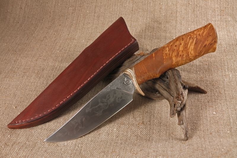

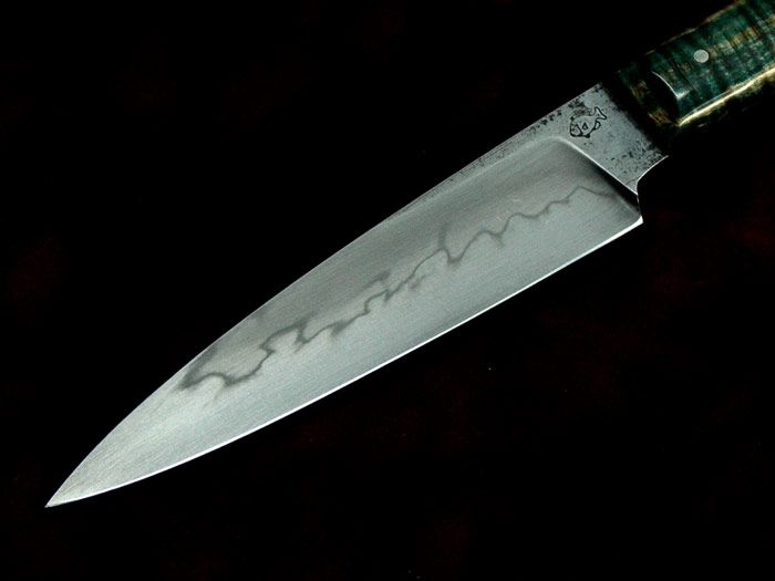

Claudio's blades are laminated blades so the wavy line you are seeing is a lamination line not a temper line so to speak of

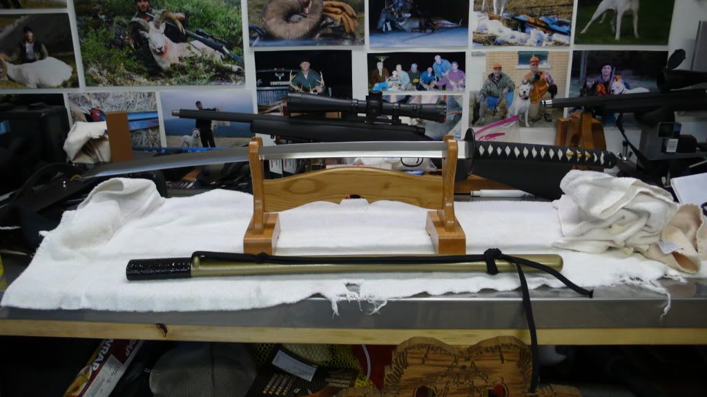

The late great Paul Champagne who in my opinion was a master in both styles once made me a Katana that was diffentially heat treated in the drawback method which shows no Hamon. He made this for me as a performance piece and had full confidence that it would perform as well or better than a traditional Japanese clay tempered piece

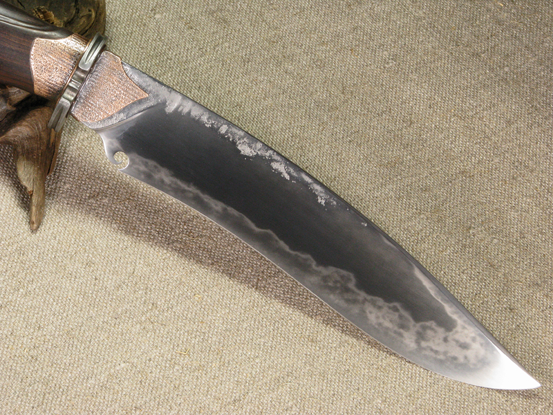

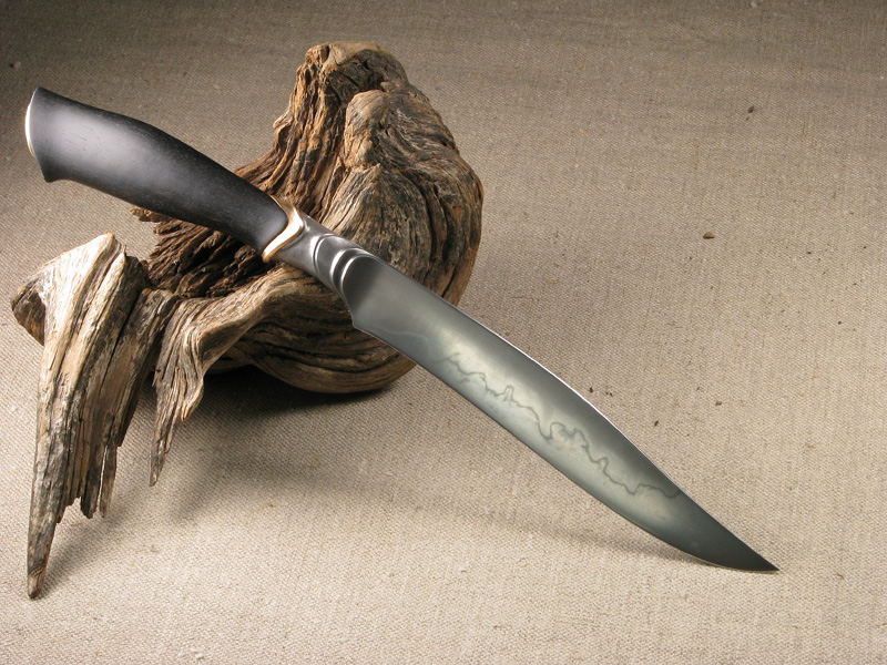

I too am huge fan of hamons, they have been the primary focus of my work for over two years. Attached is a recent bowie I did, w-2 clay hardened in water with mesquite handle.
As to Ed Fower's question, yes there is definite evidence. I know of at least one case where the steel has been analyzed, the evidence is on Don Fogg's website. I have no doubt there have been others. Personally I can say that the steel on the spine is easily filed while the edge cannot be.

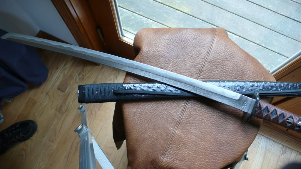

The blade by Paul Champagne which shows no temper line but it is differentially heat treated

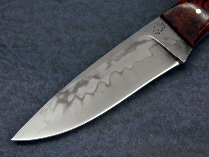

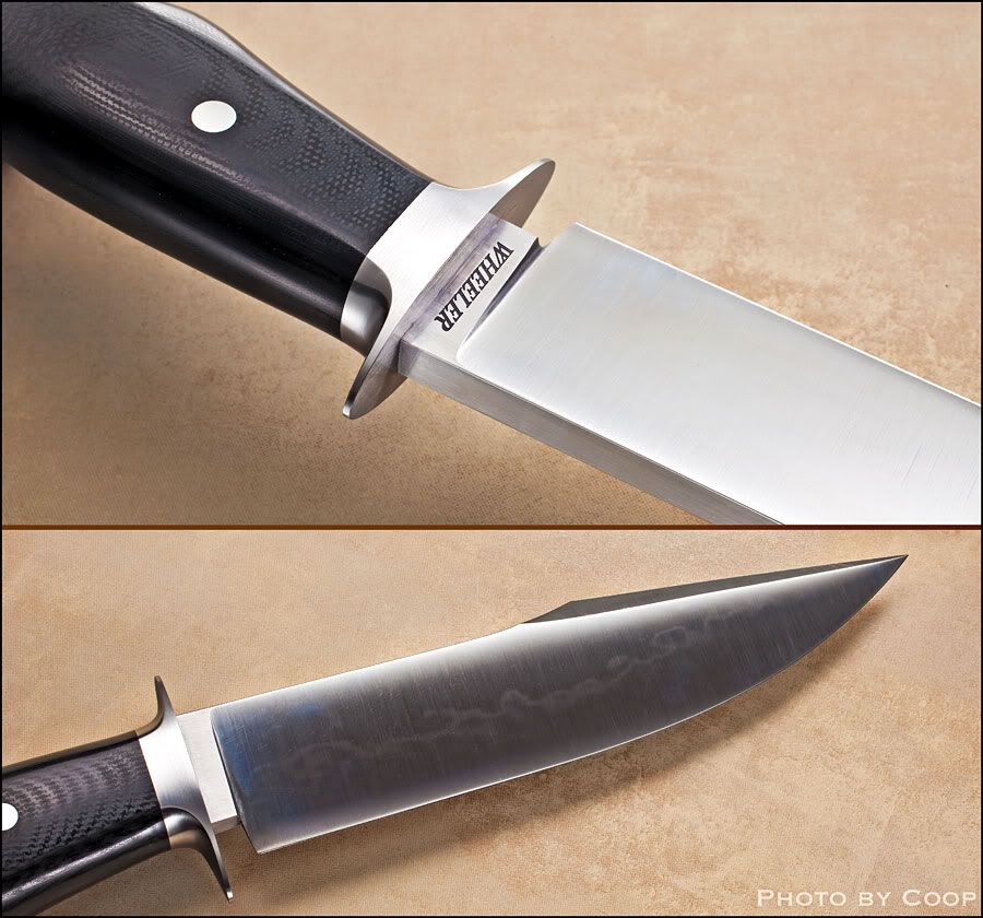

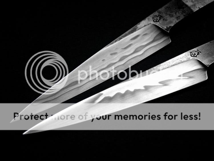

Well, you know this one had to end up in here (Wheeler W2):

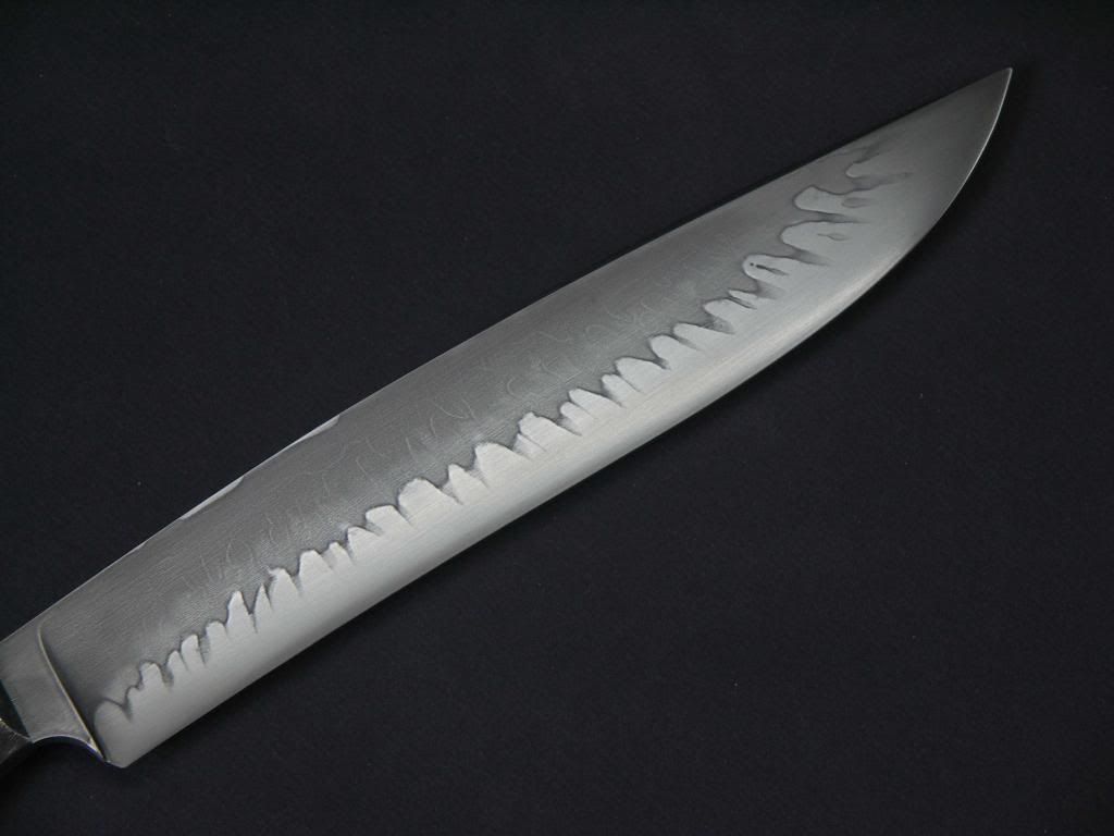

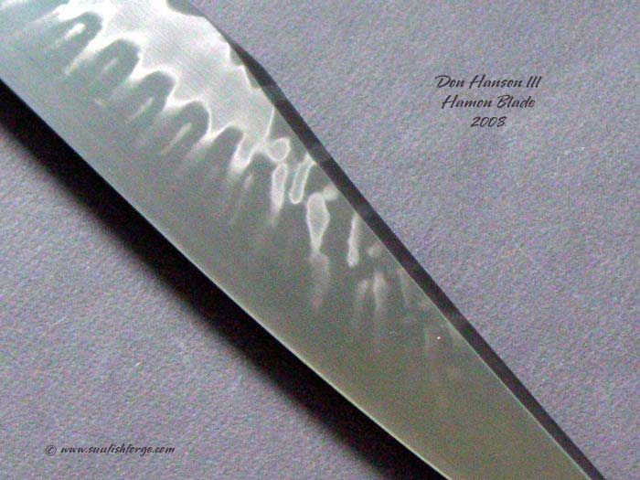

And of course, my thought is that you cannot have any discussion about hamons, especially in W2, without mentioning the work of Don Hanson III:
Having picked up some of Don's W2, I have tried my hand at a few hamons as well. For me, the personality and beauty of a hamon is hard to beat. Here's a few I have made with hamon:

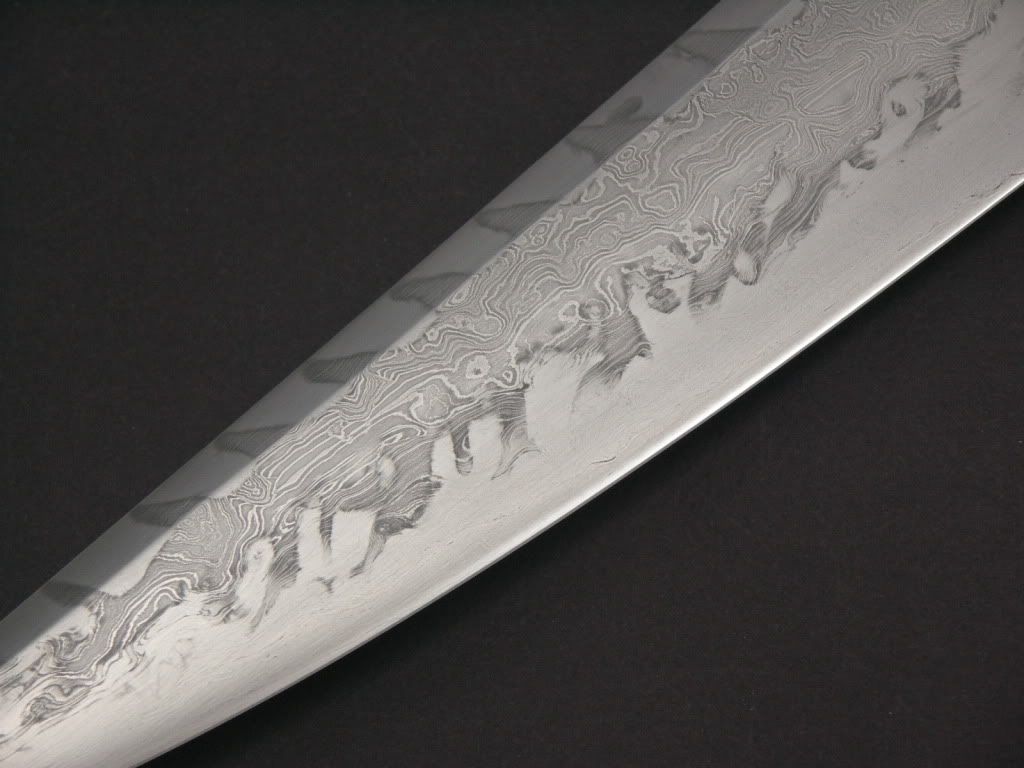

This blade by Scott R has both a lamination and a temper line

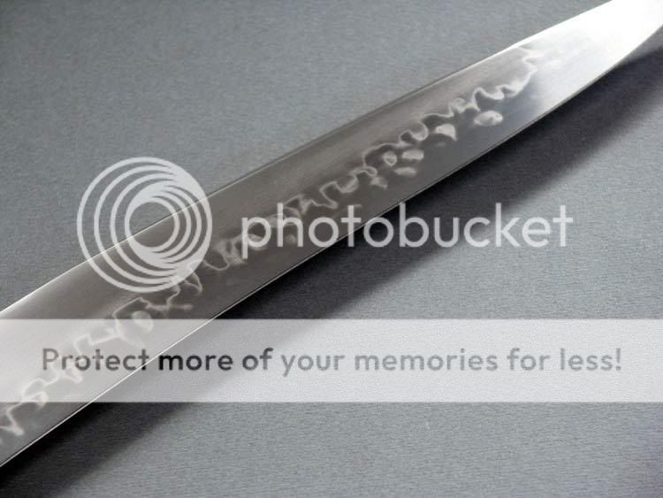

Hi David.
I don't think that looking inside the blade is even necessary to see evidence of differential hardening. The polishing of the blade and the resulting hamon is all that is really needed to know that the steel is different above and below the habuchi.

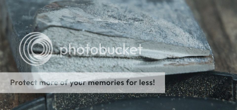

Most people who have quenched in water will have cracked a blade, as I have. As frustrating as it is, it was instructive to snap it fully to examine the steel and I can tell you that the grain looks VERY different in the hardened edge compared to the softer spine.
Here's a photo. It's not from an actual blade but an experiment to see grain difference. Some time ago I hammered a piece of steel into a crude blade shape and put a little clay on the spine just to mimic the conditions. No grinding or anything, just something to quench and break as an instructive process. In fact I can't remember if I really thermo cycled the this but if so there was only a very rudimentary flash thermocycling at the end.
And finally I did use a torch to speed up the heating of the spine. All this to explain the very coarse grain in the spine area.
But it's indicative of two very different structures.

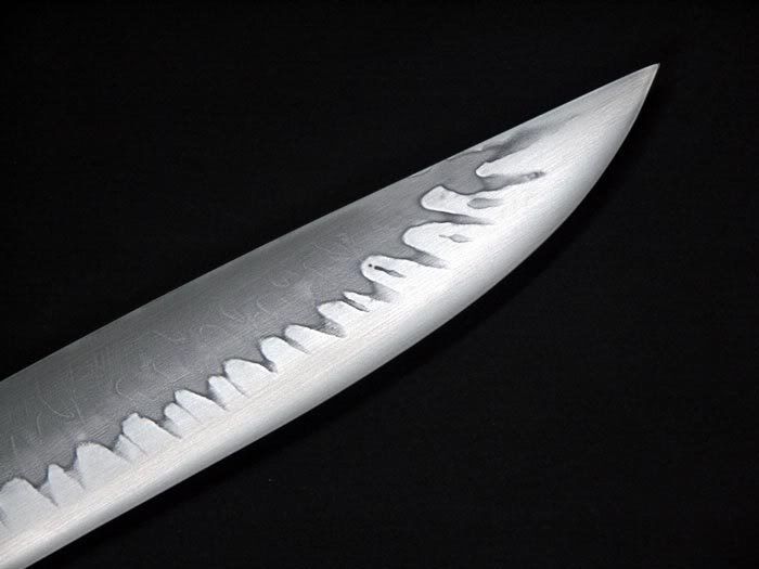

I've seen a lot of impressive hamons over the years, but yours and Nick's are very hard to beat.
Branson:
Wheeler:
Roger

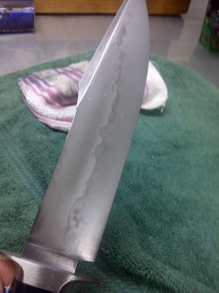

Hey Joe, not sure about CAS knives, but it isn't just a lamination line in Burt Foster's knives, there is also carbon migration which when treated optimally(a hand rubbed satin finish) will reveal itself much like a hamon.

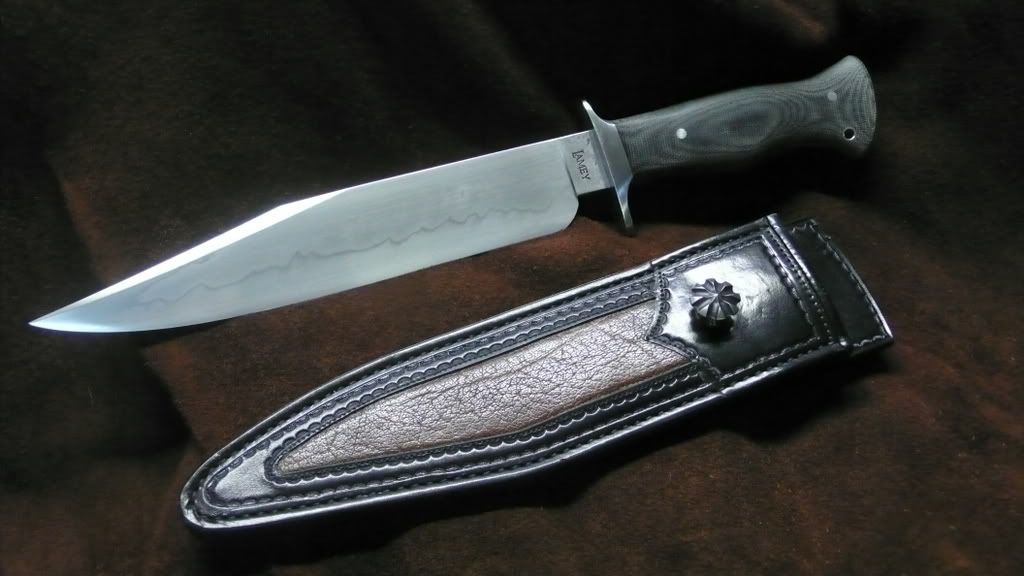

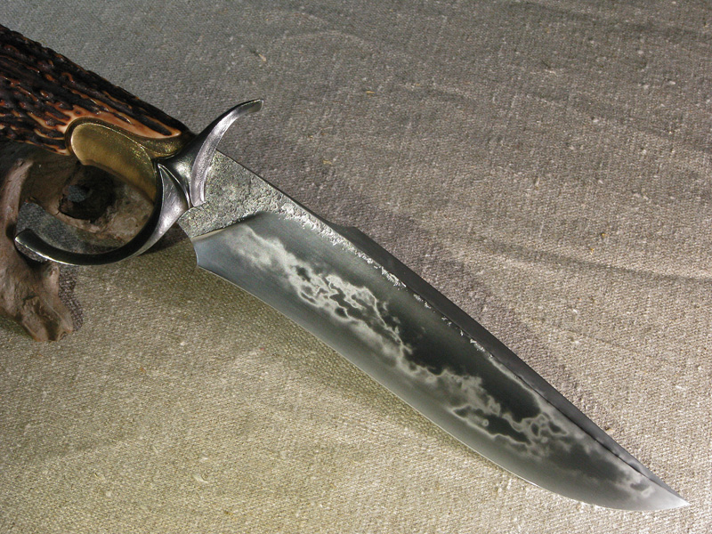

Bill Burke fighter, I don't own it, but did handle it at Josh Smith's microshow a few years back. Stunning piece, good one to start off this thread as Billl studied with Ed Fowler, and now often stylistically differs from Ed, while using many of the techniques he did learn. P7's photo shows how difficult it can be to photograph a hamon effectively, while attractively displaying the rest of the knife.
Don Fogg American Bowie II-Not mine, never handled it. Kind of knife I dream about. Thing to worry about with a knife like this....the surface finish is extremely fragile(it is hand rubbed far in excess of 2000 grit) and keeping the hamon popping will present a challenge over the course of regular maintenance.
I do own this subhilt fighter by Burt Foster, and love it. You can clearly see the carbon migration in this photo. Steel can do some funny things, and what Burt had come up with for the way his steel gets laminated was just a little bit of genius and alchemy. In my opinion, at this point, no one does it better.

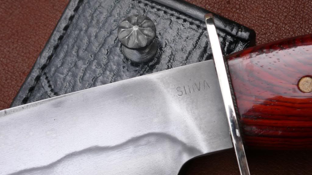

Here is a J.D. Smith Shiv, a very rare and uniquely styled piece. J.D. crafted this one out of tamehagane that he had made himself.

Steven I see your point but I do not consider a lamination line the same as a traditional Hamon
You can :)
Now is San Mai which the laminated blades in question are a traditional Japanese construction method....... Yes
