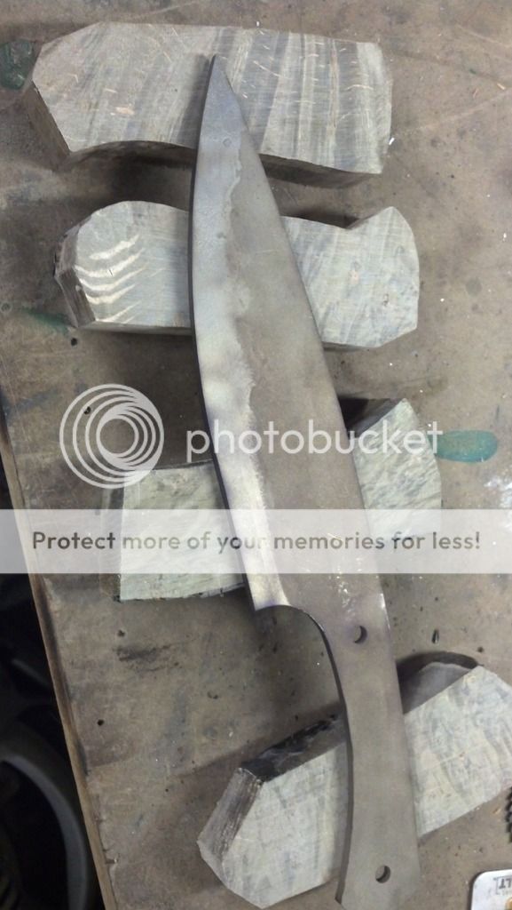

One of my better ones this year. It's a little higher than I like, but it's done aiming for a more traditional look. Thin knives are a challenge, as they quench so quickly. W2 that started as 1/8", but thinned to 3/32", with a mild distal taper. 70/30 offset for a right handed user, full flat on the left, and convex on the right.

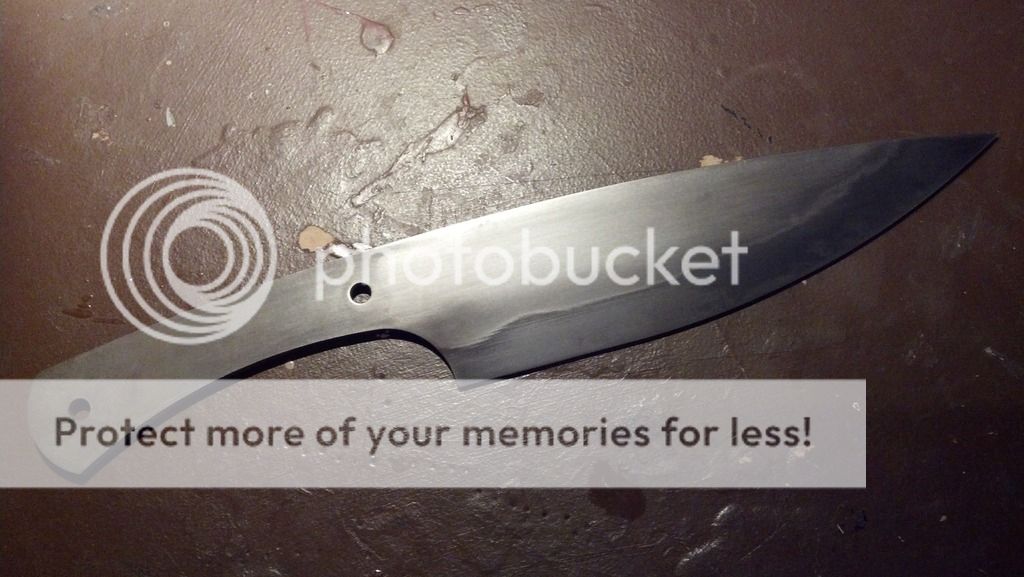

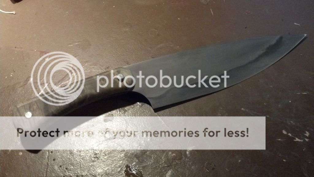

I've got a great clayless hamon on a tanto I've been working on between other projects. I need to get around to a proper light box as I can't capture it even remotely well the way I'm currently taking pics, which is pretty lousy.
This is probably the best on I've done to date. W2 as well. Same dimensions and grind as the knife above. It's a popular combo for me.

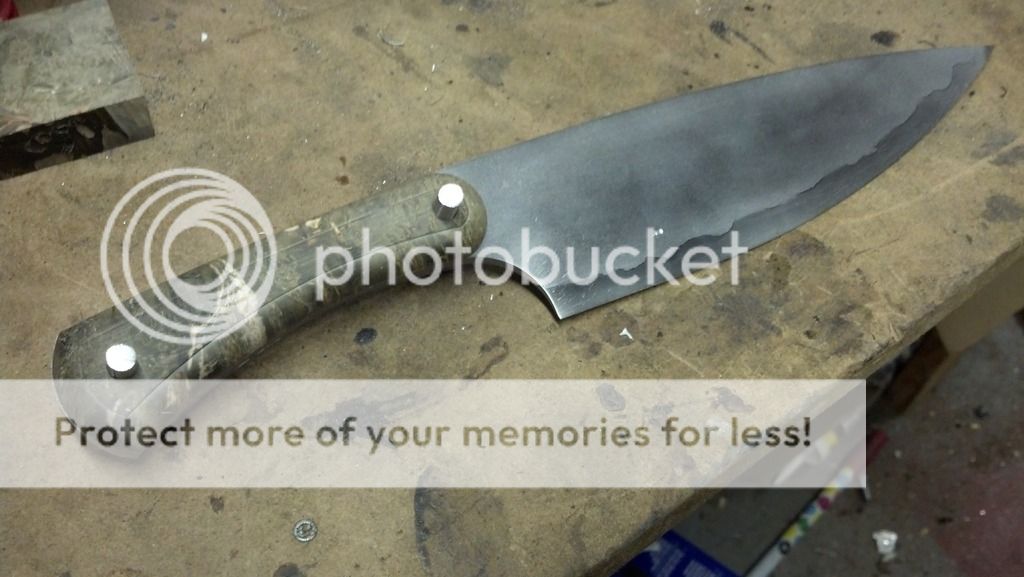

as a relatively new knife maker (less than 3 years)... I am now addicted to making hamon's
Some kitchen knives I have had success with...
