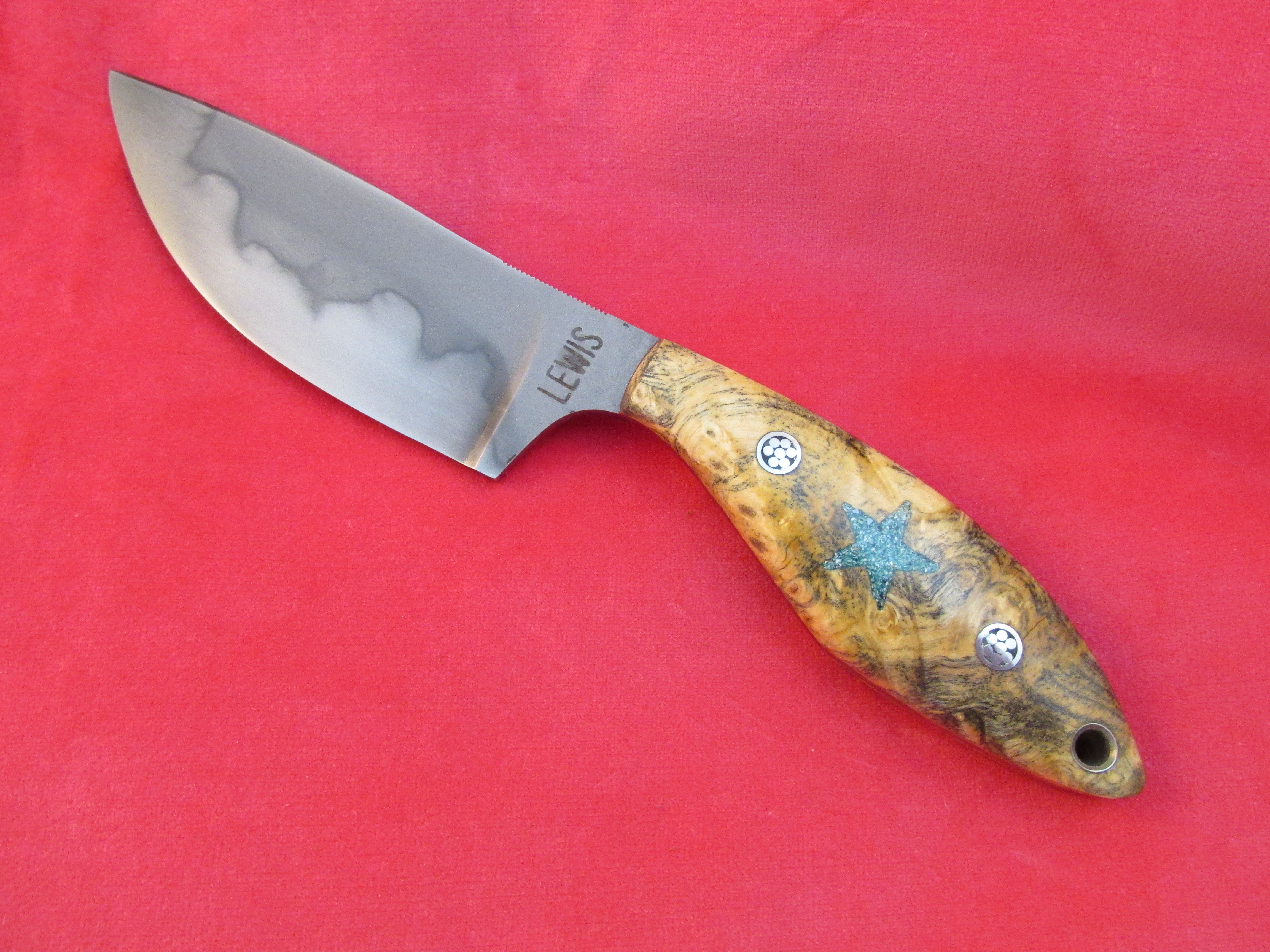

I've been using Rutlands black furnace cement. The biggest tip I have with using it is to make sure it is 100% dry or it will bubble up and fall off as soon as it hits the oil when quenching. I let the cement sit on the blade overnight, then to make sure it is completely dry I take a propane torch and go over all of it.
