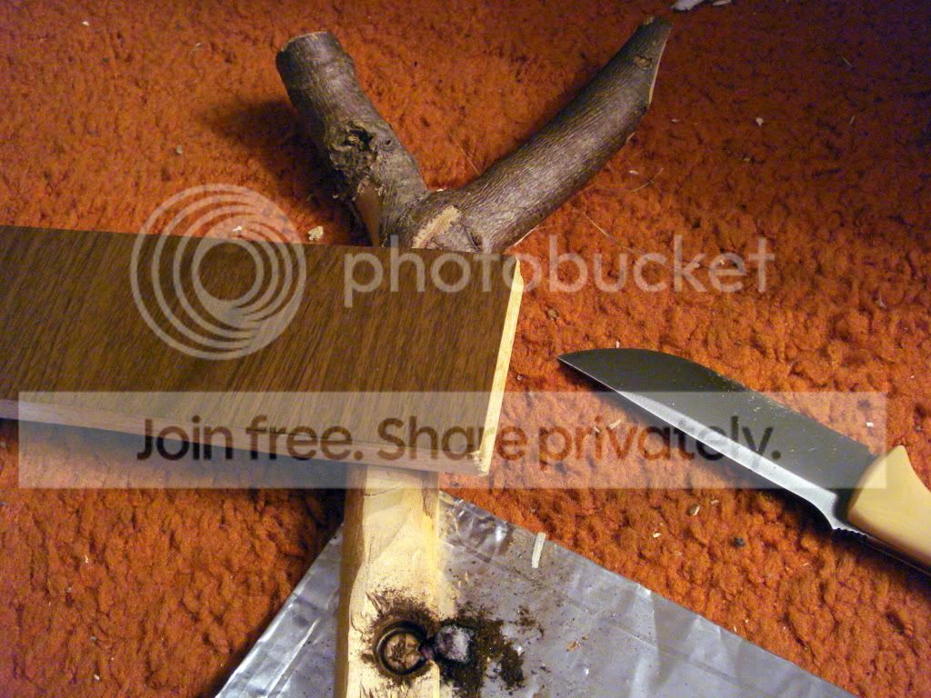

You mention 2 ways of positioning your body - sitting down or kneeling on one knee. I kneel on both knees (helps me to get a longer run on the spindle). I also use a helper board (a board under my left knee securing the hearth in place).

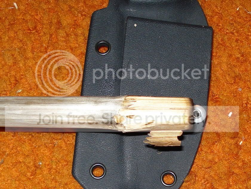

Sometimes, the 'bark' on a spindle will loosen from the spindle and knock your char pile all to heck, so scrape the 'bark' or outer skin off of the spindle. This is especially important with more fibrous spindles.

This is what I mean when I say scrape the sides of the drill. The piece sticking out is part of the 'skin'. This can whip around and wipe out your hard-earned char pile.
This is what I mean by a helper board. My left knee rests on the helper board (usually with the aid of an age mitigating foam pad :rolleyes:) )
