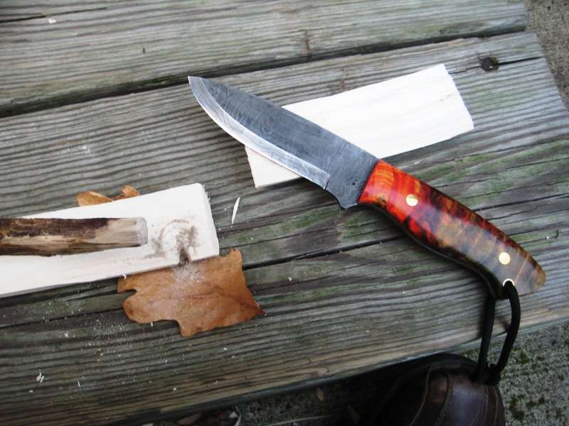

Ok here is my 1st miserable failed attempt. I confess I didn't try all that long. I never got any smoke and only managed this sad gray powder. So should I get some Red Cedar or keep trying with this basswood.
Any help will be greatly appreciated.

Tony,
First off, it is difficult to troubleshoot via pictures, so in advance I apologive if I lead you astray.
From what I see, it looks like the dust you are getting is not very fine, more like whiskers which isn't a good thing. It could be too much moisture in the basswood, or the mullein is too hard for the piece of basswood you have. No smoke or dark coal dust could also be a result of not enough down force.
Suggestions:
- use handshears or heavy duty scissors and clip the end of the spindle. That bark like sheath on the outside will get you a coal before the pith will.
- if you have a piece of dry cedar (sapwood only), try it, maybe that basswood is too moist.
- get a partner to help, switching off. Great way to learn more by saving your hands.
- when you do start getting smoke and good coal dust (and you will!), that notch needs to go to closer to the center, if not all the way, and be at least twice as big in my opinion.
- stop before you get a blister, you will be able to do more practice by stopping and giving it two days, then try again.

I will get some dry Red Cedar and try again implementing your tips.
