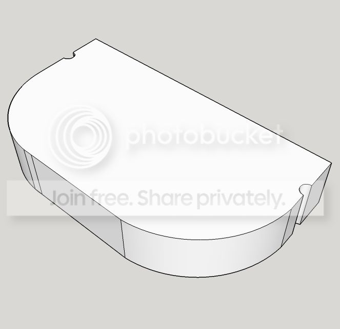

Very interested in this as well. Since I am new to hand rubbing, does anyone know how to do it on a hollow grind? I can do it on a flat grind easily, but the contour for the hollow is not working for my sanding blocks.

Buy or make a sanding block with a corresponding radius and sand just as you would a FG blade. I hand sand my straight hollow razors and it works just fine.
