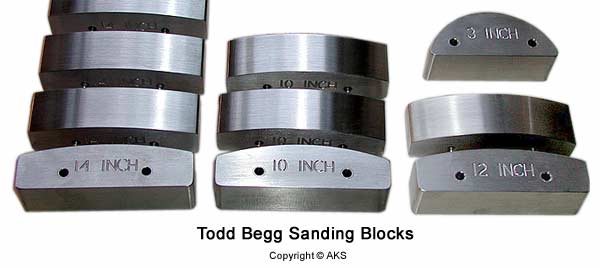

Here is a picture of the sanding blocks that Alpha Knife Supply carries, made by Todd Begg.... these look quite a bit like mine.... just a lot nicer! :)
Oh geez -- I didn't know such a thing existed! Thanks Nick!

Hey Nick thanks for taking time to make those vids! Good stuff. Just a quick question about your sanding sticks. It looks like you are just using the edge or corner of the sticks and not the flats. But at the beginning of the first one you talked about having the paper sit flush on the flat and I got confused. Is the corner sharp or slightly rounded?

If I typed somewhere that I'm using J-flex belts on my blades, it was an accident. I LOVE them for handles, but I don't use them on my blades unless there's one on my rotary platen that will work for feathering an edge in. I cut my plunges in pretty darn close to final shape with the 60X, then closer with a 120X, and then if they need dialed in more, I do that sandpaper glued to the block of steel thing (like I did for Lorien's knife thread).
