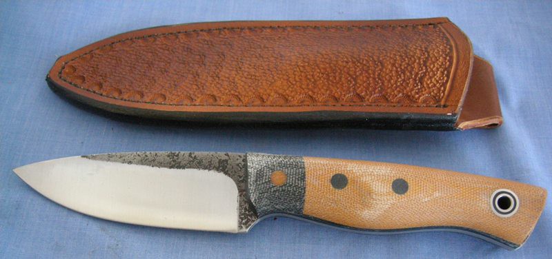

You mentioned switching to 1/8" pins. Does this bushfinger (my new, just purchased Fiddleback :D) have the 1/8" pins you mentioned? These look a little different than the ones I've seen before, including your 12/2 batch.
No, those are 1/4" pins. But you can see that I've gotten that front pin quite close to the front of the scales. I really liked that knife.
Thanks Andy. So you feel like this pin configuration is as stout as your 1/8" config? It almost seems to me like a larger pin like this might even give it the ability withstand more impact, etc.. Also, I was curious - do the pins go all the way through the tang to the other scale? I assumed so, but I just wanted to be sure.
BTW - I like it too! Can't wait to get it in my posession!
Yes. They go all the way through. I think thats a stout handle that isn't going to break, thats for sure. Wait till you feel it.
