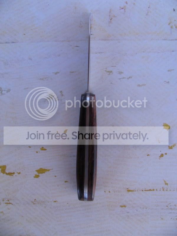

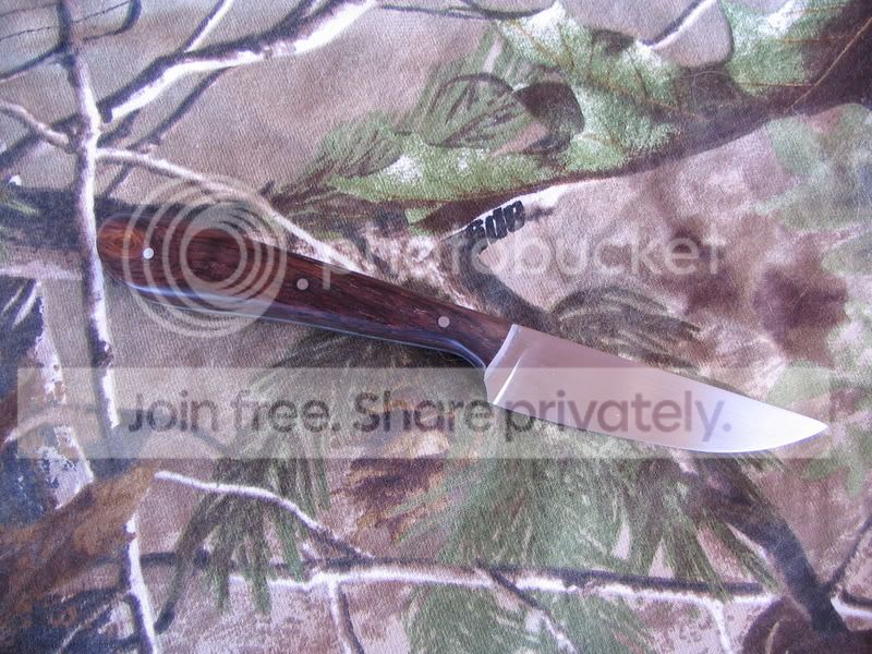

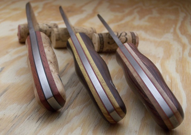

I'm heading towards a 'rut' on how I'm contouring my handles, and I'm not sure if it's a good one or not. My goal is comfort in the hand AND pleasing to the eye. The feel and look pretty good to me, but I lack the years of experience that others here have. I'd like feedback and critique if possible from the more experienced on how these look to some fresh eyes.
The concept in my mind is:
-tapering towards the front starting from about 1/3 or so back
-thicker in the middle...ie, a palm swell
-tapering again towards the back end where the pinky/edge of the hand fall.
Here are my last 3 knives as examples:

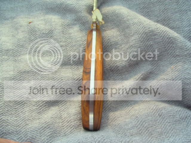

Blade: ~4" Handle ~4"
Intended use: drop point hunter
Blade: 3" Handle: 3 3/4"
Intended use: Bird & Trout

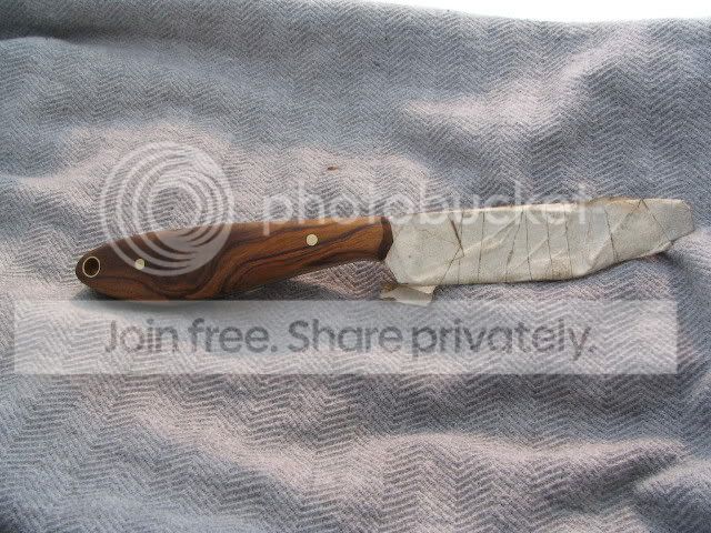

This one is currently being shaped. I am more or less finished with the shaping, but haven't yet started finish sanding so I could still do some more without any trouble.
Handle: ~3 3/4"+ Blade: ~3 1/4"
Thanks in advance for any feedback or suggestions!
Lots of good ways to skin that particular cat. One thing I look for: the blade end of the handle should always be narrower than the bulk of the butt end, both across the back and from top to bottom. I hate a handle that feels like it wants to fall out of my hand. I like the handle to balance comfortably in hand without really having to hold on to it, if that makes sense.
Paul, From what I can see I'd consider your handles still "blocky". I'd thin the plunge end and the butt end. Also to my way of thinking the handle should be thicker at the spine tapering to the edge of the handle. Think of an upside down egg shape or a rounded off inverted pyramid. Take a paint stirrer and put some clay on it like you would a handle. Grab it like you'd normally hold a knife then take a look at the clay.
Another thing to remember is that different uses require different grips, a chopper to my way of thinking chopping knives should thin then expand at the butt to help keep the blade in your hand during chopping and swinging motions. Hunting knives depend on the size and usage, capers/bird and trouts should be very slim, larger hunters should have more swell in the palm and some thickness on the butt because some people will pound on the butt to push through the sternum when dressing game.

OK, I updated the first post with blade info and side profile shots. The first couple did get an egg shaped profile from spine to edge, however I did forget about that to some degree on the last one.

I think those look pretty comfortable. I agree with Will, they look a little thick to me. And as already said, consider all the different ways a knife is held during use, not just the "standard" grip.
One tweak I'd suggest to your shape that I think you'll like for this kind of knife is to improve the pinch grip. It narrows going toward the blade, but just before it gets there it thickens a hair, so the thinnest part of the handle (on the sides) is half an inch back from the front, rather than the very front. This gives a bit better pinch grip there, and also makes the handle more interesting looking (less blob).
Nice looking fit and finish, BTW.

As stated above, the flow of a knife comes from tip to butt; you have it down in the profile, the cross section is just a little thick.

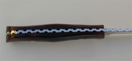

Since you asked about contours though... I deleted my typing and drug these pics out of my fototime account. I think they'll give you enough angles to see how I personally like to shape a handle. :)
This one obviously was not done as it's rough and not symmetrical yet... but it gives the basice idea of the front view. :)

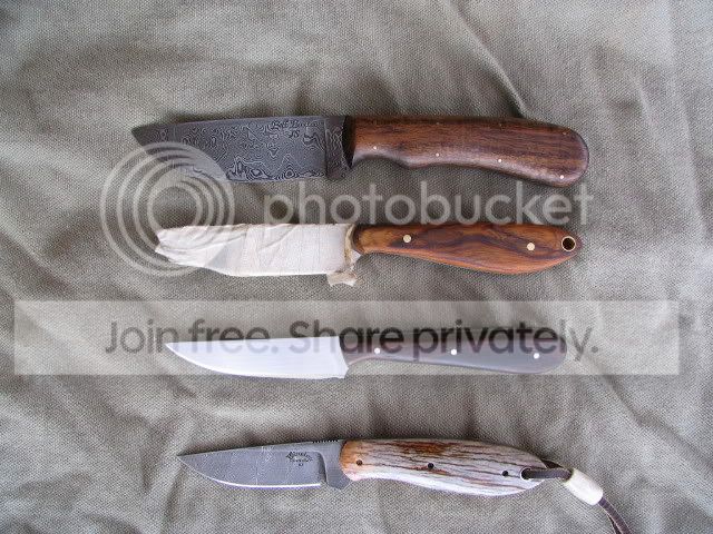

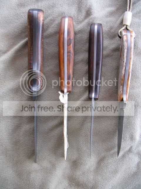

Just to satisfy my curiosity, I grabbed a couple of my customs in a similar size/style to see how they compared. The top knife is a damascus EDC from Bill Buxton, the bottom knife is a small hunter from David Winston (unfortunately I don't know the model offhand.)
I'm not sure I see dramatic differences...mine seem to be somewhat thicker in the palm swell/middle, and more tapered towards the butt. Maybe the tapering I've done somehow makes them look a little thicker or more blocky???

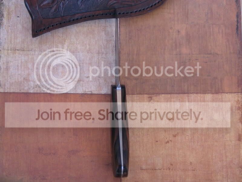

WILL just told me about making my handles egg shaped ,That WILL dont miss much lol . I showed the customer tonight he said yup that just how i wanted it. I completely agree with WILL that handles should be egg shaped. I believe master knife maker nick sad the same thing. I made my first 2 blocky then was corrected and been making then egg shaped ever since. Here is one i finished yesterday.

Thanks for the additional input! I will do some more thinning and playing around with this one and see what I can come up with. I sure wish I had some more wheel options besided my Craftsman drive wheel to help with some of this!
you do buddy! its called a file. and it will work on wood as well as metal. a good half round file and my lil craftsman 4x36 is what i use too. also learned a new trick from my Dad over the week end, he takes a thick (1/4 - 3/8") square piece of window glass and gives a side of it a quick pass on the fine wheel of the bench grinder then uses it to pull scrape wood it leaves an unbelievably smooth finish I'd say in the 220-320 grit range. It also makes quick profiling of precision fit parts easy

I want two things out of a handle. Comfort in multiple grips for extended work, and a shape that allows your mind to index where the knife is in your hand without having to look at it. Will's egg shape from spine to edge is important. These pics show how I contour my Woodsman.
