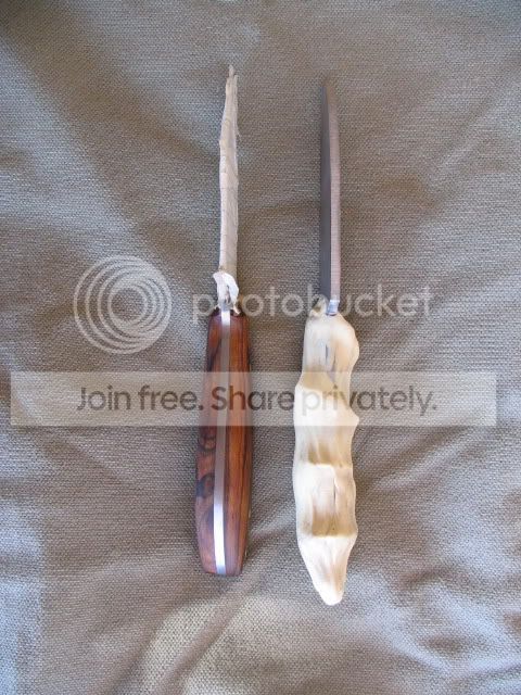

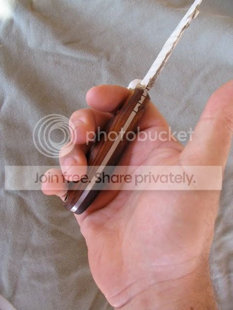

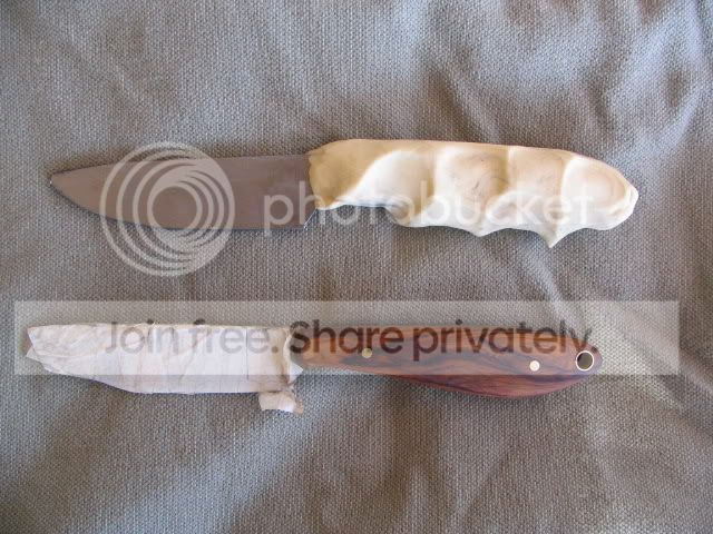

I had another blank mostly profiled out to match the third knife above, so I stuck some clay on either side of the blank and squeezed it, removed the excess, squeezed, removed excess, etc. until it felt good in my hand. I'm still getting a somewhat amorphous blob and I'm not 100% sure how to interpret the results. I get finger 'grooves' and thinner on the finger tip side, and thicker and rounder on the palm side.
If anyone can help with what conclusions to draw from this, or a different/correct method of shaping/squeezing the clay that will help me learn more from the exercise, I would appreciate it.
profile:
from below:
from above:
For fun and for scale, a couple in the hand:
It's not a way to get a exact picture of handle shape. You are not necessarily suppose to squeeze the bejesus out of it. It's more of a way to play with shapes and get a general feel for where bulk is needed and where it's not.

Handles, to me, are simple trial and error. Take a piece of wood, grip it as tight as you can and see where it hurts the most, then remove material from that area until the handle naturally fits the hand and your grip gives nice even pressure all around. I also think sometimes we get too caught up in making things symmetrical when in reality, hands strongly favor a certain shape from left to right. If a customer wants, I'll always swell the handle into the plam if they let me know their dominant hand.
AHA!
Now you can see in the clay the obvious difference between a right handed knife and a left handed knife!
Some folks like to make an ambidextrous handle...while other strive to do both...

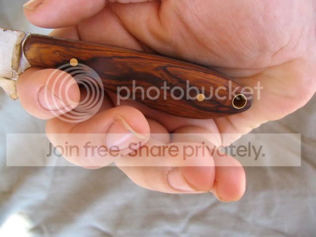

Paul, thanks for posting that in-hand pic. To me, the handle looks too small for your hand (not by a whole lot). I would rather it be a little on the big side than too small. Personal preference, of course. Blocky edges are a big no-no in my opinion, regardless of size.
I think sometimes it's hard to tell much about size/scale from a photo even with some of the dimensions listed, so I thought showing it in the hand would help with that. In some of the earlier closeups it looks much bigger than it really is. It's a small bird & trout, so it's pretty comfortable in my hand even though the handle does not extend past my hand.
Good point, Paul. I've seen pics of miniature knives (only a couple/few inches overall) that were so well-designed and proportioned, it was hard to tell them from a full-sized knife based on just a picture. I also understand your point that a bird & trout knife doesn't need to be as big overall as, say, a "regular" hunter.
