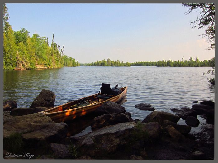

There is no reason to not use the West System you already have, Joe. think for a second - it's a marine epoxy.
It's used to hold wood boats together.

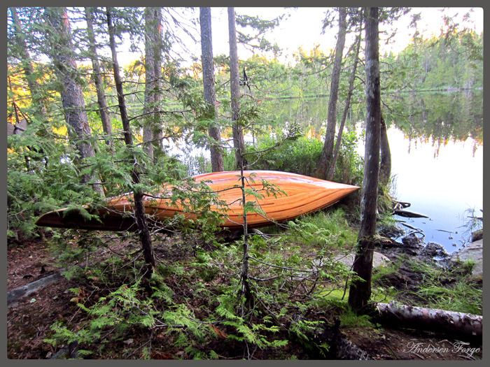

For example, I built this last fall and I beat the snot out of it. Made from all raw materials - cedar, maple, redwood, etc. - and held together with WS -

That's nice!! How long did it take you to make?

Karl - that is a BEAUTIFUL!!! canoe- and the workmanship is fantastic! That is too purty to put in the water {g}
I just spent a week in the Boundary Waters Canoe Area Wilderness carrying a heavy load.
The West System held up just fine.
Of course - she has a few more scratches than before. But what good is a canoe if she ain't beat up?
I agree Karl - what good is a boat if you can't use it - much like a "never been fired" collector's rifle safe queen.
Ken H>
Karl, you don't have a layer of fiberglass over all that...? Just straight wood?
Matt, there's all kinds of fiberglass on that. A layer of 6oz, both inside and out, with three coats of West System epoxy on the outside and one coat on the inside.
Wood glue was used between the bead and cove strip edges, but all of the furniture - decks, thwarts, gunwales, etc., are held in place with West System.
It is the strongest adhesive I know of.
In respect to Joe's first question, West System would be my first choice when attaching wood to wood for knife making purposes. The epoxy joint, itself, would be stronger than the wood on either side.
