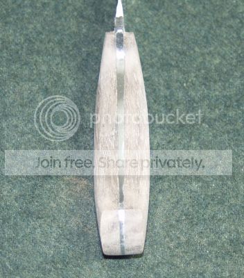

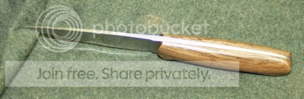

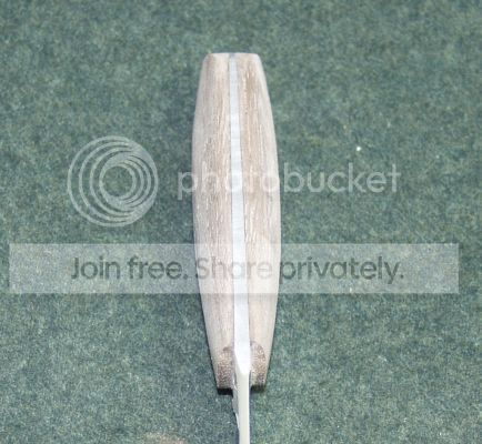

I just did a little shaping of the spine profile so far. Just this little bit is making the handle comfortable in hand. I didn't take as much off the butt ....yet?

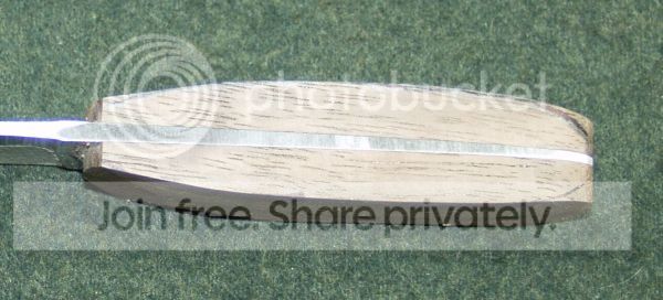

Now I will round the cross section a bit getting closer to shape. I am going slow and seeing how things look and feel as I go along.
I think I've got it now. Proportionally it still looks a little chunky, but it is a real small knife and this shape feels really comfortable.

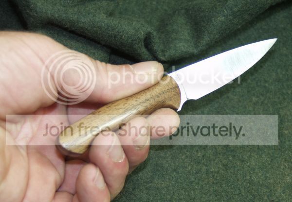

Now some further hand sanding to refine the shape and see how it all turns out.
Much nicer.

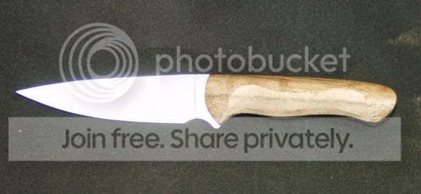

It still looks a little strange, but I don't think that it's the fault of the scales. The knife is very small, but it's shaped like a larger blade with a full-sized handle. It looks like you should be able to get every finger on the handle between the two wider portions. A small knife should be shaped properly for its size, not like a full sized hunter.
It also doesn't look like the grain matches between the two scales. Was this a proper bookmatch?
Much nicer.
It was sort of a novelty sort of blade. Shaped like a hunter but 1/2 size. I think with the size of knife, proportionally it should be thinner in the handle. At least for better visual appeal. I left it thicker because it just felt comfortable in my hand. I think it still looks too thick on the underside though. I think I will change that and see what happens.
No this was not a proper bookmatch. I was frustrated stripping good wood off the blank and grabbed a piece that was in the kindling box. Figures that would be the one that turned out best. I think I will strip these off and use some nicer wood next.

There's a certain point where "normal" proportions just don't apply. Although the blade is quite small, you still want the knife to be comfy in use, and I think you should rely more on your hand than your eye to judge when it's right. Just thinkin' out loud.

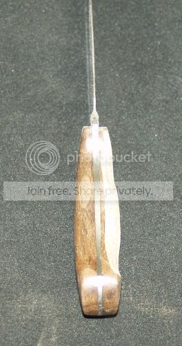

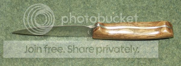

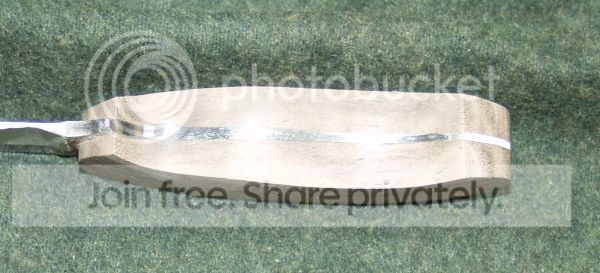

Heading out the door I was thinking about this handle. Since the blade is shaped like a full size hunter the handle would look best that way as well. I want it to still feel comfortable as well.
What I did was go to the spindle sander and started to reshape it so there would be an indentation at the first and third finger. I just rough sanded one side but I like how it is going. Maybe in the end a coke bottle shape will be best?
Any input tonight before I start messing with this tomorrow is appreciated.
Thanks, Mark
Mark - To my eye, your most recent modification is on the right track however, I also agree that the butt end is a bit thick - chunky. Give that feature a little slimming as well, about the same thickness as the front end, and I think it'll get a bit closer to what your looking for.
I'm confused. Are you making a scale miniature, or a usable knife with a small blade? They're two different animals...
You can't drink whiskey out of a bottle of wine :)
Hey, Mark. It's looking much better! Here's something I do that helps me get that egg shape I'm looking for from spine to bottom of the handle:
I get the knife to the same condition as you do like so:
Then I use the flat platen (or you can use a rasp/file) to knock the corners completely off like so:
So that you get this:
I'll go ahead and take the edges of the scale down to right at the finished thickness I'd like. I usually leave the "peak" of the side of the scale just above midline in the handle. Not so much a perfect oval when it's finished, but rather tear drop shaped.
Then I go to the slack belt and round it out. If the scale still seems thick, I'll knock some off of the "peak" before I blend it.
So you end up with something like this:
Then again, it all depends on the profile you want. For my smaller handle EDC's, I like a smooth tear-drop or egg-shell shaped handle. For a full handle, I like a bit more contour, and maybe even a palm swell:
Anyway, keep playing around with it, and you'll find something that clicks in your hand and in your mind.
--nathan
