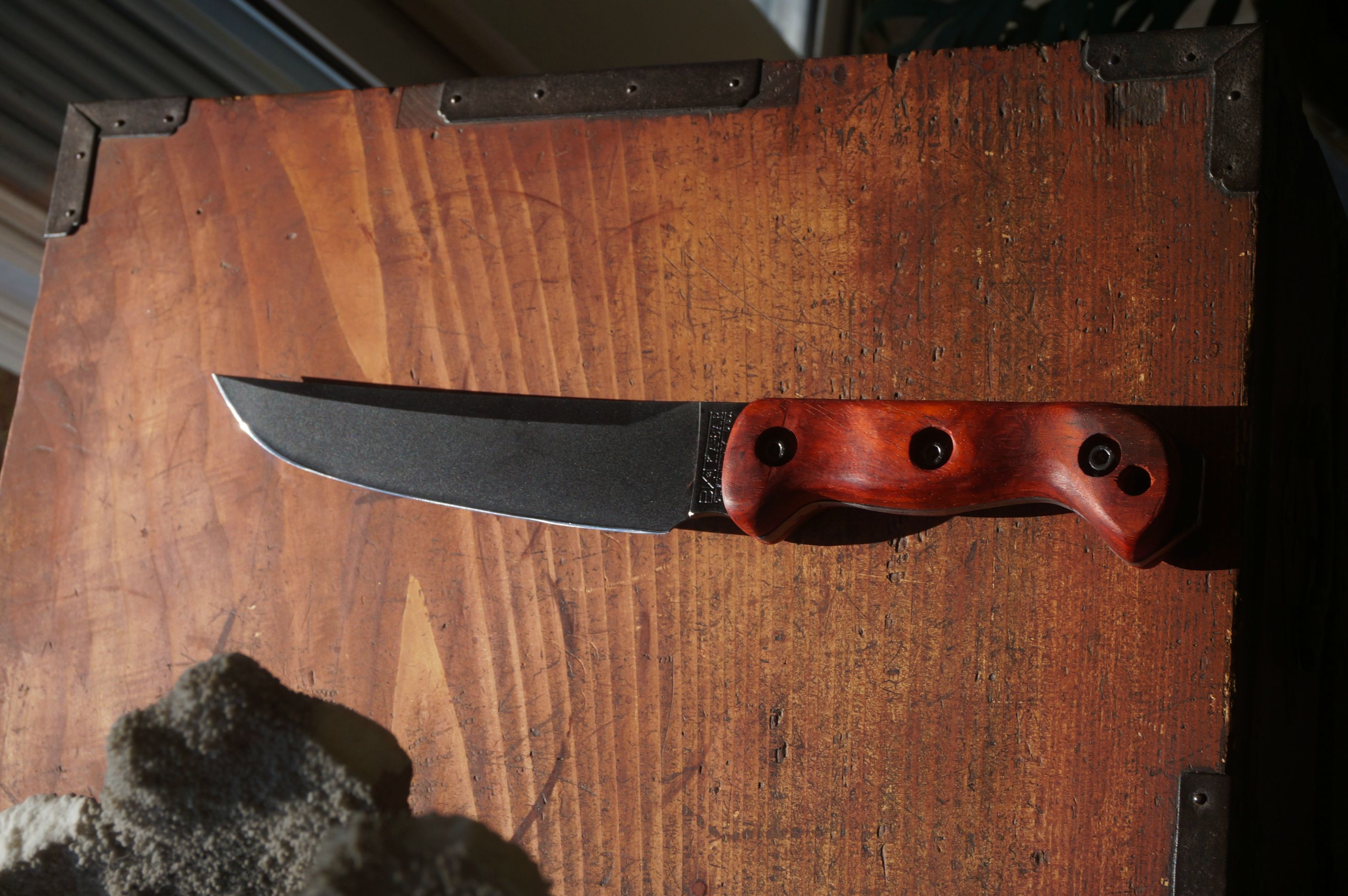

I tried a set of Bocote wood scales that started out thin, and they show in the results. But at $8.oo, what the hay. Mine are fitted on the BK5 next to Tommy's Honduras Rosewood on the BK9.
[/IMG]
My only becker.
