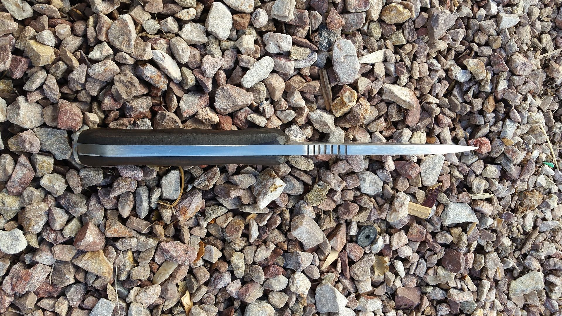

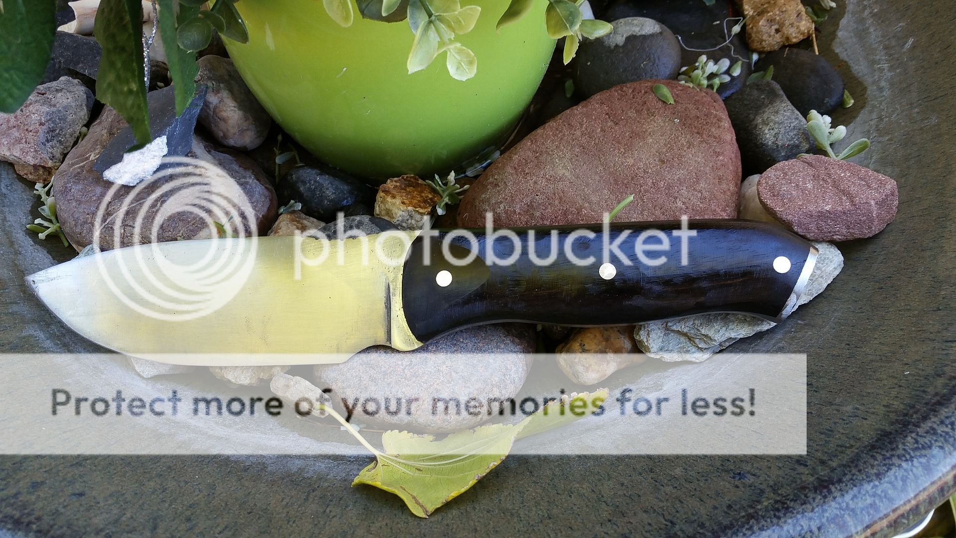

:). Thanks. This feels like a high dollar knife now. I'm pretty happy with the results. They aren't professional but it's mine
Bighaze, that came out really, really nice.
Any shots of it in/with the sheath?
Not yet, I've actually decided to continue with the finish. It's on my bathroom floor in front of the vent drying right now. The Formbys wasn't holding up as well as I thought it would so I got some Tru-Oil. I experimented with it first on my Mora I rehandled in chestnut and so far am much happier with the Tru-Oil finish. Once I get a substantial coat built up on it, I'll take some more pics and show y'all how it comes out
How many coats are you planning on putting on the scales? I bet you can't get it out of the bathroom door by now...

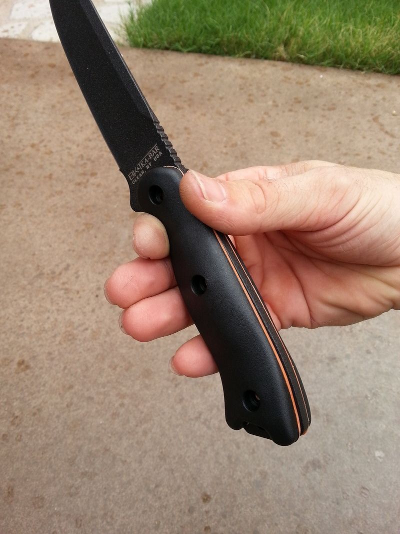

I just made liners for my 15's with a trip to the dollar tree. Look for the thin plastic 3 ring binders and the cutting mats. The cutting mats are a tad thicker. You will want to stack layers. Think 3 on each side would do the trick for you.
:thumbup:
Those cheapo thin plastic file folders and binders work well. You can glue up multiple layers to get the hand-fit perfect.

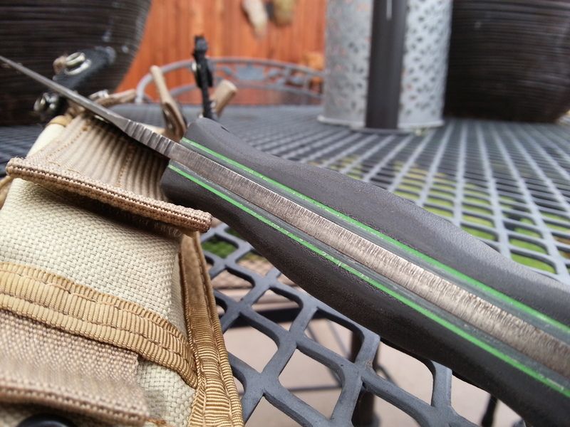

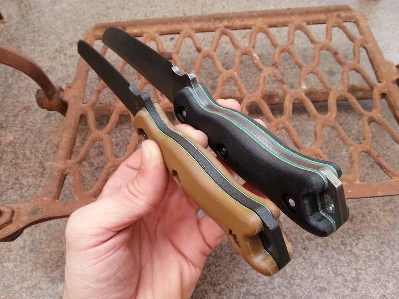

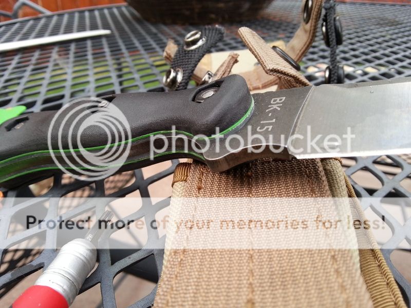

Here's one, with (I think) 3 layers of each/side: green notebook, cutting mat. It's a little too beefy now, but still good. I'll likely remove one or the other.
Compared to a normal one...
Orange, being held in place
Green and brown looks pretty cool. That's just one layer per side.

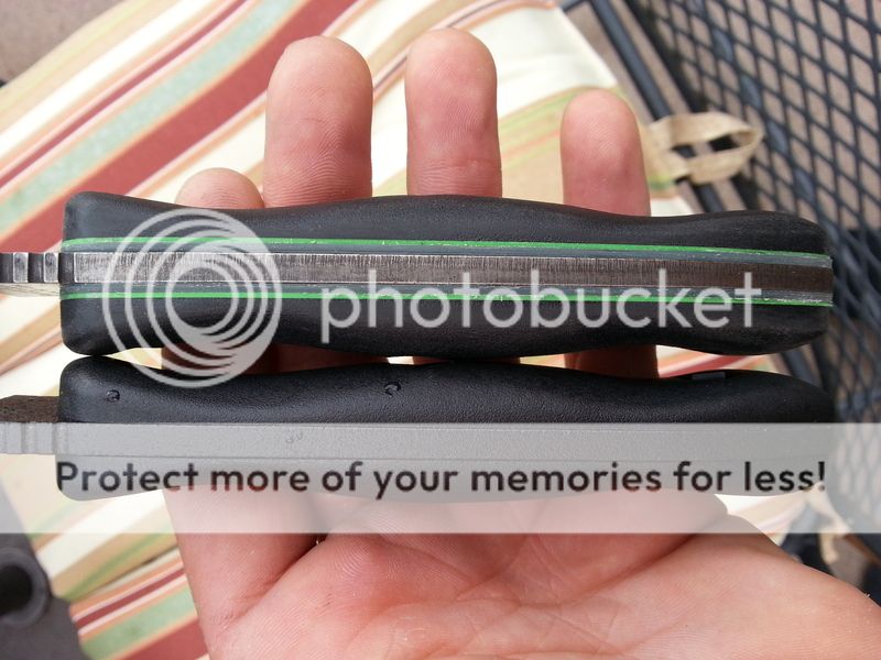

This is the natural patina my 15 is taking on from usage. I am Really liking how that is panning out. Below is a quick shot of my shower pan liners.

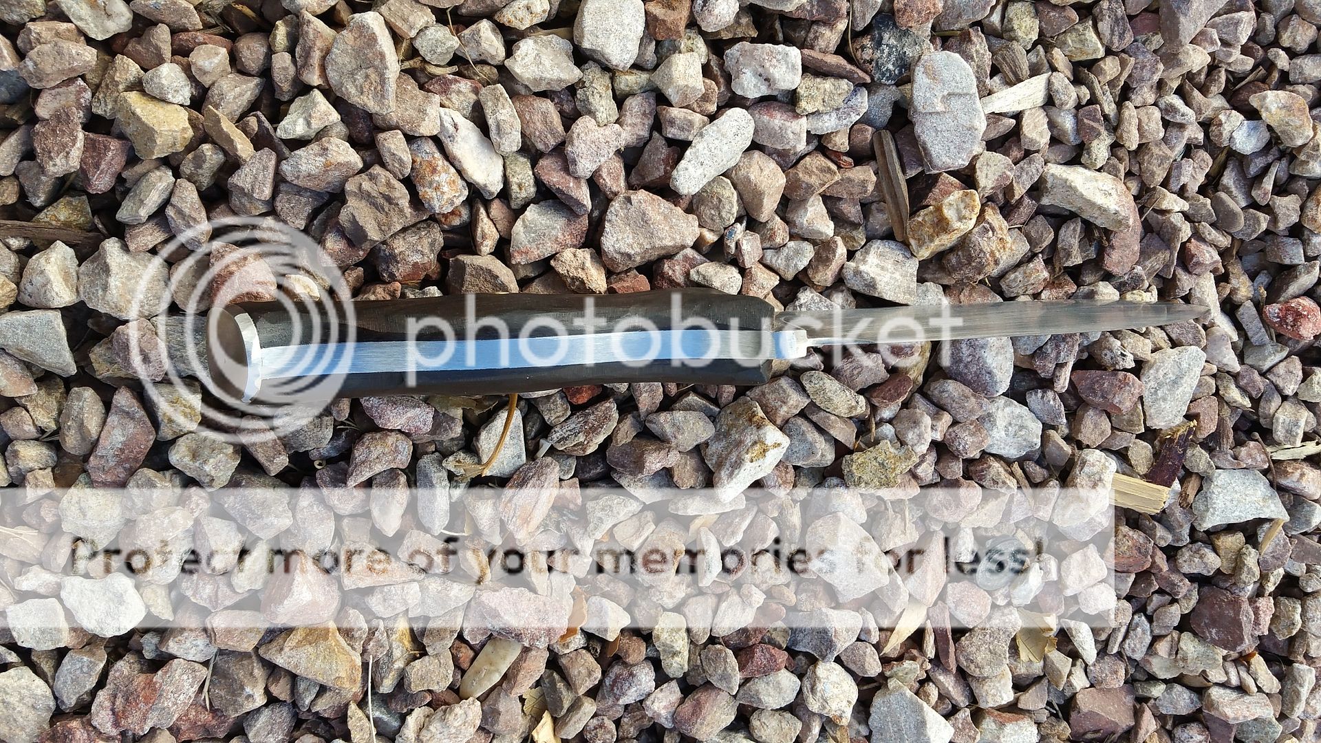

Macasser Ebony, stainless pins and butt plate.
Feels like a totally different knife minus all that weight on the ass end. I'm pretty happy with how it came out.
